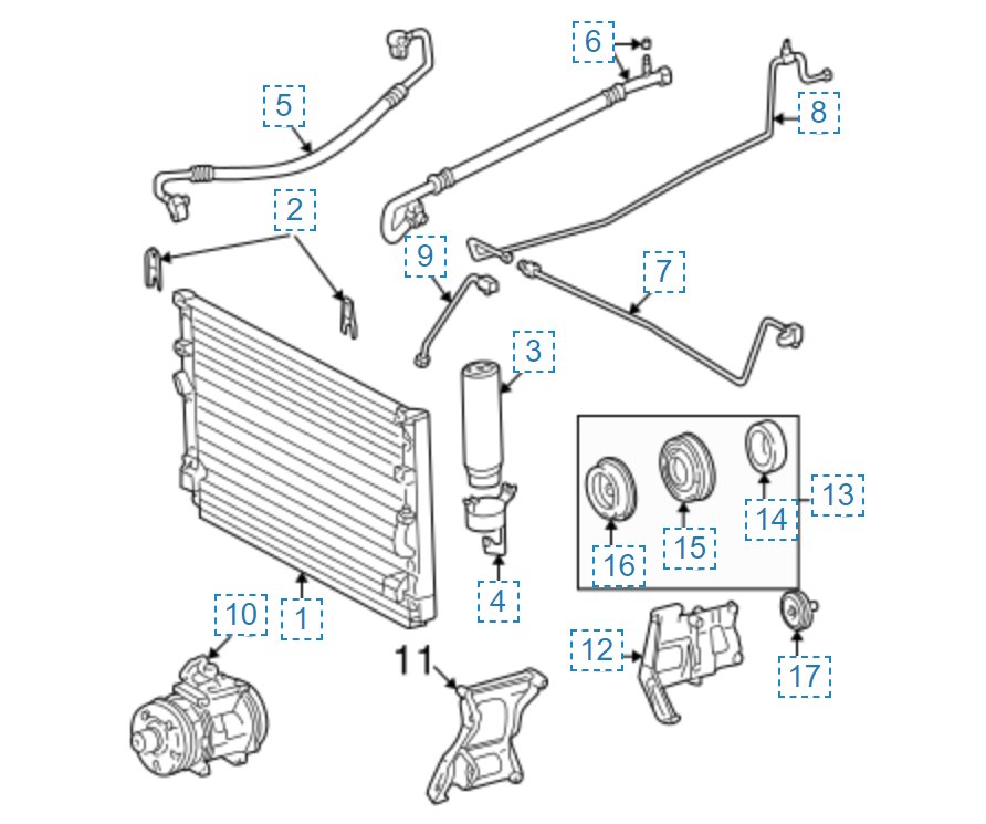

    They are separate part numbers, but if you order a compressor they come as an assembly. If you were to only have a broken clutch you could in fact order just a clutch. I'd just get the whole thing new on rock auto from Denso...

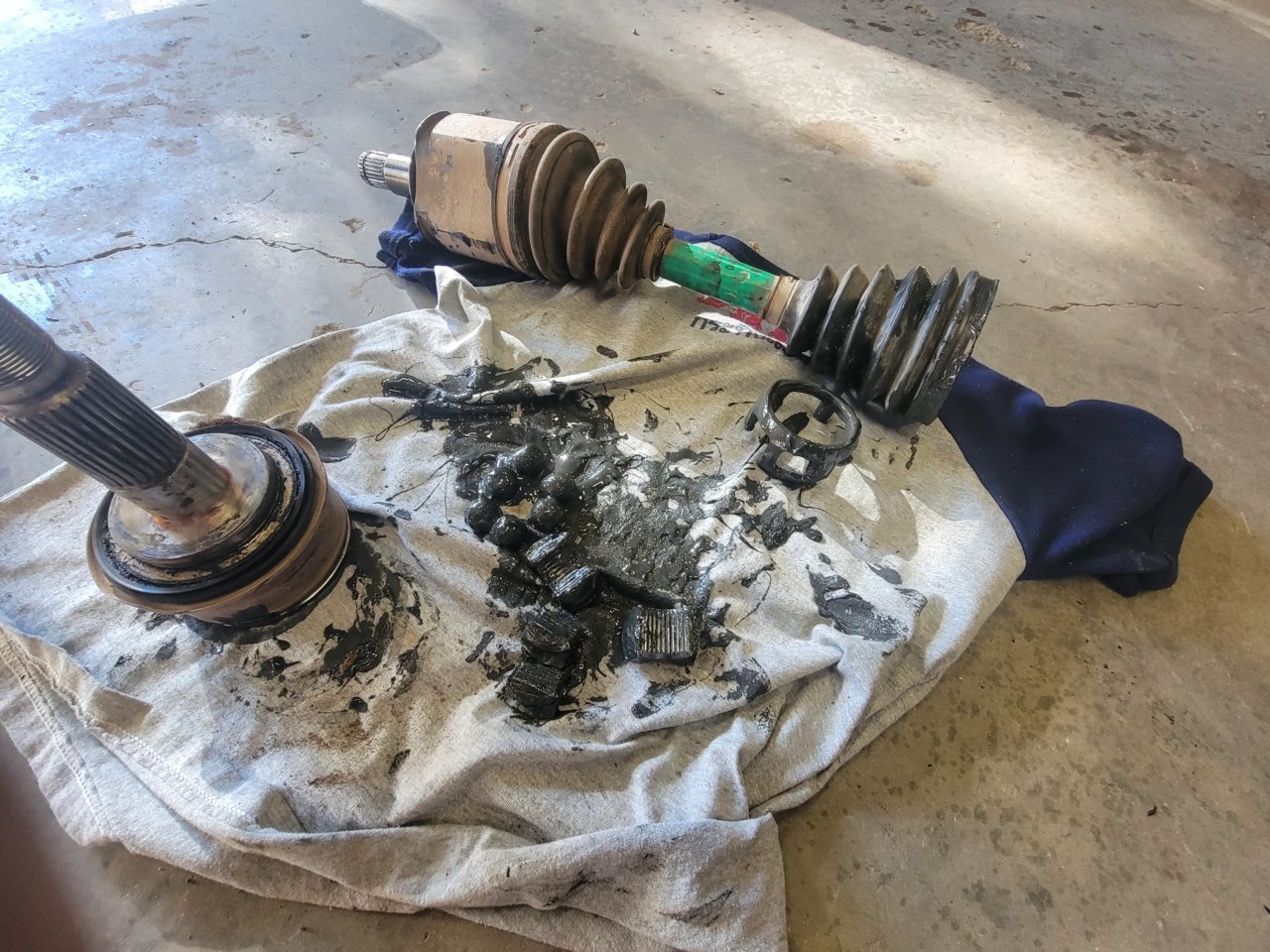

    Back on the trail, and another CV down.

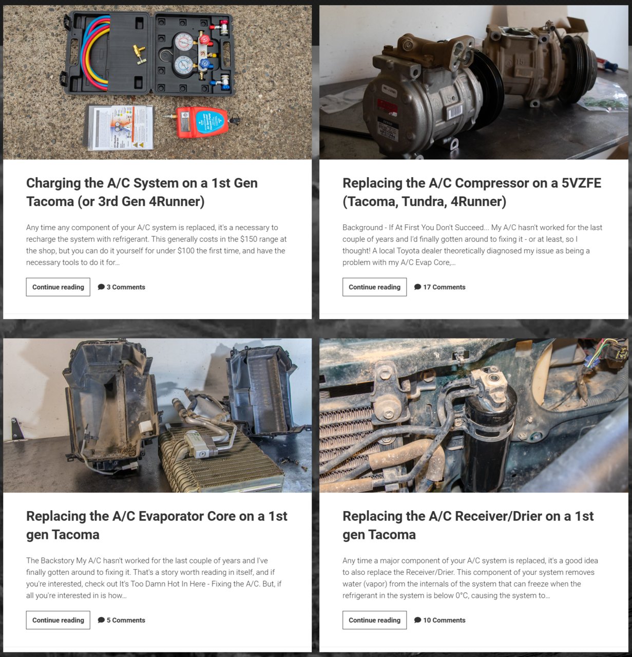

    Here are some write-ups. As usual, parts, tools, etc. needed, and photos of how to do it. FYI, if you replace the compressor (or any part of the system, you are *supposed* to replace the receiver/drier)
    Climate Control Guides

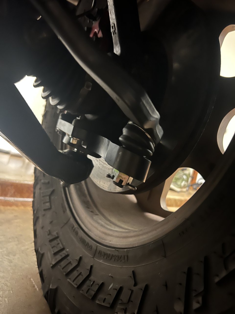

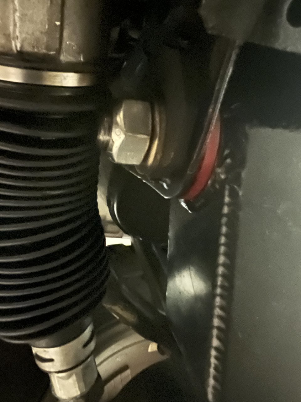

    Finally got around to installing the TC uniball LBJ. I’m interested to see how long they last. Absolutely love it so far.
    Also installed the KP Offroad alignment cams. The bolt end protrudes into the steering rack bellows by a little, but apparently it’s fine like that. We’ll see.

    Nice. Are you running the solo LCA's?
  18. Aug 15, 2023 at 10:53 AM
    ChargedSHOTaco
    ChargedSHOTaco Well-Known Member
    Aug 19, 2012
    #85118
    808
    Yup. Solo stock length LCAs. Puts my caster in the sweet spot.

    Careful... steering gunna be stiff for a while. I didn't like it... at all... at first. But, it's wearing in and I'm probably getting used to it. But it seems like I have to make corrections on my corrections because it's so tight it wants to keep tracking the direction I correct to. If that makes any sense.
    I have 333 Fab alignment tabs. The bolts protruded in to the bellows and eventually tore them. I've been meaning to replace their nylock nuts with shorter stover nuts.
