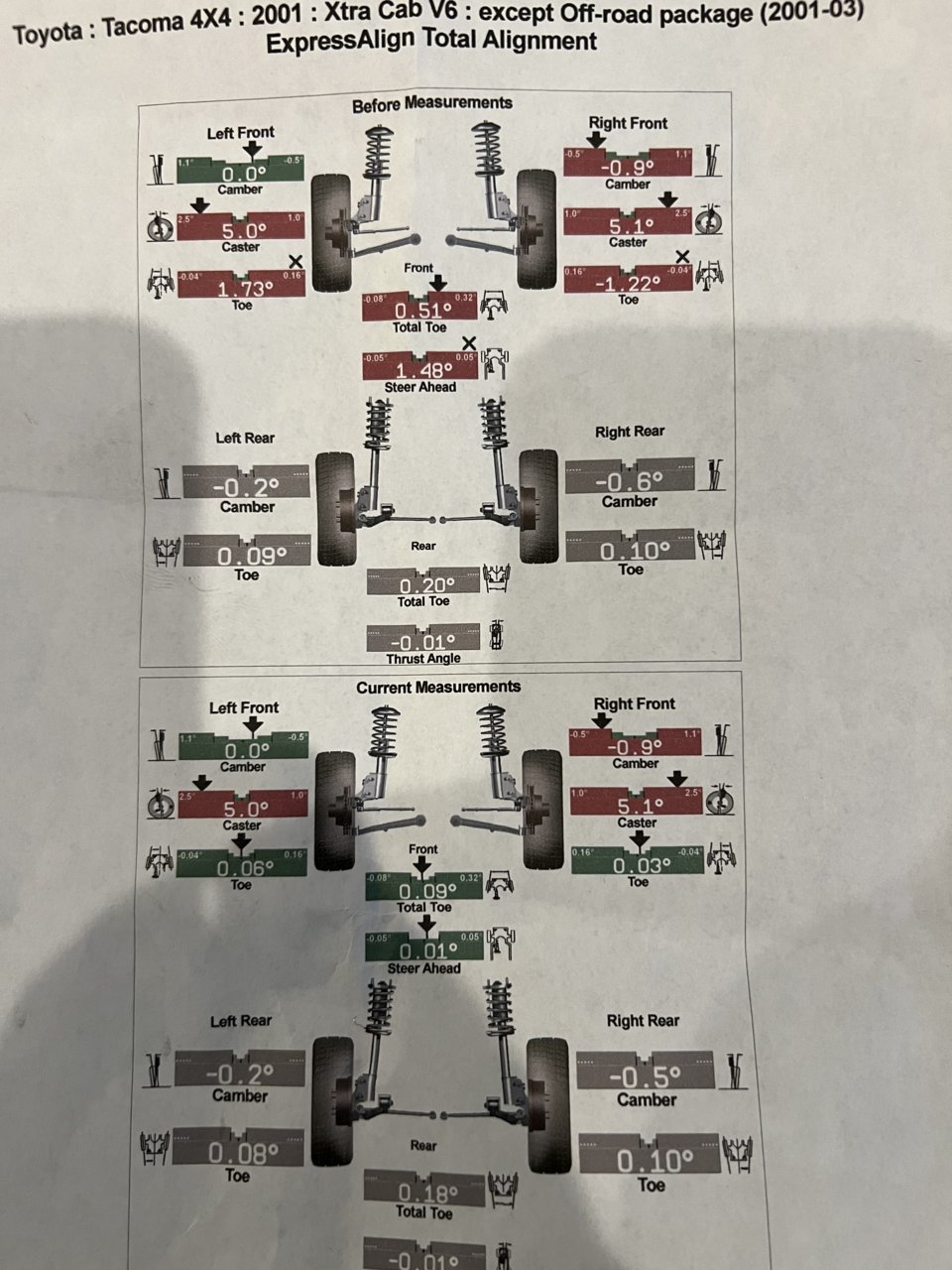

    Initially the steering was stiff, but it went away fairly quick. I didn’t even notice it this morning on my drive, and I have less than 500 miles on them. My truck apparently had 5* of caster:D , so I’m sure that helps it return to the straight position.

    That's a solid alignment.

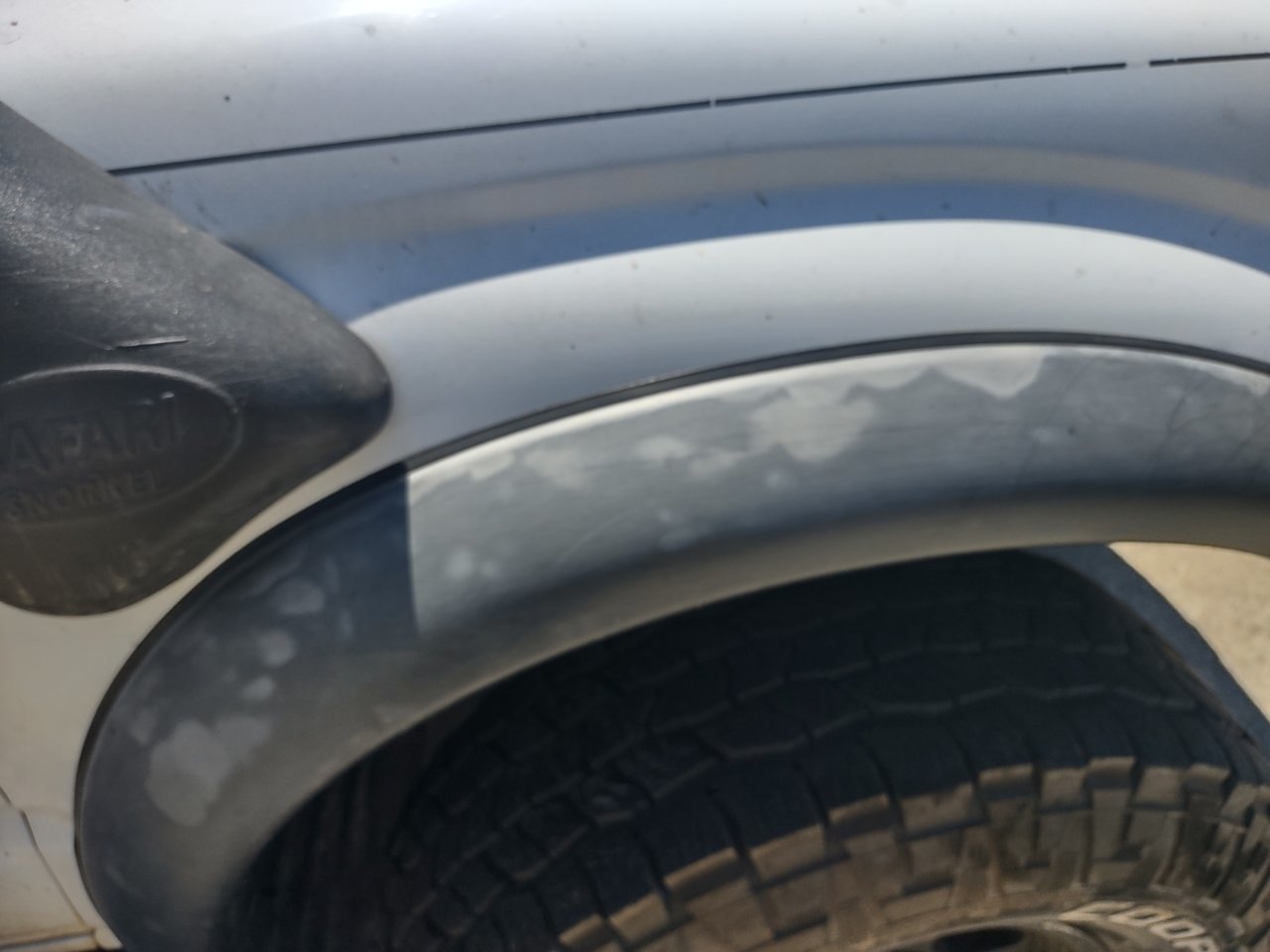

    Besides the oil change I also decided to do the annual "take a heat gun to the fender flares and make'em look black again" mod.
    They all looked like this (or worse)

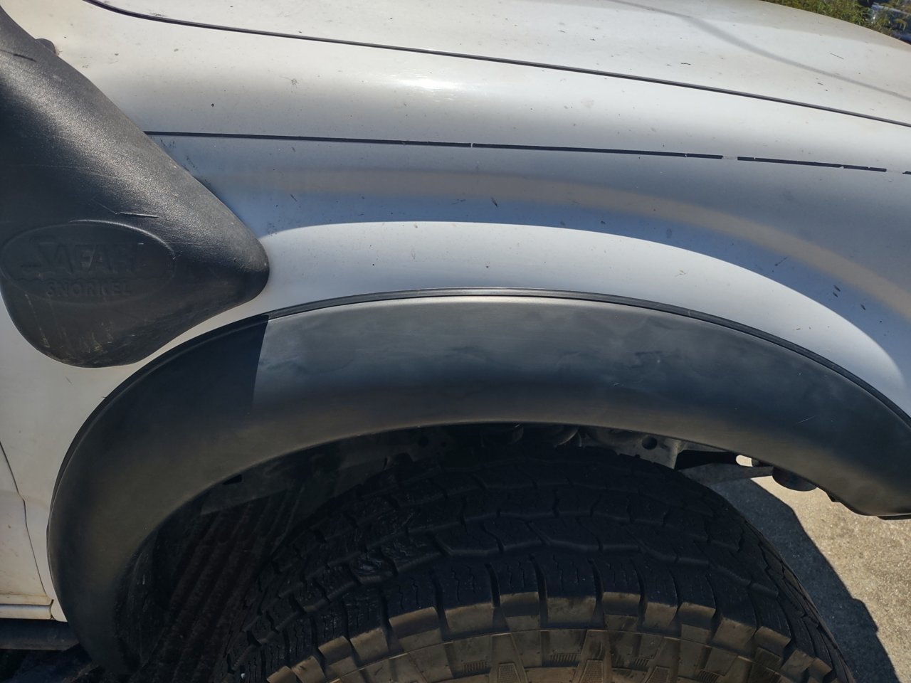

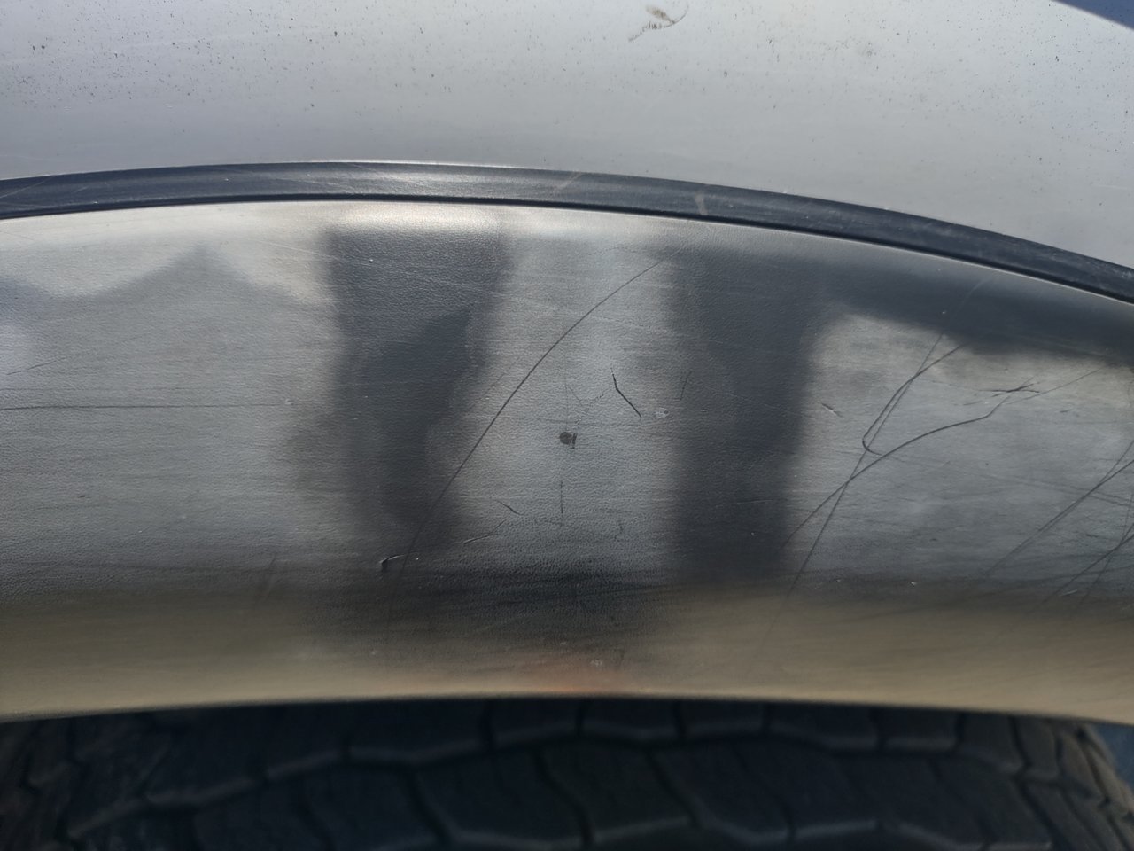

    Stripes to show the difference

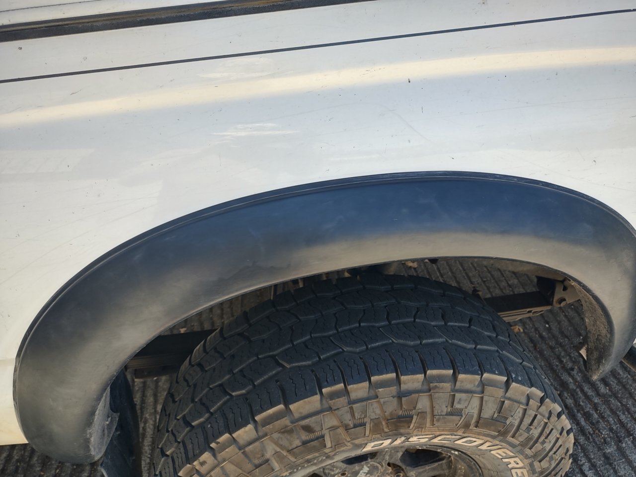

    As good as they're going to get
    All of 30 minutes with the extra, added bonus of a contact high from hot plastic fumes. All tolled ~1.5 hours of attention lavished on my Betty White so she is a happy girl and now to celebrate a 2-mod day with a tasty pint and a gummie that will give me a "real" high. Happy Tuesday.

    How long does the new color last before it fades again?

    When I did that it lasted like 3 weeks

    It does seem it lasts less time after each "treatment." First time looked good for a year+. Second time, a year. Third time, six months and it has seem to stabilized there between the last two times I did it. Still takes about a year to annoy me enough to do it again though.

    If it faded evenly I wouldn't mind and probably wouldn't notice. It's when it gets all splotchy that it annoys me and I am forced to do the bare minimum.

    I got sick of it and paint matched them to the truck. Super easy and no longer an issue
