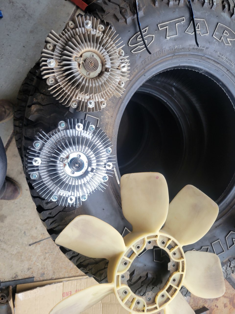

    More last minute shit before Rubicon.

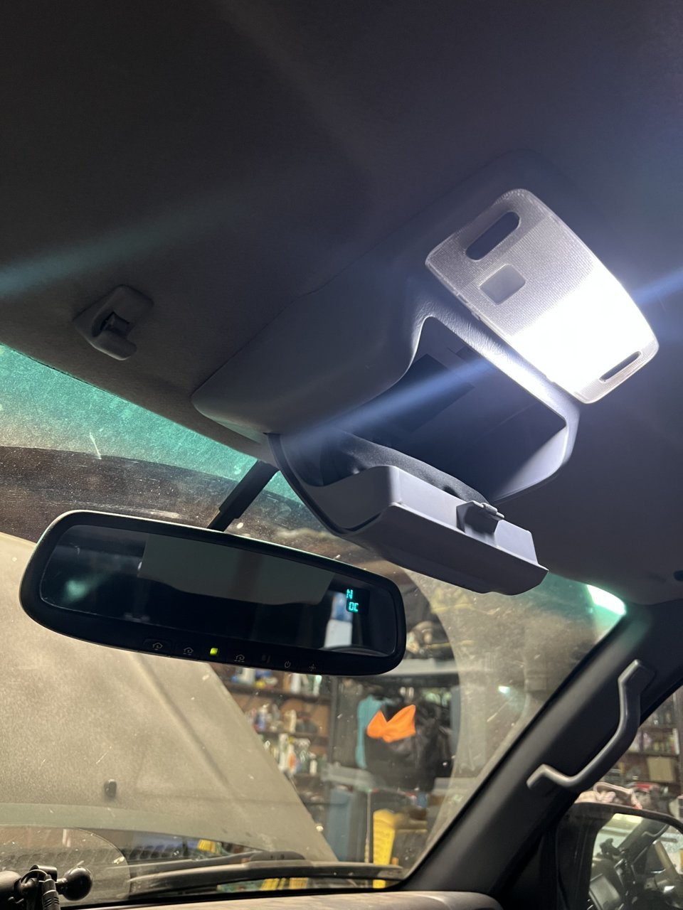

    IMG_0339.jpg Just finished 4Runner sunglass console and a Gentex 453 mirror with Homelink, compass and outdoor temp (waiting on Nissan temp sensor), makes the truck I’ve had for 20 years feel a little bit more modern.

    Way cool. If you're planning on a thread with parts and basic description of the job, we'd love to read it!
