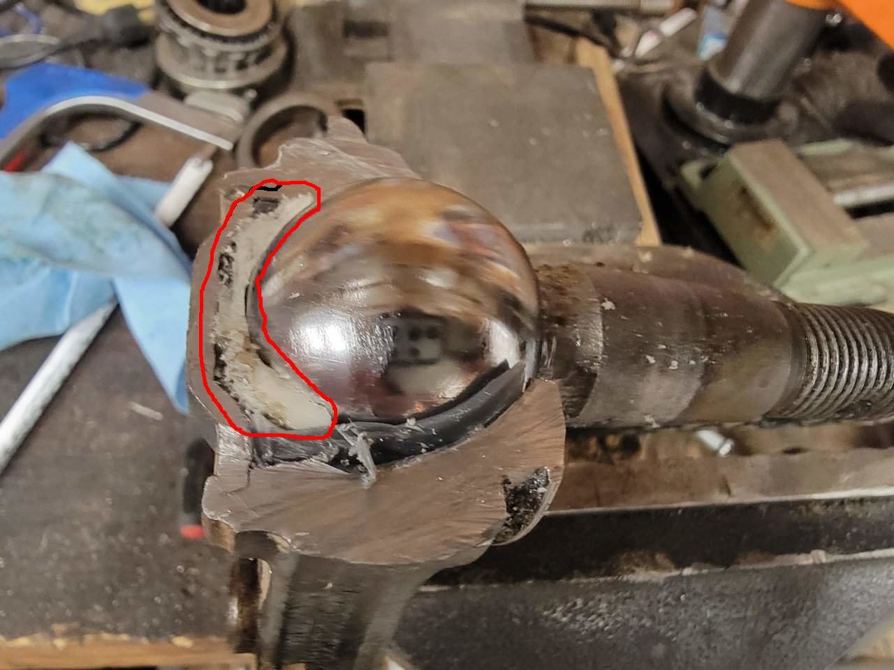

    Measure the narrowest point in the socket and the diameter of the ball. Curious how much material must be removed for the ball to pull out.

    Very interesting. Basic intuition has been any play is bad news. But what I'm seeing is that even minor play has some life left, how much life, well that's up for debate. I haven't checked mine in a while, maybe my wheel isn't about to fall off after all.

    Based on that image, it looks like you would have to wear through a whole lot of material for the ball to have enough room to pull out! Like into the metal

    Is this the material that wears and causes the ball to get loose in the socket?

    Agreed. All the liner would have to be gone and some of the metal I believe.
    I don't think so, but I wonder if that's what's causing the touch of vertical play for those of us that are hard on our rigs.
    It's the grey liner that would have to wear out to cause a problem.

    And to be clear - I am far from an engineer, cut my LBJ apart for the heck of it, and throwing out wild ass guesses after going through many sets of joints.
    If you want to gain some real knowledge, and see a much better cross section, see @Dirty Pool 's post here:

    The other thing to consider is you will likely have to replace the uniballs even more frequently than a ball joint.
    They are not protected by anything.
    They are constantly getting dunked in everything as they are low.
    It's just a Teflon liner keeping it lubricated. Soon as that's worn down or ripped out from dirt getting in there. They are done.

    Neglect/ignore a side loaded uniball and it will eventually pull out. This guy fully admitted to thinking ball joints were no longer a worry. It failed around 50k.
    This members OE joint clearly shows the galling of metal on metal after the liner wore thru. This does not happen on a 555 type joint because the ball/seat is machined to some degree of concentric "fit". Unless it's allowed to run "dry", then all bets are off.
    For what it's worth the 555 joint has more "meat in the seat" than OE.
