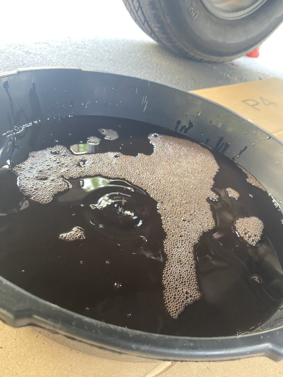

    Getting a pretty rough shudder from the trans around 20mph so decided to do a drain and fill just to see what happens... will probably do it another 2 times to swap more. Just need to get another year out of this trans. Thought it was the carrier support but that made no difference.
