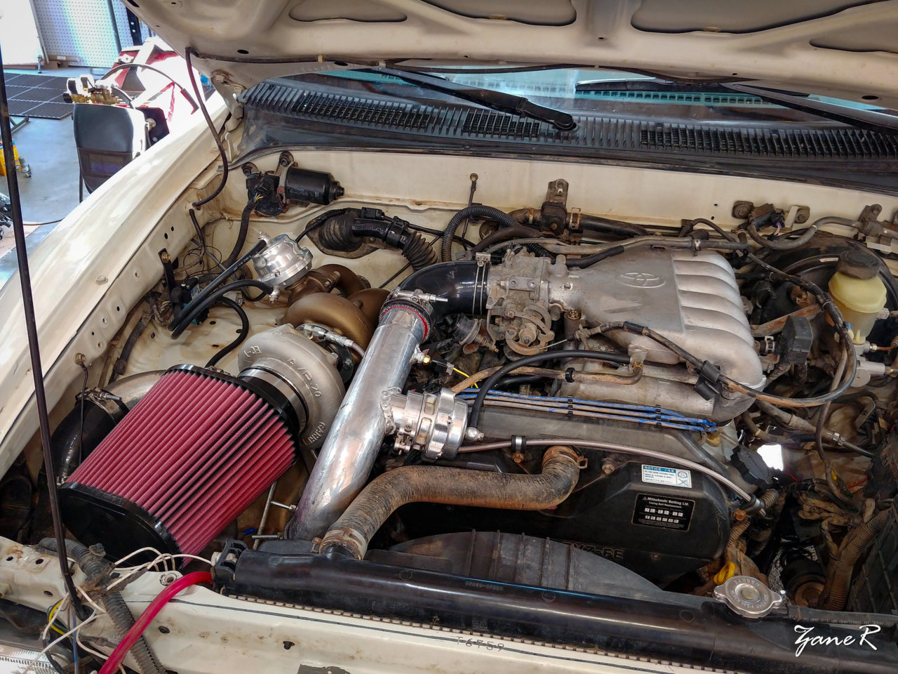

    Awful before picture this morning:
    Mocked up this afternoon:

    Sweet, what's your plan for fuel and ignition tuning?
    What size turbski too?
    I'm running a Garrett 60-1
    jubei, BYJOSHCOOK and SwampYota like this.
  4. Aug 26, 2023 at 9:00 PM
    turboTacoMonkey
    turboTacoMonkey Well-Known Member
    Aug 26, 2023
    #432158
    549
    2000 Turbo Taco SR5 MT
    TBD
    I already have URD piggyback and 7th injector from the supercharger setup - so I'll be playing off of that. (not quite the same as full control like I have with my miata and a megasquirt, but sufficient for now)
    A/R .63 GTX3071R Gen2 -- so should spool nice and low for those low rpm torqs

    Yeah that's gonna spool real early, I've got a .82 housing and it lights up quick but will be cool to see the difference. I'm running a Haltech ECU so with quick spool turned on you don't notice much lag. But damn you won't even need that haha, things gonna rip!

    Nice that's the size I would shoot for. Should be crazy torque at 2200rpms.

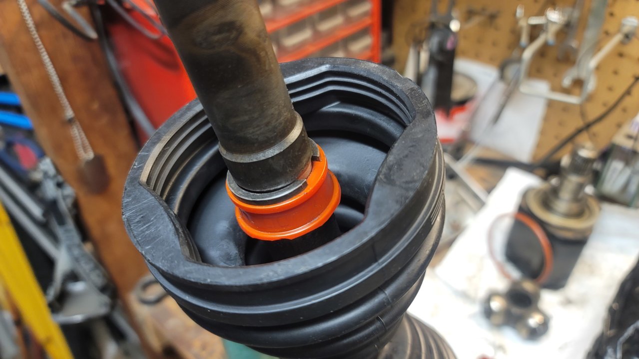

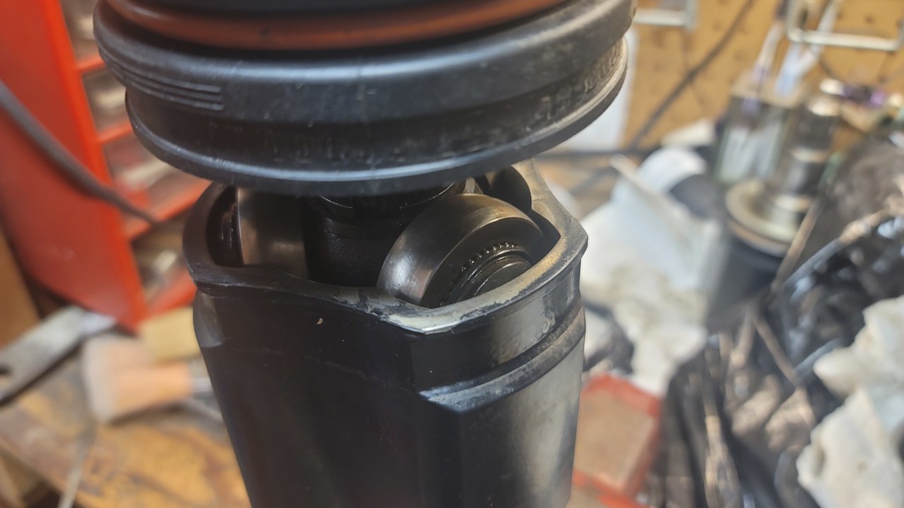

    Good to know.
    I wound up filing the corners down so it wouldn't tear it trying to hammer it on.
    Re tapped the thread. Bummed I even had to do that but now I know better.
    Used some oldspice spray to get it on. She smelled lovely rhe remainder of the install.

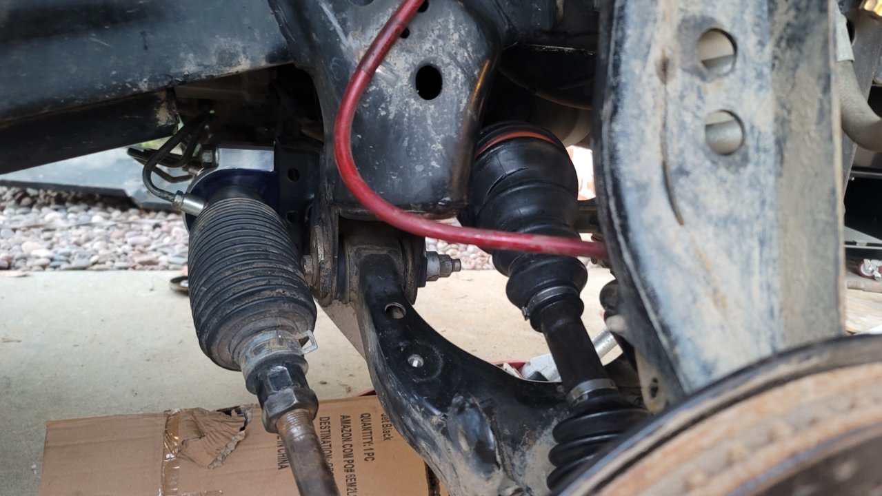

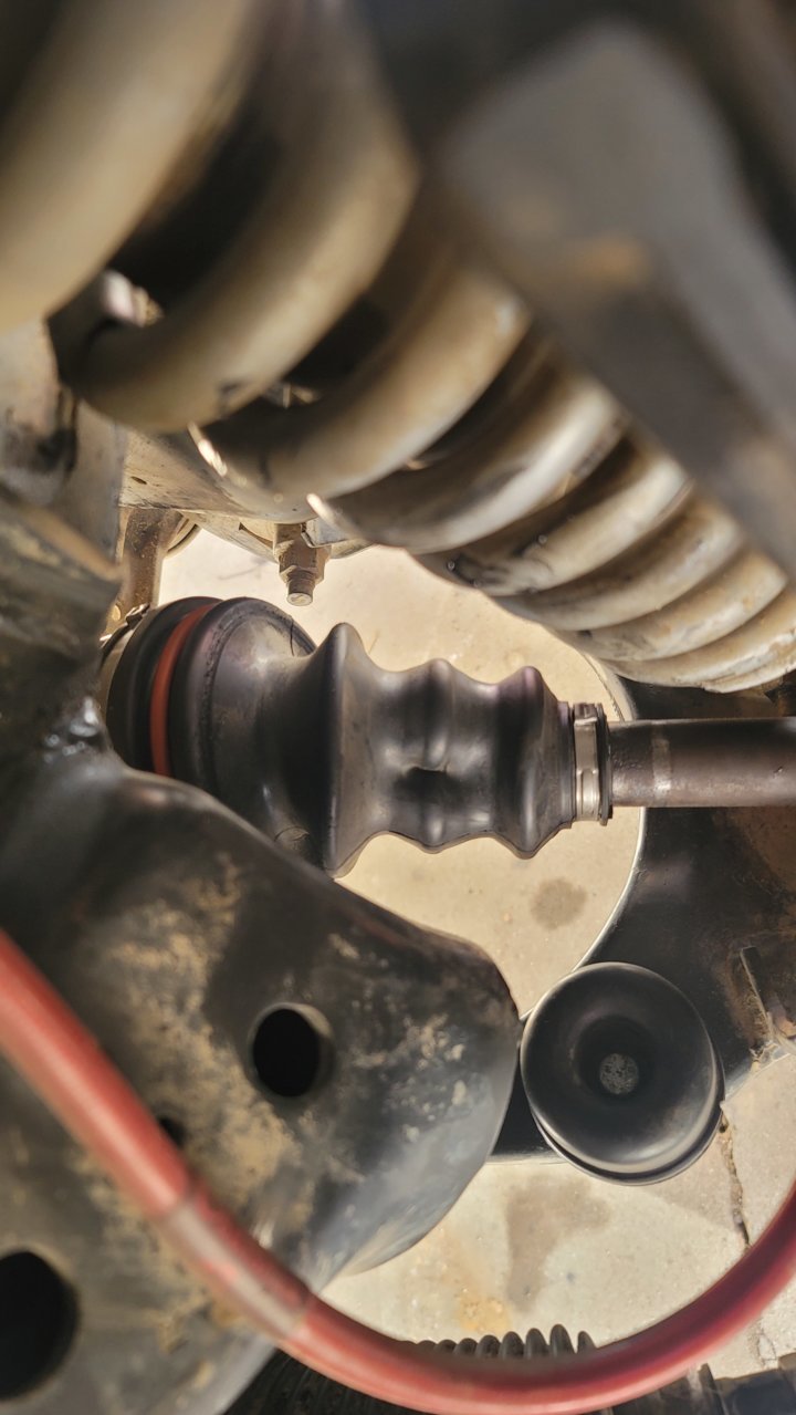

    Tossed on the rebuilt oem CVs also.
    With the expensive boot slide mod lol
    Anyone got a trick to getting the dimple out? Accidently hit it cleaning up some missed grease :(

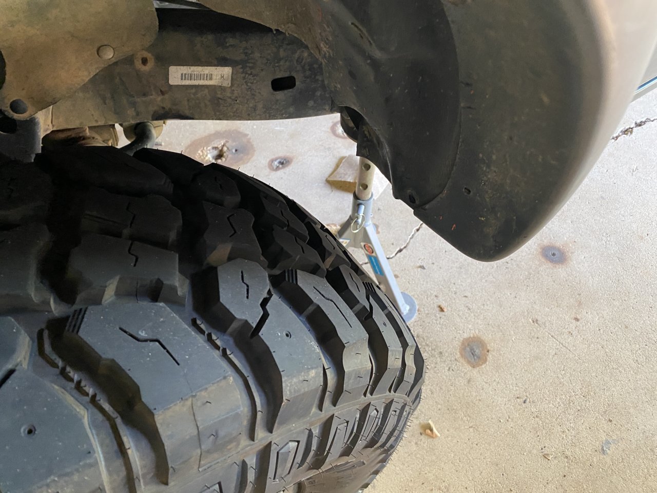

    Did the pinch weld mod.
    Remolded the plastic with the heat gun as well as repainted the bare metal.
