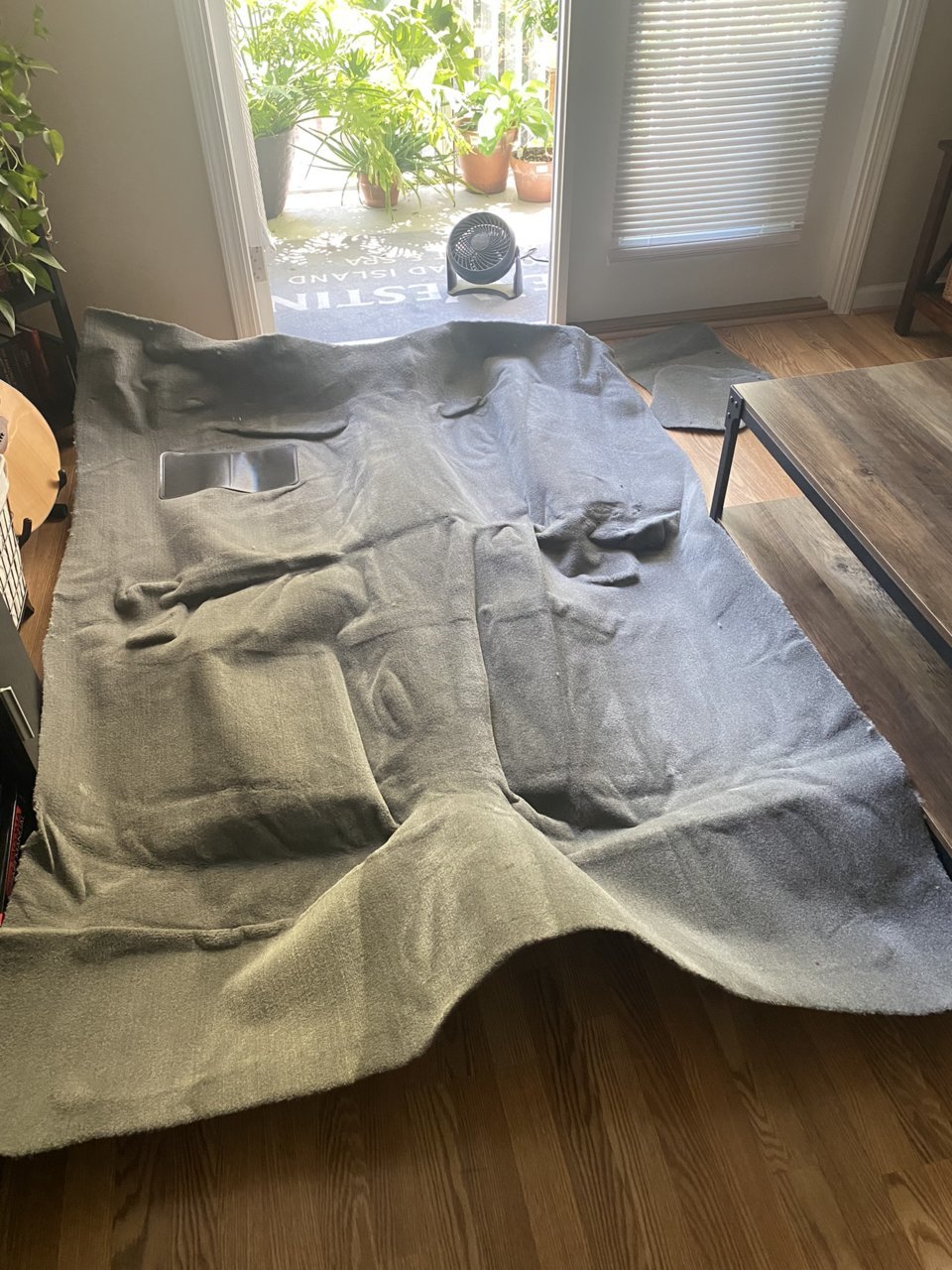

    Fixed my seam leak (thanks Flex-Seal) and the long weekend begins the long process of stripping the interior, cleaning, laying down kilmat then new carpet. ACC essex w/o mass backing purchased from Rockauto. Feels great.

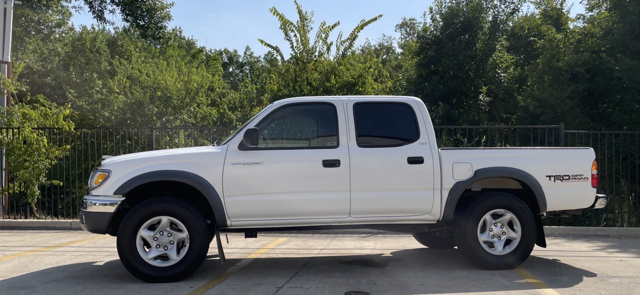

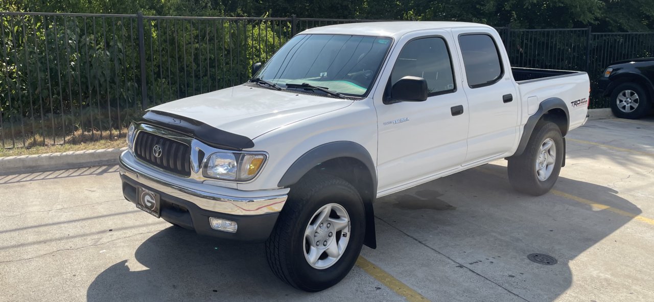

    Keeping it simple. Good ol’ wash and dry for my stock baby… IMG_2461.png IMG_2459.png
    SwampYota and Panchovilla6192002 like this.
