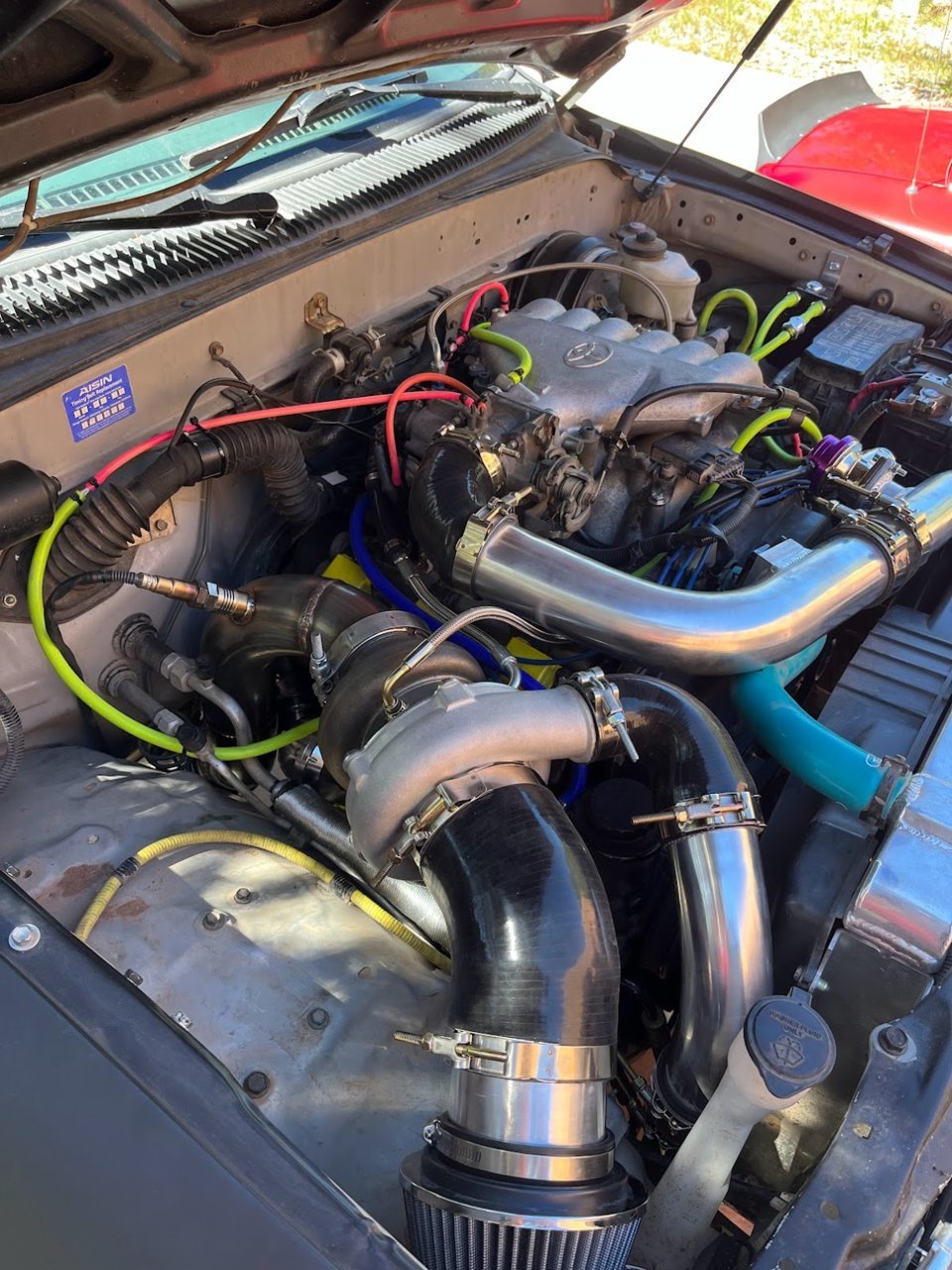

    From my thread (link in sig):

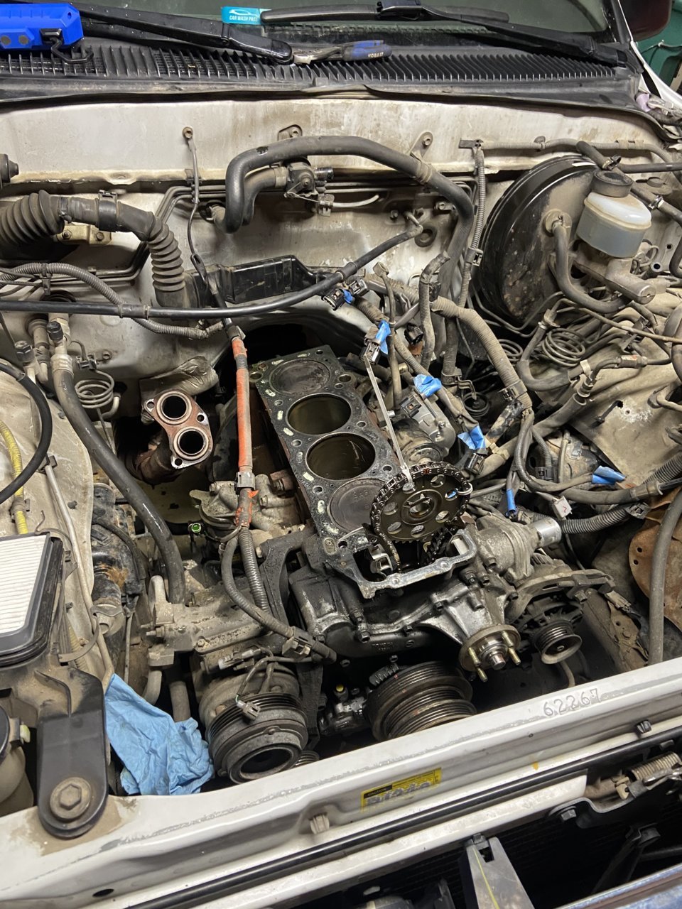

    Still a bit of work to be done over a couple weeks (because header issues), but cabs on, mostly all assembled. Need to drill out two broken bolts for the fuel sender. She’s just chilling in the garage for now

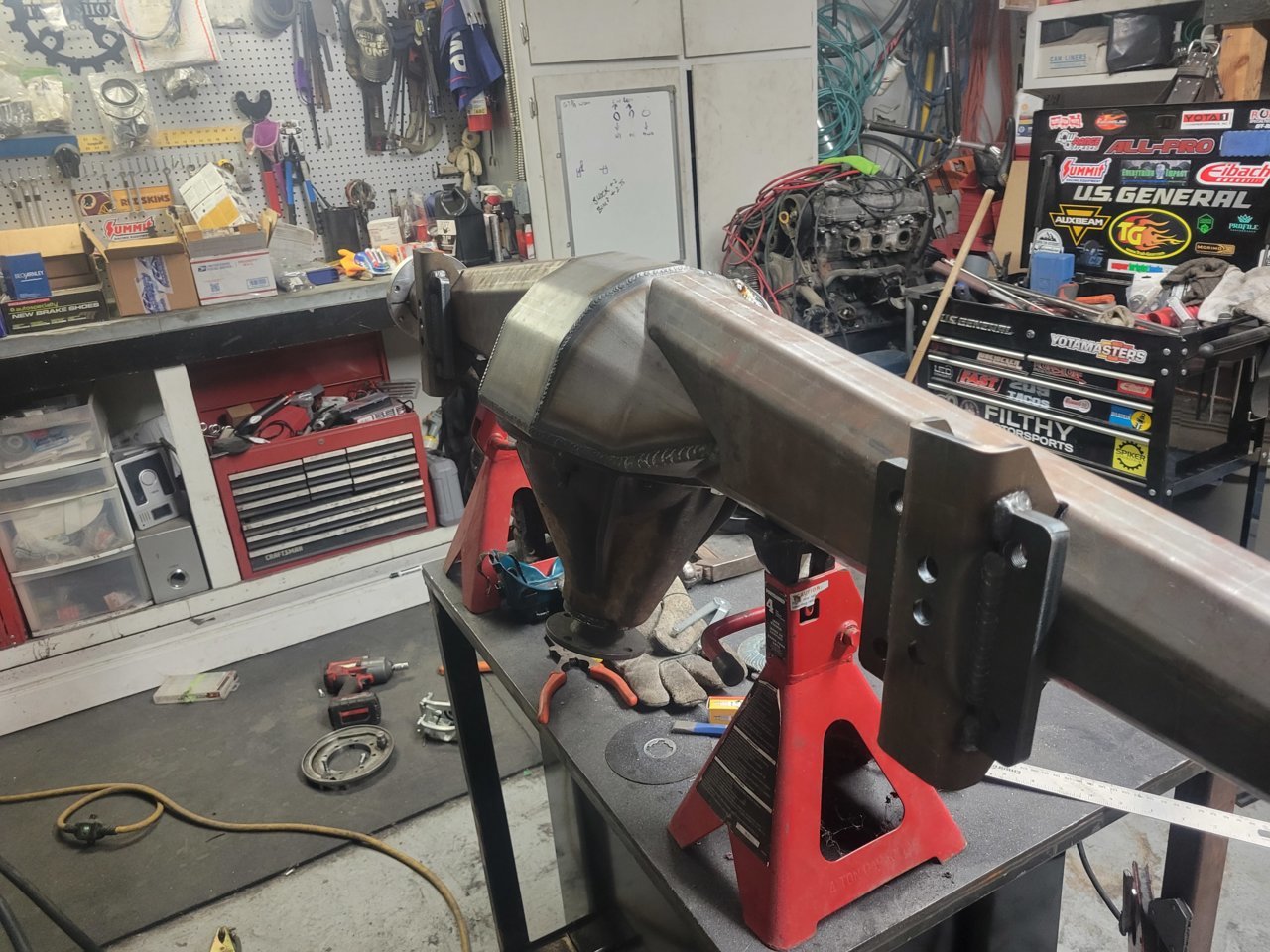

    Finally started tinkering on this project.

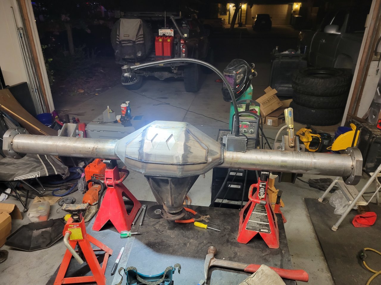

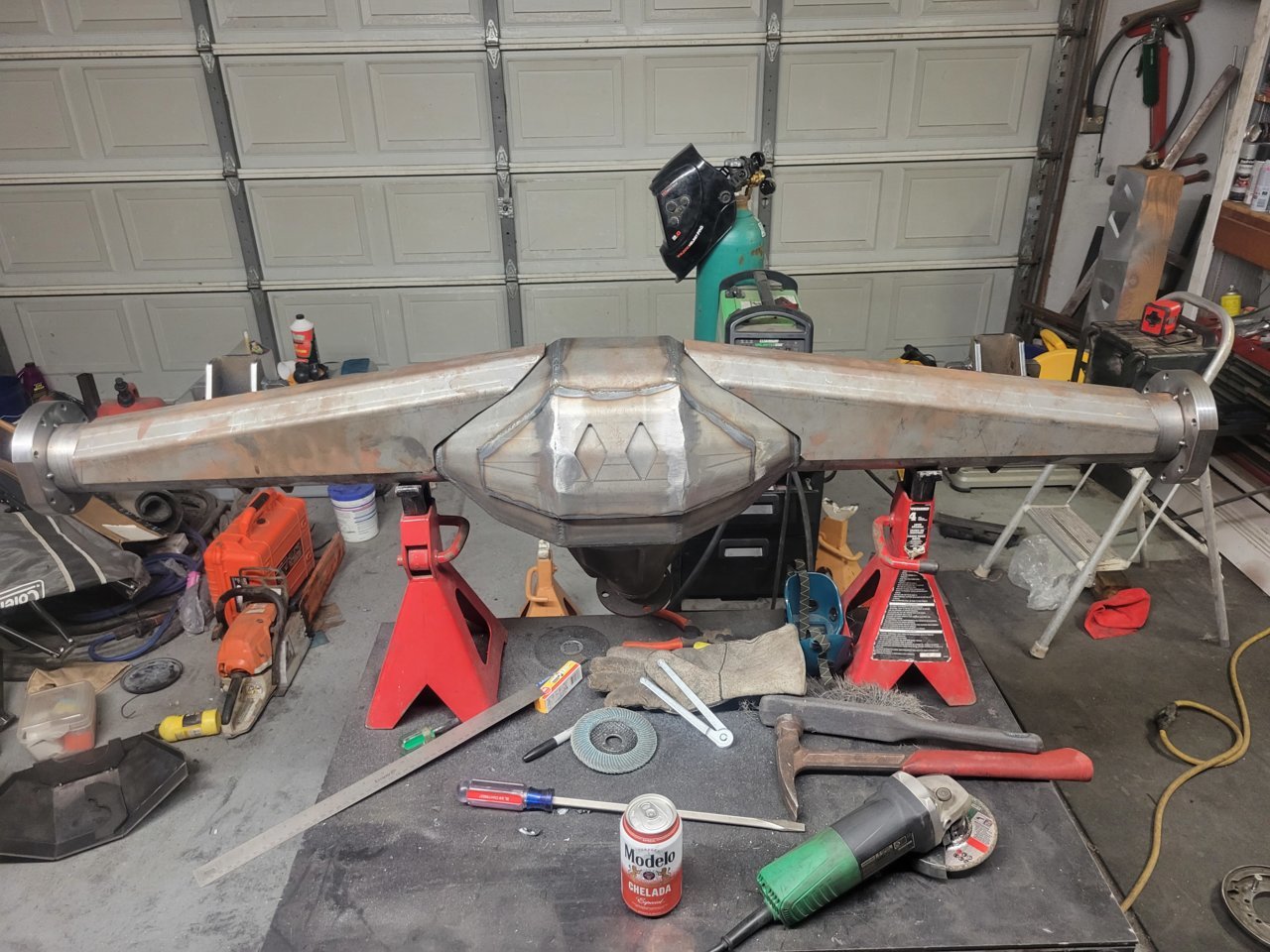

    I'm mostly just fitting things up and tacking.
    I welded the skid protection on the back all the way but the leaf perches and flanges are just tacked. I'm going to take them to a local shop to have them burned in. I'm also going to have them burn in the truss.

    Why not do the perches yourself? I get the wanting a shop to do the flanges since those being square is critical, but the leaf perches are easy. Just crank that welder up

    I would agree if I was going to have Ubolts. But these are Ubolt eliminator perches. If that weld fails, it's catastrophic because the Ubolts won't be there to hold things together.
