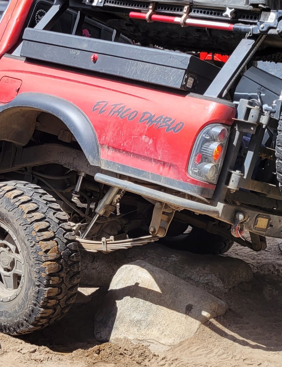

    How far negative do your leafs go at full bump?
    I have my bump set for just a little bit past flat, but my 35s dont go up into the rear fender as far as yours when flexed out.

    Probably about an inch and a half. You can see it here.
    When I originally set up the shocks and bumps I had them set to bump just before they flattened out. But I moved my upper shock mounts and bumps up a couple months ago.

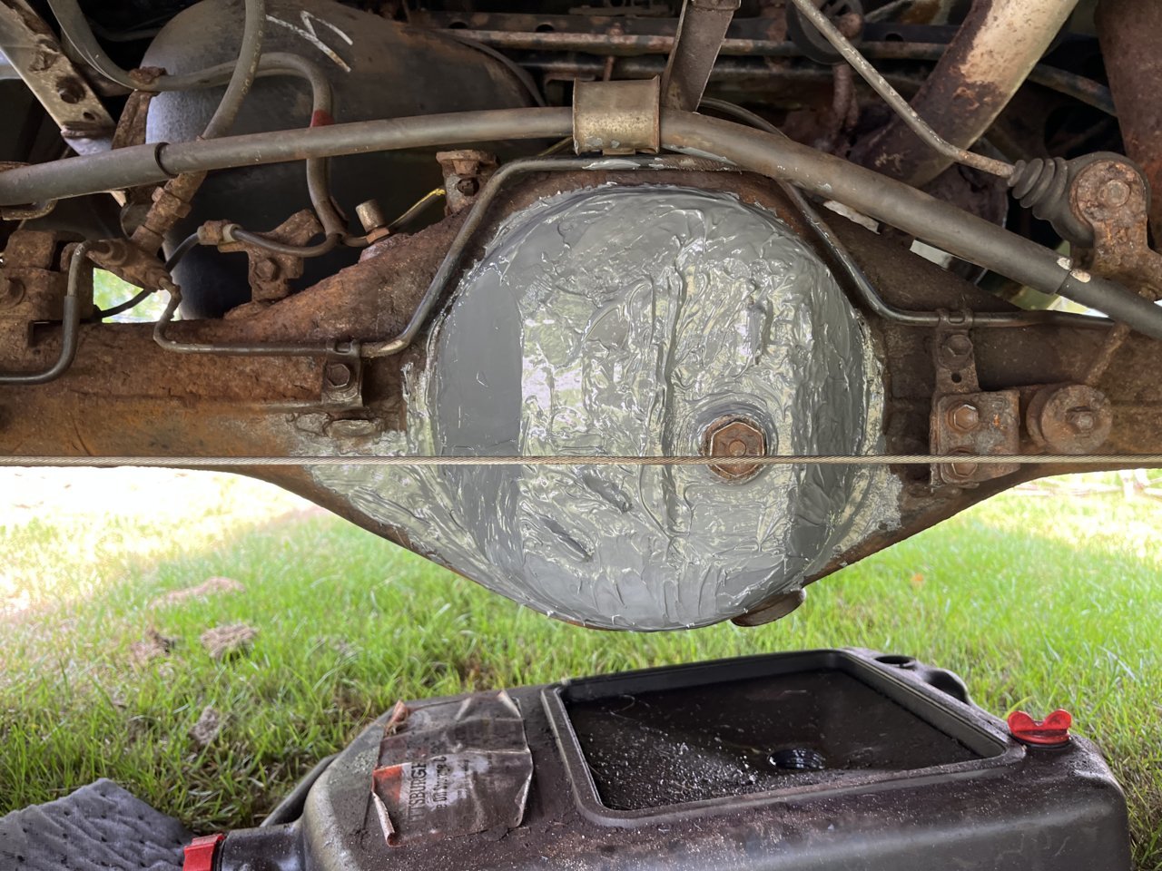

    Trying to see if I can stop the pin hole leaks in this rear diff cover with some JB weld.
    this is a photo before I used stickweld and primed and painted the cover.

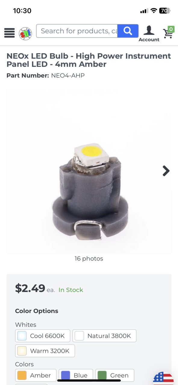

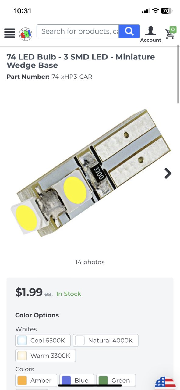

    I used #194’s in my gauge cluster. Neo wedge 4mm for the HVAC unit & #74’s for the glove box, & auto gear shifter light.
    Never heard of #74’s for the gauge cluster. These were for my 04 Tacoma

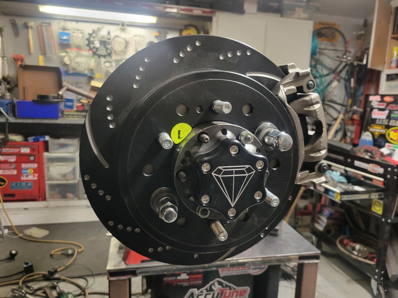

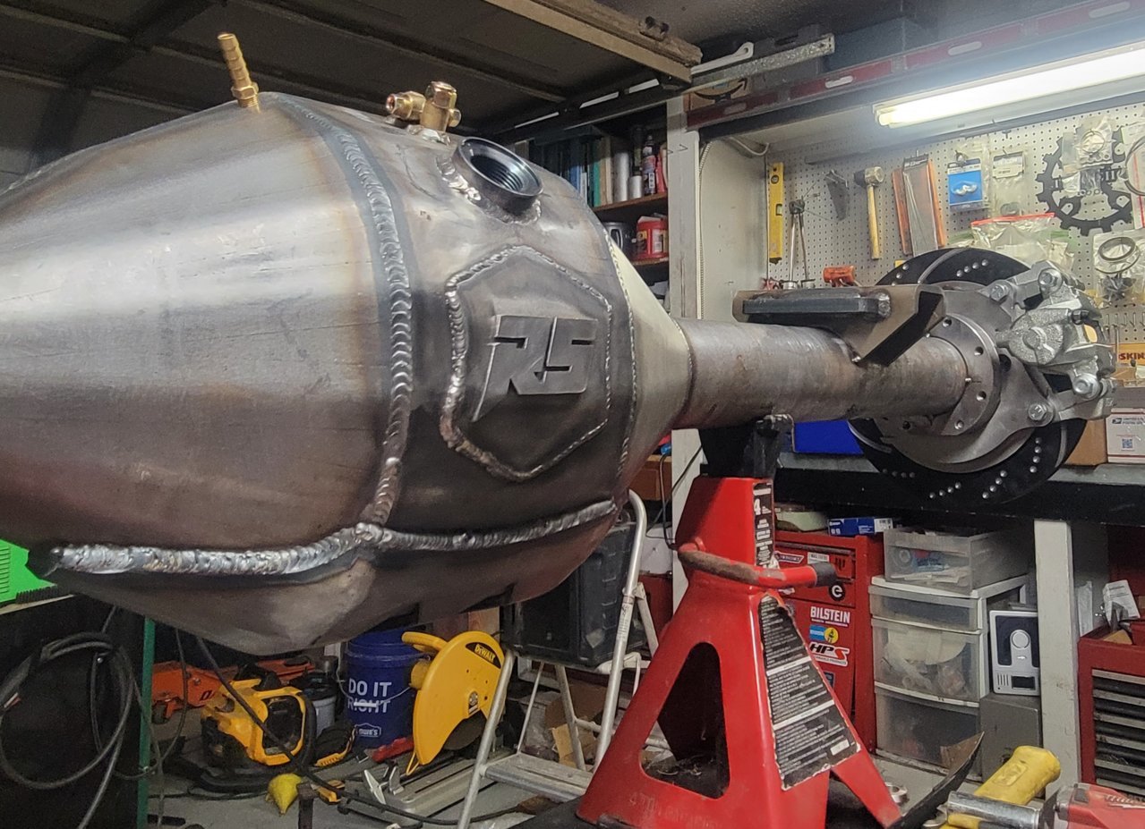

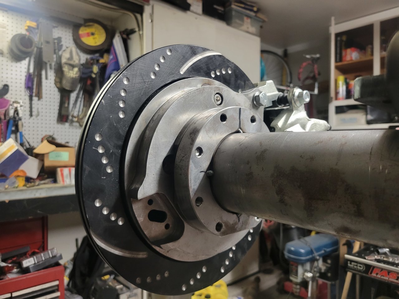

    Getting closer.
    Mocked it up to check if everything is where I want it, before I take it to the shop for final welding on the flanges and perches.

    drooooooooooool :bowdown::bowdown:
