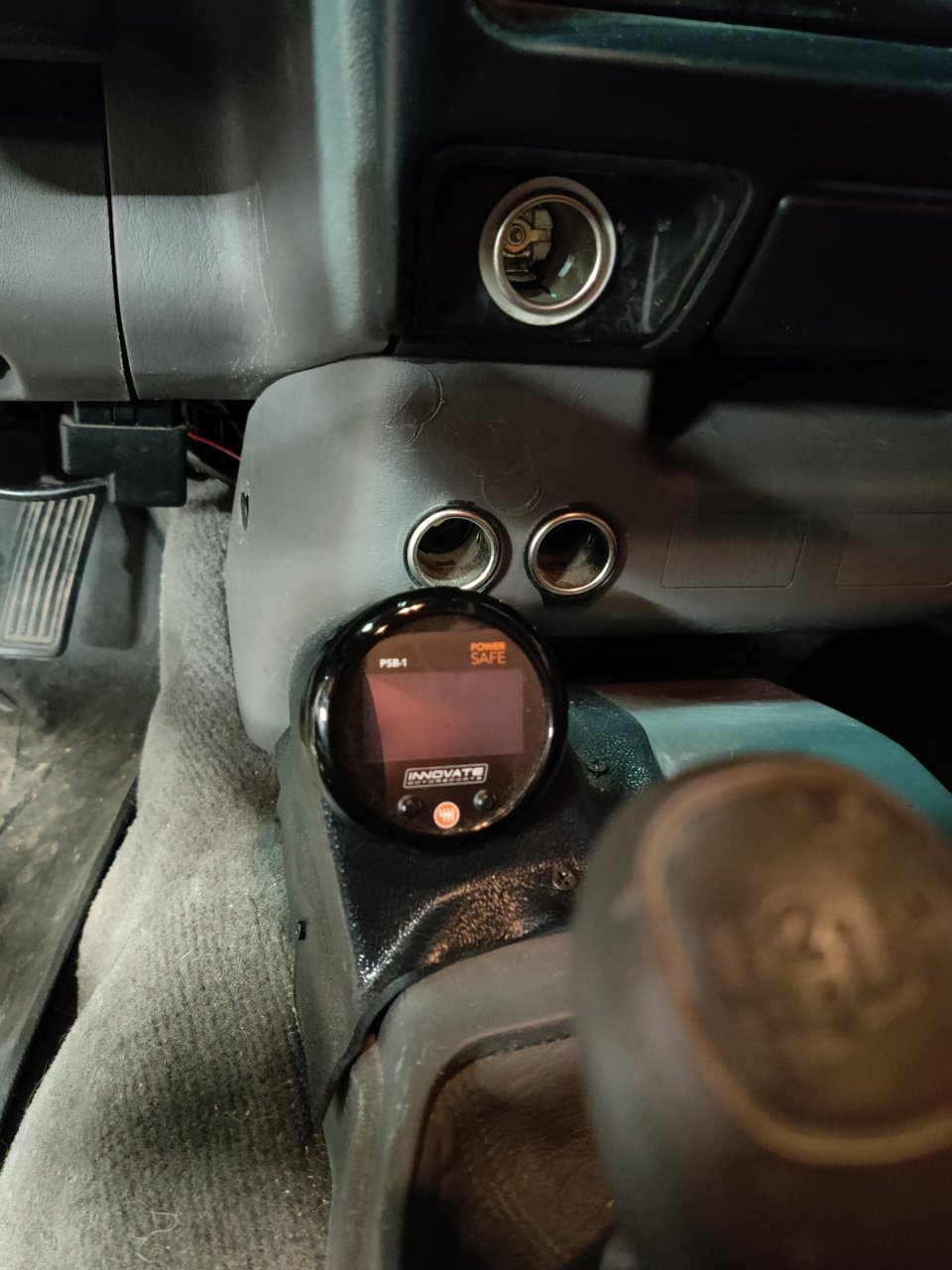

    Have you got a check valve for between the Vacuum Switching Valve and the intake so the VCV doesn't see boost?
    I was going to suggest putting a guage in front of the shift lever but with a manual it looks like there's not enough room.

    I do not.. I didn't give that even two cents. I'll look into doing that.
    That is a good spot! Definitely no room for that with a manual. may just do that kydex deal you got there on the steering column.

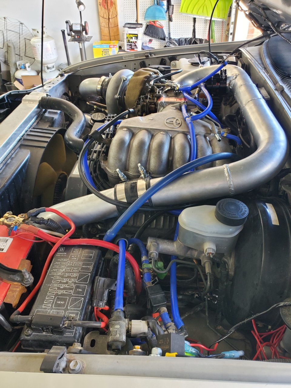

    I used a Dorman 47170 check valve on my EVAP VCV and my power steering idle up. They're like $4 at oriellys. The EVAP canister and power steering vacuum valve haven't exploded from spikes to 15psi so I'd say they work well enough haha.
    This one also fits
    https://www.amazon.com/ACDelco-14047619-Original-Equipment-Control/dp/B000C982H2

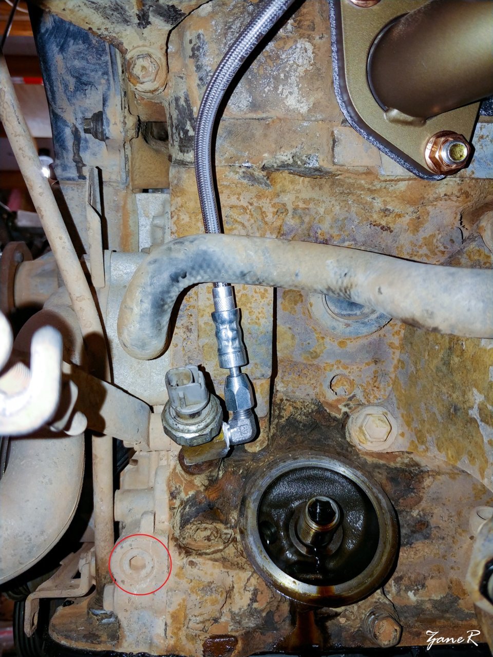

    My oil feed line has a slight leak. Idk what to do besides teflon that thread. It's tight as hell as is.

    What kind of feed are you using? My elbows from the pressure port and into the turbo are NPT to AN, the AN sides never leak but I had to use some Teflon sealing paste on the pipe thread side.
    Can see the white bands of extra paste around the edges of each fitting.

    Mine are NPT no AN. its at the turbo thats got a slight ooze. I'll teflon wrap the bitch to start. Next hardware store trip I'll buy that paste.

    Is the oil pressor sensor port filtered oil?
    ShiftyShank likes this.

    be sure to use the yellow Teflon rated for petrochemicals the white stuff dissolves in long term fuel/oil exposure:thumbsup:

    Yup, there's only one unfiltered oil port I know of and it is this one...

    damn, that's pretty neat. I was going off of old tech knowledge and was curious.
    I've been looking for a turbo feed on my 22R but the oil pressure sender is pre-filter. Probably just run an oil filter sandwich plate so I don't have to tap the block lol
