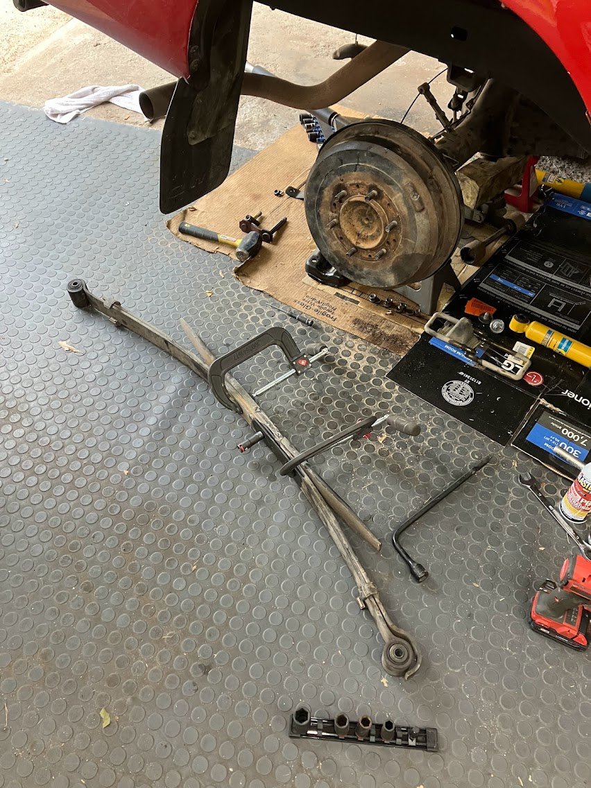

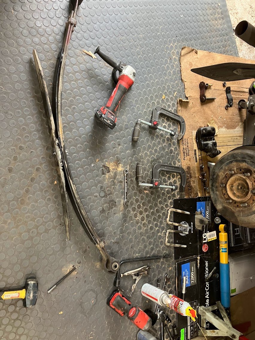

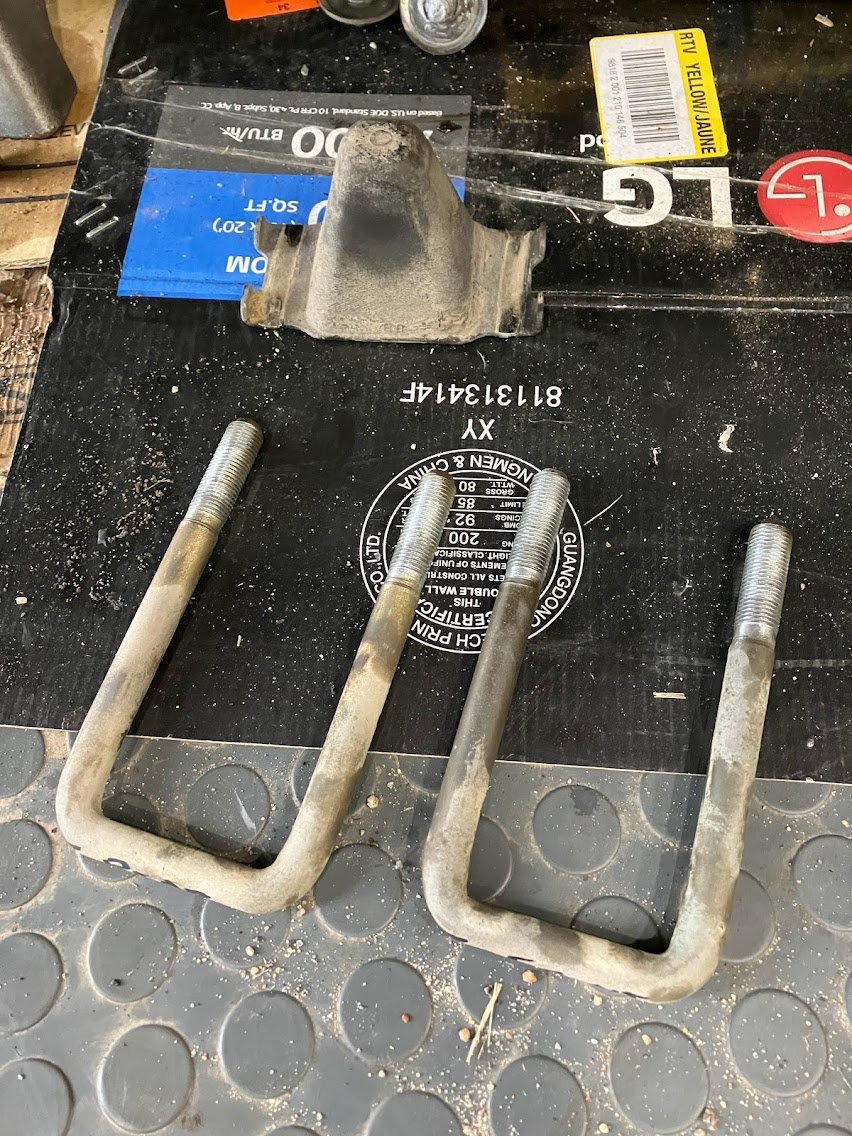

    I installed an Add A Leaf kit. The guidance here and YouTube videos were very helpful and it took a lot less time than the AAL that I put on the 1994 5-lug pickup because the Taco leafs are above the axle.
    Total time was about 5.5 hrs with the first side taking 3hrs.
    thankfully the Cali bolts and frame cooperated greatly with no rust. I torqued the U-bolts to 75 ft-lbs.

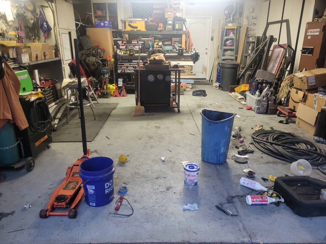

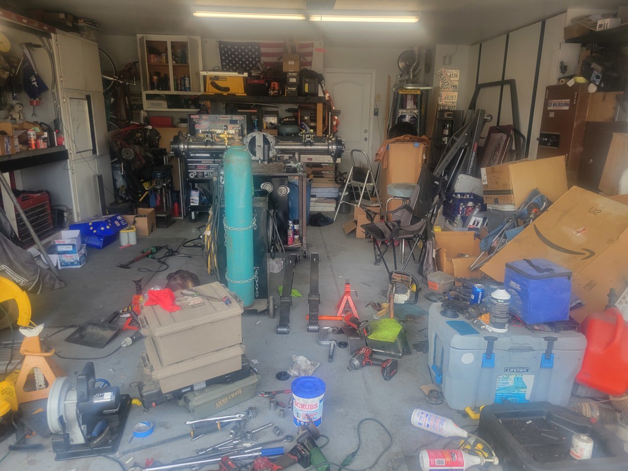

    Spent the weekend cleaning up the disaster that is my garage.

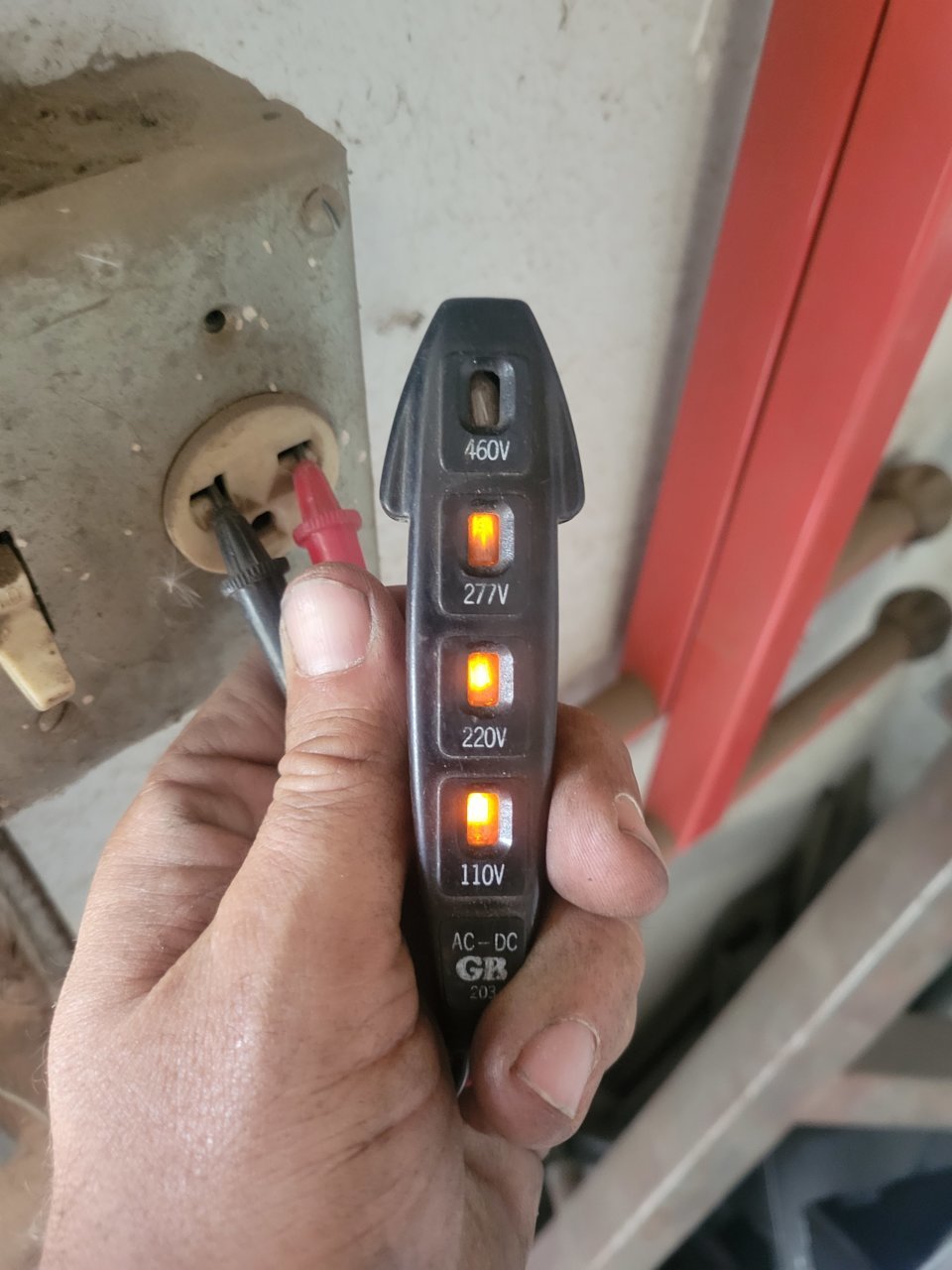

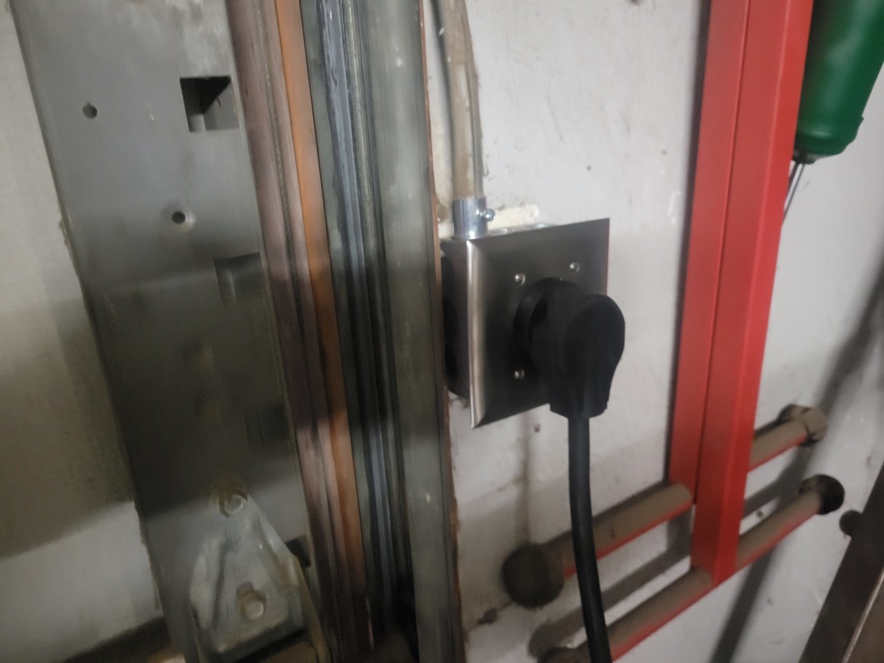

    Decided to finally replace the compressor outlet (from previous home owner) with an outlet I can make better use out of.
    20230930_153217.jpg 20230930_162626.jpg 20230930_185009.jpg 20230930_180559.jpg

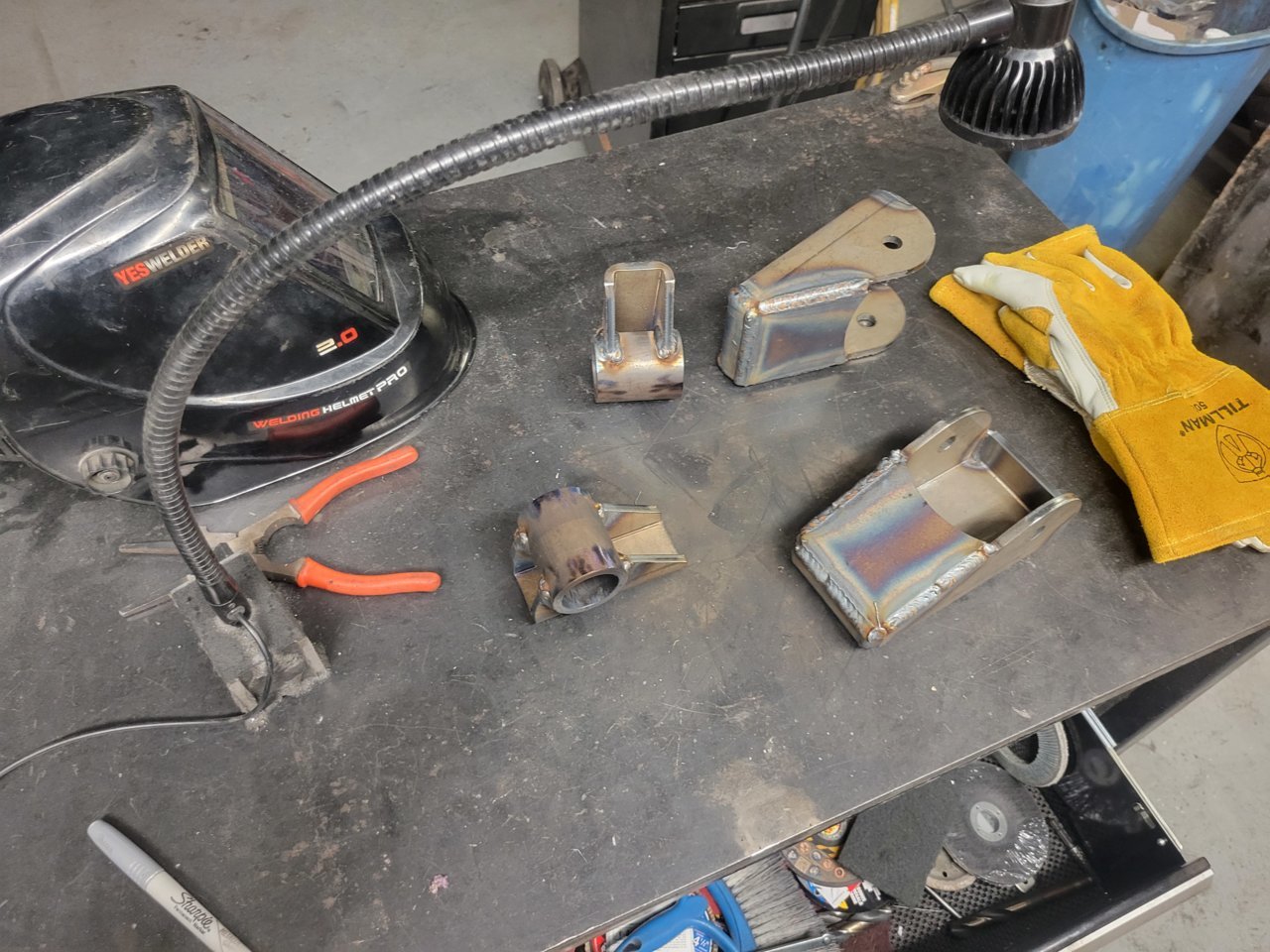

    Put the welder back to work... (Chevy 63 leaf and shackle hangers)

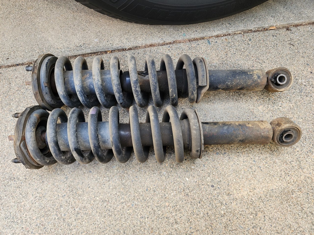

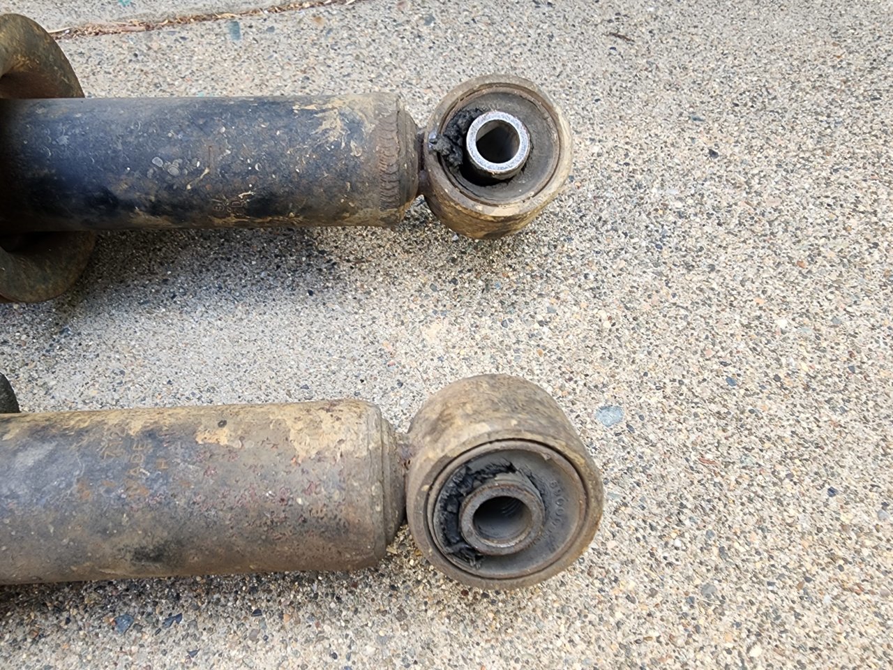

    Pulled my coilovers to replace the struts... well, the struts I have don't work, and the bushings are shot. Truck's on jackstands until Wednesday, at least.20231001_155934.jpg 20231001_155939.jpg
    Good news is, everything about these was junk. Should ride much better. Hoping the springs are stock...
    Also planning to do a fuel filter replacement and swap out my aftermarket injectors with new OEM while it's just sitting there.

    The pics actually make me feel better about what I'd been seeing before I pulled them... thought those were stock yellow and blue bilsteins until I pulled them. The yellow look is just rust and dirt I think :rofl:

    My garage looks identical at the moment. :anonymous:

    I just have way too much shit. At least it's relatively clear now. I'm going to have to tarp the cherry picker and 20 ton press and roll them outside so I can get the truck in at an angle. Once I get everything torn off the truck, I need it in the garage so weather doesn't slow the work.
