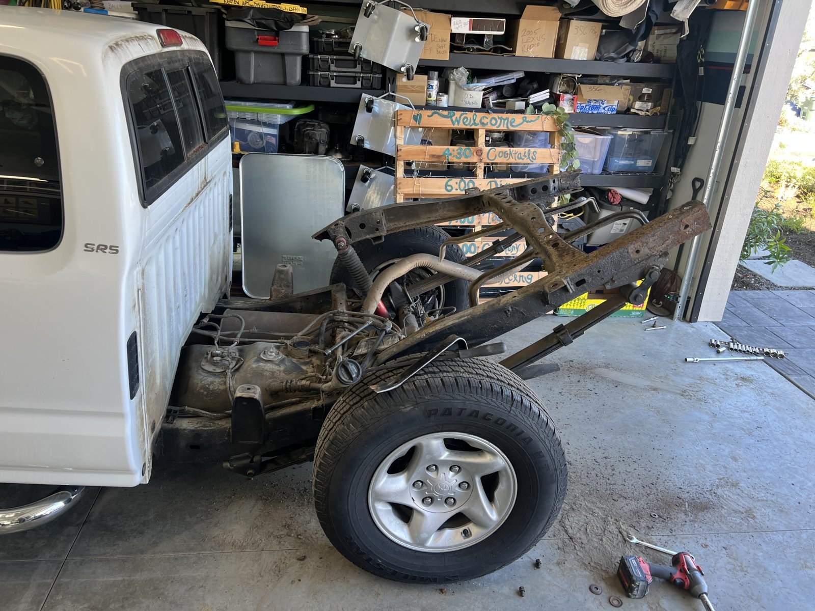

    IMG_0968.jpg Not mine, but getting into it helping a buddy with a frame swap.
    We’re probably 24hrs in, both of us with a couple 6 hr days average. Gotta disconnect the fuel lines from under the cab and a bit more wiring then the cab can come off.
    Figure the rest will go smooth once the cab is removed- drop the fuel tank, pull the suspension, engine/trans/case, put it all back together.

    would you like the frame swap instructions? i have them handy

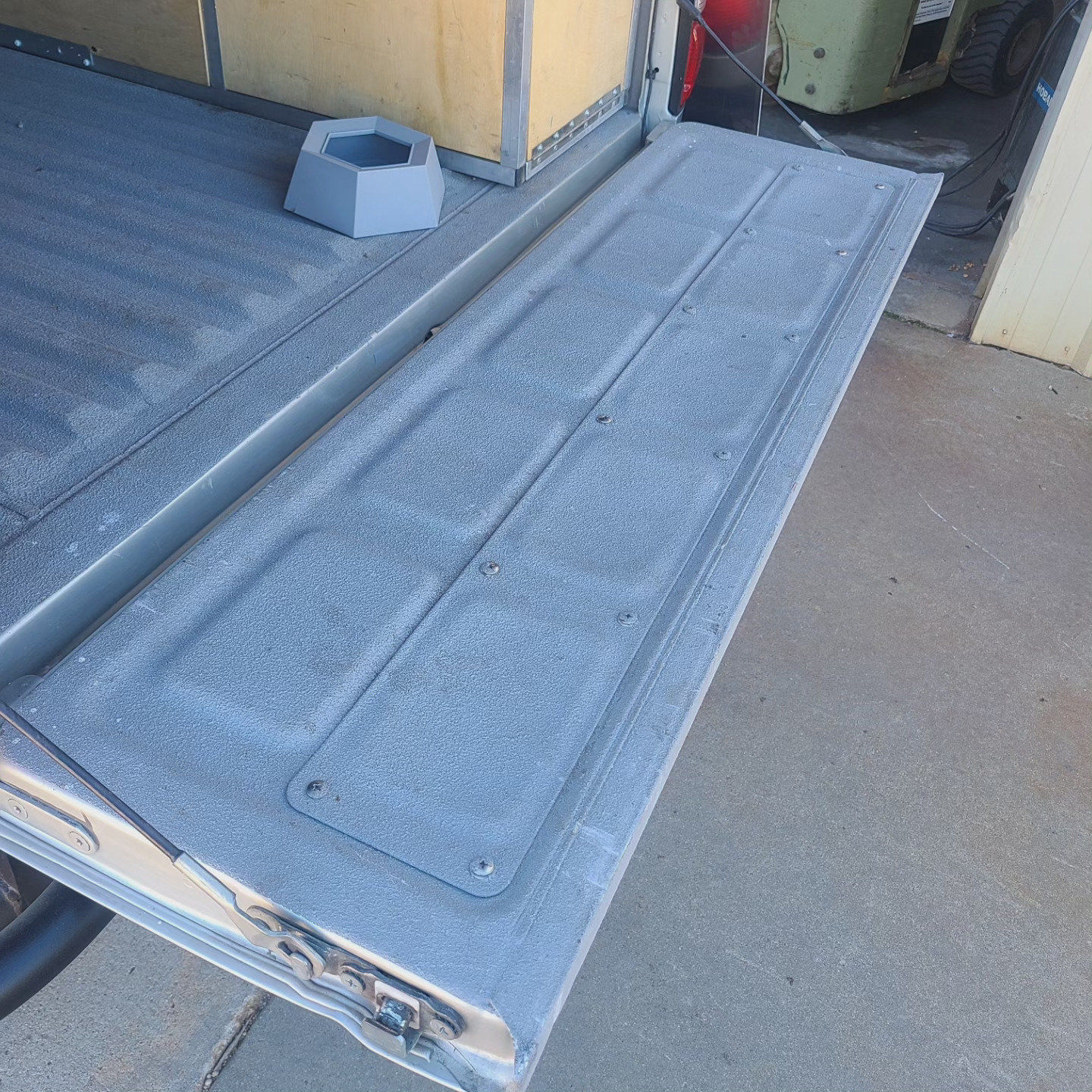

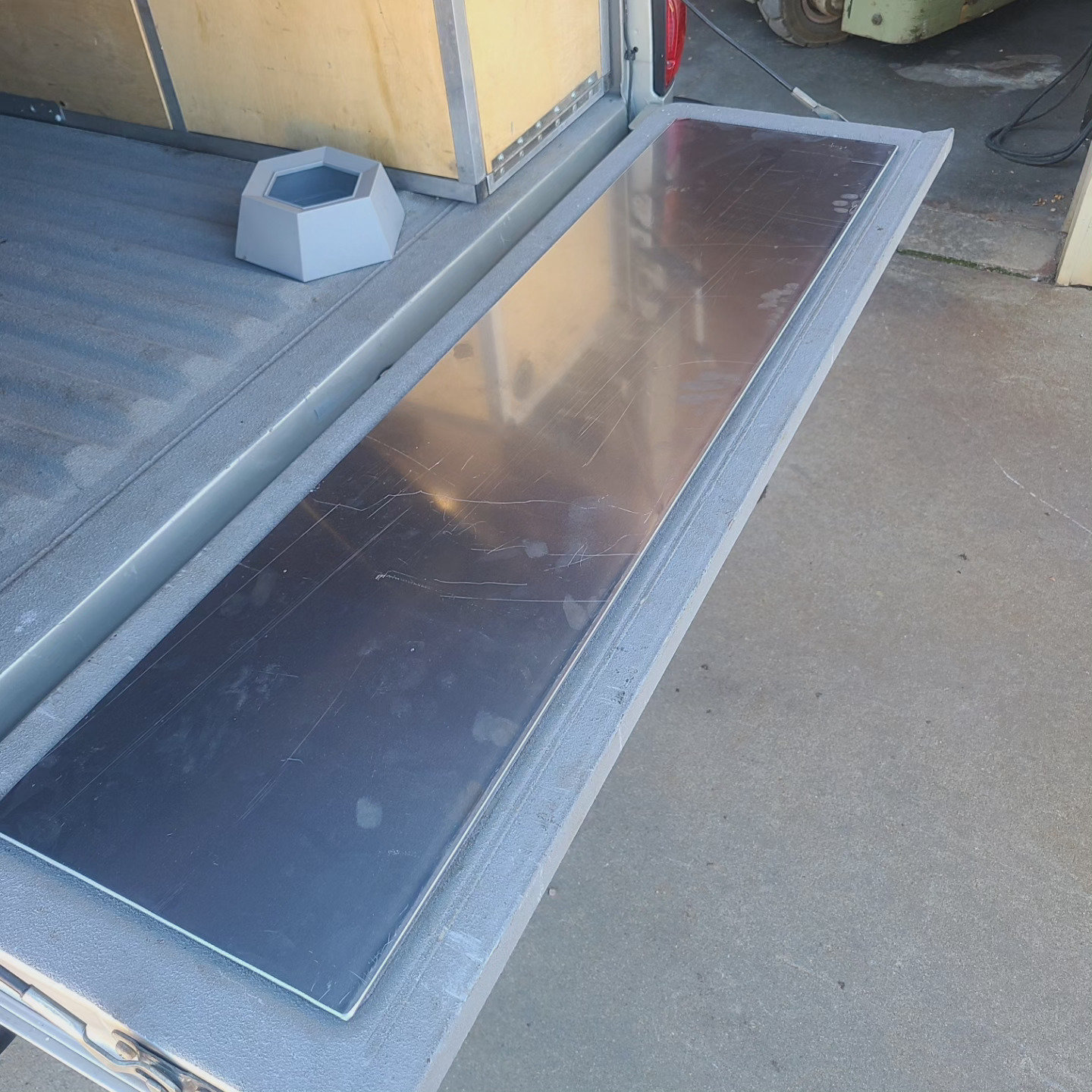

    Added a sheet of aluminum to make the tailgate smooth now. The lumpy one didn't feel the best on the knees, and it was sometimes difficult to situate things on because they would be uneven.

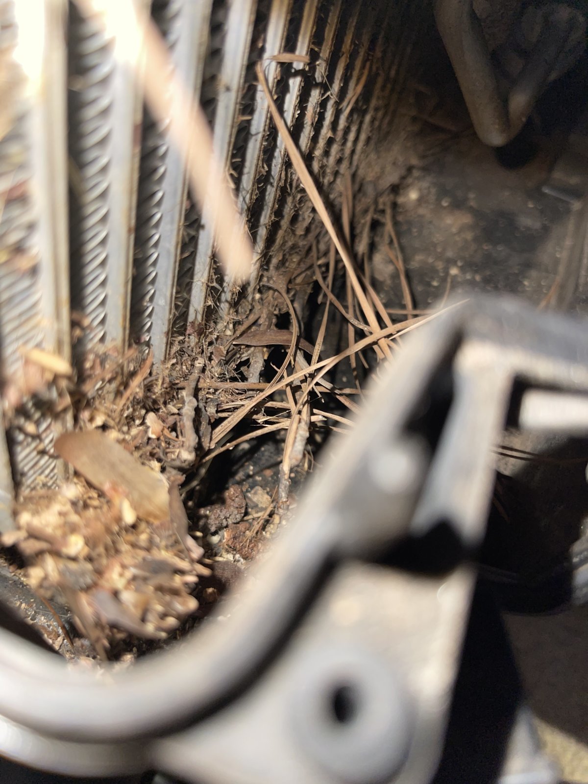

    Cleaned out the AC.

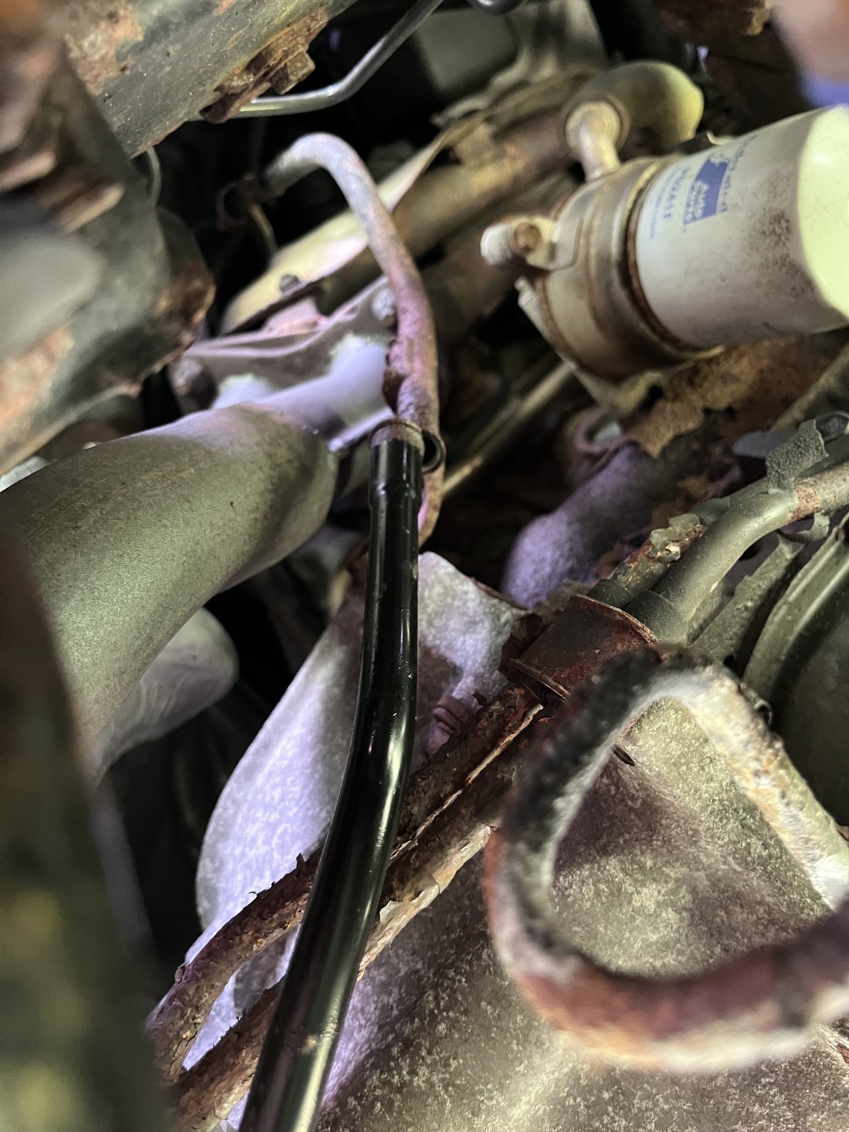

    Keeping it running
    Saw some drips, found the transmission filler tube assembly is broken where it joins together…

    Didn’t want to install flush mounted countersunk head fasteners? Or are this on order? whatever you put on there can sit even- like you wanted since the heads do not sit up past the surface

    Yeah Ill likely order these next. I just used the screws that came with it to get it back on, but the counter sunk ones will be next.

    Did you have that made or can you buy them ready to go?

    I made it out of aluminum from a shop. Conveniently it measures 12" x 48" so that might be something easily available to get from a local metal shop (*its not a strange dimension like 13 x 51), then you just have to match up the screw holes from the other panel that was removed.

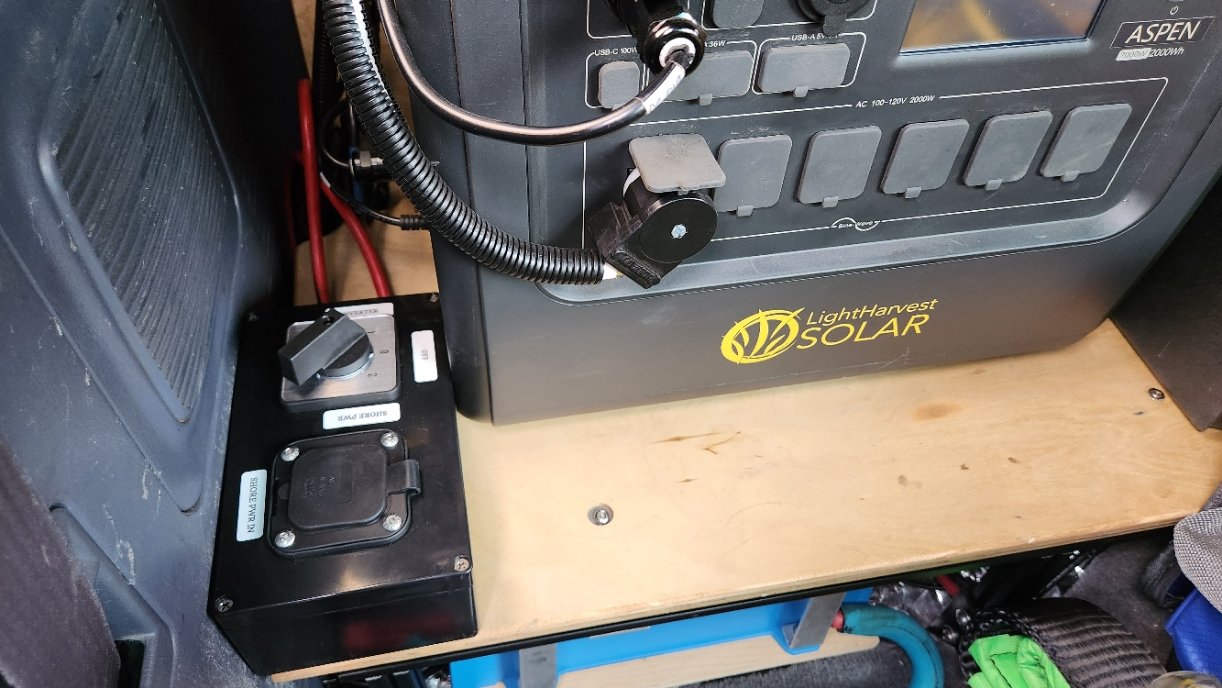

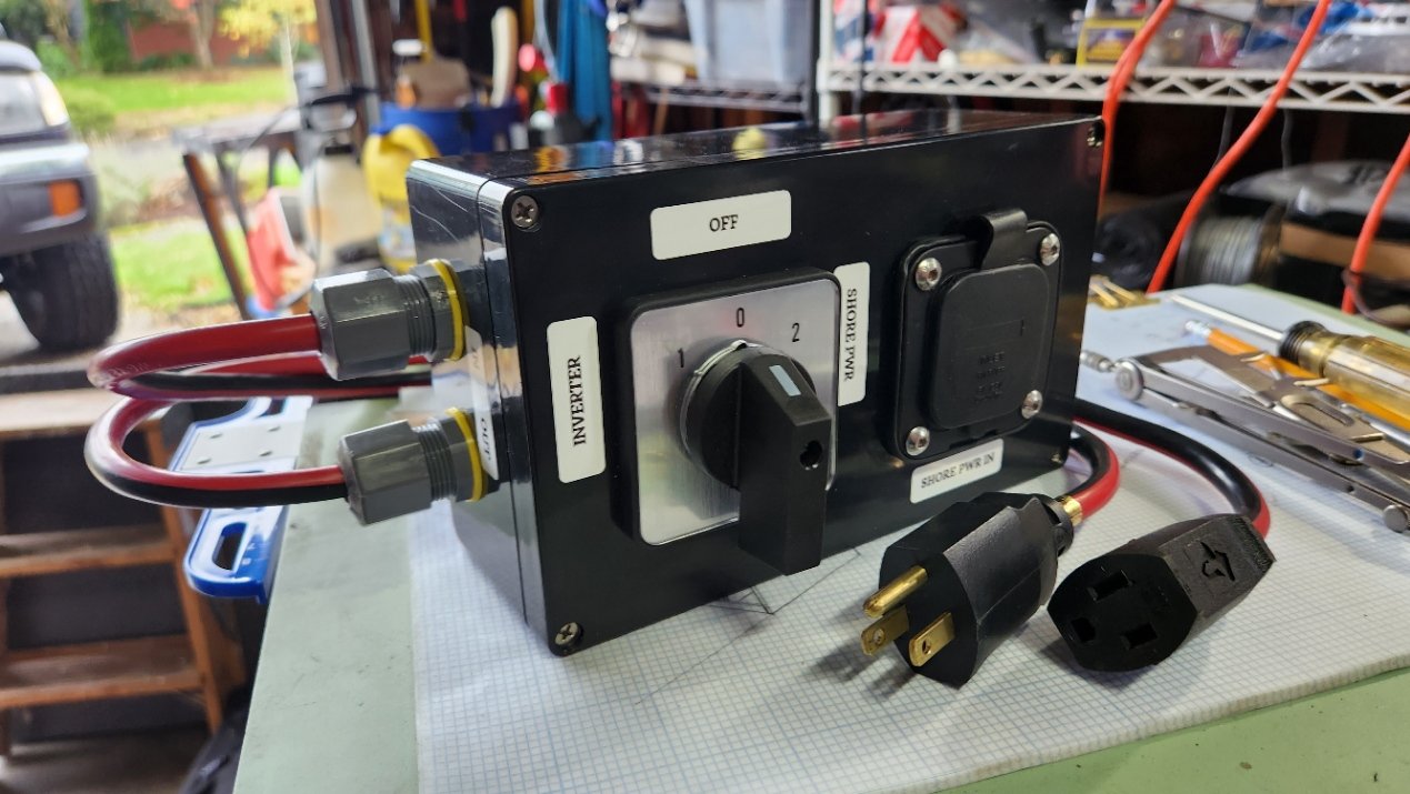

    Been on the list since I installed my camper electrical, so finally came up with a solution to be able to switch between vehicle inverter and shore power to feed into the AC adapter for charging my solar power station.
    I am using a 3-position (1-off-2) rotary switch to select which power source to use. Now instead of unplugging and plugging in the AC adapter (kind of a pain), I can just plug the shore power cord in and flip the switch.
    Should make swapping power sources so much nicer now.
