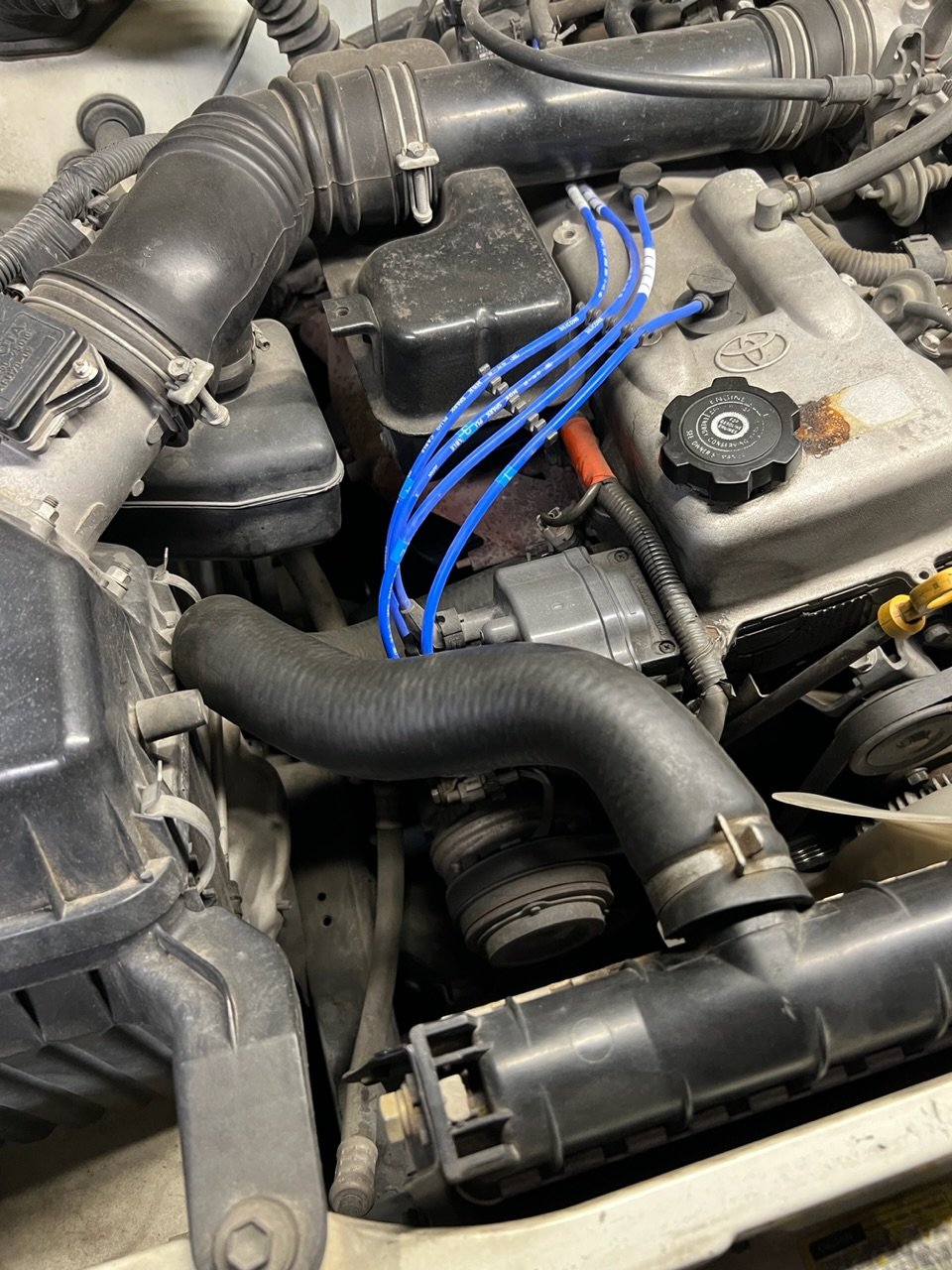

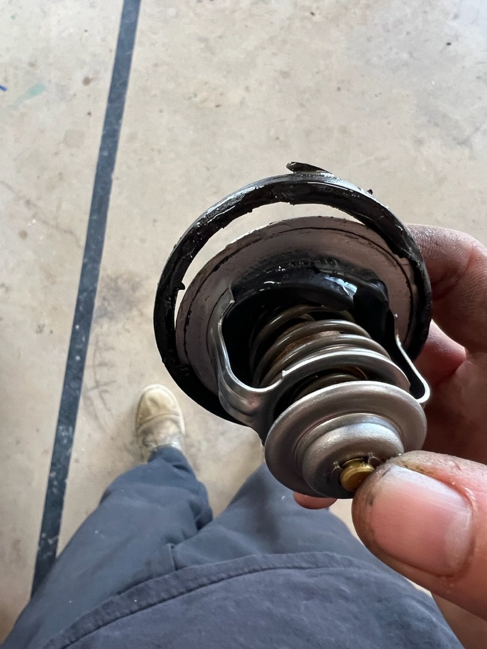

    IMG_6587.jpg New-Rad hoses-thermostat-coolant reservoir- and a full system flush on my 293k 95.5 5speed/lug Taco.
    MY Taco has been in my possession for almost or just over a year now. It was a straight work horse its entire life and was only given the care it absolutely needed!(she was my brother work truck that never let him down) Not any more! She’s getting some major TLC from here on out, going from work horse to straight cruiser.
    Noticed my upper rad hose was swollen and upon further inspection I found a few rubber pieces floating right at the rad cap. I know my brother had done some coolant system work when he owned it and knew he and a friend had to get it done in a short time frame(it was his only vehicle at the time) assuming something’s were rushed when the job was done at that time, I knew I had to dig in a bit for myself and see what I would find. Now after 293k of hard work I knew I’d find some surprises, but this good old Toco wouldn’t skip a beat even when it wasn’t in optimal order!! (The Toyota way!) my brother did inform me that they did use a bleeder vacuum to bleed the system last time which in result most likely ended up causing the issue I located which was a severely blown out thermostat/gasket as you can see in the pictures.
    Once the system had been flushed, I popped in a new thermostat, hoses, res tank, and good old Toyota red coolant/distilled water, let the truck run with the heat full blast for a good 30 mins to insure proper temps were reached, stat opened and bam, complete. I’m definitely one to be a bit ocd with my vehicles so without a daily inspection of motor bay and under carriage I may not have caught this and something worse may have occurred. Pays off to pop the hood and look under the vehicles no doubt, “lol even if my lady thinks I’m crazy at times ” Hope everyone has a great Tuesday and thanks for the read.

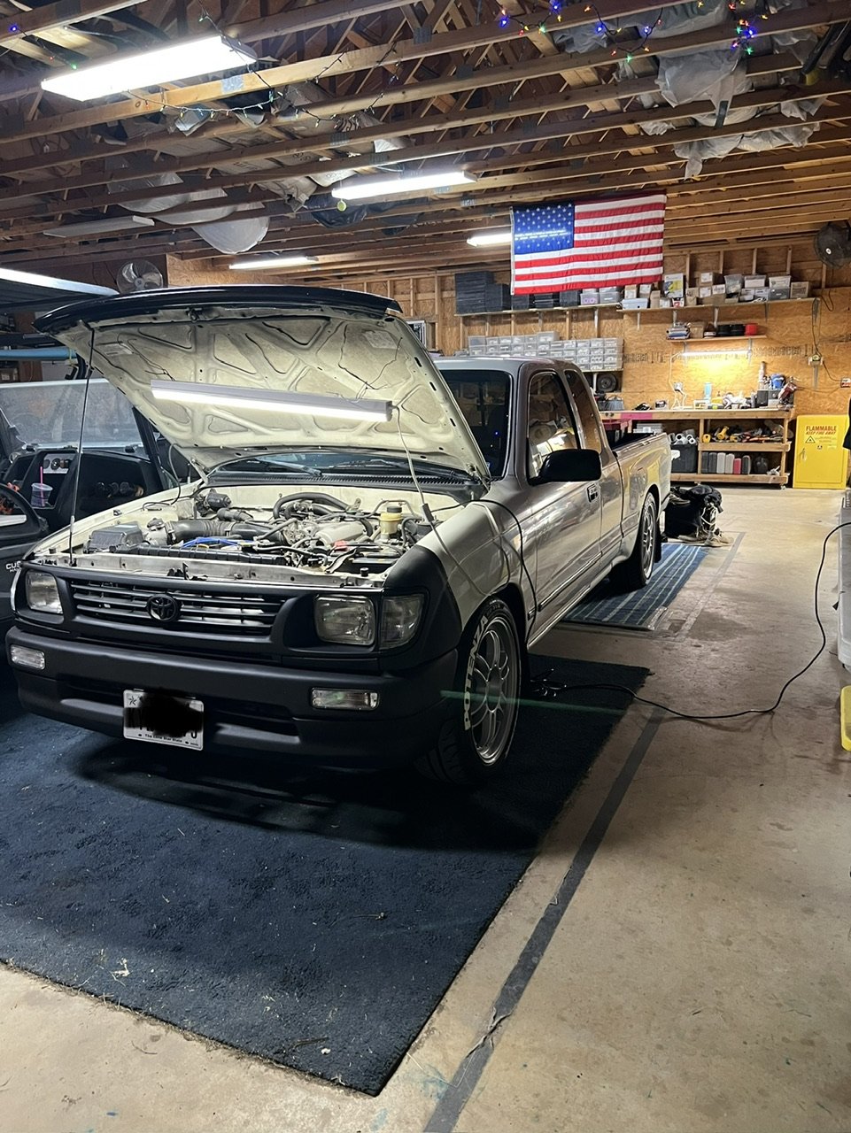

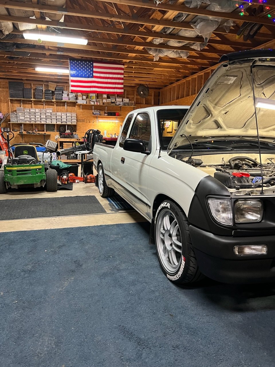

    Your garage looks like heaven

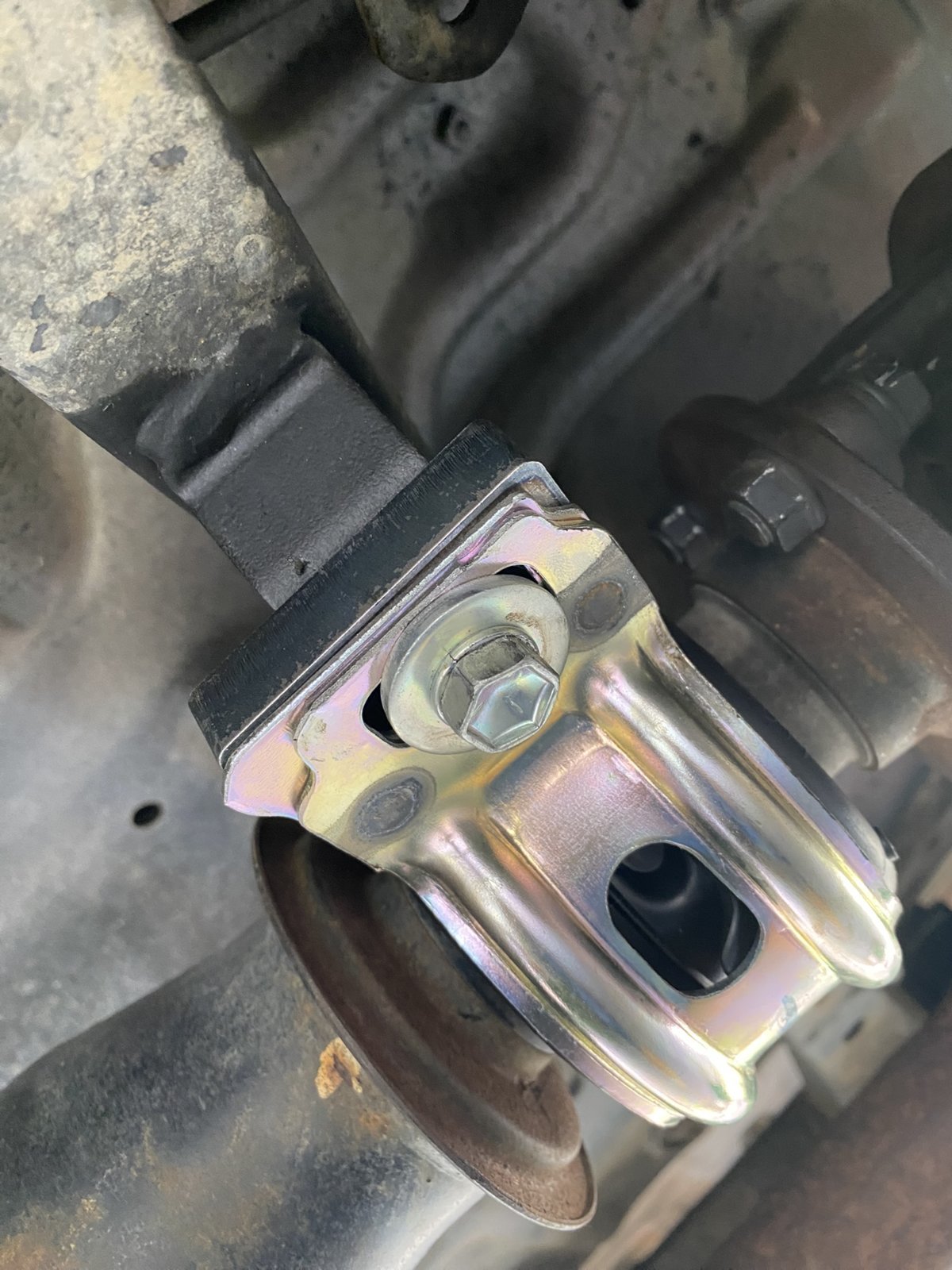

    Here I was wondering the last month what that weird clunking was in my front suspension. Good thing I went out to grease zerks today. Also put a carrier drop in have yet to test it out to see if it helps with the vibes.

    Much thanks, it’s been many years in the making. You’re seeing the best version of it yet. Considered my home away from home!
