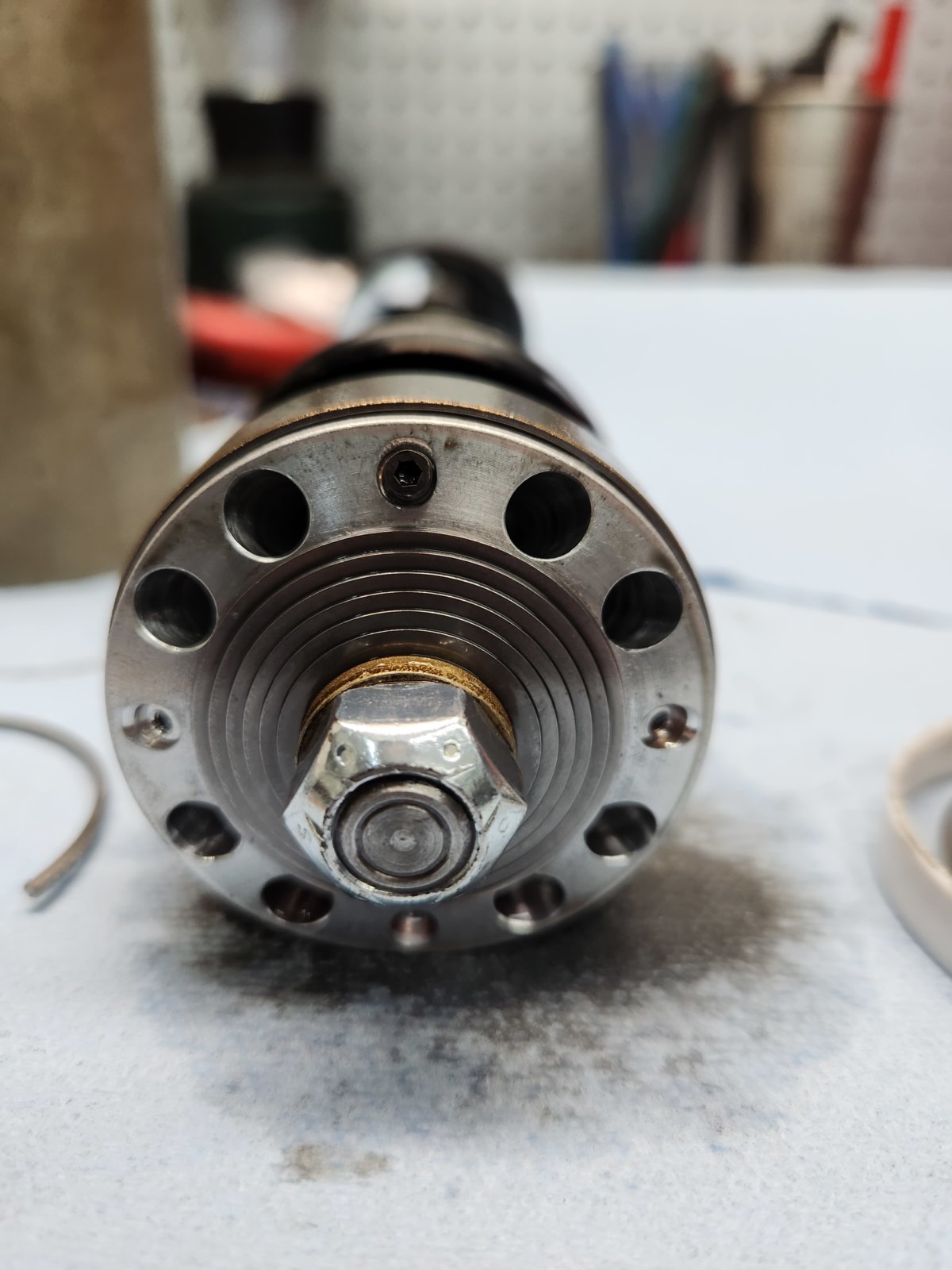

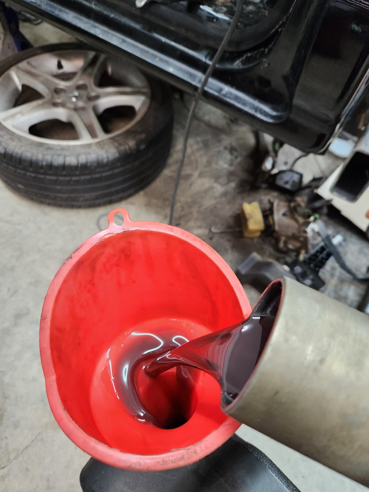

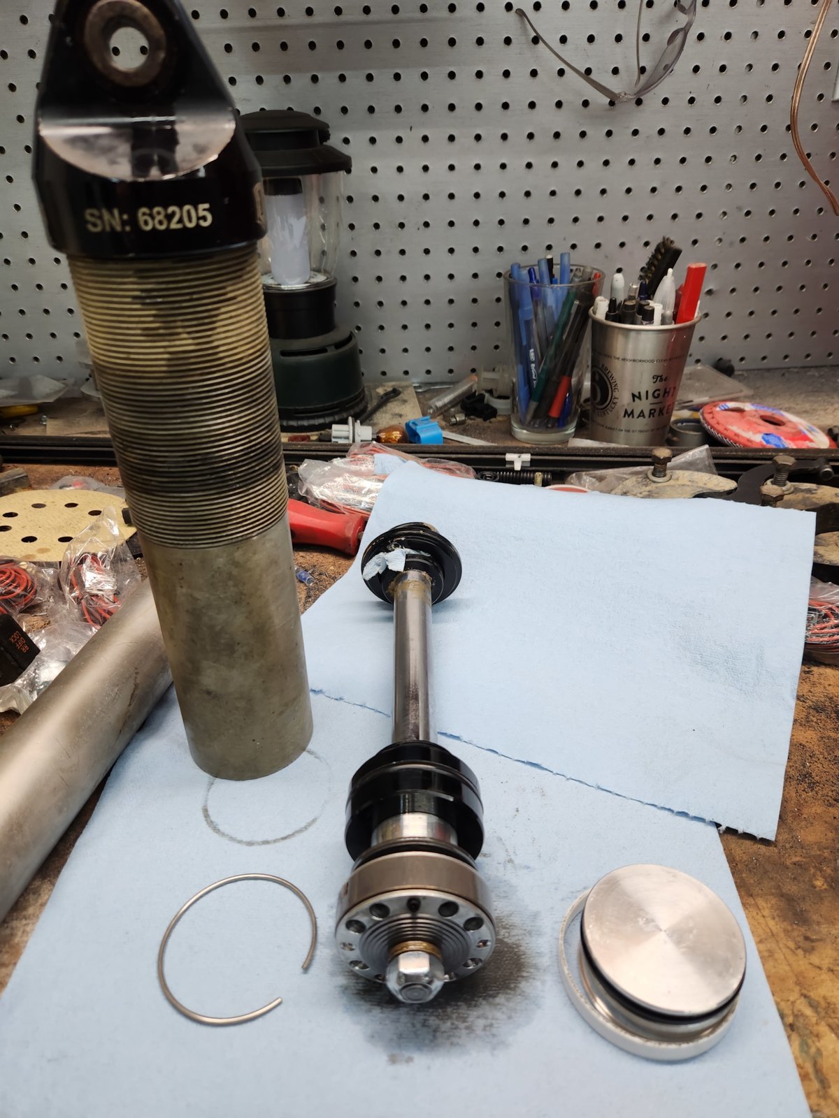

    Oil showed up today so I rebuilt the shocks after work.
    I was going to change valving again, increase rebound a little, decrease low speed compression (again), but instead I am just going to pull the last bleed screw and see how that feels.
    I did increase preload on the rebound shims some... Replaced the .08 with a .06.
    The main seal and wiper were a little beat up, probably not keeping the shaft clean. One of the shocks had good looking oil, the other did not and definitely had low air pressure.

    Shock tuning is another thing I'd like to learn.
    I just take them apart, change the wear items and oil, and put them back together :rofl:

    Read a lot of stuff, then change no more than 2 shims at a time!

    That's basically the process of learning to do it. Only done it twice and learned a ton about achieving the feel I want. You get really fast at taking them apart and putting them back together with your changes.

    Now that I have all the right tools to do it. I'm actually not that slow at rebuilding them.
    The problem is, shit like that I tend to over think and make adjustments. I could totally see myself adjusting it back and forth, from almost the same set up, in an endless loop. :rofl:

    I mean you have to know what you're feeling and that can be difficult to begin with. You might think you know what a compression change feels like or when rebound comes into play but I'd bet you'd only be partially right. Once you have a feel for what changes what you can get pretty close to what you want rather quick. There is no "perfect" with single front or single rear (per side) shock systems. But you can get very close and even closer with bypasses when it comes to the rear. As long as you know when to stop chasing perfection, you'll hit a point where your changes to one area start to become a detriment to others.
    The spring handles the weight and the shock controls the spring, keep that in mind and it all becomes a lot easier to think about.
