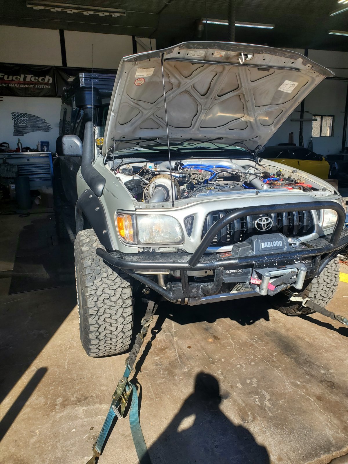

  14. Oct 20, 2023 at 6:33 PM
    El Taco Diablo
    El Taco Diablo Professional Pinstriper
    Nov 6, 2017
    #235223
    13,971
    Matt - KN6DZP
    Hughson, CA
    Impulse Red DC, 5vz-fe, 4wd swap, LT, dual case, F/R locked
    Just 3 tons of fun!!!
    Rear facing winch is mounted.

  19. Oct 20, 2023 at 9:37 PM
    ShiftyShank
    ShiftyShank Oof
    Sep 11, 2019
    #304986
    1,260
    Pat
    Northern Colorado
    02' BestGen 5VZFET
    That winch is buried mighty deep... why? No shit talk. Interested.
  20. Oct 20, 2023 at 9:56 PM
    El Taco Diablo
    Nov 6, 2017
    #235223
    13,971
    Matt - KN6DZP
    Hughson, CA
    To get under the bed, the winch has to be about 2 inches lower than the bumper. Moving it back makes a better line angle.
    Also being between the shackles make it less likely it gets hit. Way out by the bumper, I'd come down on it coming off a shelf.
