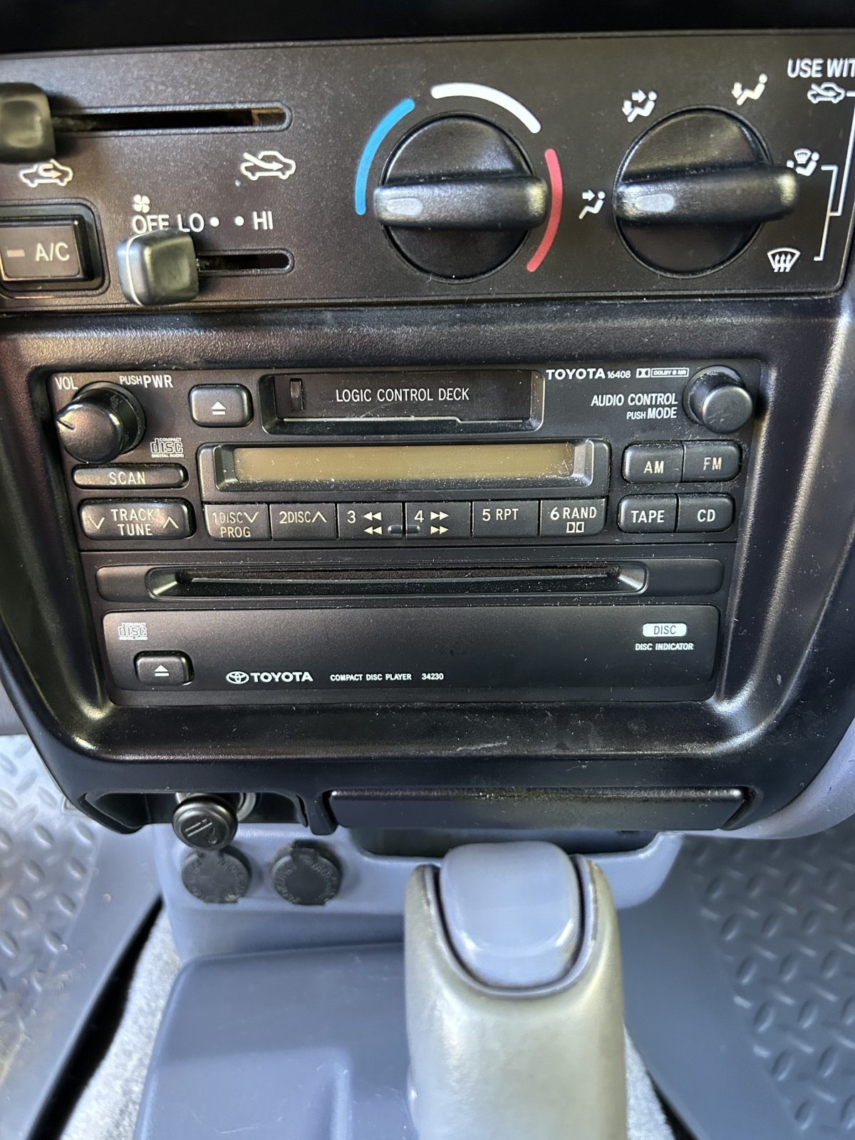

    I’m a purist but needed some tunes better than the stock AM-FM cassette player that came with the truck. I found and bought an NOS CD player and installed it today.

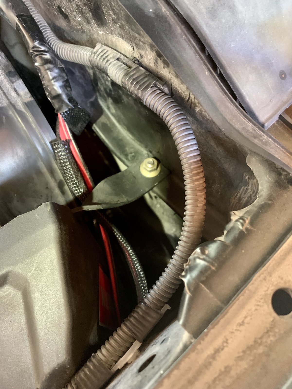

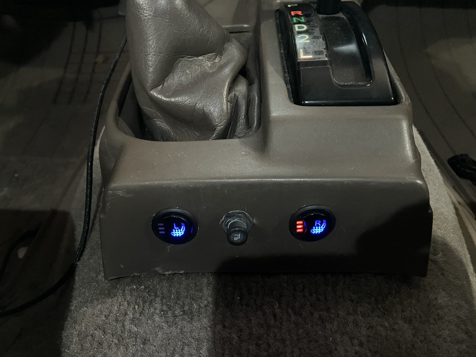

    Finished the wiring for the heated seats today. The passenger seat is done and the driver seat will be dropped off next week for leather and heated seat inserts.
    7.5 amp circuit breaker for good measure.

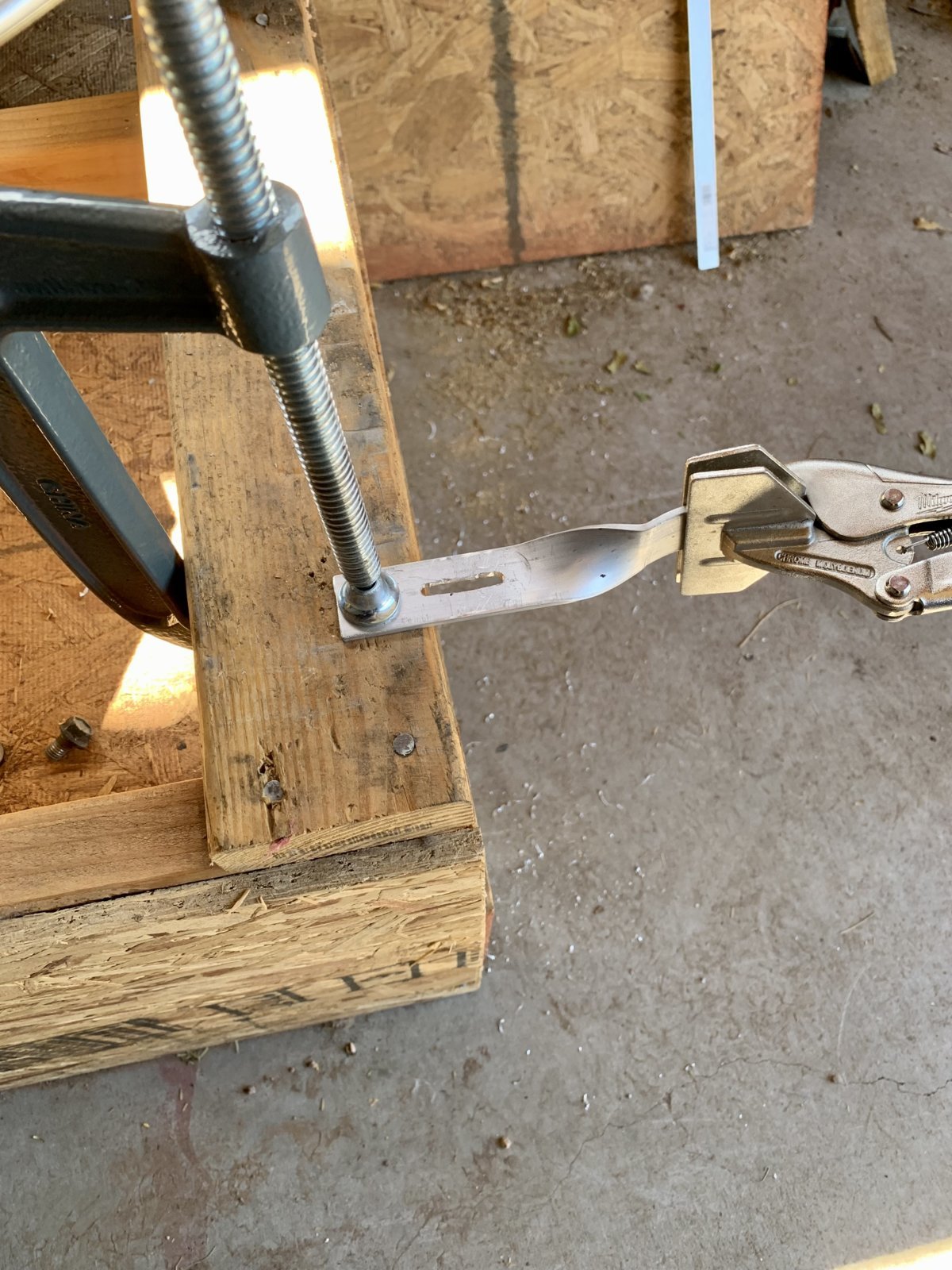

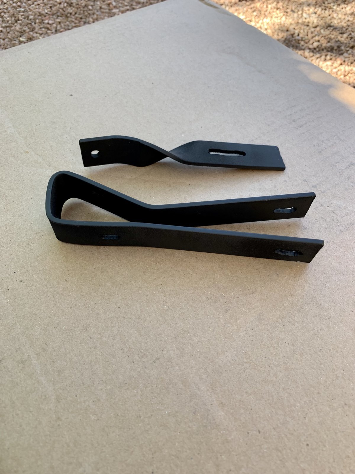

    Finally got around to relocating my winch controller. Made a couple custom brackets out of aluminum bar. I don’t have a metal brake or a vise so had to make due with a c clamp and some locking seamers.

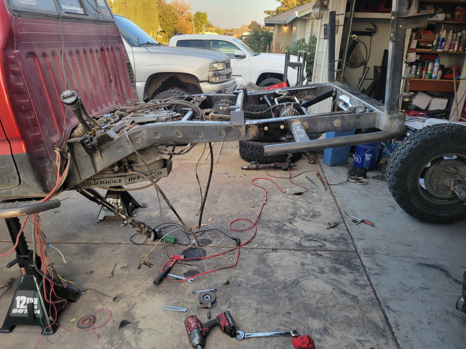

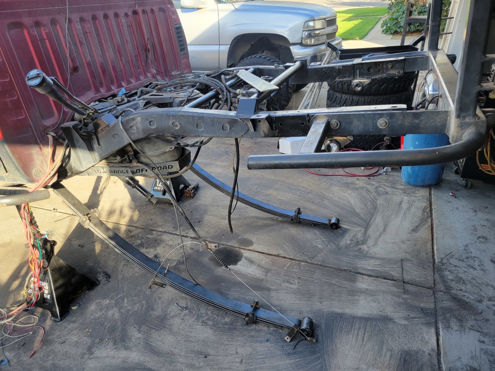

    All of the old leaf perches are cut out. New rear leaf perches are tacked (tacked well) Leafs are half in.
    Left the rear perches tacked in case I need to move them front/back to get the right shackle angle.
