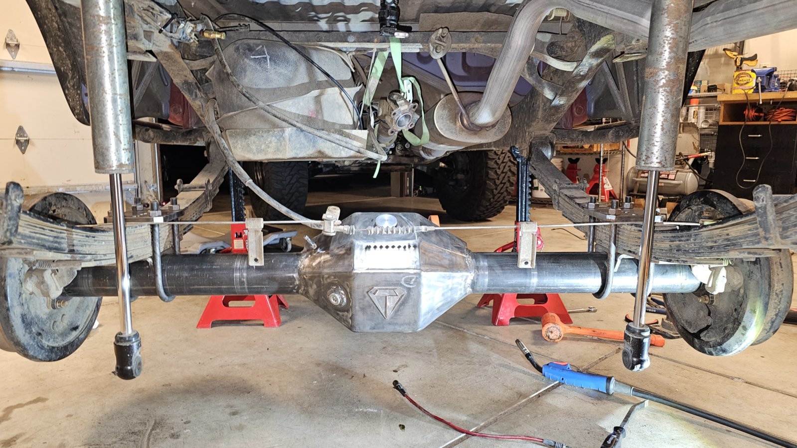

    It's about damn time you throw that under the truck haha
    Sounds like a plan! I'm undecided on spindles since the Solo Motorsports kit looks bitchen, but rumor has it that MCM Fab has a 4WD race kit in the works, so I might wait and see what he comes out with first.

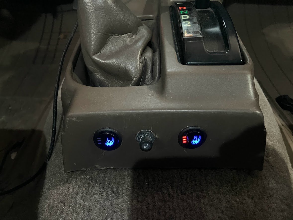

    I found "key on" power in an unused connector dangling under the radio stack. The heaters in my 1994 pickup can both be on high and the 7.5 amp CB does not pop, whereas the 5 amp CB did pop with both heaters on high.
    I did not find a relay and wiring to my battery was necessary. The seat heater wiring harness that I bought also came with a Blue 15 amp fuse. I opted to use a CB for ease of resetting if needed.
    Here is the kit I recently ordered for my Taco
    https://www.ebay.com/itm/195958565680
    It has three levels which is an upgrade from the usual two level offerings and the switches have embedded illumination for night ops.
    It appears that the current link offering has rolling switches. When I bought the kit a few weeks ago it came with the 3-level switches pictured below.
    The power rating of a similar pad is listed at:
    DC 12V, 24-36W /Pad
    so, just about 2-3 amps per pad at 14V DC, I'll report back if I need to move to a 10 amp CB with both seats on high.
