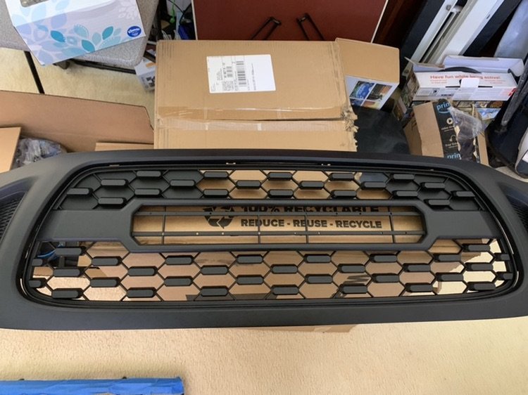

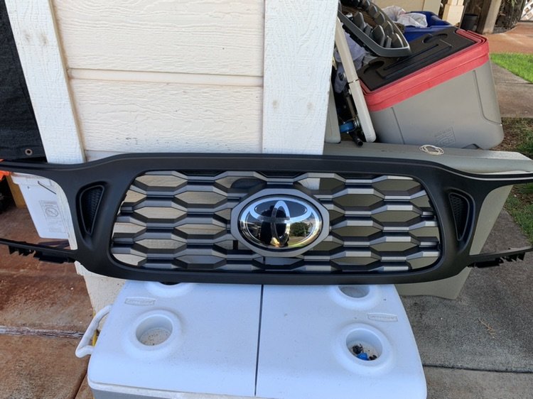

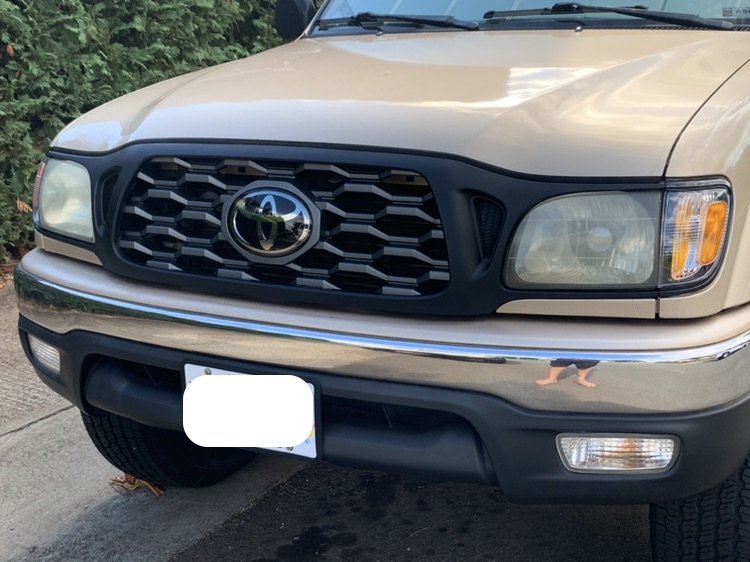

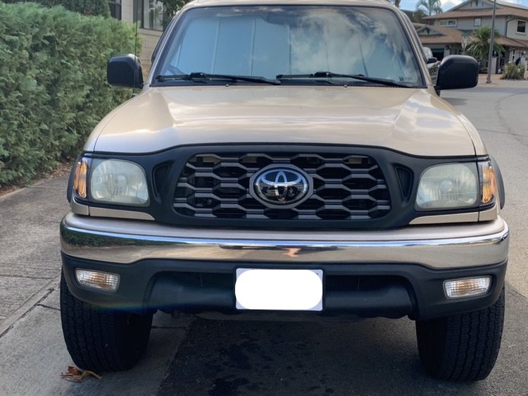

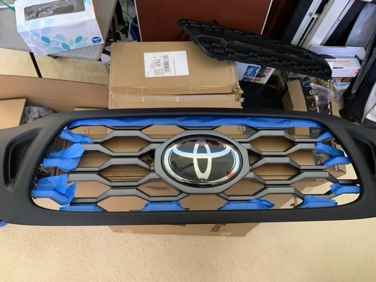

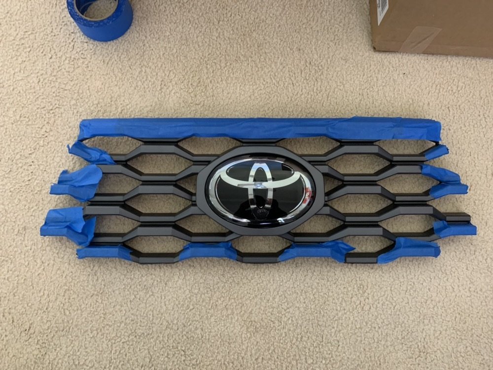

    Purchased a Pro Style Grille. But I wasn't very happy with it.
    So I decided to convert it with a 2022 Tacoma grill I saw another member here that did this and I kind of liked it.Now the problem is that it makes my headlight look like crap!
    Well time to order a new set of lights!

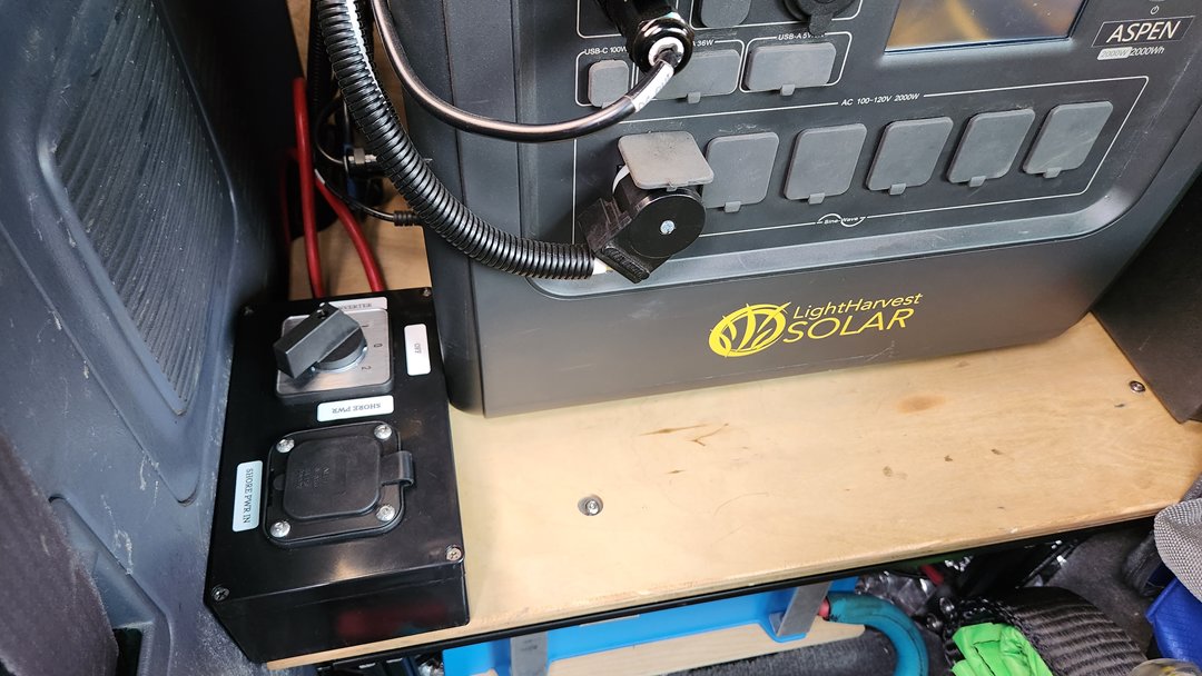

    I would like to learn more about your distribution box. Any build pictures?

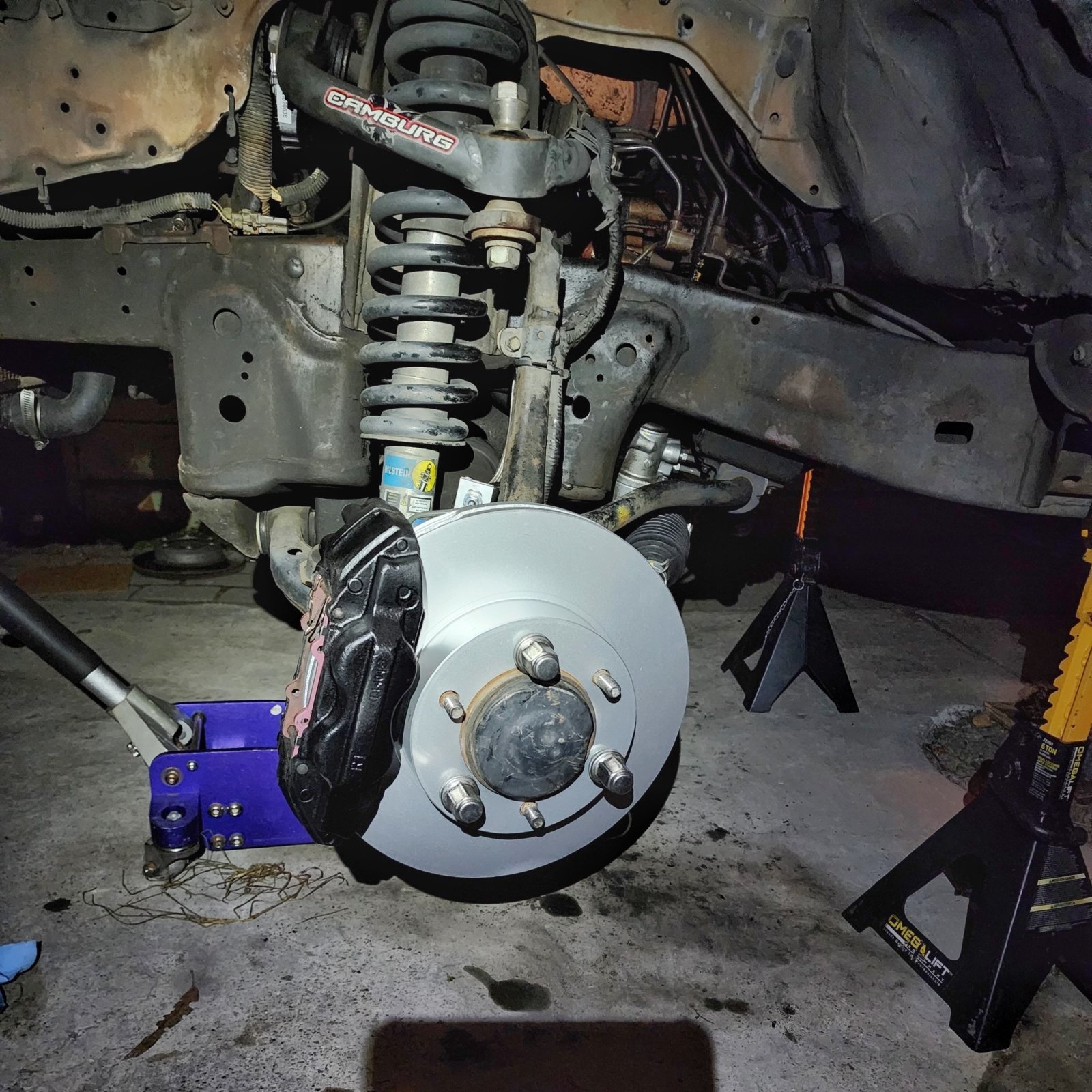

    Upgraded the brakes, Tundra swap. Found some 13WLs at a boneyard, which I rebuilt and painted, went with Bosch rotors because Amazon Prime discount and shipping saved me many $$. Also went with the Tacoma-to-Tundra Hard Brake Line Upgrade Kit from Adventure Taco. Pretty easy swap overall, even rebuilding the calipers was straight forward.

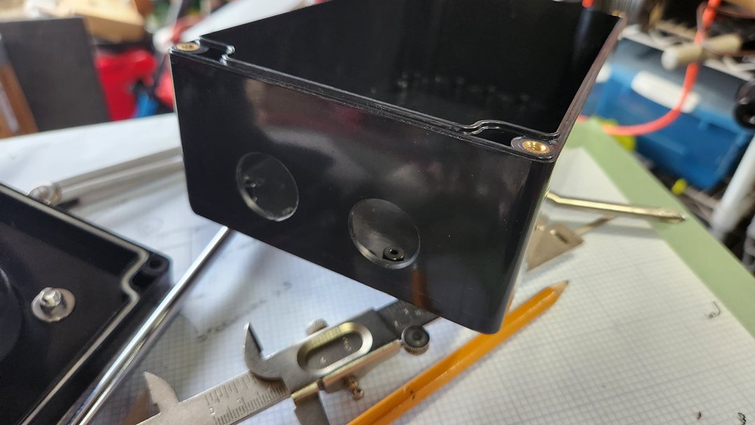

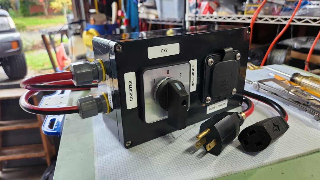

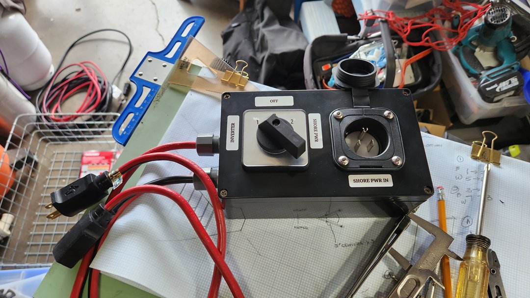

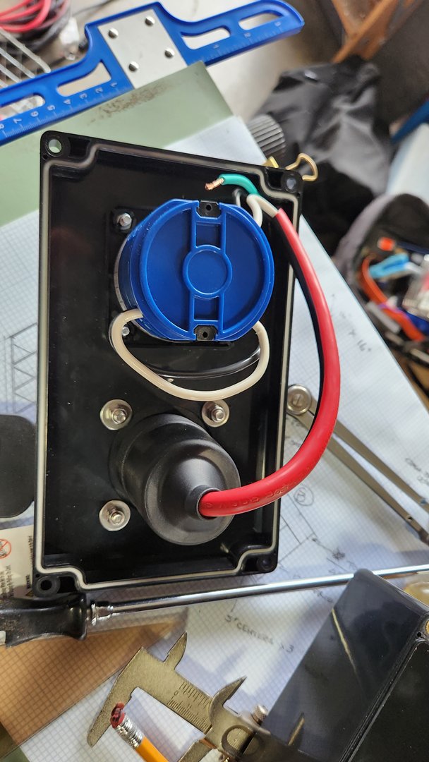

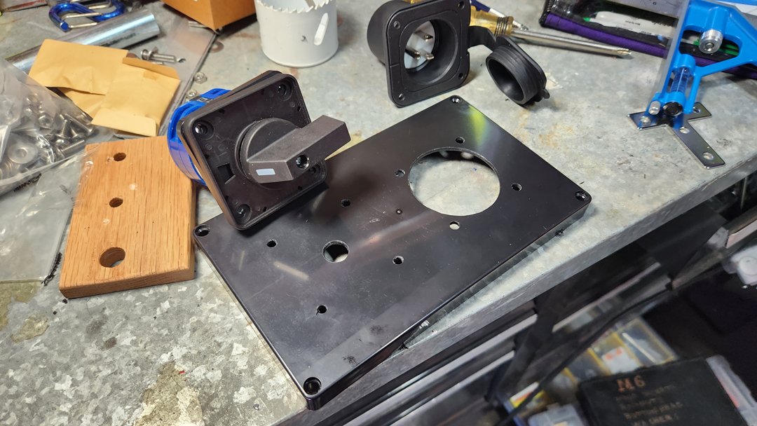

    Hi!
    Parts:
    The switch has 8 poles which allowed me to wire up a "2-in, 1-out" arrangement. To make it work, The actual 2-out are connected via jumper wires.
    I bought the project box after receiving and measuring the switch and inlet. After figuring out the component locations, I then drilled the side holes which would be for the inverter-in and power-out cables.
    I have a simple, cheap label printer so I decided to add specific switch position identifiers.
    The common output goes to the charger adapter for my power station. The the input plugs into the AC out of the inverter.
    Let me know if you have any questions.

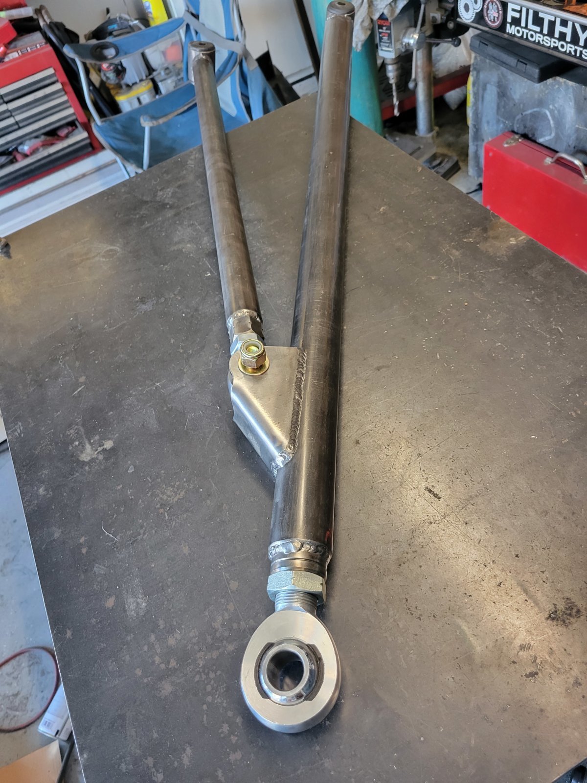

    Ready for paint

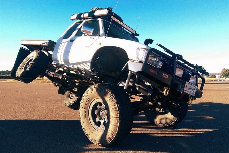

    One of the best mods I did on my old Hilux after I went with a rear locker, 63" springs and 37" tires.

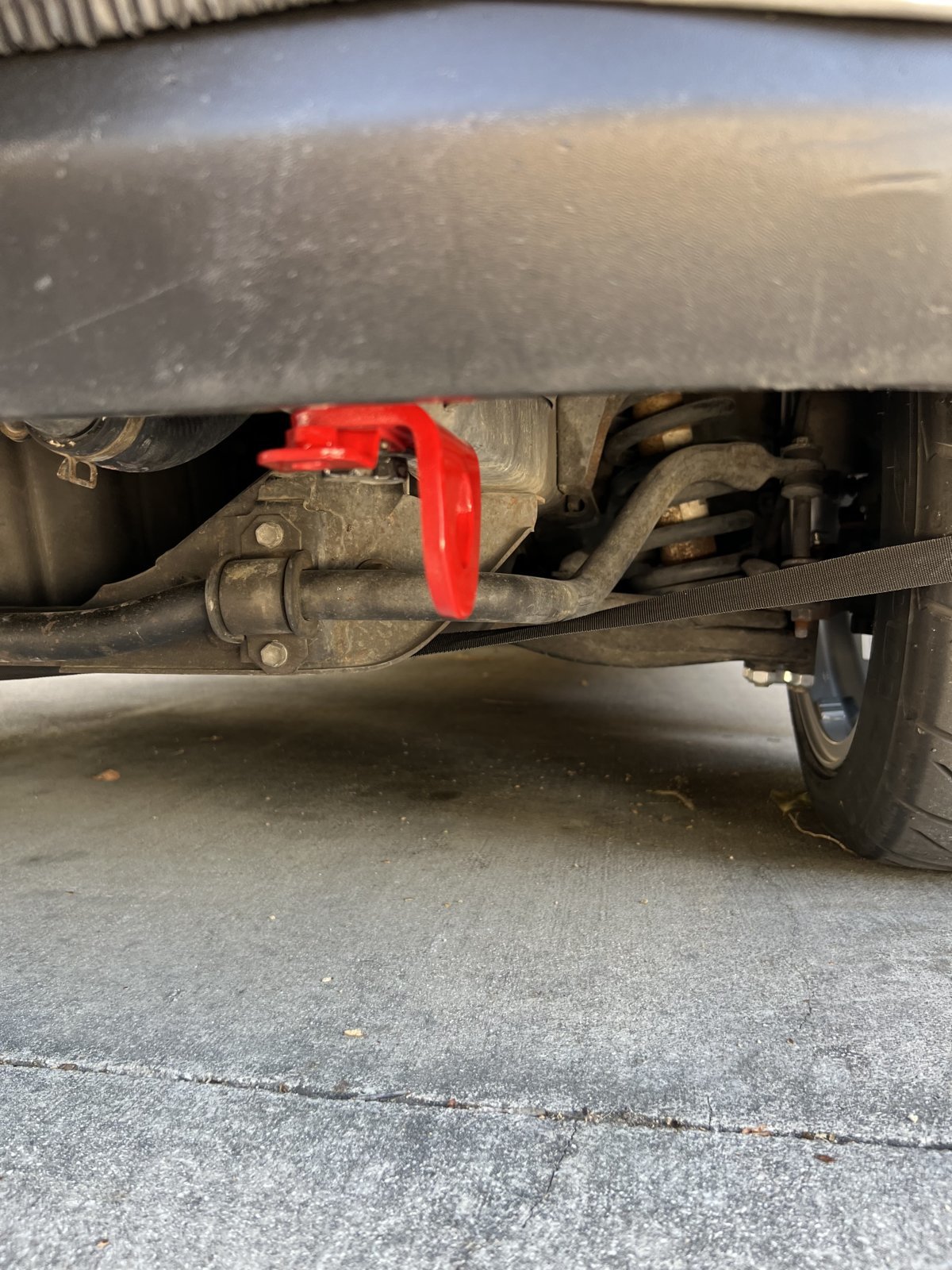

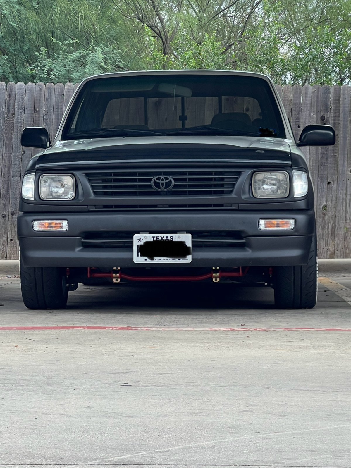

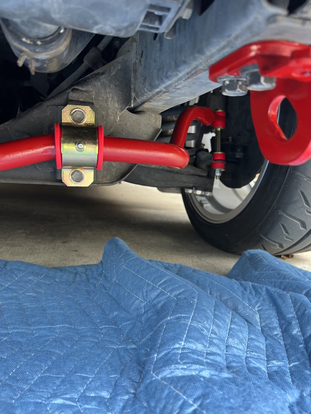

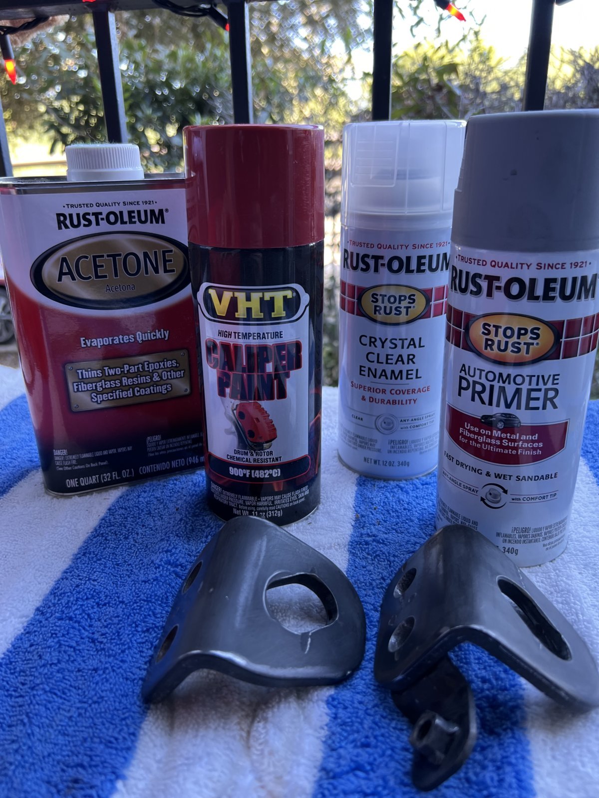

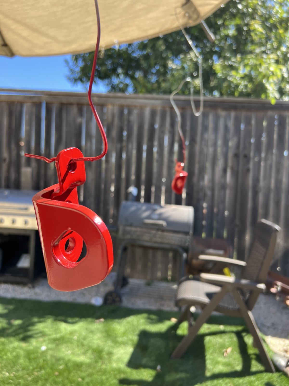

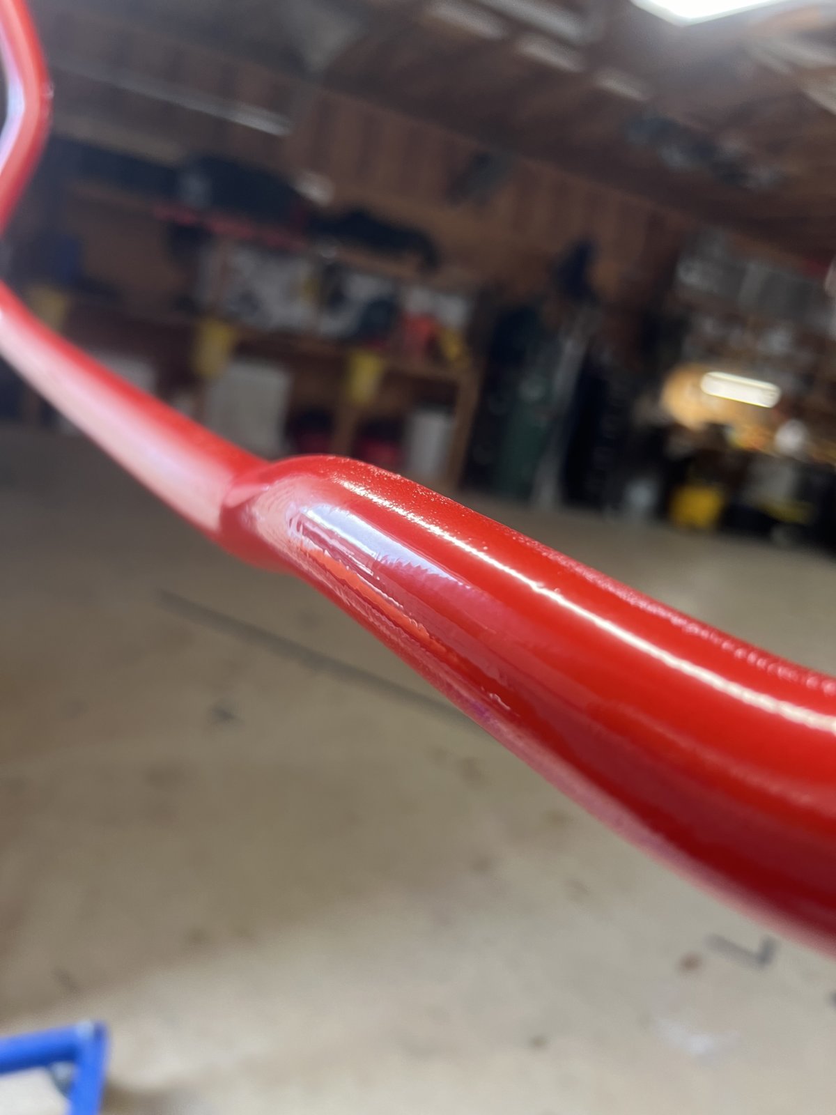

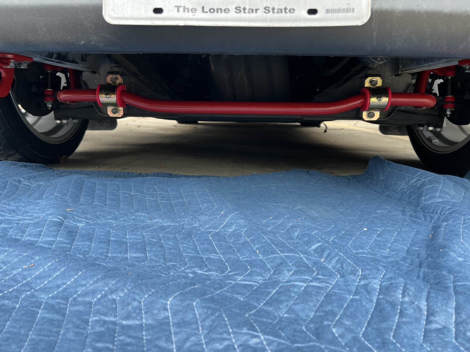

    Hope everyone’s weekend is going great. Feeling some cooler weather down here in south Texas. Stoked on that! Ended up refreshing some paint on the front sway bar and tow hooks. Ordered up some energy suspension sway bar bushings and hardware to complete the refresh. Still have to torque all hardware down to specs but give’s an idea of it finished. New Brakes coming next !

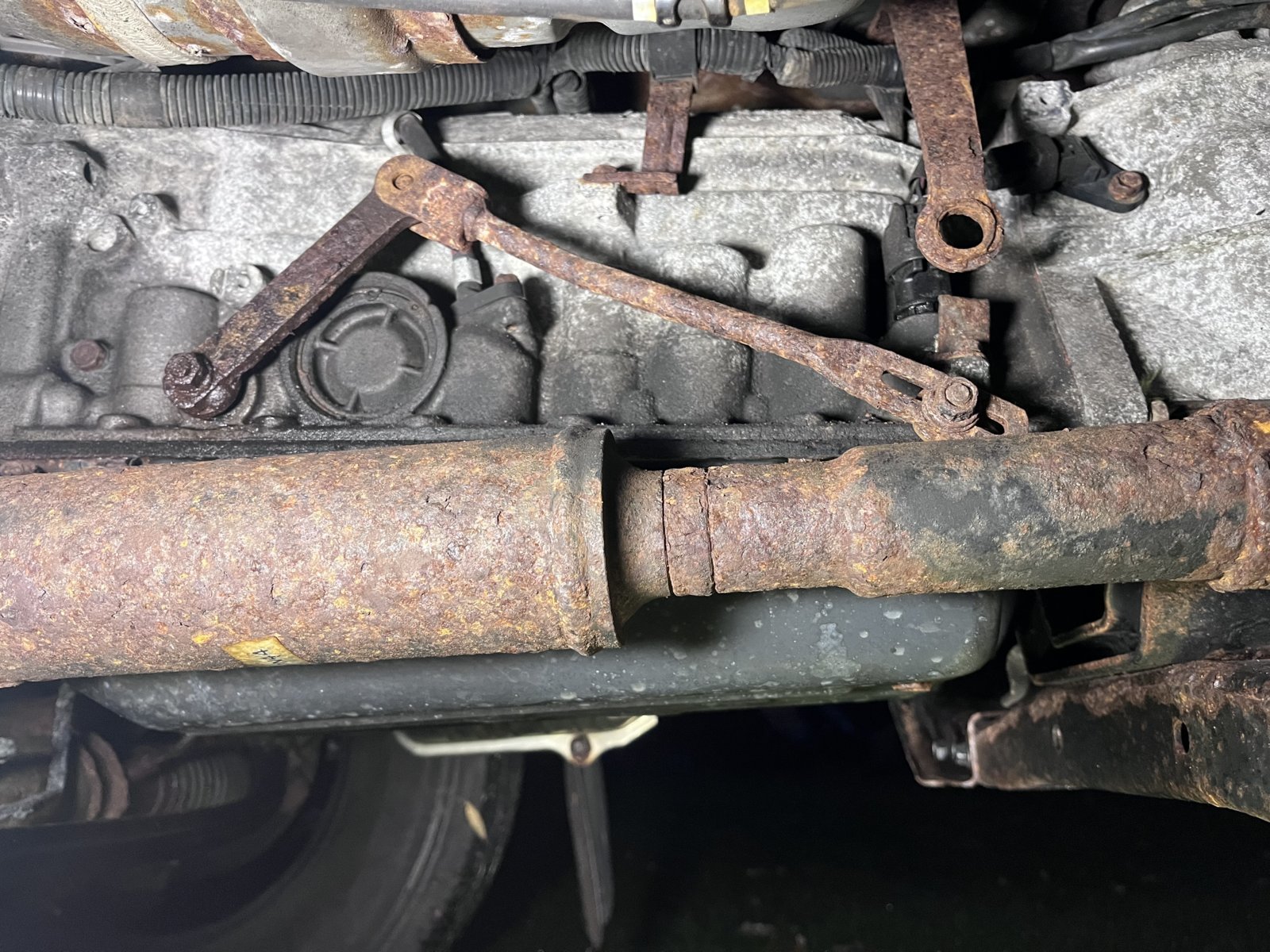

    Keeping it running
    Was unable to move the shifter as usual…
    found this under a the truck…

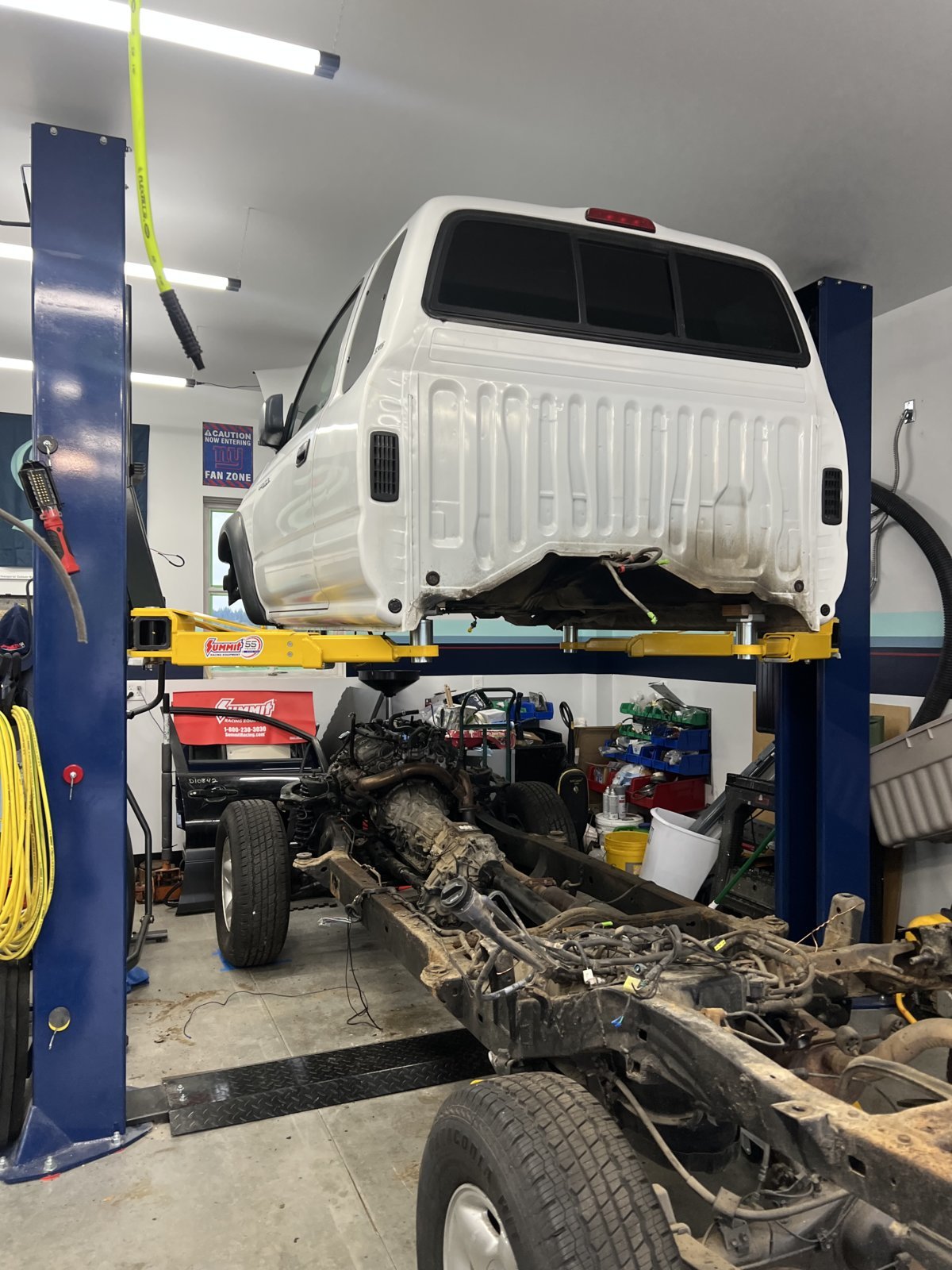

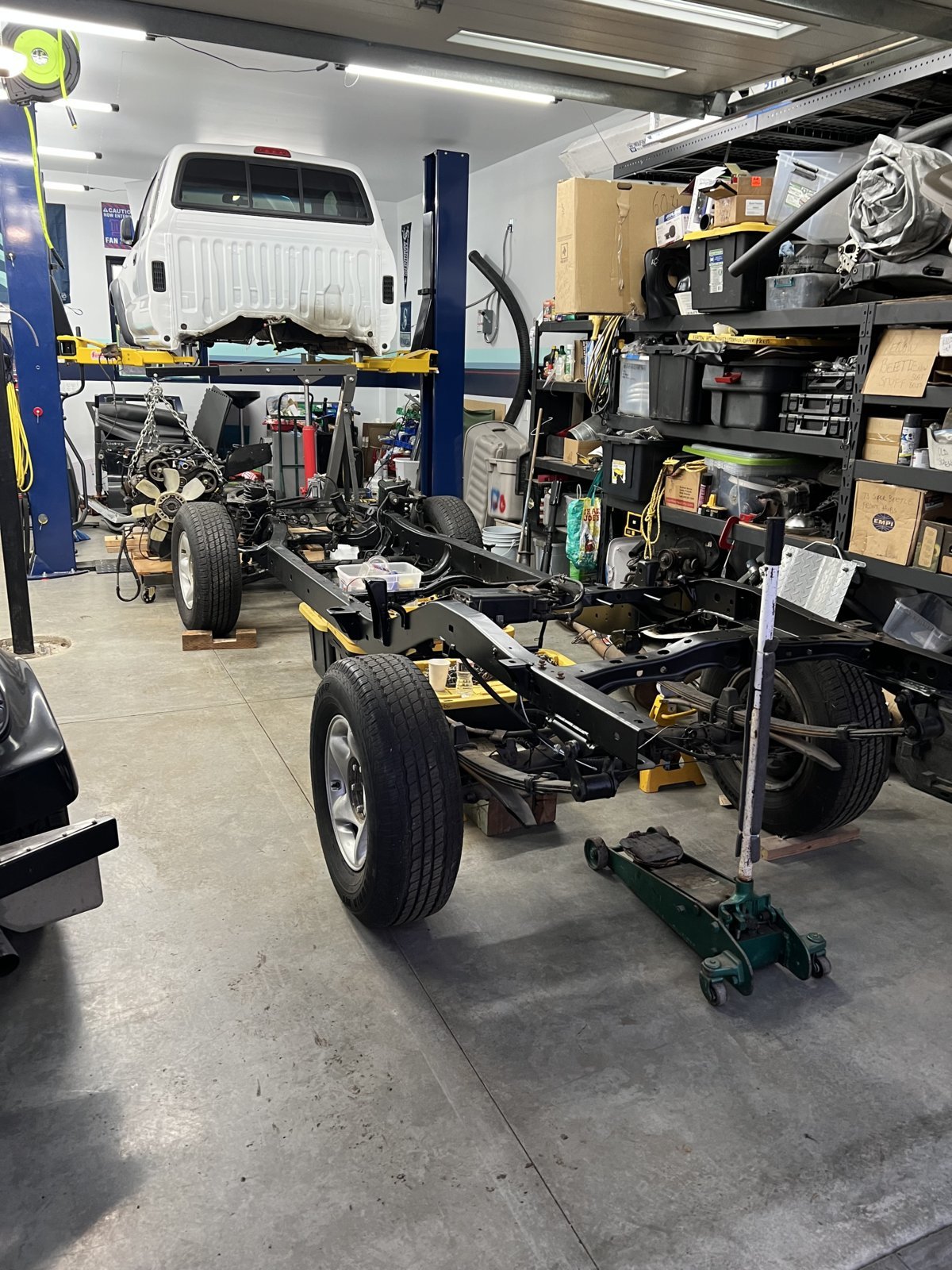

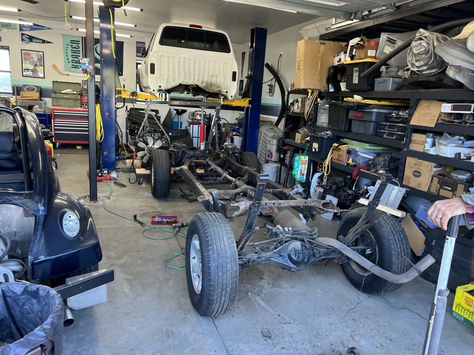

    IMG_1102.jpgOctober 21IMG_1142.jpgYesterday IMG_1168.jpgToday. Bit slow going only working on it on the weekends, but should go back together a lot faster than it came apart

    i like seeing this ol things getting the attention they deserve.
    i've still gotta get my 02 frame swap done... but first the 07 frame so i can sell that bastard

    Glad I could help a friend out. It was his fault for not having the truck looked at before he bought it, but he paid too much for it to take a huge loss.
