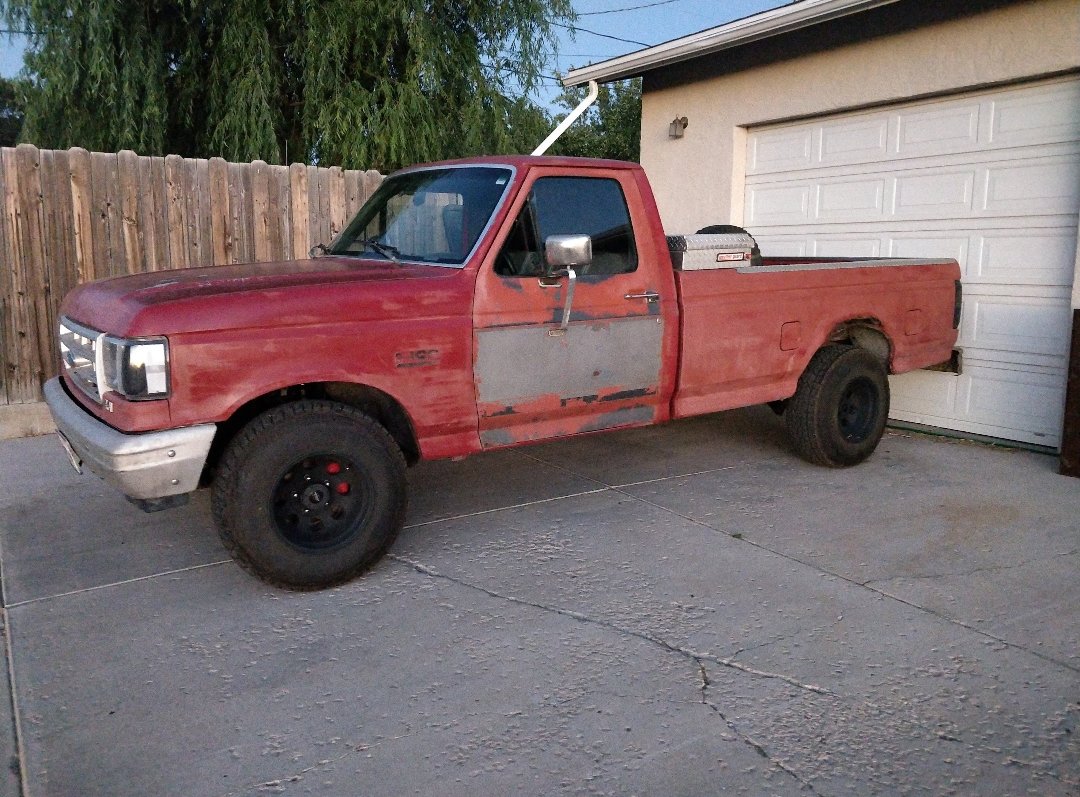

    It grew on me. After a little suspension work it drove really nice and the AC was cold as deaths breath.

    buddy had as shitbox ford like that in HS. Put some nice suspension kit on it and it would hit speed bumps at 40mph like it was nothing. Was fun.

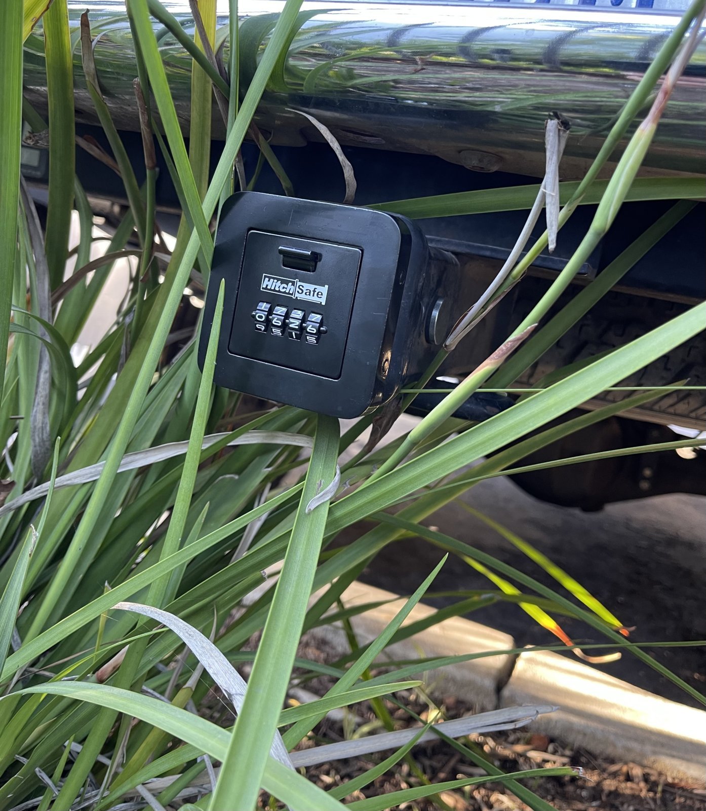

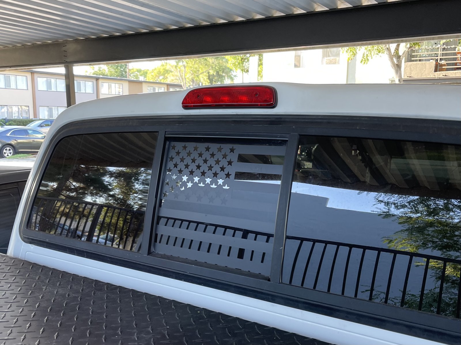

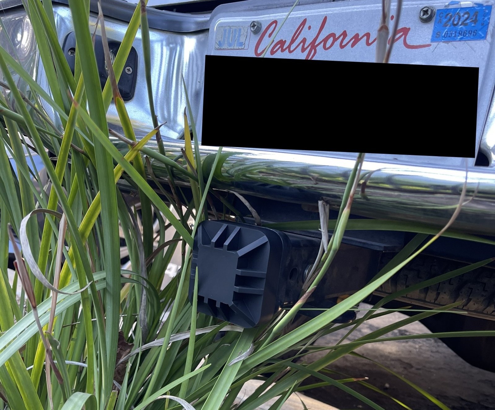

    Ditched the old and faded smoked third brake light. Went back to oe red with Depo. Also got a hitch safe. Don’t have pictures of this yet but also got a new driver side seat panel and reclining lever. Had to color match the panel as best I could cus I have oak interior and the panel came grey. Got close enough. And then I realized I’m a goddamn idiot cus I ordered a passenger side seat lever but needed the driver side lever so it won’t fit. Go figure. Got another one on the way now. Anyone need a passenger seat recline lever??

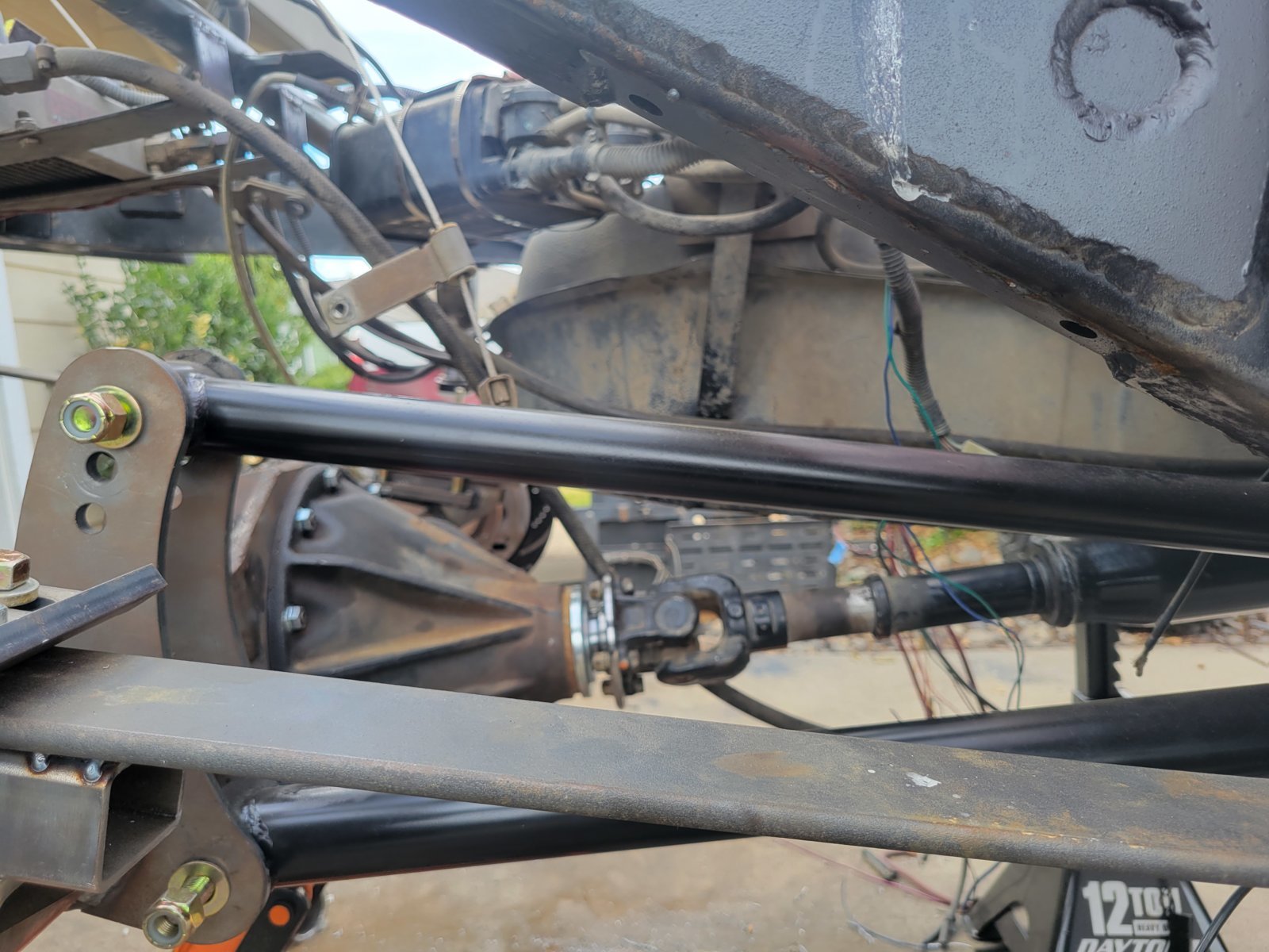

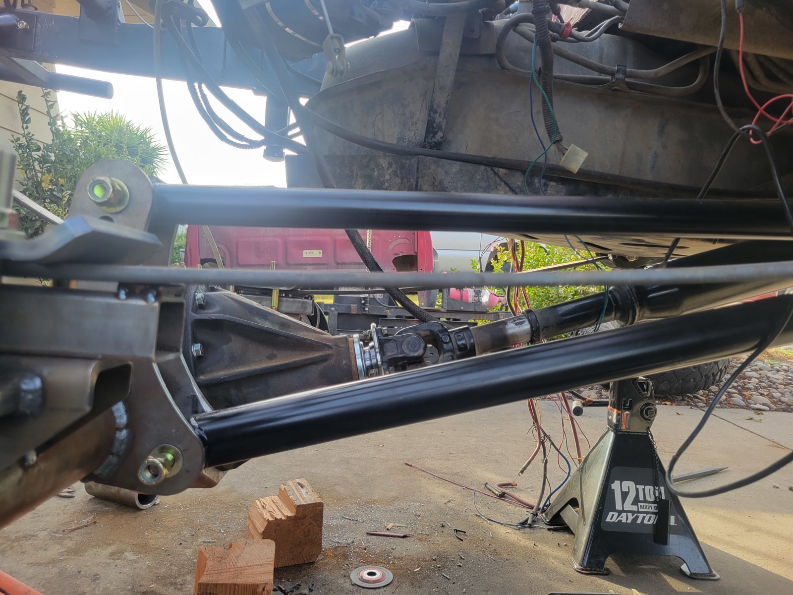

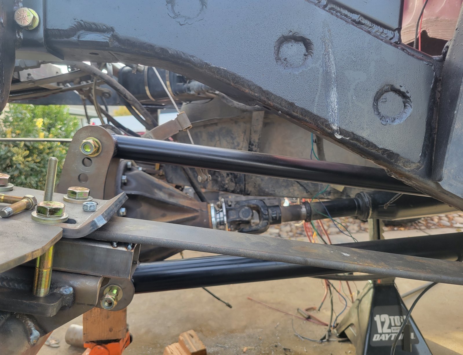

    Triple drilled Yukon flange installed to adapt from Landcruiser diff to Tacmoa driveline.
    This is ride height. Looks like the pinion angle and axle position worked out. (Moved the axle back to accommodate the longer nose on the LC 3rd member)
    The slip joint still has clearance for more bump, and it doesn't slip out at full droop... I'll call it a win.

    How's the yoke looking at full droop? If that's how it look at ride height, the yoke might be too short based on the picture.

    Full droop. (May droop another inch or so with tires on etc. But that's all the way drooped)
    Going to say no issues with the pinion angle.
    From full bump to full droop I'm getting 13.5 inches of travel (without tire weight, and I'm also going to add another inch to the shackles). I'll have a full 14+ inch up and down.
    This is driveline angle at full squish.

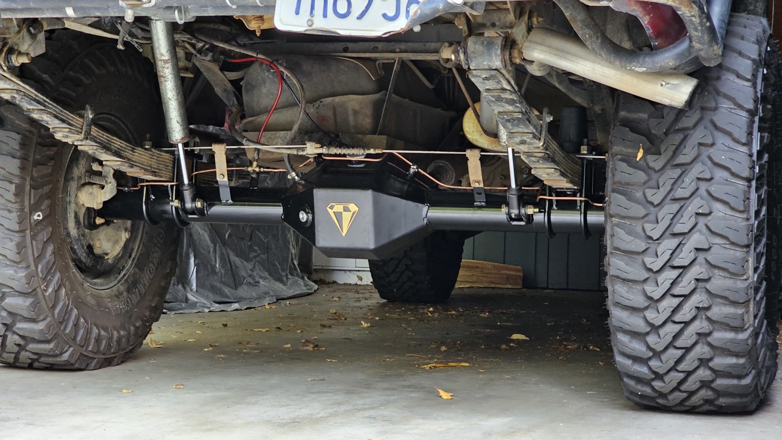

    Finished installing my Diamond housing

    But why did you put a volcom stone sticker upside down on it?
    :crazy:
    Looks very nice

    Because it make sense

    It looks better that way

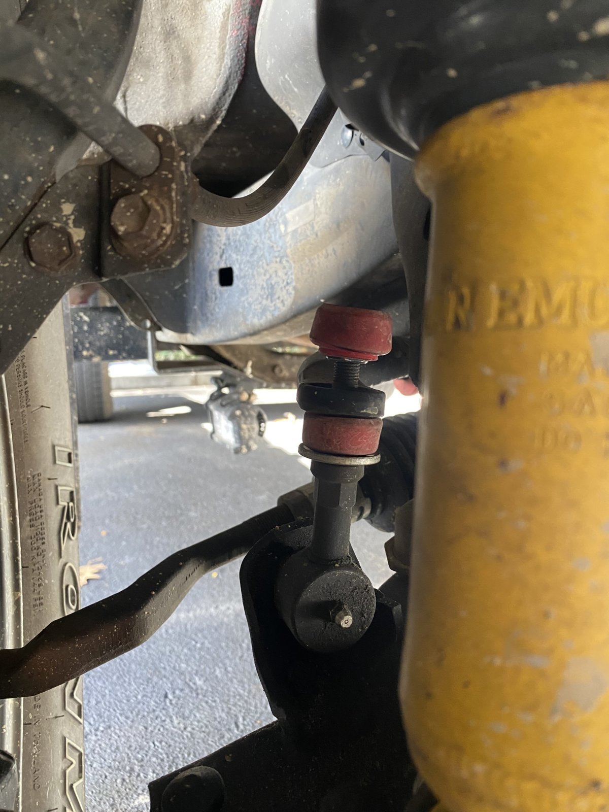

    Whoops... nothing a hammer and a washer can't fix for now

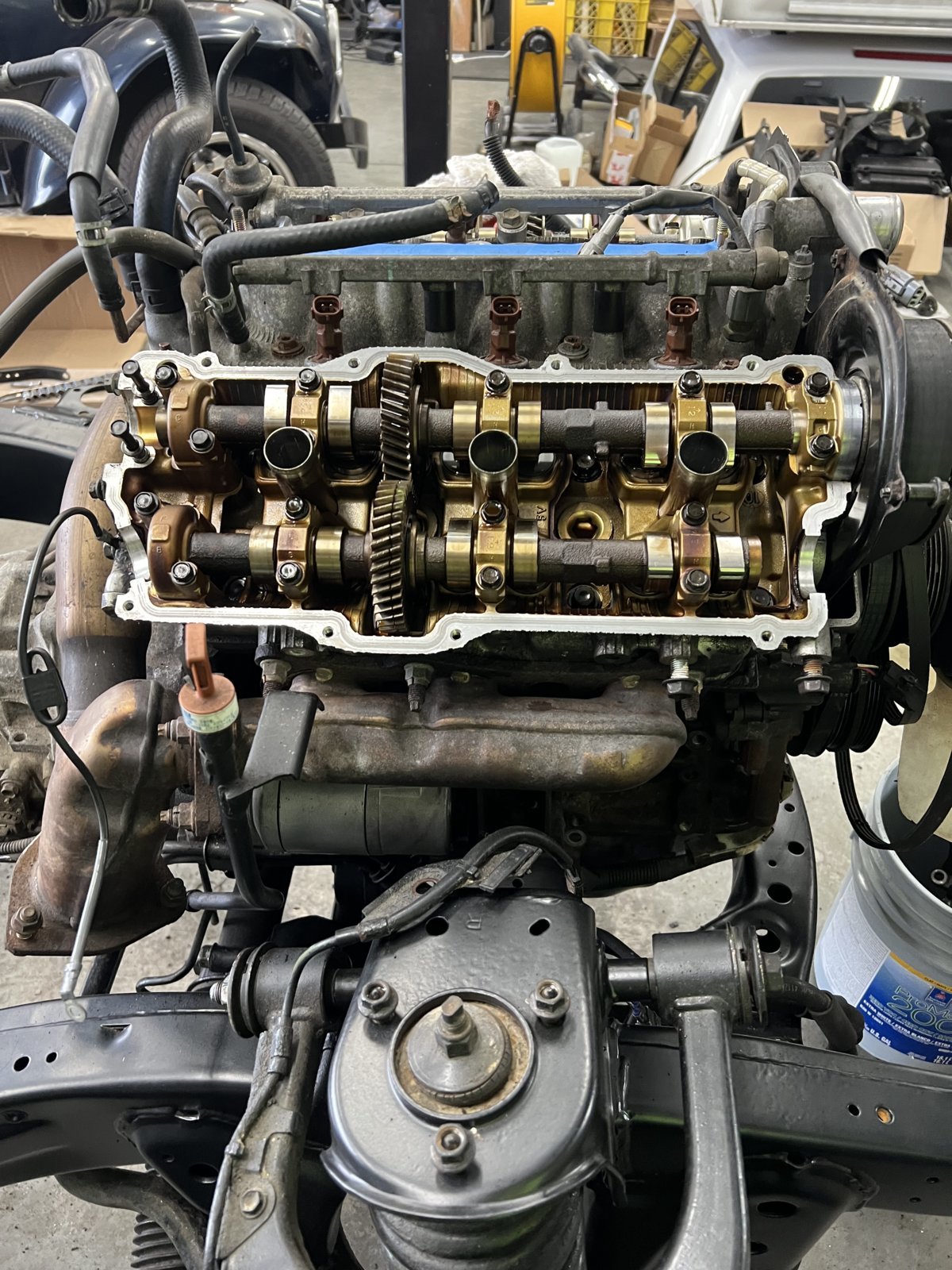

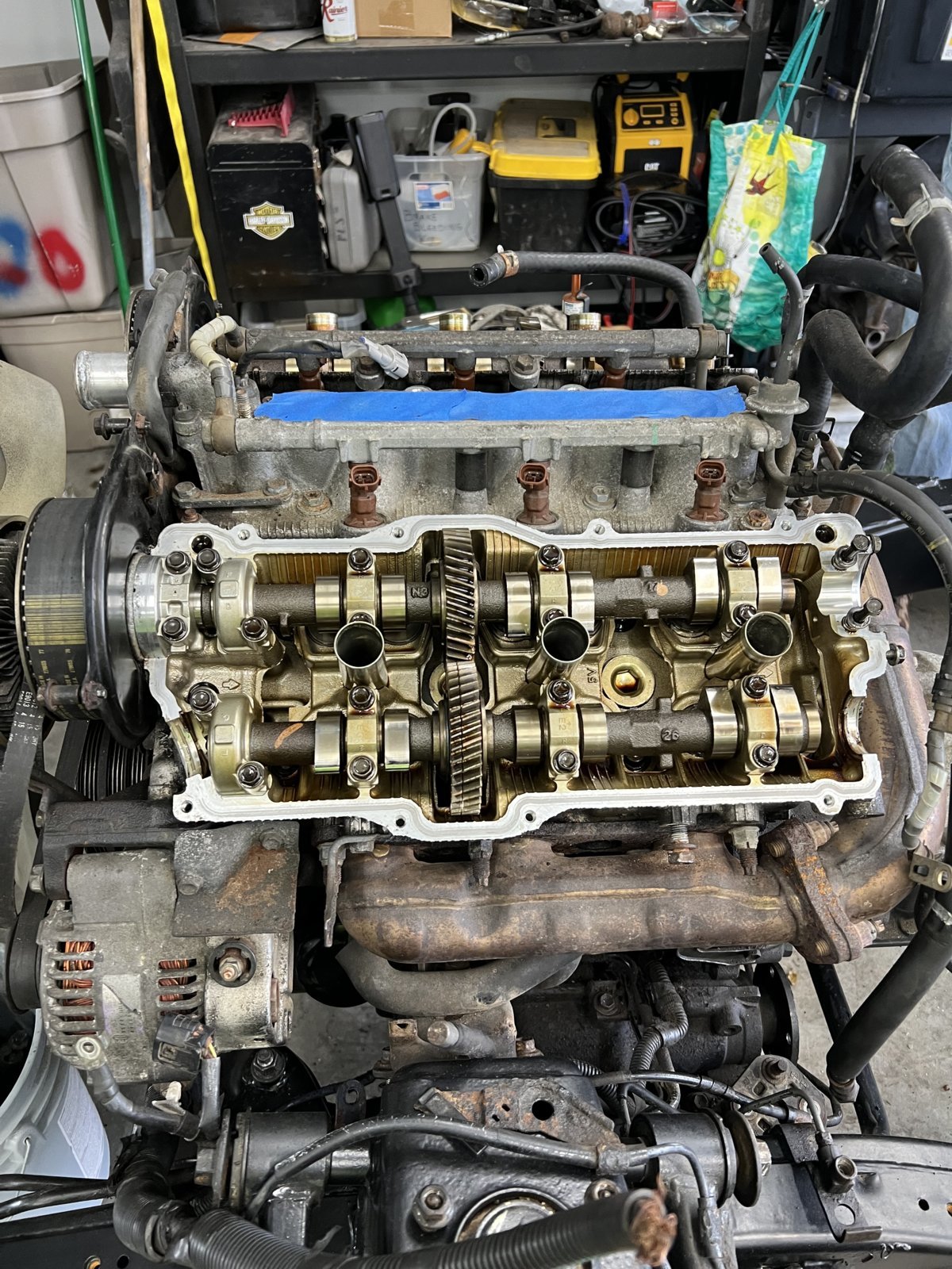

    Did the valve cover gaskets prior to the cab going back on and noticed the passenger side was dirtier/more buildup that the driver sideIMG_1237.jpg Passenger side IMG_1236.jpgDriver side
    Not to say passenger side is bad, more buildup/light layer of sludge on passenger side valve cover, more curious about the reason for the difference- maybe bad/clogged PCV valve?

    That's how it always is, one is the fresh air side the other is the PCV output side, totally normal

    Hmm, I mustn’t have noticed when I did mine. I was surprised how clean the driver side was more that anything

    At least you noticed it. I remember being similarly concerned when I did mine
