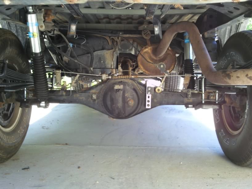

    The setup...
    Gonna have to wait a a year or two for bigger tires. :( Need to save mah mooney.
    Here's a pic before the lift:
    And after...

    Don't forget to extend your Brake Proportioning Valve arm mount. You need to extend it or you wont have any rear brakes.

    Whoops! Didn't know it was that important! :eek: Like this?

    That would be it and really need to get off my ass and do this.

    Yeah, except that one is too short for your application. From the pic of your truck, it looks like you got 4-5 inches of lift. Extend the mount by the same amount of lift you got.

    Yeah your going to have to make one I don't think anyone makes one high enough for the expos. Maybe AllPro should get on that :)

    Make sure you use at least 1/8" thick plate, steel would be best. I'm doing mine with 3/16th plate steel.

    $1 peice of strapping from the hardware store and a wee bit of measuring.

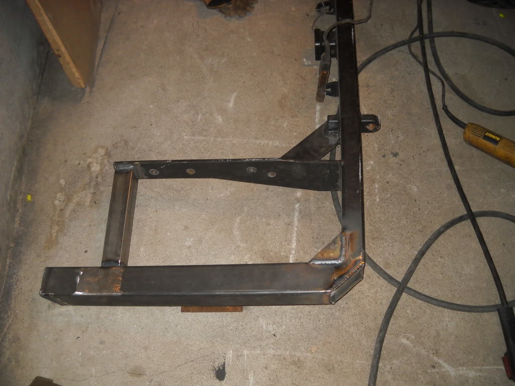

    Got around to adding wrap arounds to my bumper. Still need to grind them clean and add tube work to it.

    Looks Beefy ^

    After dealing with how my front 3/16ths plate bumper folds around the mounts i decided i wanted to make my own so i never have to do anything but paint it. I Think i will have a hell of a time bending this one no matter how hard i hit it.;)
