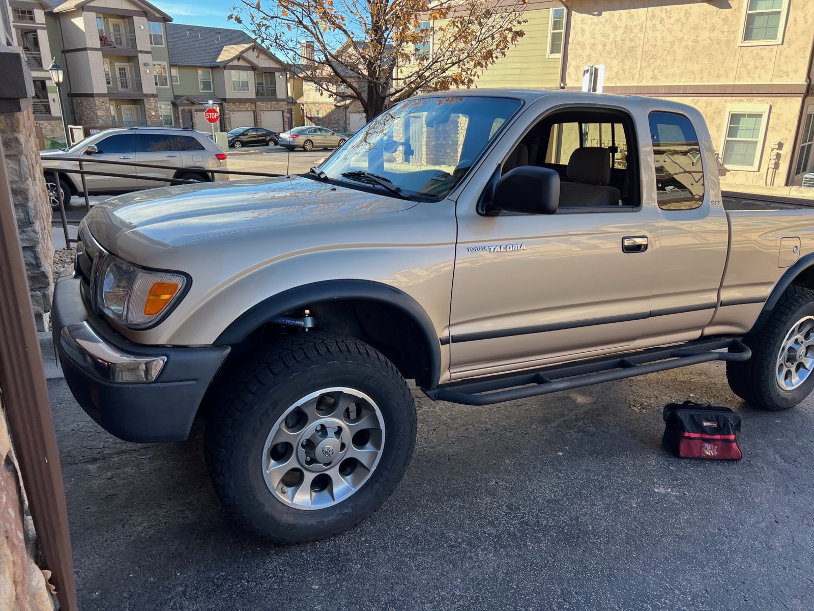

    Can I get some follows as I begin this build!
    @wnc_tacoma

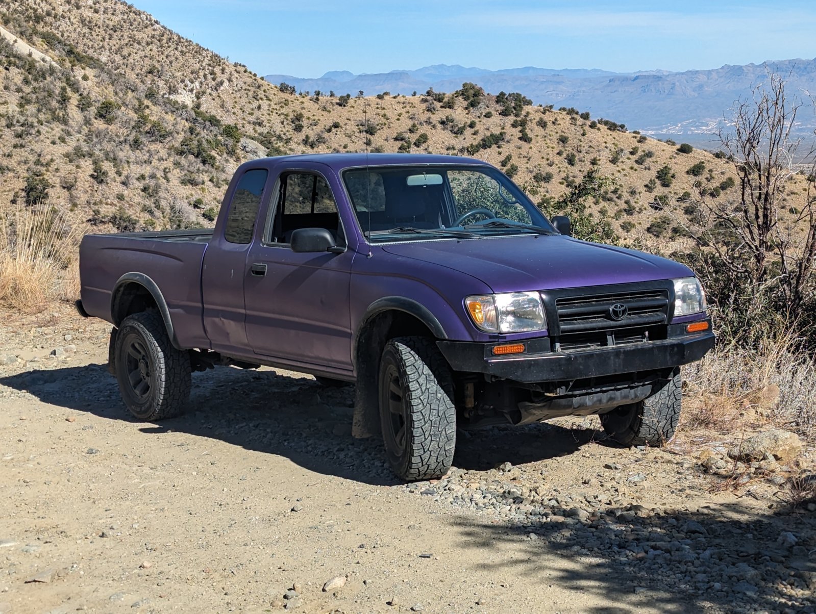

    My brother and I went up the Mount Lemmon control road today, had zero issues with either truck. Decided we both like automatics better than manual for this, just way easier to control. Tires made a huge difference, my worn out and super hard Coopers were not happy. PXL_20231122_185037178.jpg PXL_20231122_184954730.jpg

    Closes in December sometime. Honestly the first 3/4 we did in 2WD, it was only the last 6 miles or so we did in 4Hi. Never really needed 4Lo or the Elocker. Super nice day to do it. Looking at Reddington next.

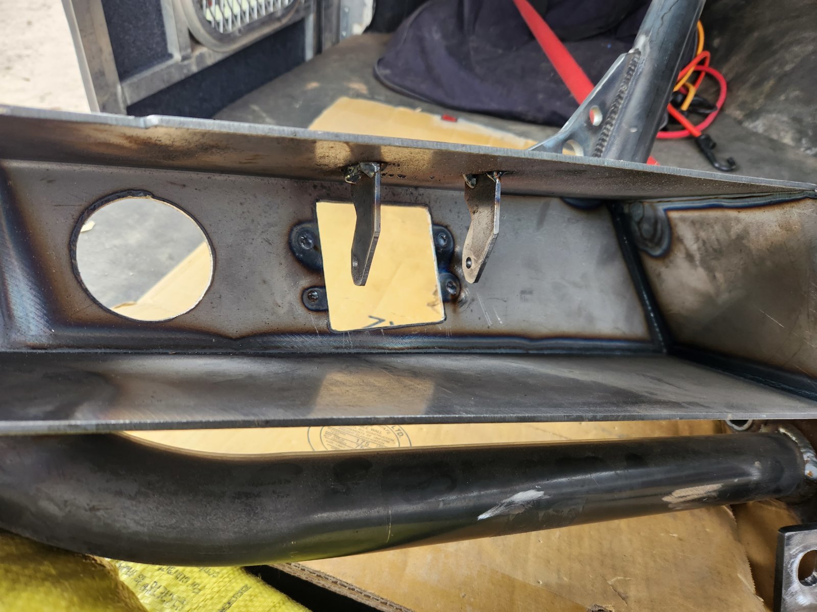

    I bought the Astro Pneumatic 1443B tool, and a multi pack of stainless rivet nuts on eBay. Then I had to buy a metric carbide drill bit set, since some of the holes needed feel between sizes in my SAE drill bit set.

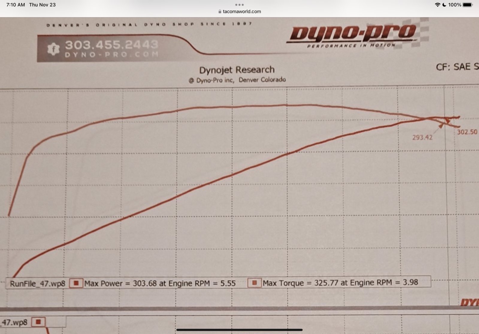

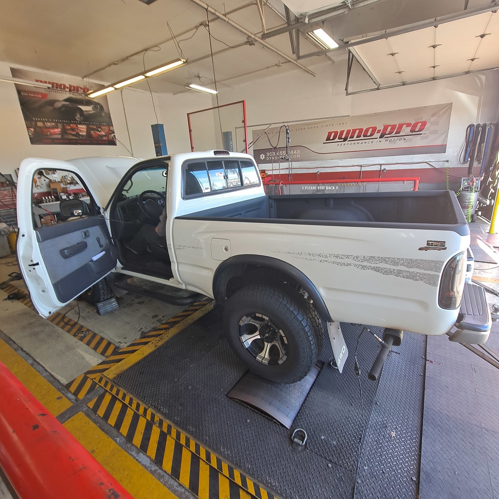

    Did a remote tune with the 1320 supercharger 60mm pulley yesterday:)
    Some nice results at 6000 feet, sea level will be more
    304HP-326TQ

    That's a really smooth curve, should be super driveable.

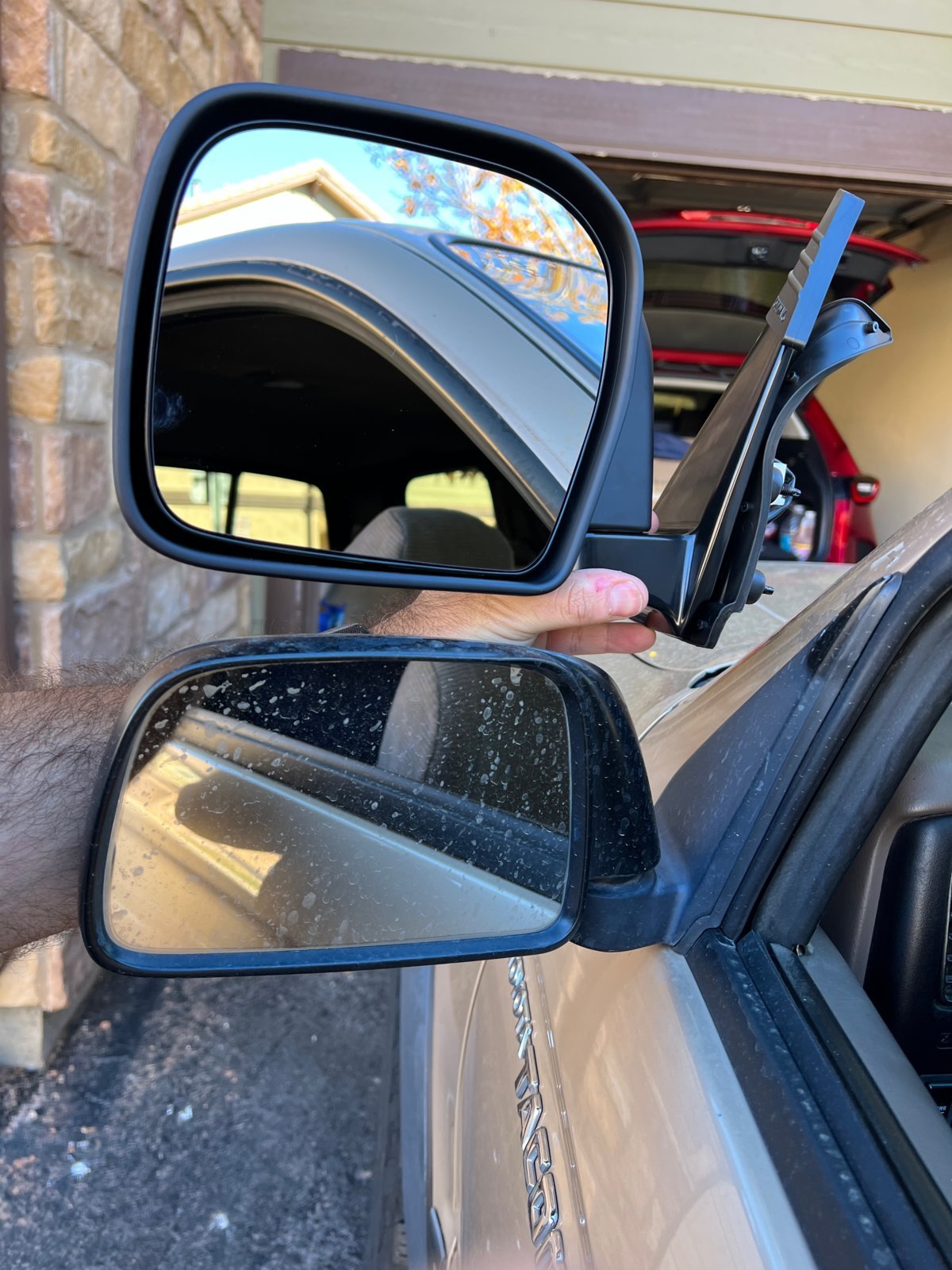

    Very nice!
    Source link on the mirrors please?

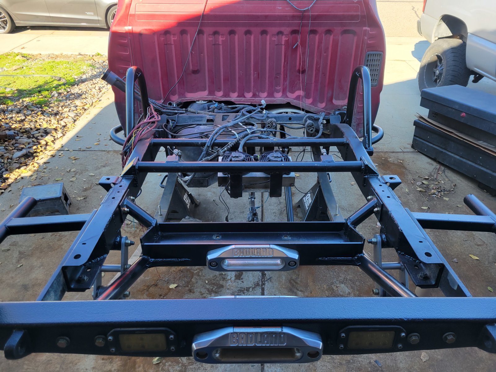

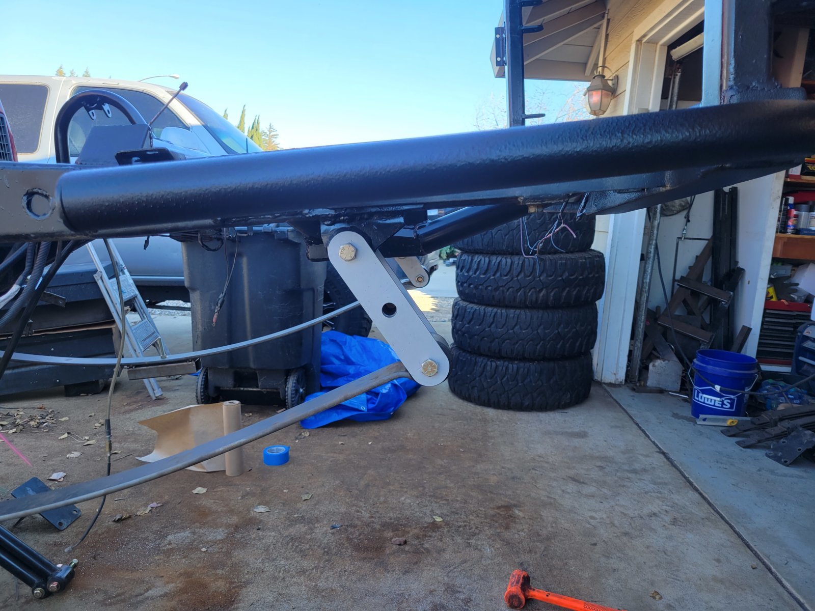

    I'm going to go out on a limb here and predict I've sufficiently delt with the frame flex in the rear.
    At least for my purposes.

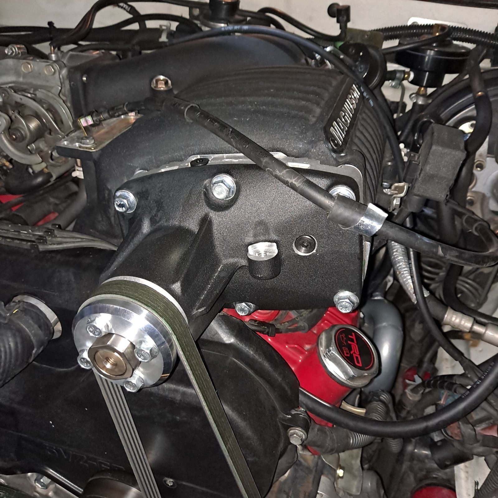

    This is the new TVS1320, It a much better supercharger

    Old one maxed out, ported and 1.9 pulley was at 278hp and 305TQ with haltech

    Nice. Decent bump but not huge. Is this a stock pulley and what boost numbers?

    New supercharger is designed to be the same power output because of emissions with 4 pounds of boost instead of 7 pounds.
    It makes a little more but is much more efficient and much less heat.
    Essentially it's 200 more than the 20 year old design
    Most the older superchargers are at 250hp

    IIRC this new SC comes with a 75mm pulley. From what I recall, he next tried a 65mm pulley. And is now onto a 60mm . I could be wrong but I suspect these numbers pretty much represent maxing out this SC. The snout had to be redesigned to be able to accommodate the 60mm pulley.

    they came from Rock Auto as a set and were very reasonably priced.
    I think the first number is the set, comes with both.

    I should have brought the 65mm and 60mm pulley and dyno them the same time.
    Regardless the 60mm is as small as you can go.
    The 60mm boost gains over the 65mm were 1.7 pounds at 7.2 pounds at 6000 feet, 304HP-326TQ The 65mm was at 5.5 pounds at 6000 feet, 298HP-314TQ
    BUT My biggest surprise was that the boost at higher elevations from my 6k feet going up to 8k feet, 10k feet, 12k feet were actually a lot more power because the boost cap has been moved higher from 5 pounds to 7 pounds for my situation. What does these mean?
    Stock pulley 75mm pulley at 6000 feet is 1.5 pounds :(
    The 65mm pulley at 6000 feet is 5.5 pounds and at 8500 feet is around 3.5 pounds.
    The 60mm pulley at 6000 feet is 7 pounds :)
    and at 8500 feet it’s at 5 pounds of boost.
    The lower boost numbers 1-4 are more efficient than the higher boost numbers I’m thinking because more heat being generated at higher supercharged speeds. So there is a big difference in useable power per boost the higher you go with the 60mm pulley. Definitely a pulley to get especially if you’re running at higher elevations. Higher elevation will show greater gains because more boost is available sooner.
