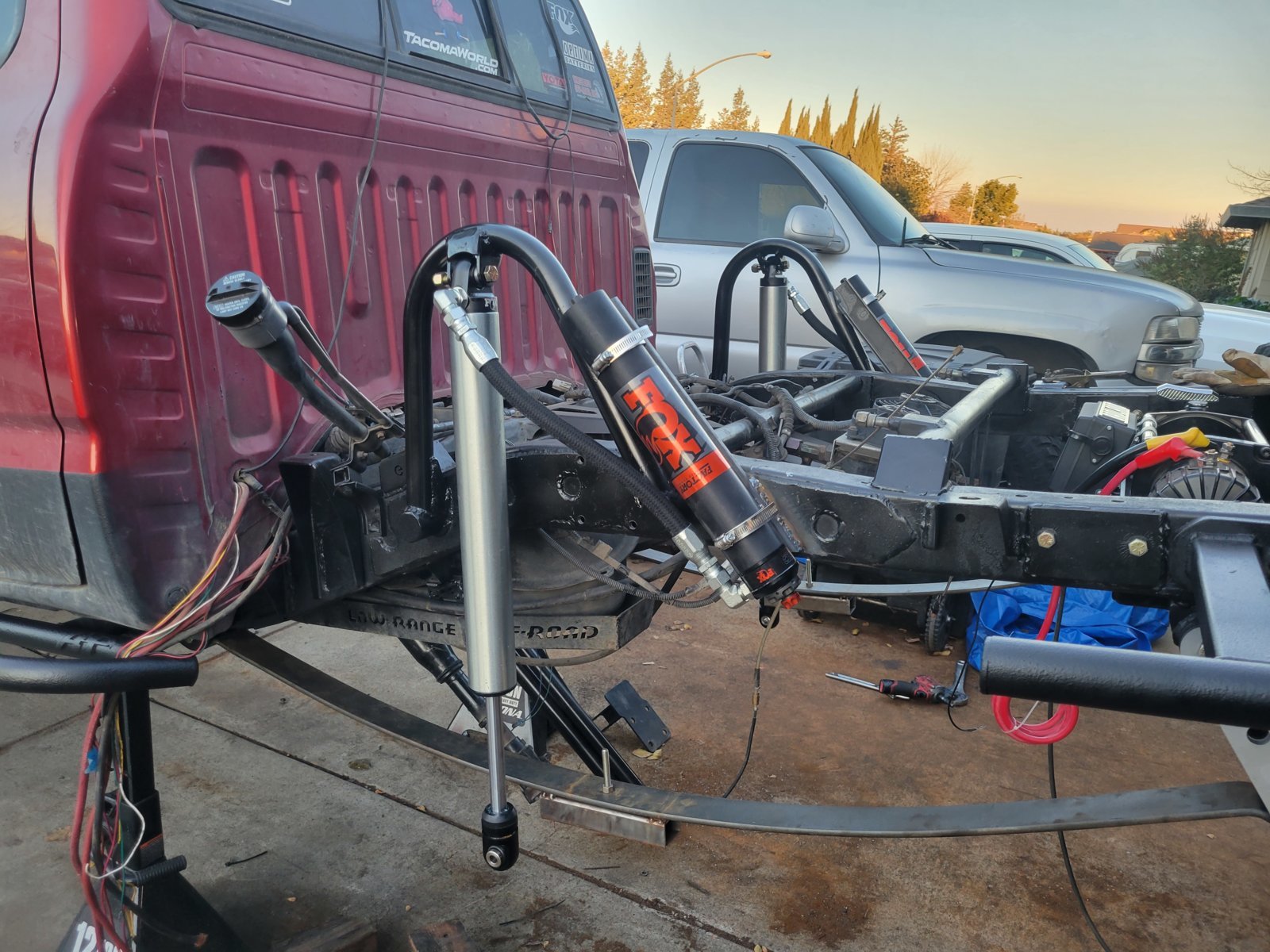

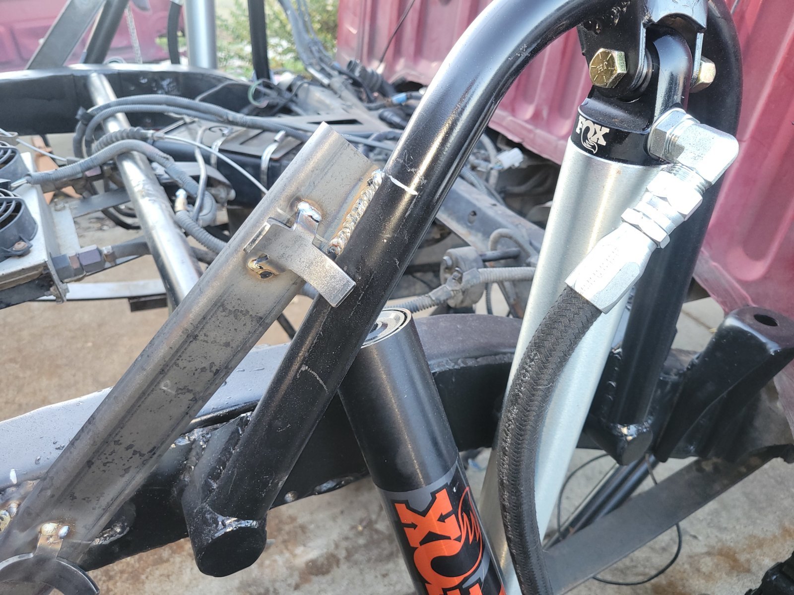

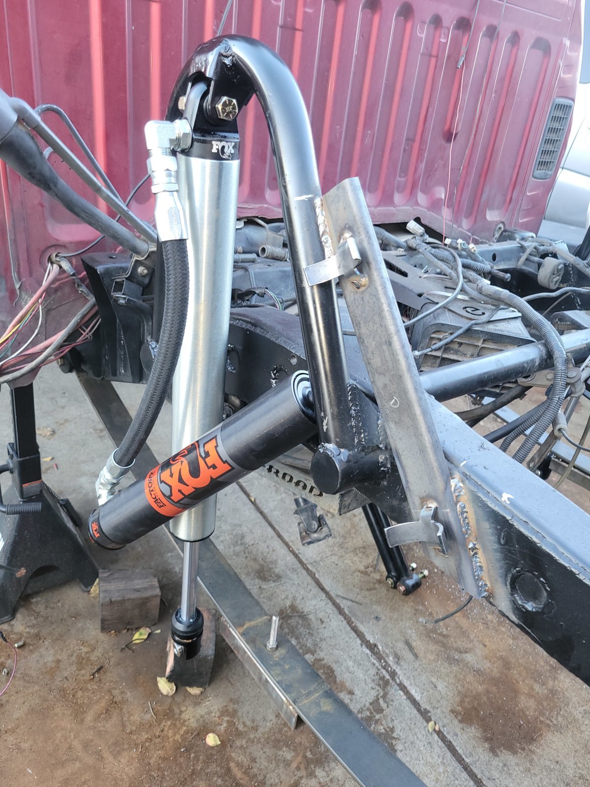

    The elbows, to re-route the reserviors, were delivered today. So, I was able to get the mounts fabricated. They came out like I was hoping they would :thumbsup:

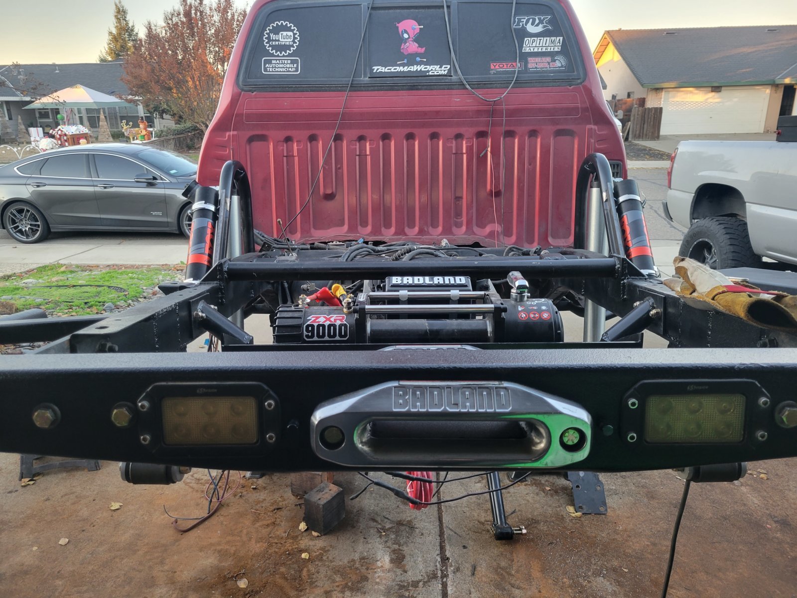

    Isn't that area by the front of the gas tank already boxed? Not that I'm getting myself into hard breakover situations, but is the only way to reinforce it to just add a thicker box (or at least, side plates? Or, am I misunderstanding the location?

    I think you'll be suprised.
    But, I'm actually not unhappy with the way it's working out. Depending on how everything starts fitting together, I'm looking at adding a link bar from one hoop to the other.

    That's too much for a leaf spring set up. But hey, if you think you need it, send it.

    You don't think it would help if I take a hard hit? Although the shocks shouldn't bottom out, I'm thinking it's a lot of force being applied to those hoops if shit starts getting western.
  14. Nov 24, 2023 at 10:12 PM
    02hilux
    02hilux What do you mean there’s no road, I’m here
    Sep 14, 2016
    #197244
    6,486
    Planet: EARTH
    IMO, no. Your leaf pack will absorb majority of the force. Now if you're on coilovers where the towers holds the weight, than yes.
    But tube towers are more prone to bending vs solid towers due to the lack of support (welds) and metal due to length.
    I need to get off my lazy ass and link my front and rear tower. But I believe it's efficient enough with the extra bracing at the base and tube support toward the top of the tower. It's easy to do. Took it through some gnarly shit without issue.

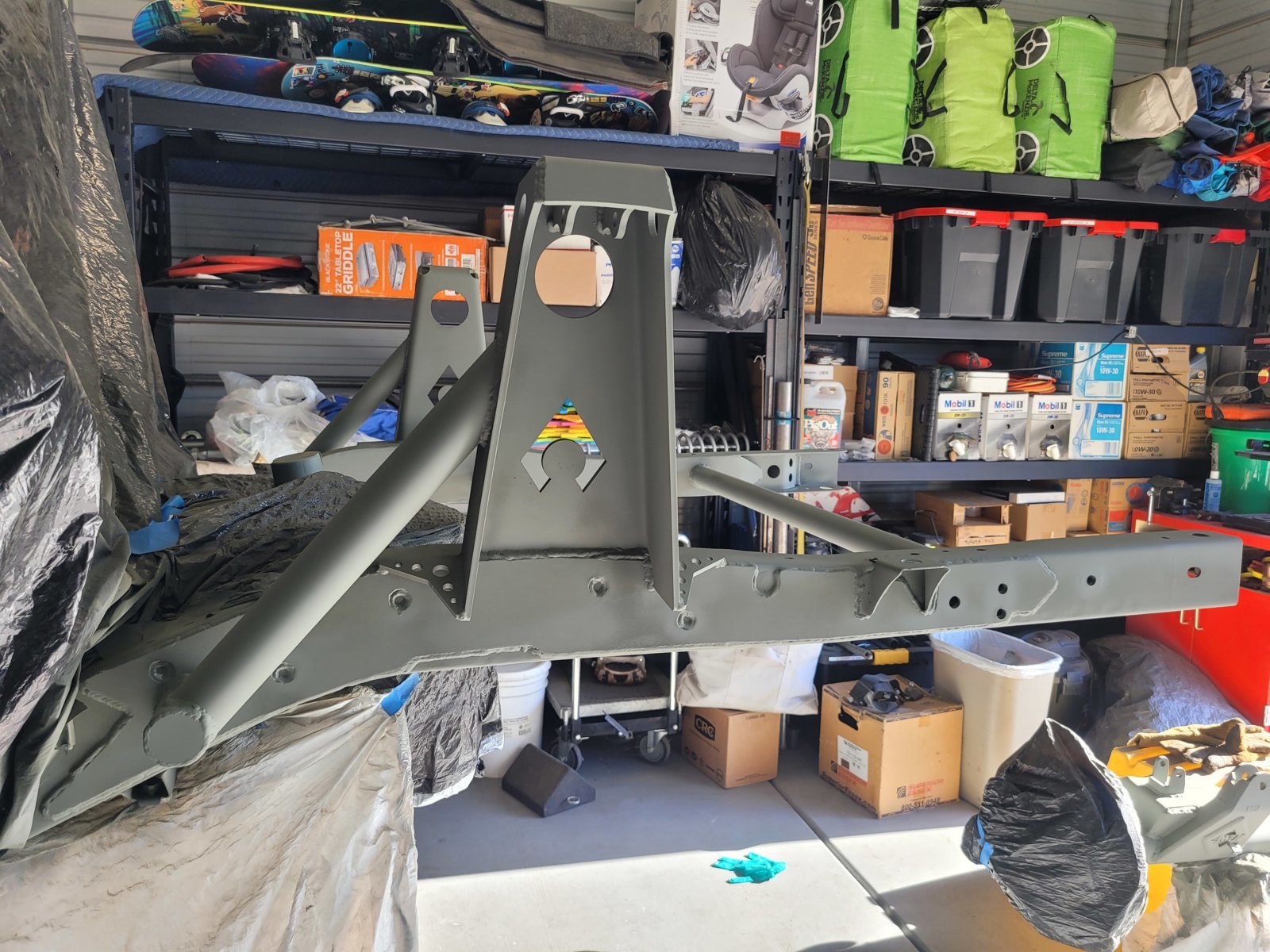

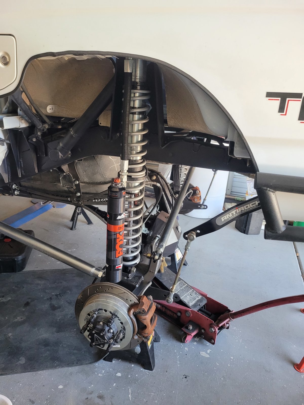

    Starting to look like a truck again...

    Is the passenger tower taller?
