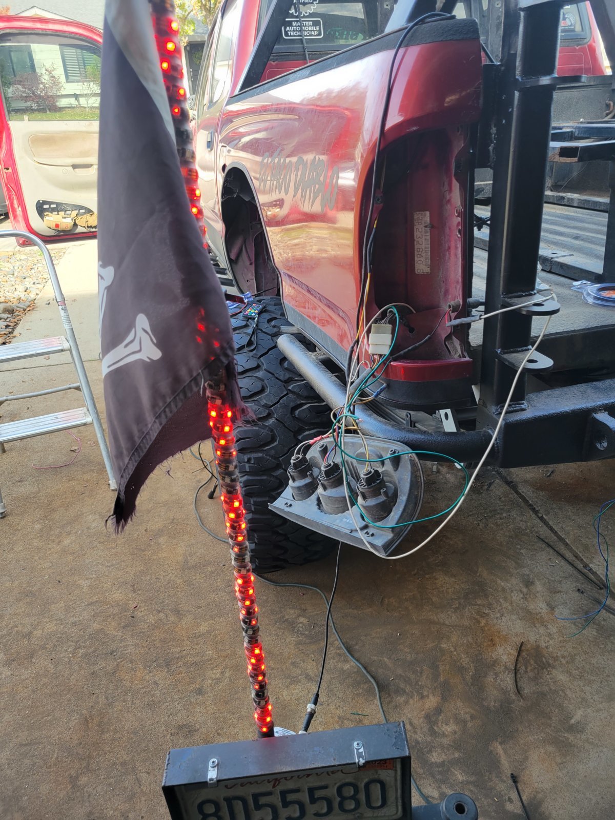

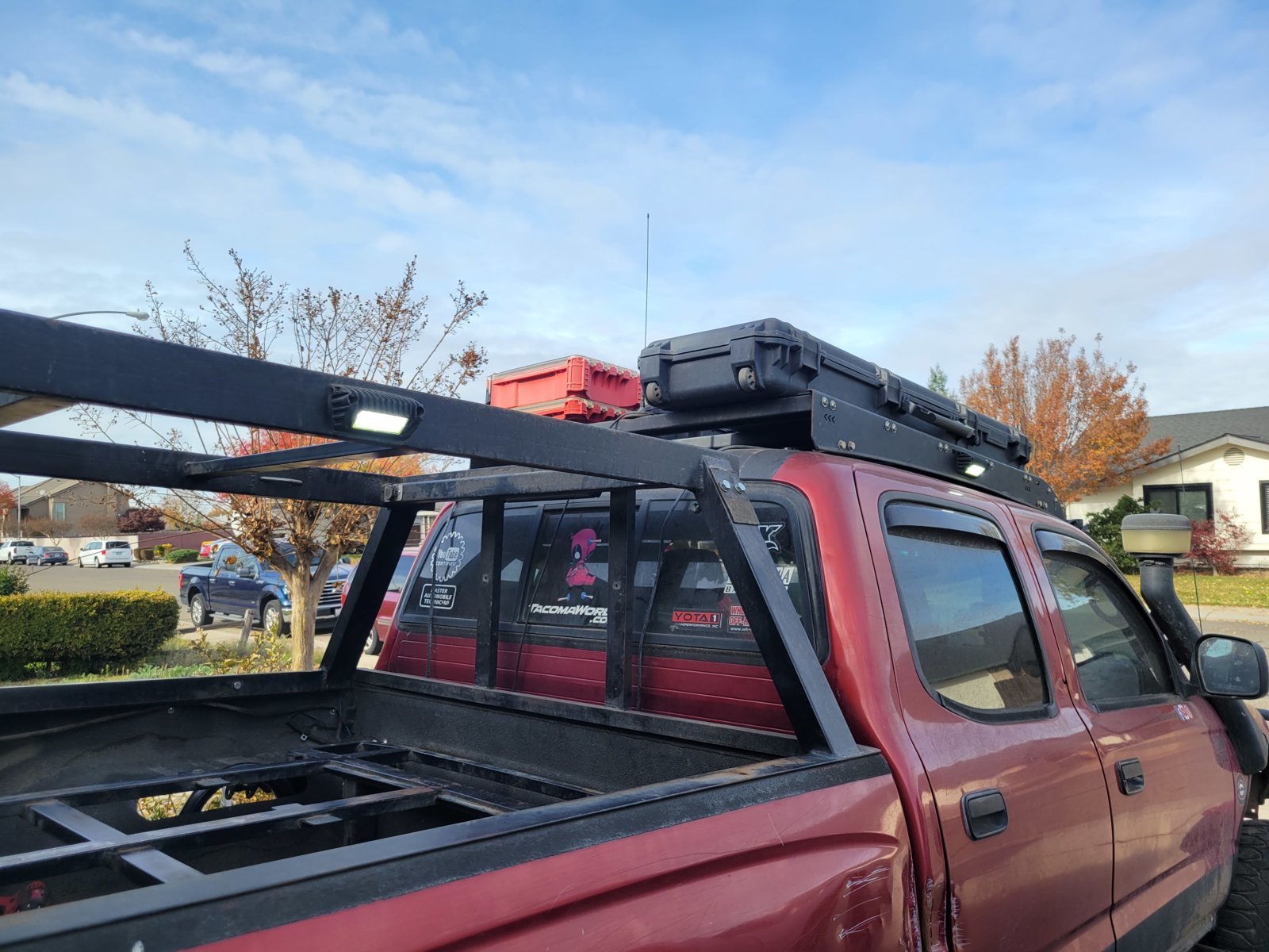

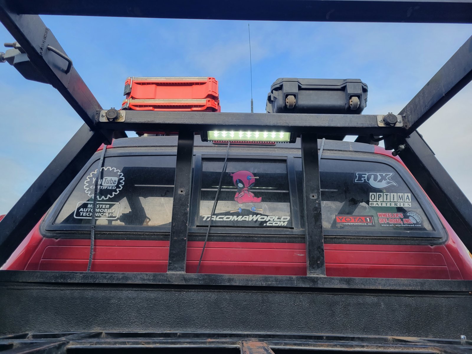

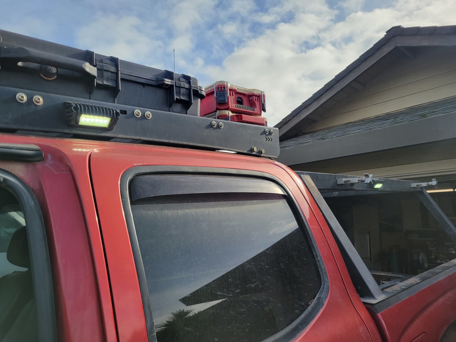

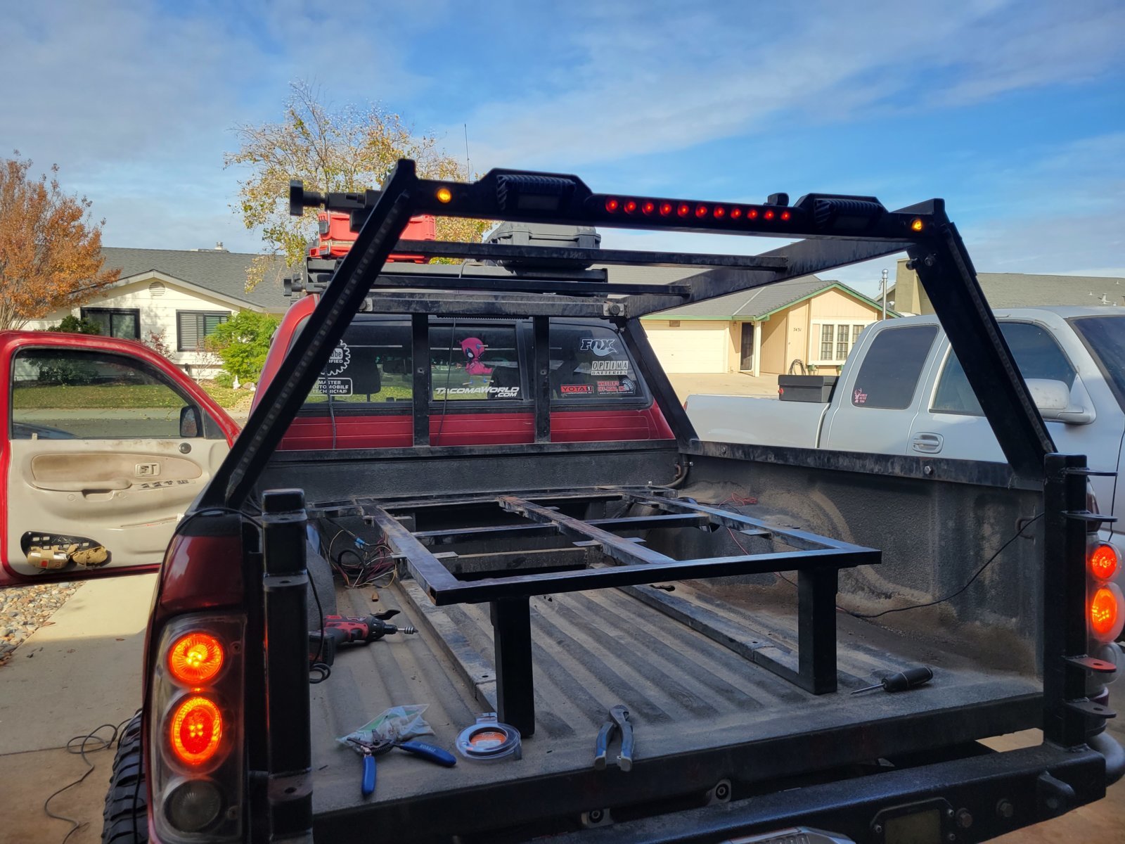

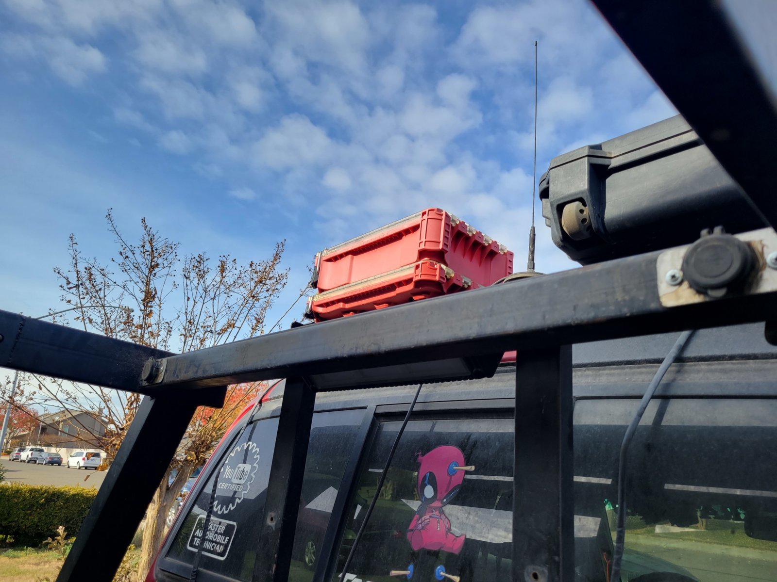

    Wiring... that is what I have done today.
    I love wiring :puke:
    Ok... so...
    Transmission cooler/fans are wired
    Rock lights are wired.
    Lighted whip is wired
    Passenger camp lights
    Driver camp lights
    Back camp lights
    Bed cargo light
    Rack aux chargers
    High mount stop and high mount flashers
    Back up lights
    Getting this thing put back together one step at a time.

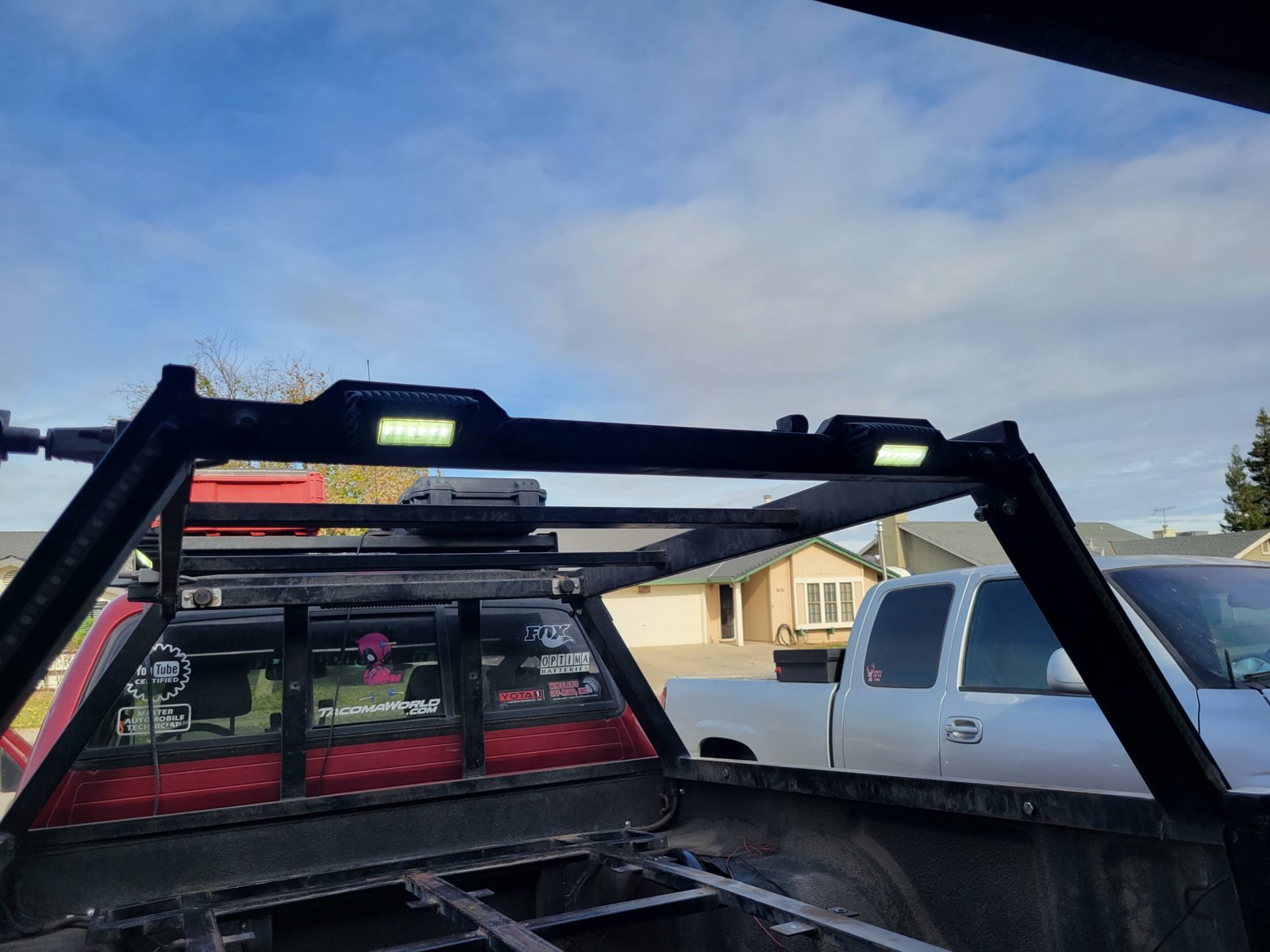

    Hazard/Chase lights are done too.

    You need a few more lights...and more wiring....

    No more lights to wire.
    Just have 2 compressors left to wire... and the rear winch.

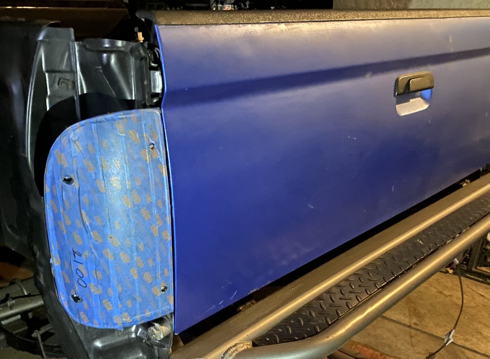

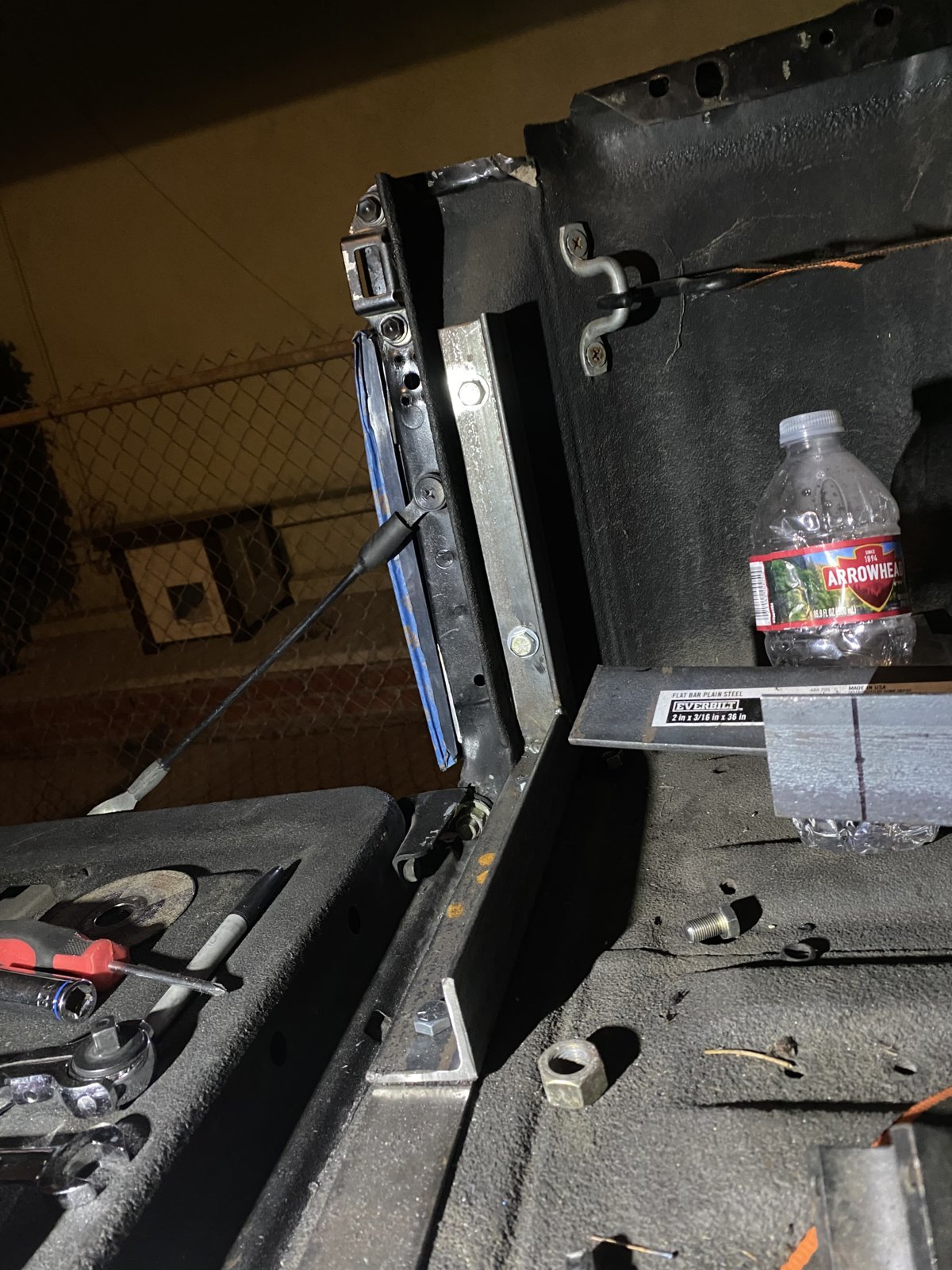

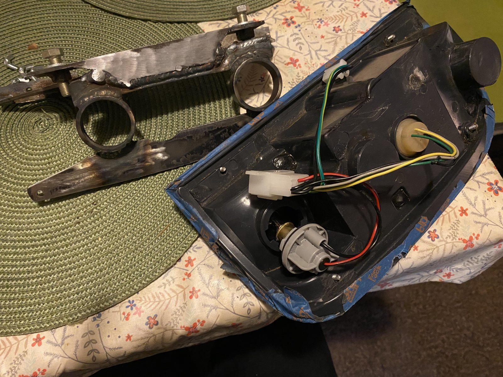

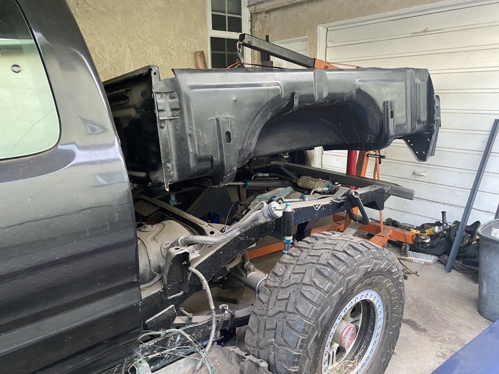

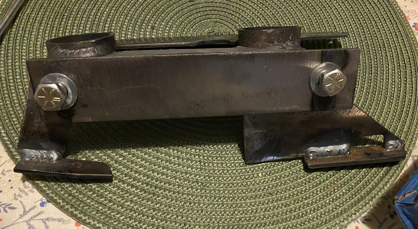

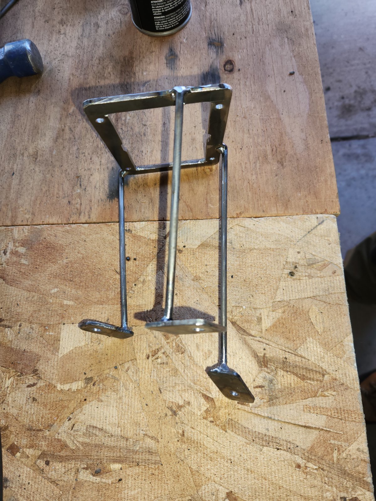

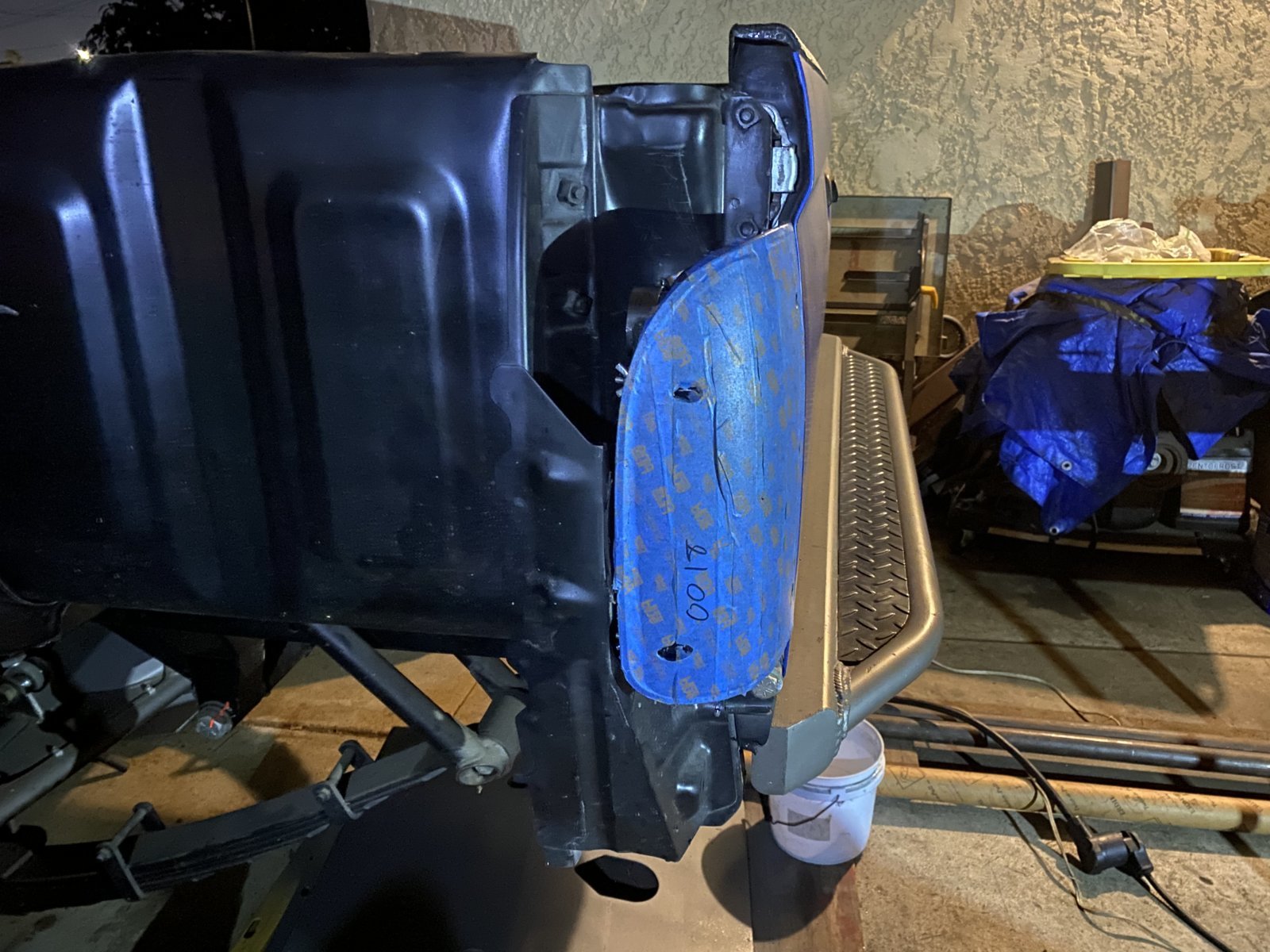

    Related to lights - completed driver side tail light bracket and rear bed stiffener setup. 1/8x2x2 angle iron under the bed acting as a sandwich plate along with 1/8 flat bar on top and two 3/16x1.5x1.5 bed stiffeners that bolt to the tail light brackets so the factory screws aren’t holding the lights any more and it’s just two bolts for the tails. Tie down points will be added to the bed stiffeners that will get some cosmetic stuff to make them look good (not as good as @Kwikvette ’s stiffies but they’ll be inspired by them lol).

    Are the bed stiffeners really that much of an issue? If so I will fab something up, but I never drive around with the tailgate down.

    For people that put some weight on the bed rails and / or off road a lot and in some cases neither, they’ll see gaps appear between the bed and the tailgate. In my case I have cut the outer sheet metal and lift my bed to work on stuff so the bed would fold inward on itself.
    The tailgate wouldn’t even fit after lifting the bed without me pushing the corners of the bed back into place.

    If you carry weight on the rails and bounce around on rough roads they are an issue. The front will also begin to tear.
