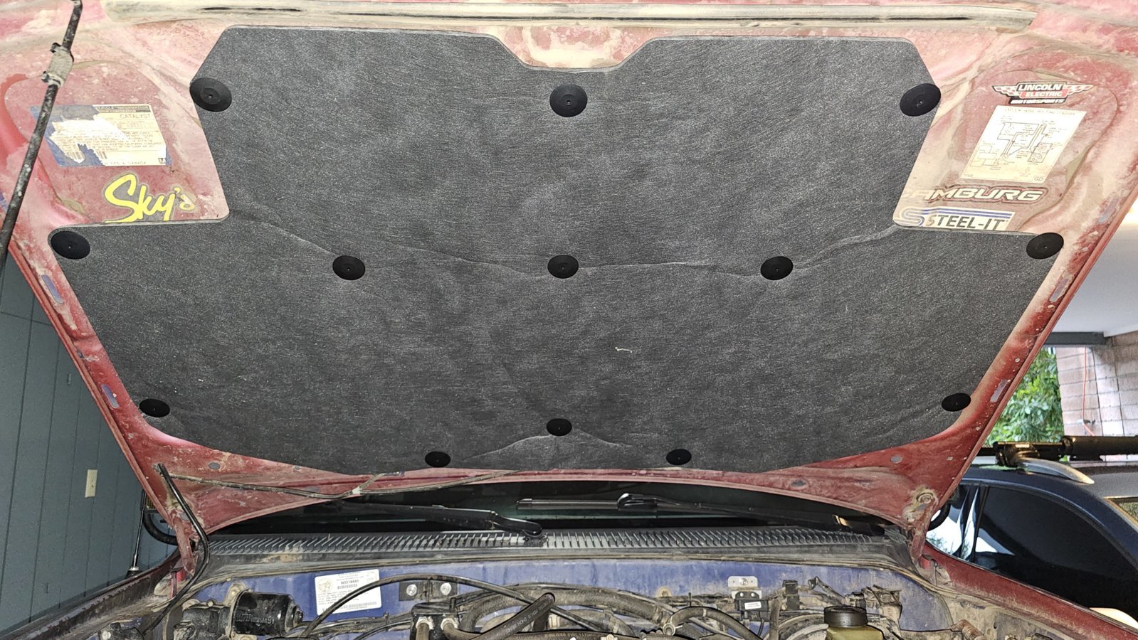

    I pretty much only got it for the sound deadening properties. I don't need the added insulation where I live, but can't have one without the other

    Can you notice a difference in the sound?

    Seems a bit quieter when I'm not in boost just cruising around town.

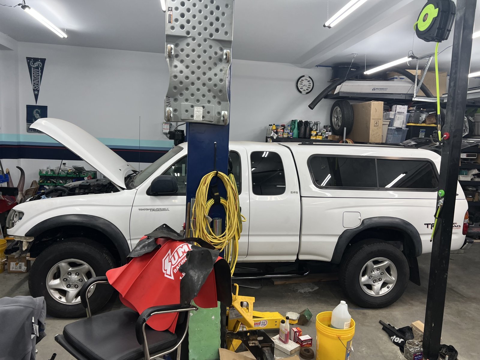

    IMG_1445.jpgFinished friend’s frame swap, all that’s left is the nerf bars, front bumper and grill. Overall took a bit longer than I thought, but hard to get a lot done working 5-6 hours on Saturdays and Sundays.
    Good practice too, I’ve got a replacement cab and bed sitting beside my garage and an engine on the stand waiting

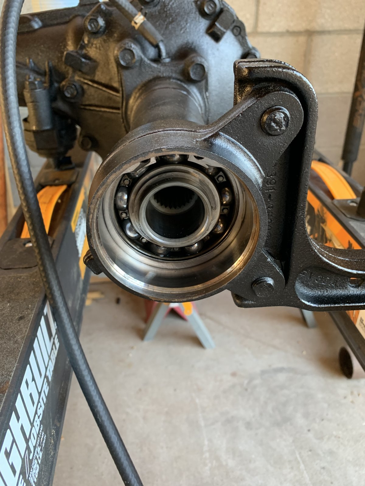

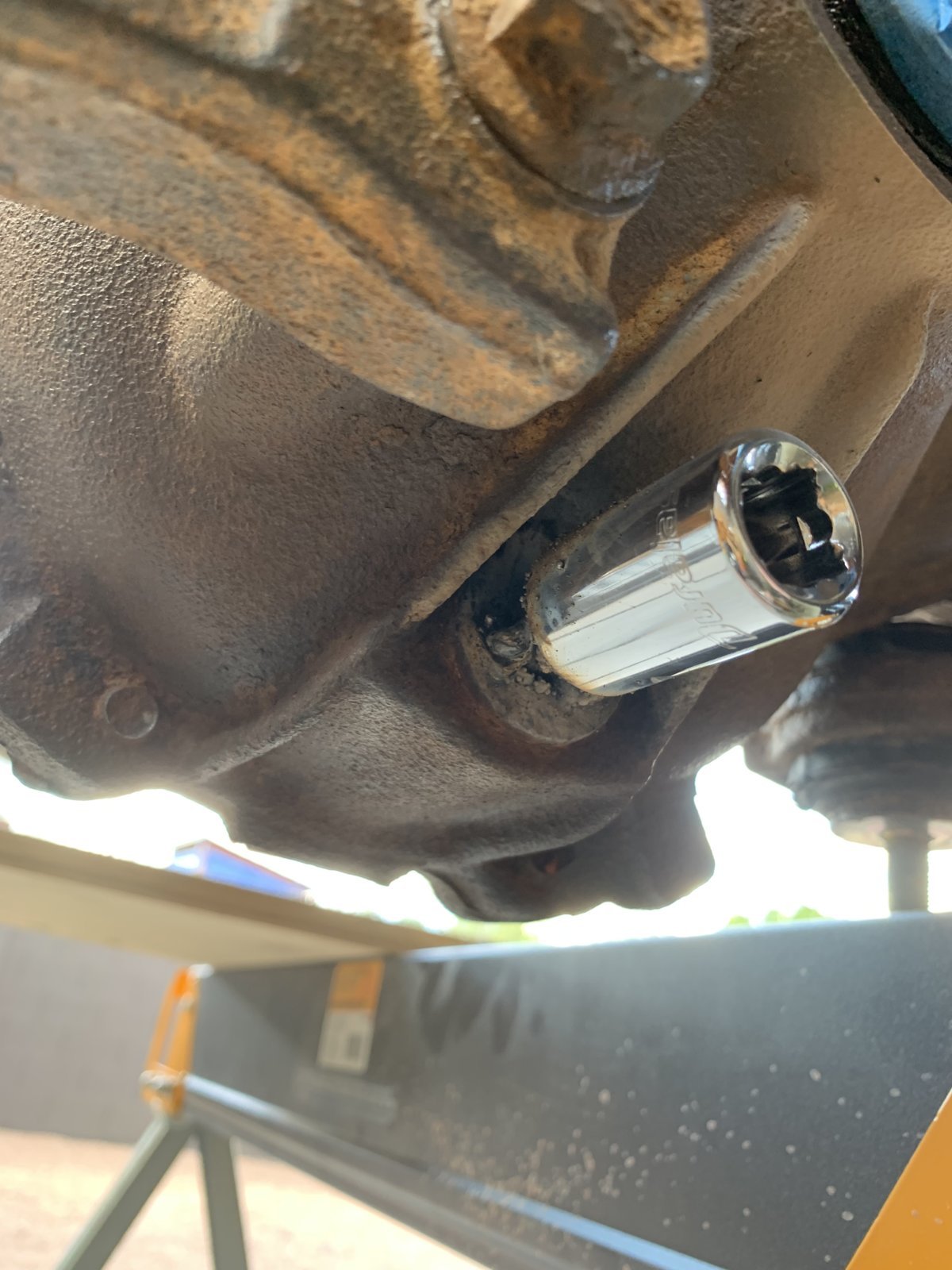

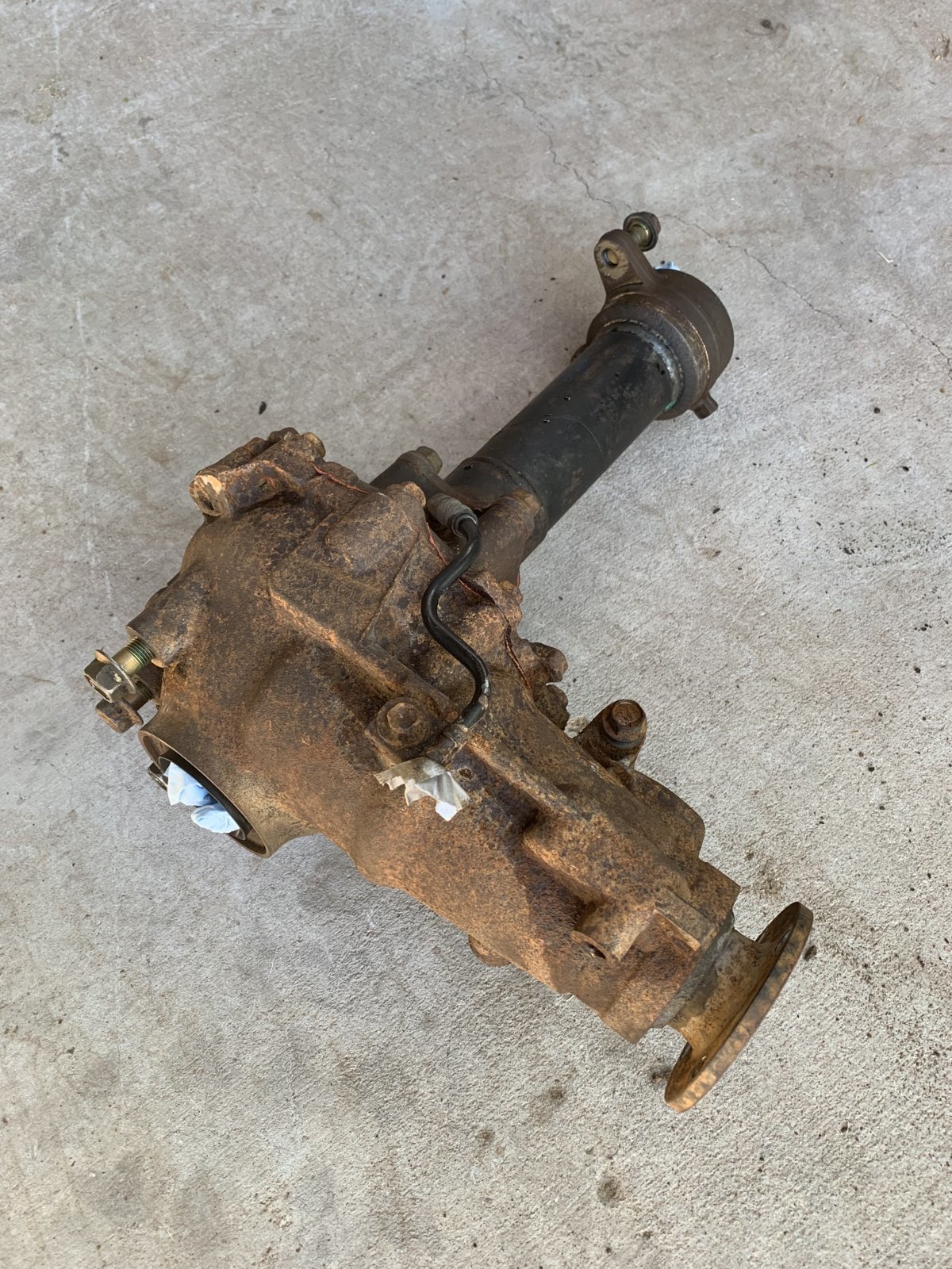

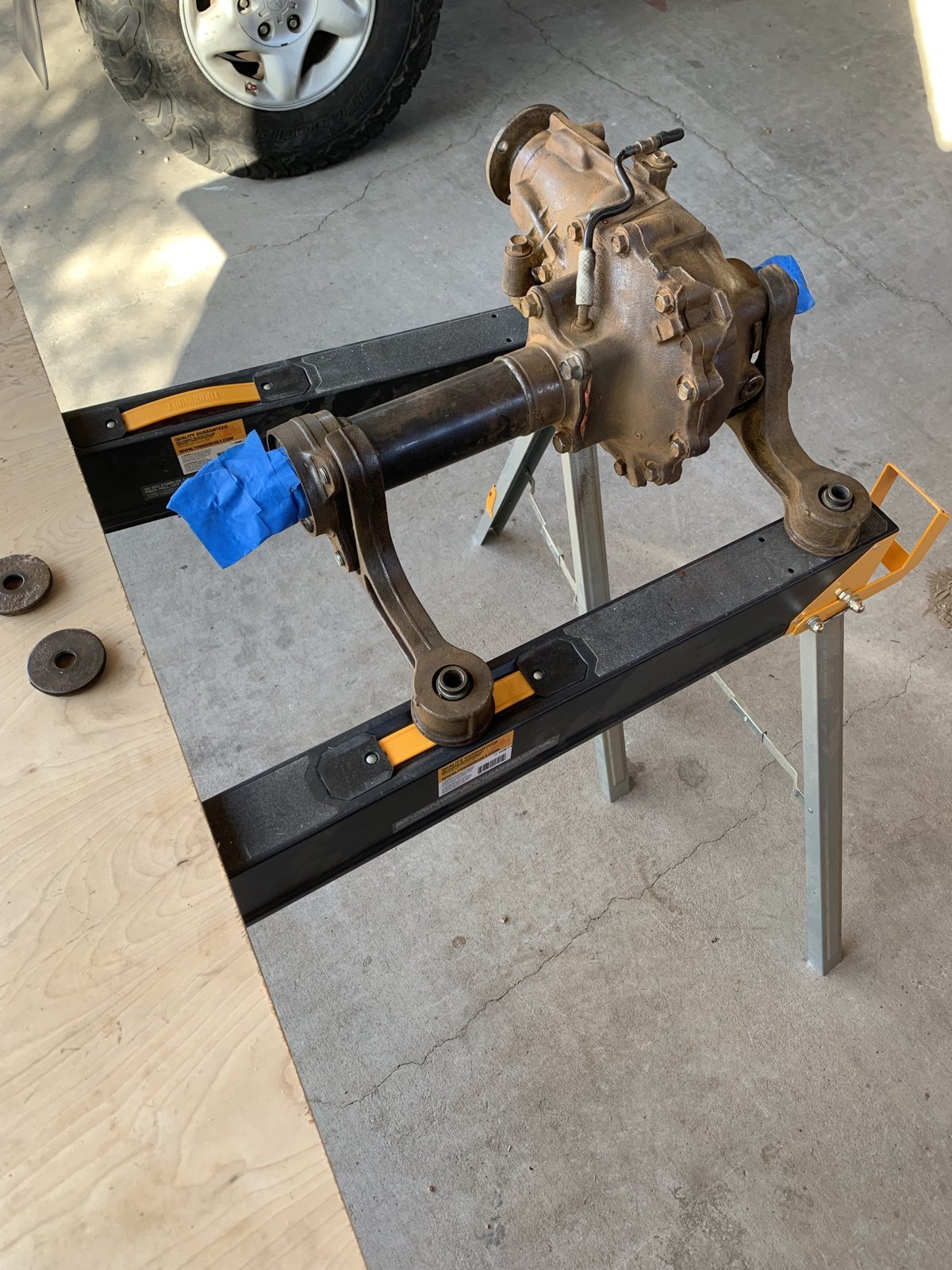

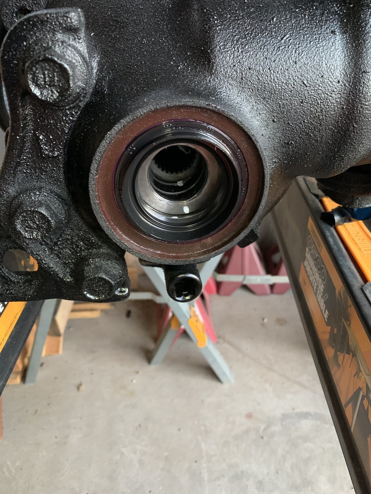

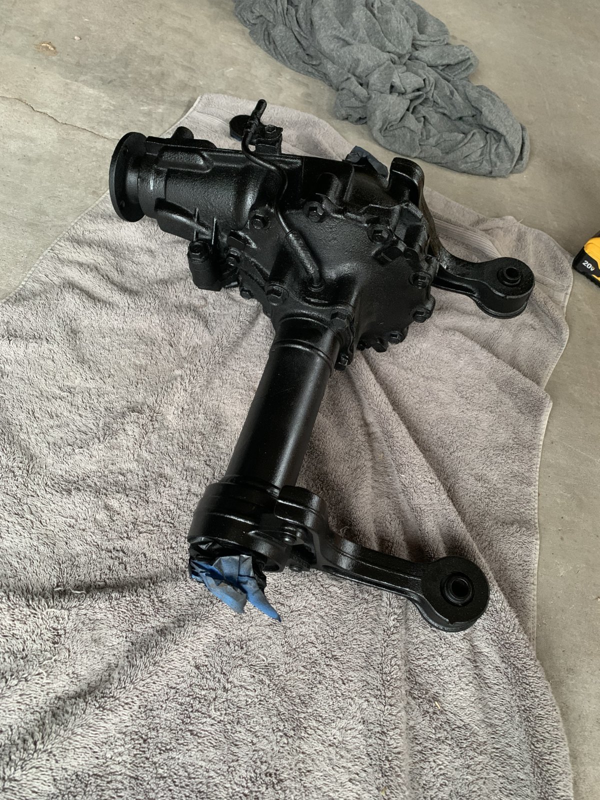

    Finished up the front diff restoration project. Wire wheeled the rust and painted with Eastwood rust encapsulator then chassis black. I had to weld a hex key socket into the drain plug to break it free. Just waiting on the Lexus plugs to come in now.

    Nice, I welded a nut for the same reason.
    You can swap it out for the lexus one which has basically a nut on it instead of the allen head. Toyota 90341-24016

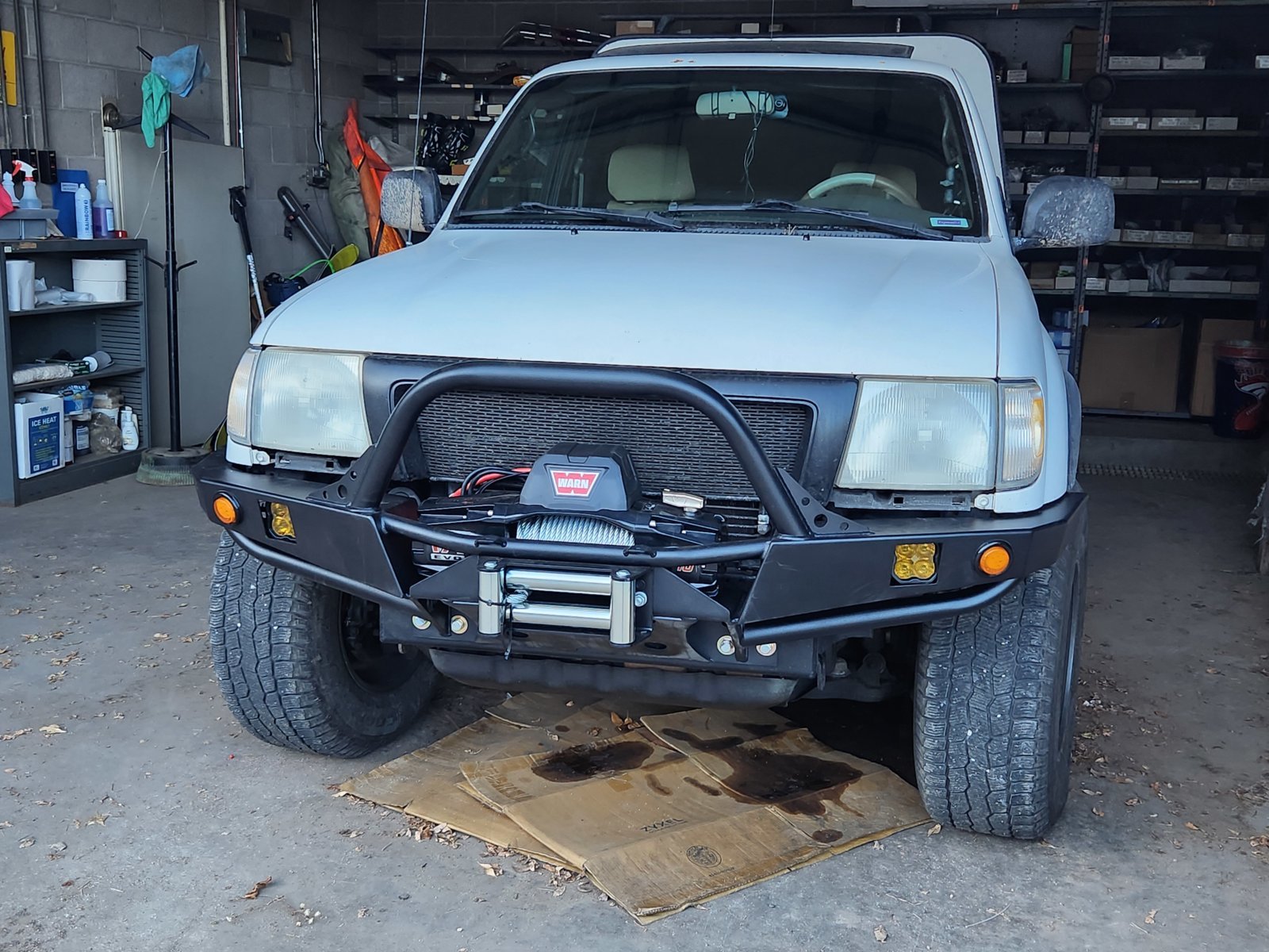

    Finally got the new bumper mounted last night. Now back to the auxiliary wiring project

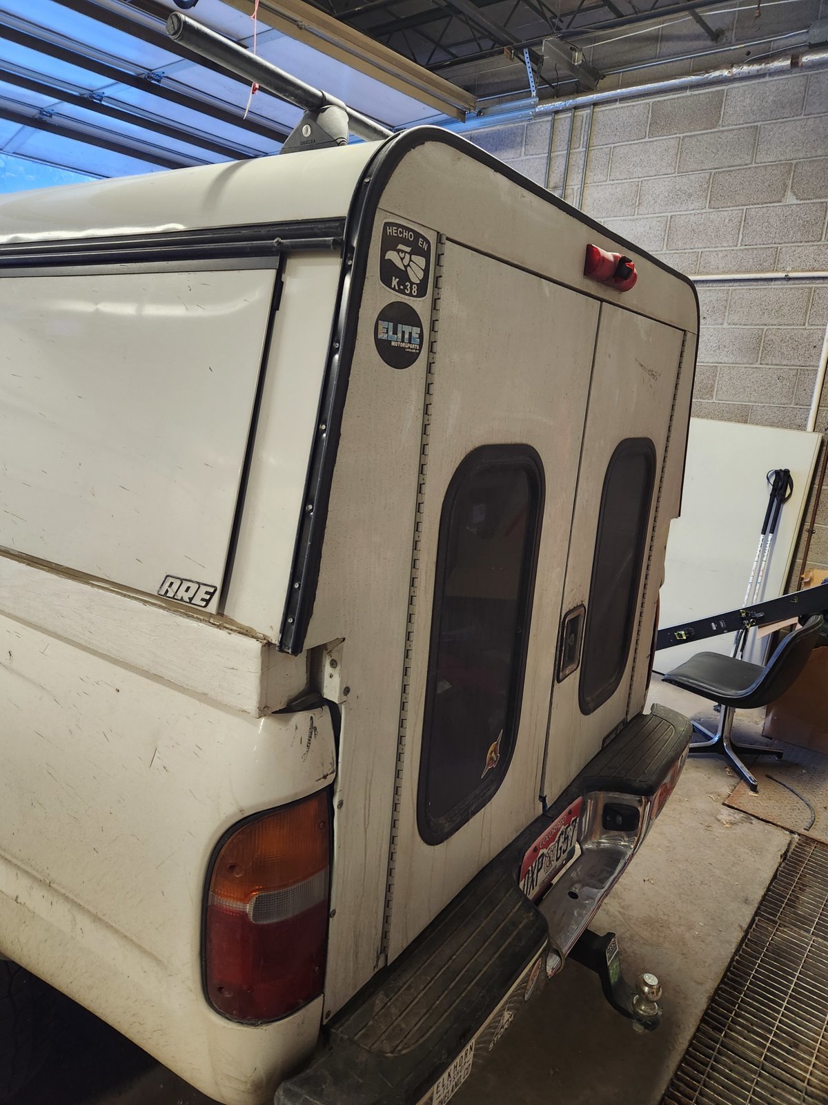

    What camper is that?

    Looks like an aluminum contractor cap

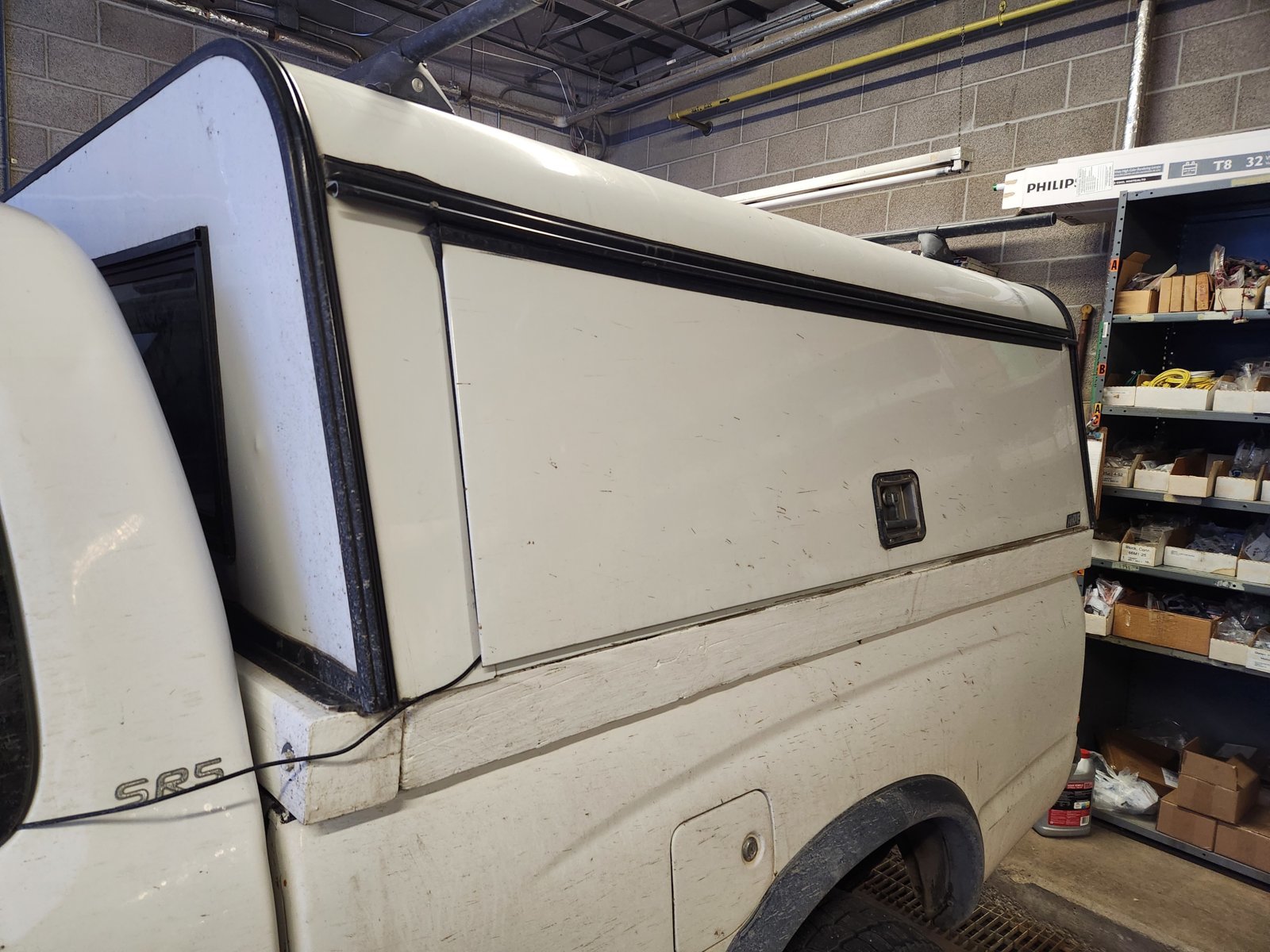

    You are correct. It's an ARE commercial cap. I think it came from a 2015 Chevy Coloado. It was mounted by the previous owner... he got creative to make it work. The bed rails were raised by bolting on 4x4 deck posts, and a couple inches were cut off the bottom of the back doors to clear the bumper.

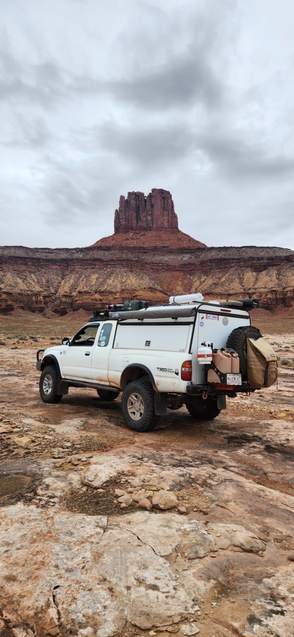

    Funny you should ask because mine came off of an S10 pick up.

    Looks like a great fit. What year? Did you have to modify to fit?
  19. Dec 8, 2023 at 8:39 PM
    Phessor
    Phessor Well-Known Member
    Feb 15, 2014
    #123156
    3,599
    I installed a 1" piece of aluminum angle to the front for a better seal.
    The back door frame was two layers of 1" square tubing, I cut the inner section out to be able to slide the shell forward an extra inch.
    The S10 has an angled bed, it gets narrower at the rear, this was not a problem though.
    I pickup my new OVRLND camper in a couple of weeks, so I no longer need this one.
