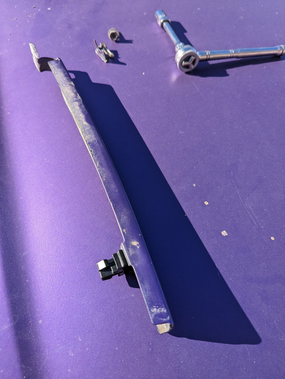

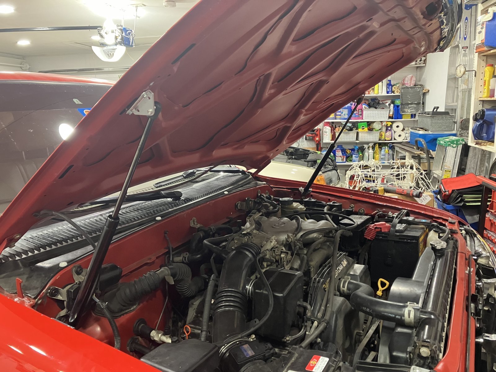

    Finally got around to installing lift struts on the hood to eliminate the prop rod!
    Bye bye prop rod.
    These are the struts and brackets that I used
    Hood Prop Rods
    Hood Prop Rod Brackets
    The hood bracket on the passenger side was not initially set up properly so I made the best of it. The original rivnuts were placed with not enough gap for the strut to fully collapse. :annoyed:
    M4 rivnuts and m4x10mm bolts were used to fasten the brackets.

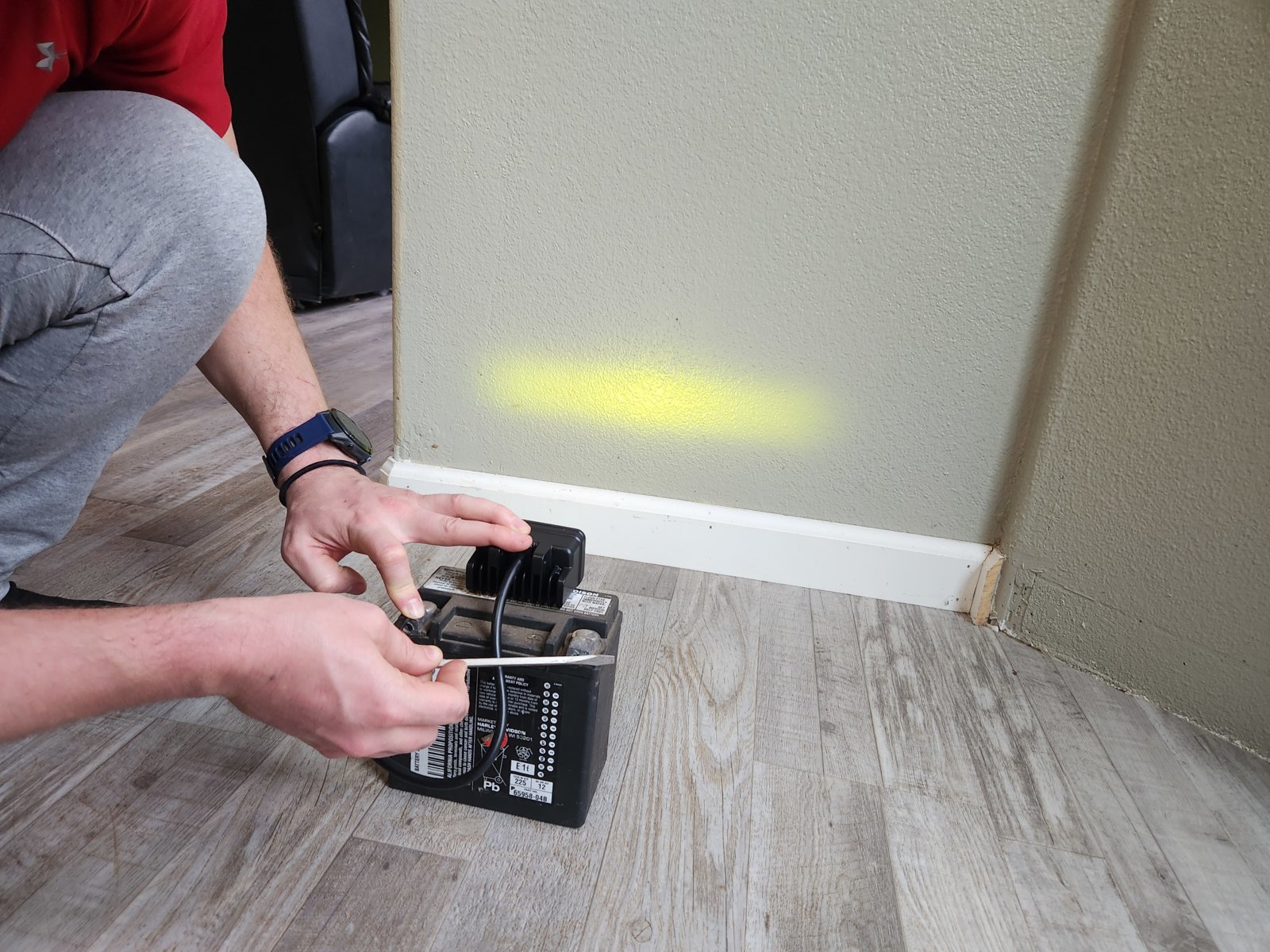

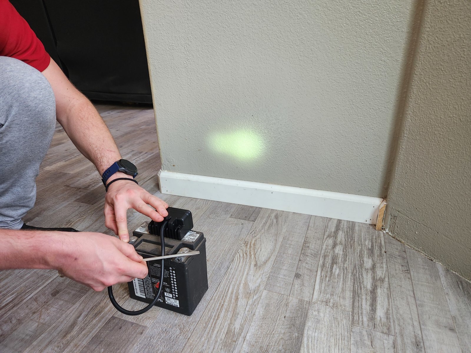

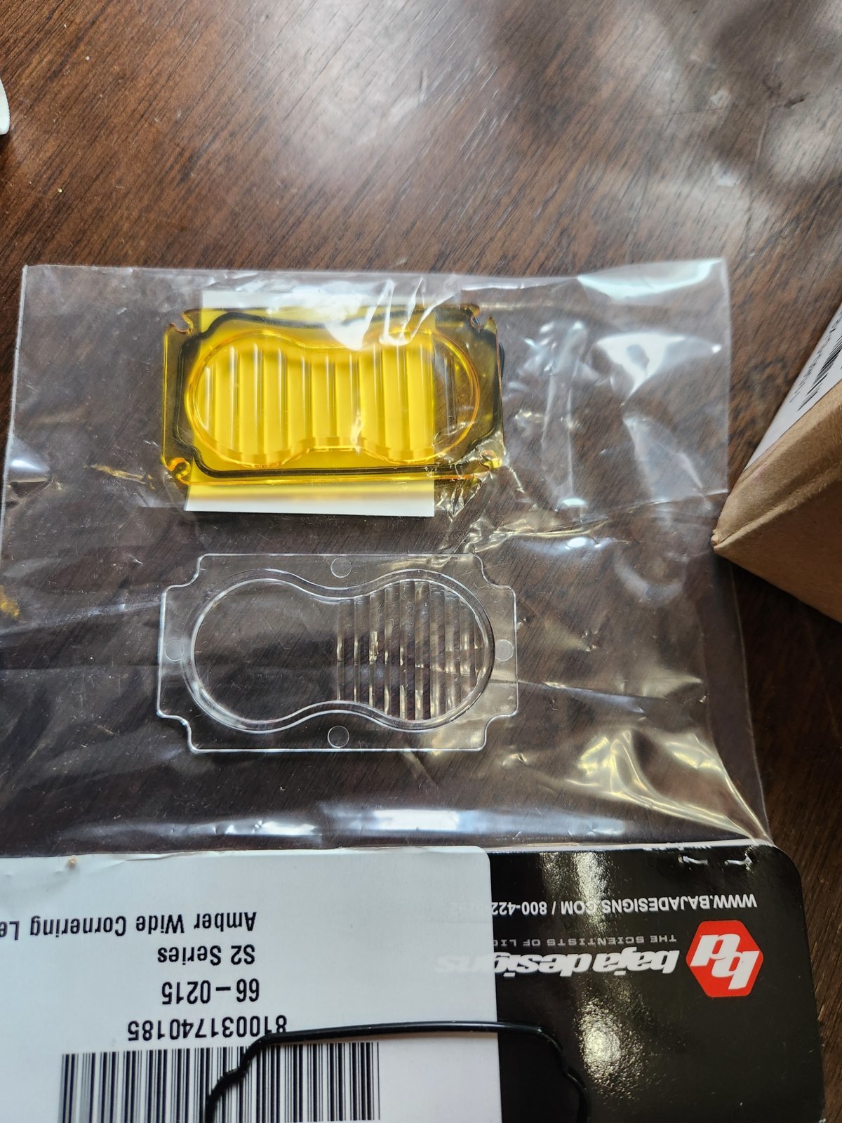

    Not on the truck yet, but put Baja designs lenses on Amazon special "S2" very impressive difference.
    Stock lense.
    BD wide cornering amber.
    Lenses.
    Link to the lights: Auto Power Plus LED Pods, 2Pcs 40W 3 Inch Driving Light Bar Off Road Spot Light Super Bright Work Light Cube LED Bumper Light Pod Fog Light for Truck ATV UTV Motorcycle Boat Offroad https://www.amazon.com/dp/B09NPNTNTD

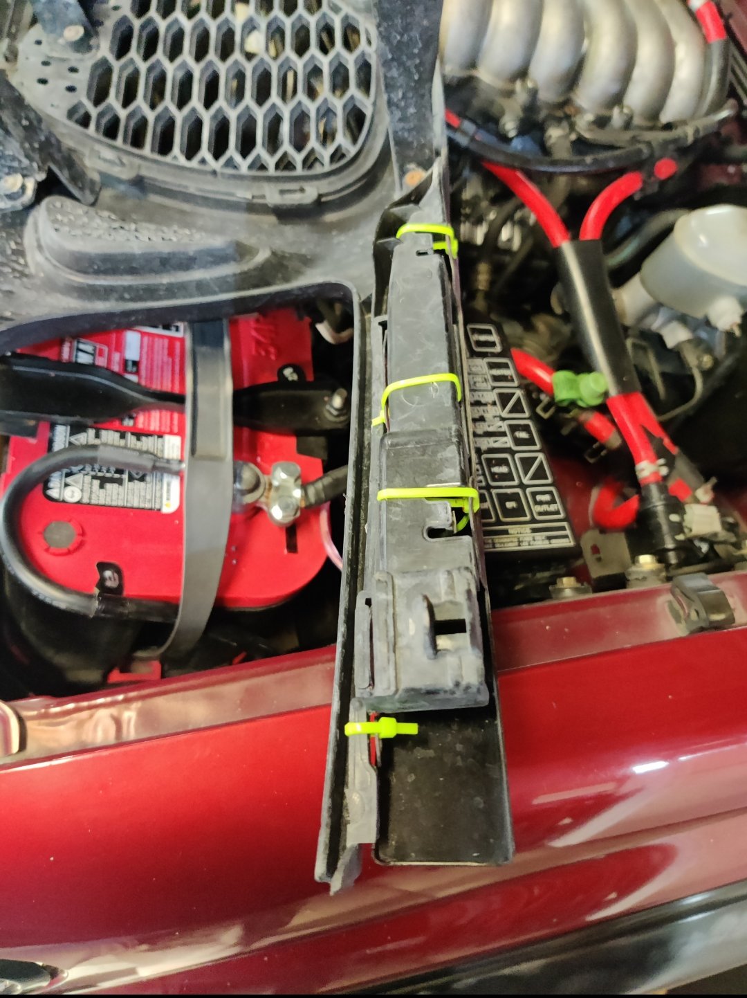

    It's not hard to get them to stay with a couple hidden zip ties.

    Set it up like that a while ago, you don't see the zip ties at all from the front. I have single piece head lights so the grill end has been trimmed but It should still work

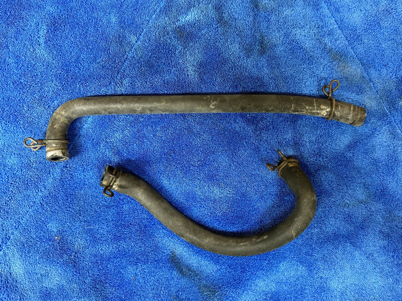

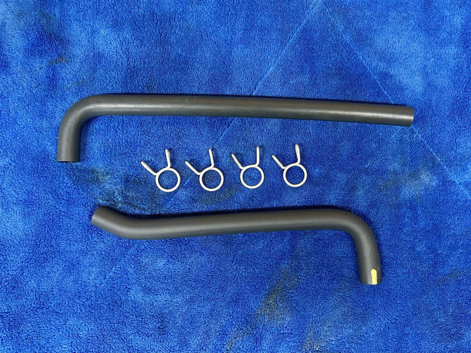

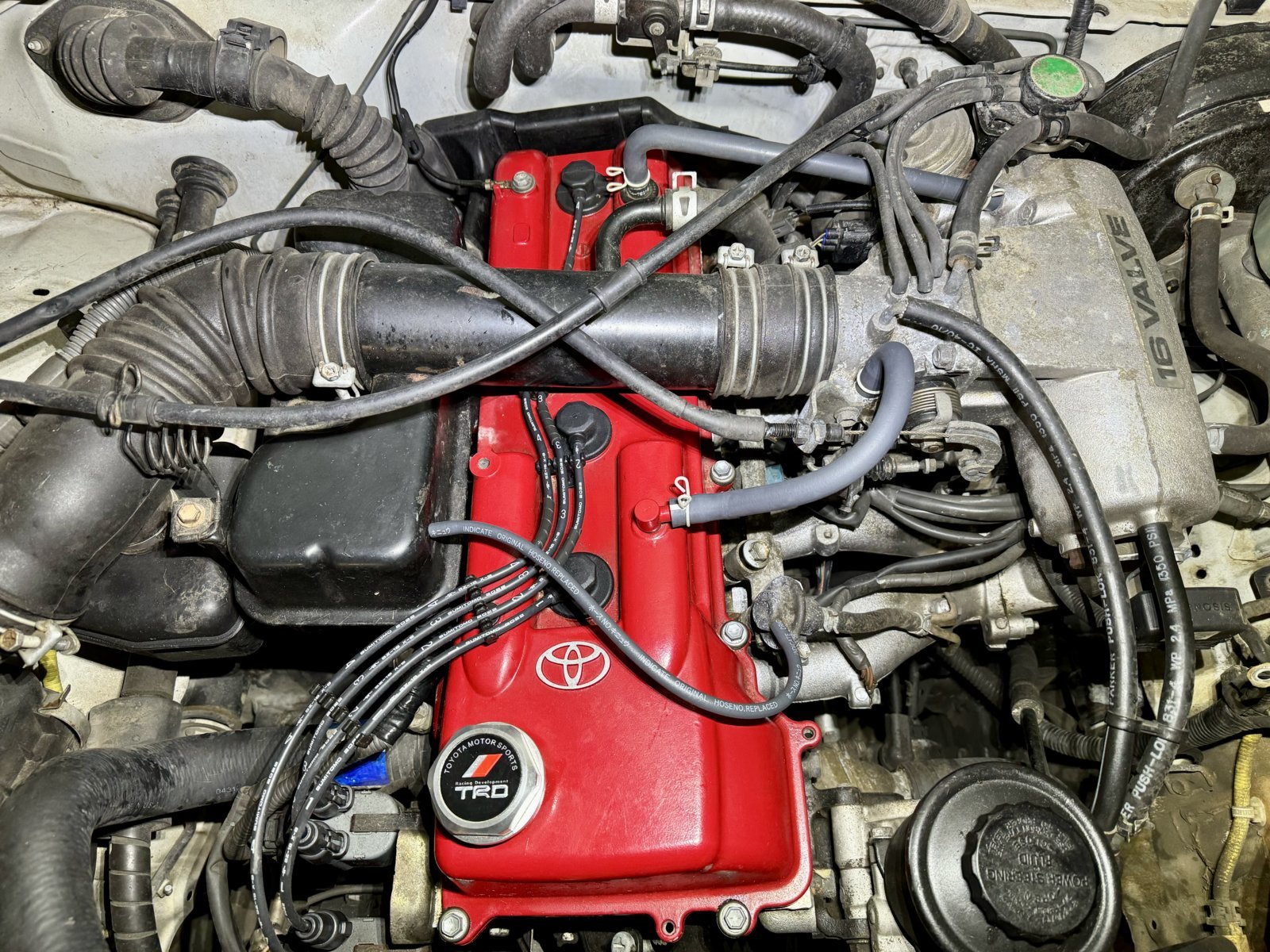

    I picked up 5hp by replacing my Breather hoses and clamps.

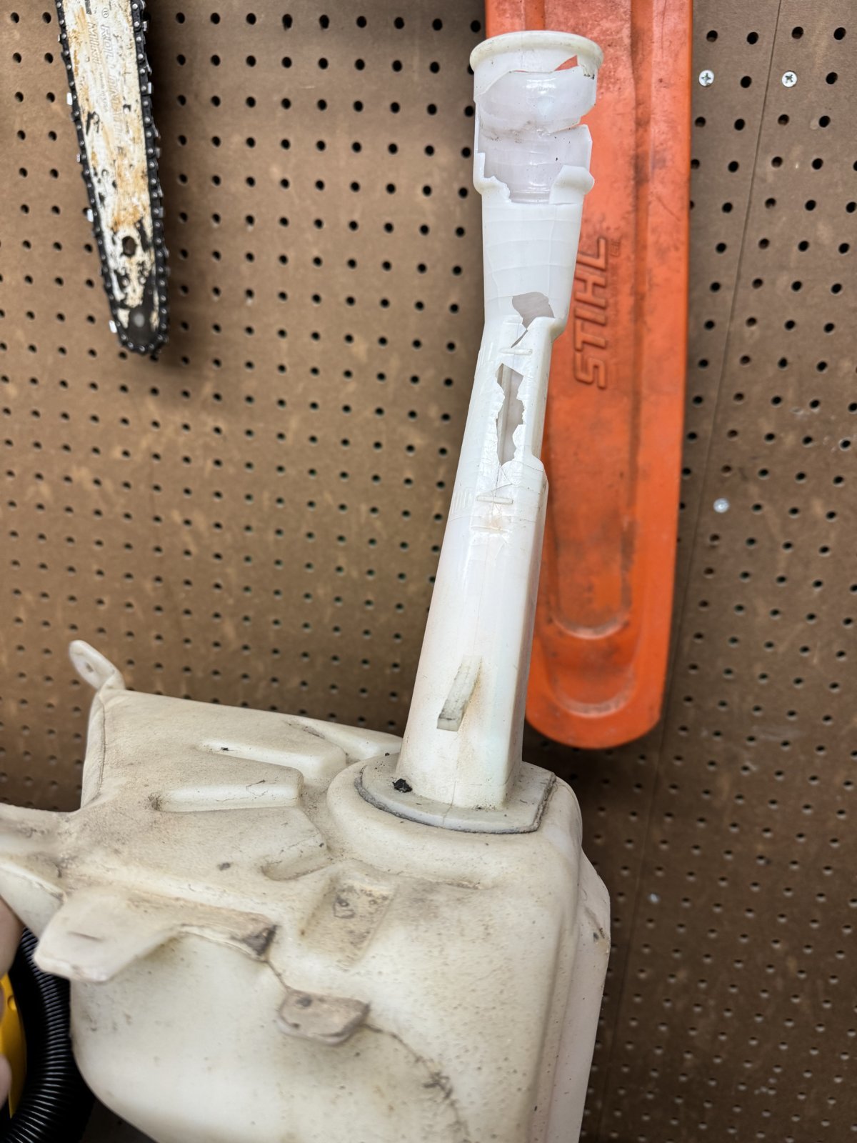

    Then replaced my broken Washer Tank with a new OEM one.

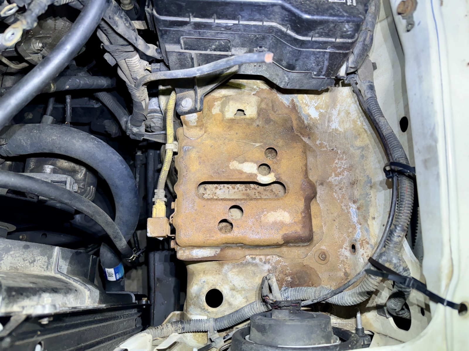

    Then opened up a can of worms with fixing the surface rust under the battery :frusty:

    Don't get rid of that washer fluid tank! I've heard people say the new ones are just as bad and you're lucky to get 1-2 years out of them, it becomes an annual expense. I fixed mine by putting a balloon animal balloon down the throat and fiberglass around what was left of the neck. Now at least I'm not worried about replacing it

    That’s not a bad idea. I was trying to try ink how to repair it in the current state.
    The bottom tank part is built like a military gas can, but the neck is the cheapest, most brittle plastic imaginable.
    I was going to do the relocation option, but I have cruise control, so there is no where to mount the tank under the hood.

    I got this tank.
    https://amzn.to/48eLJGo
    (I can't see how a new tank would be as bad as a tank that is disintegrating)

    I just meant maybe don't throw the old one away yet, since ive seen people online say that new ones aren't made as good you might want to try and repair the old one in the future

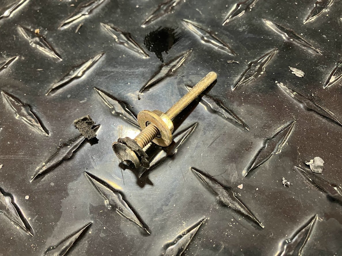

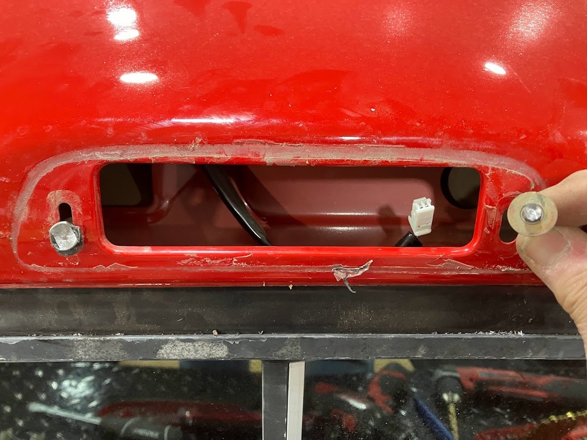

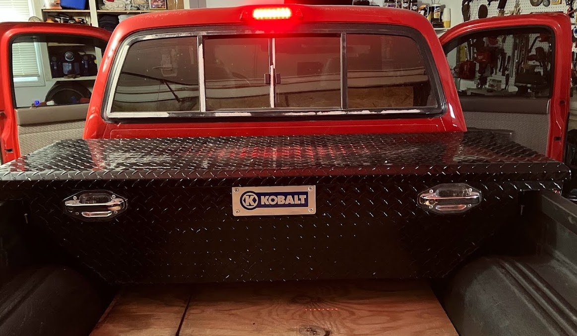

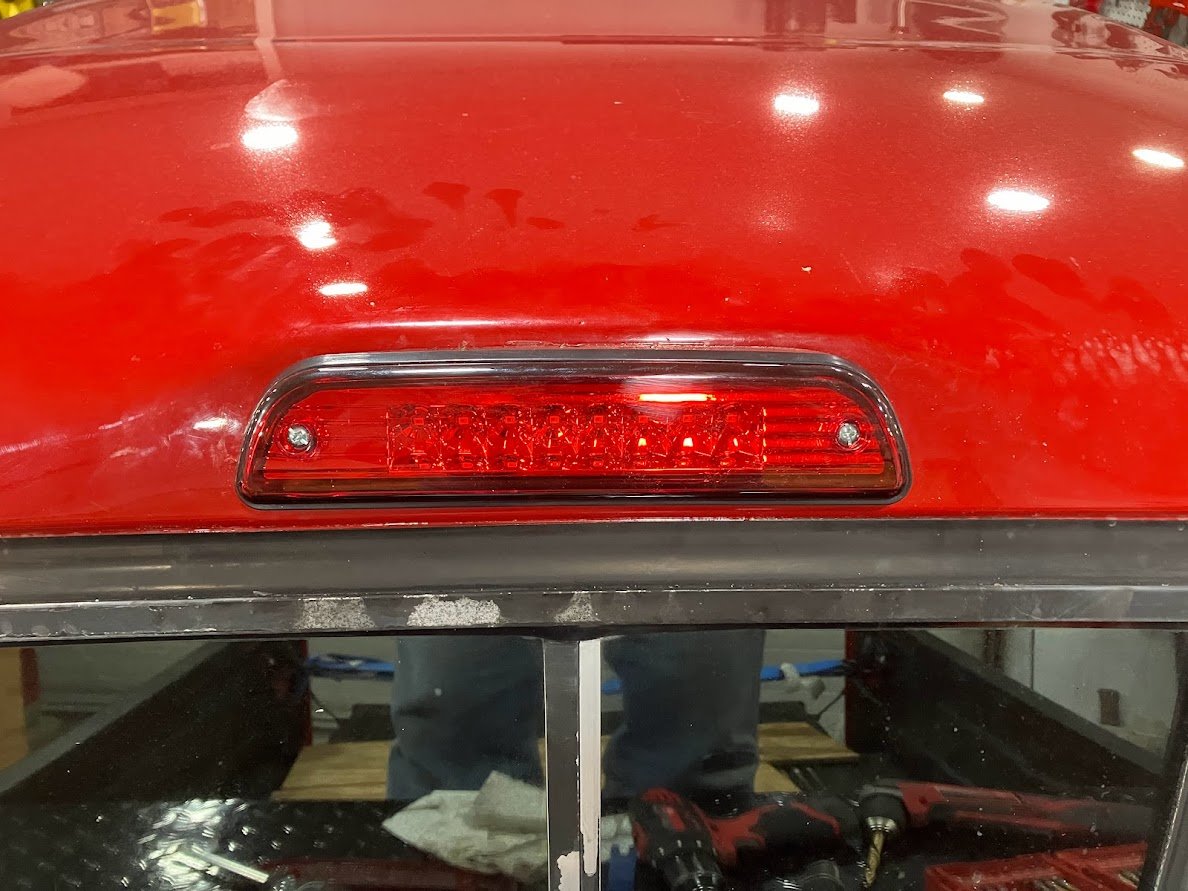

    I finally tackled the high mount brake light LED swap.
    Drilled off the heads of those fasteners to allow removal of the brake lamp housing without headliner removal gymnastics.
    Fastened LED housing with clip nuts/tinnerman retainers.
