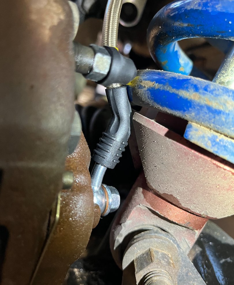

    I installed some Stoptech brake lines. After installing I noticed that the lines rub on my coilovers (Camburg/Sway-a-Way 2.5) at full lock. There are wear marks on the rubber lines I removed that make me think this is a problem with the coilovers and not the brake lines.
    Has anyone else seen this problem? @Speedytech7 I think you have the same coilovers.
    I'm wondering if I should flip the banjo fitting 180 degrees so the line angles toward the caliper instead of away. I'm worried that this might put the line too close to the wheel. The rubber lines had the line angled away from the caliper. They had an indexing tab, so I'm sure they were installed correctly.

    I have the same lines too haha. They don't have an alignment Tang like the factory ones so I chose to just angle them backwards so that the curve of the line fitting didn't smack the coil over.
