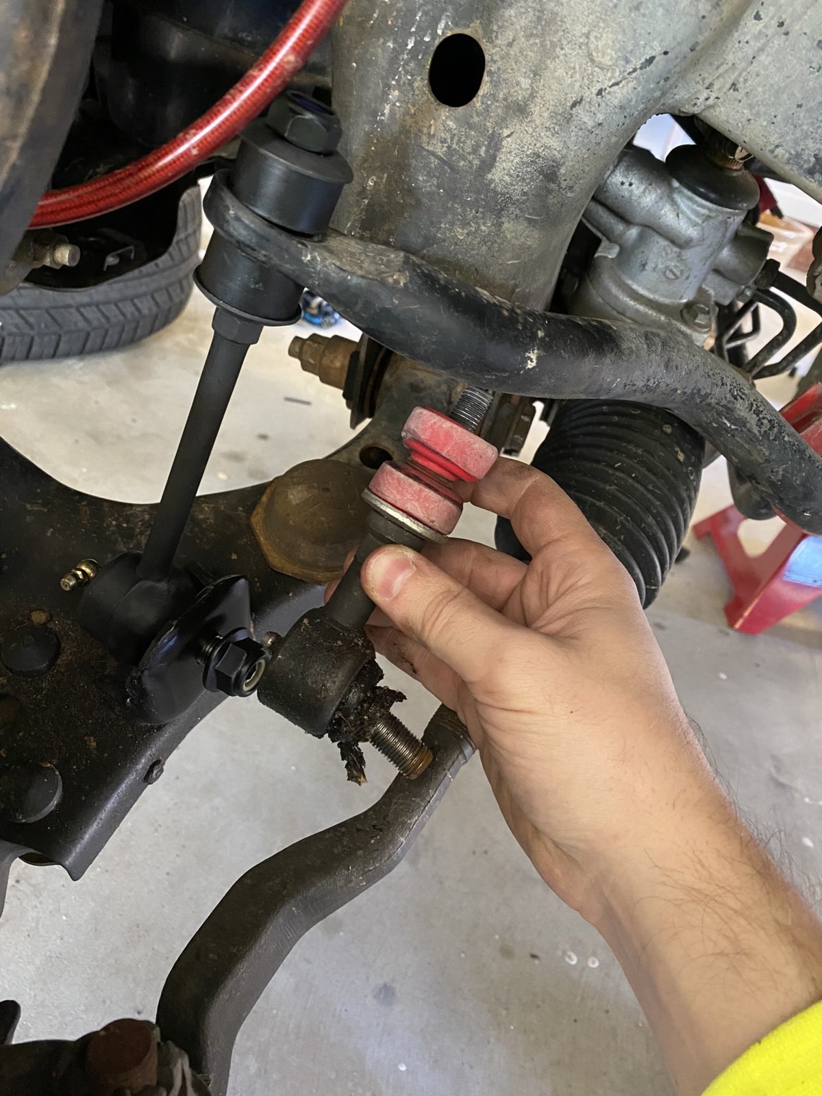

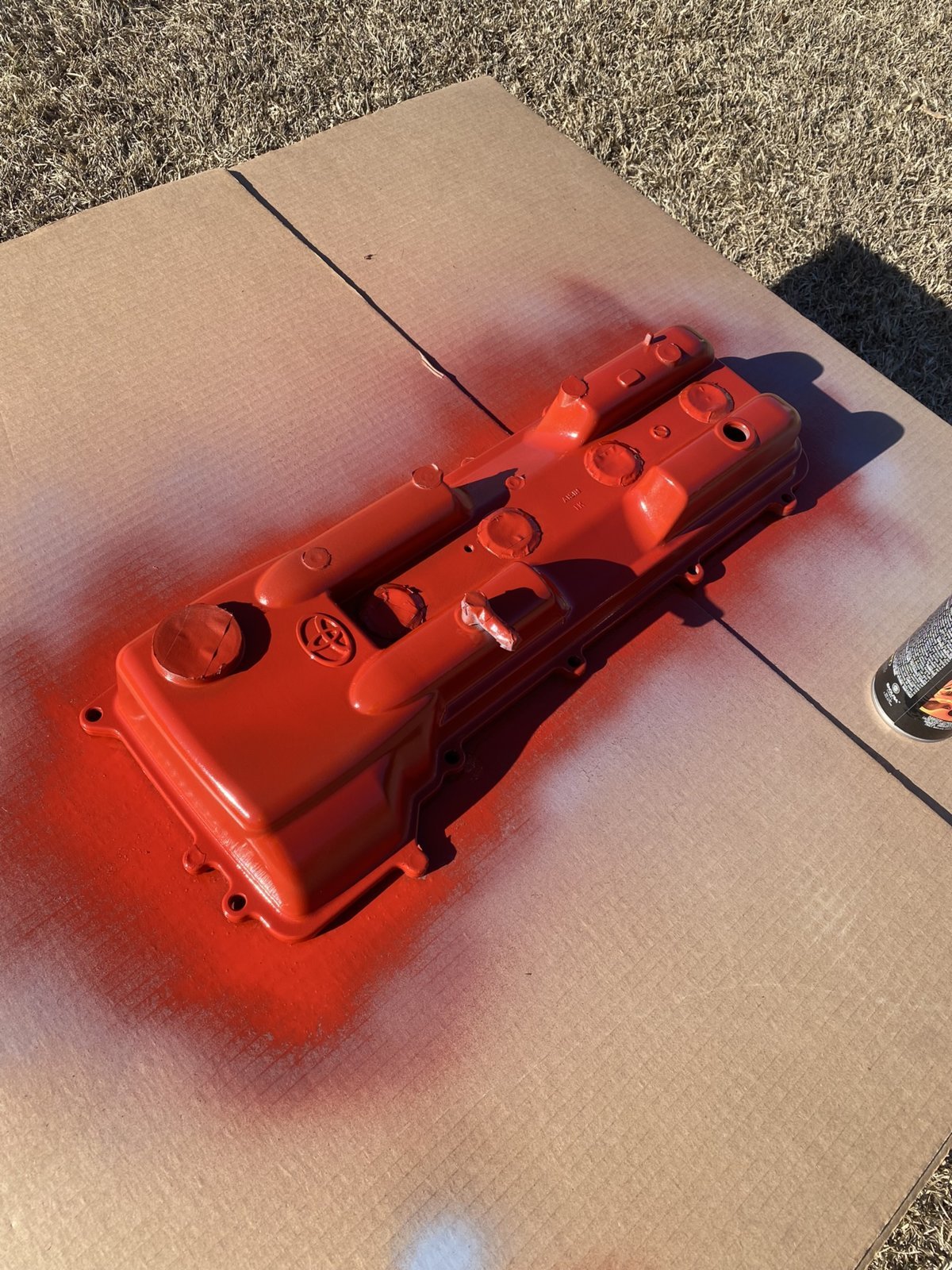

    Some pre-Christmas work... replaced my long overdue broken sway bar links with long ones from a 2000 Tundra. Direct bolt in super simple. Also finally got around to painting my extra valve cover, will be installing that in the next month.

    Hi Chris,
    What is the benefit of the longer sway bar links?
    Just curious to understand if I should consider them as well.
    Thanks.

    Better articulation from my understanding. From the research I did, one wants their sway bar to be like 10ish degrees or whatever. When I was off-roading about a month back I ripped both links clean off there wasn't enough travel.
    I'll find out in about 2 weeks when I take it off-road again, $40 "fix" hopefully.

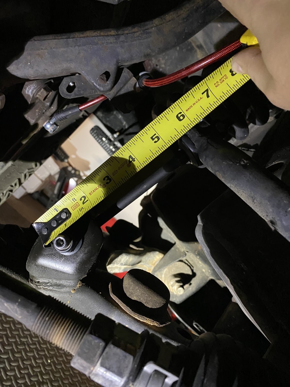

    how long are the tundra links? ball to bushing mount

    Hope this helps? Looks like right around 5in, haven't taken it on the road yet to see how it feels but will know after I replace the master cylinder tomorrow and road test.

    Hint: just take em off and never look back. Way smoother ride. You get used to the body roll. Or get some nice shocks/springs and you won't notice it.

    I've come full circle and vastly prefer the ride with the bar. Even on most dirt roads... QD is definitely the answer.

    I think off-road no sway bar is much more soft on baseball size rocks and two track in my 2nd Gen with oem shocks. My wife’s 3rd Gen t4r has kings and no sway bar and it feels planted on road (no off-roading yet - gotta re-redo a leaking front diff seal). I’d say experiment and see what you think for yourself - I may do that once I repair my wife’s vehicle.

    I thought the same thing, but after road testing the tundra links today it was a vastly different ride. Much more controlled and I was able to take faster sharper turns and stay much more planted. I've got OME coils/leafs and nitrochargers along with UCAs and replaced pretty much all the bushings I could find as well.
    I looked for QD but couldn't find anything for the 1st gens. Is it even an option?

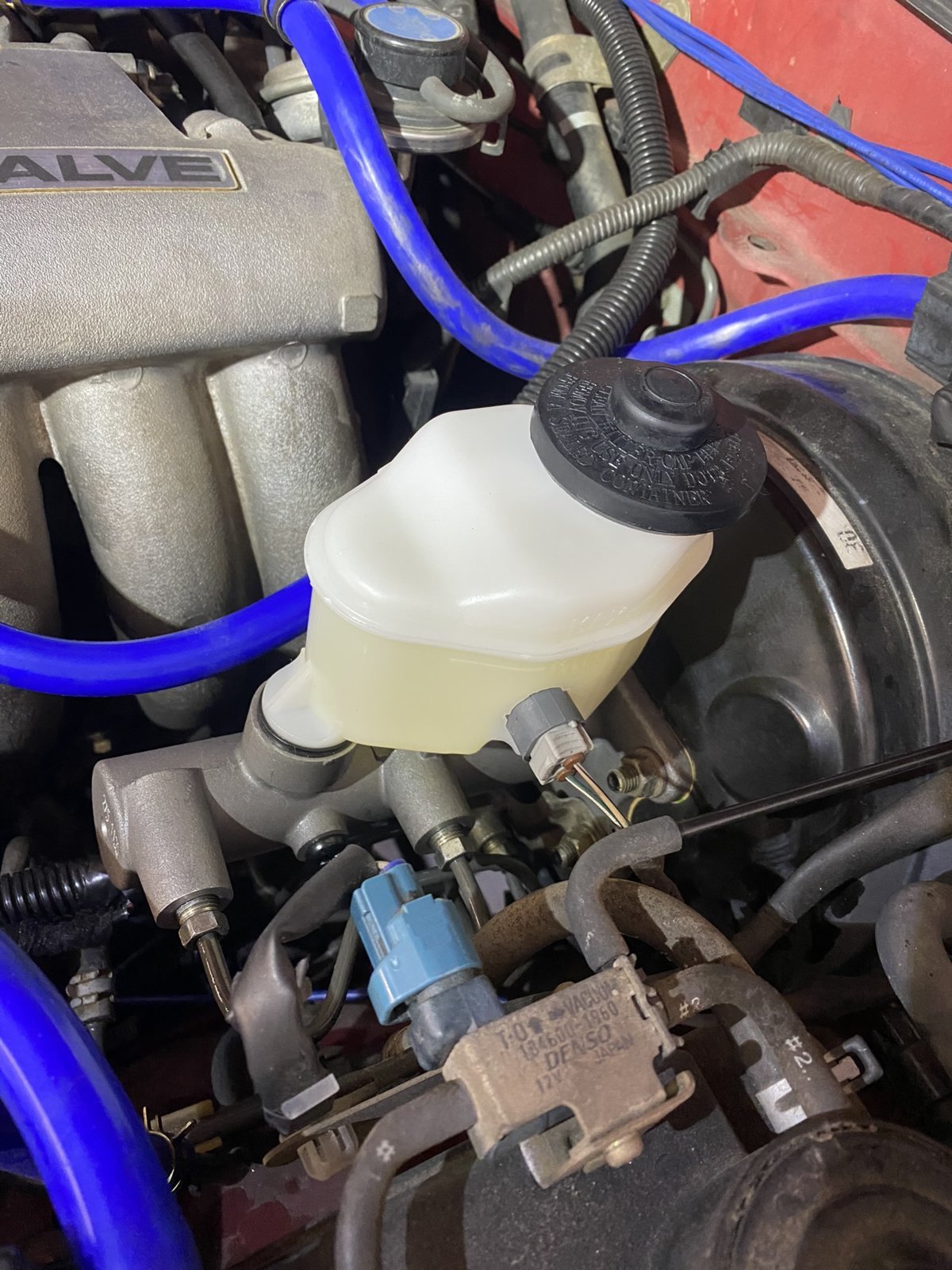

    New master cylinder installed. It was relatively straightforward replaced the paper gasket behind it. Bench bleed was simple took less than 5min install less than 2 hours including bleeding after. Peddle feels pretty much the same though but doesn't continue to sink as it did before.
    Who knew brake fluid wasn't supposed to be dark brown and full of solids?

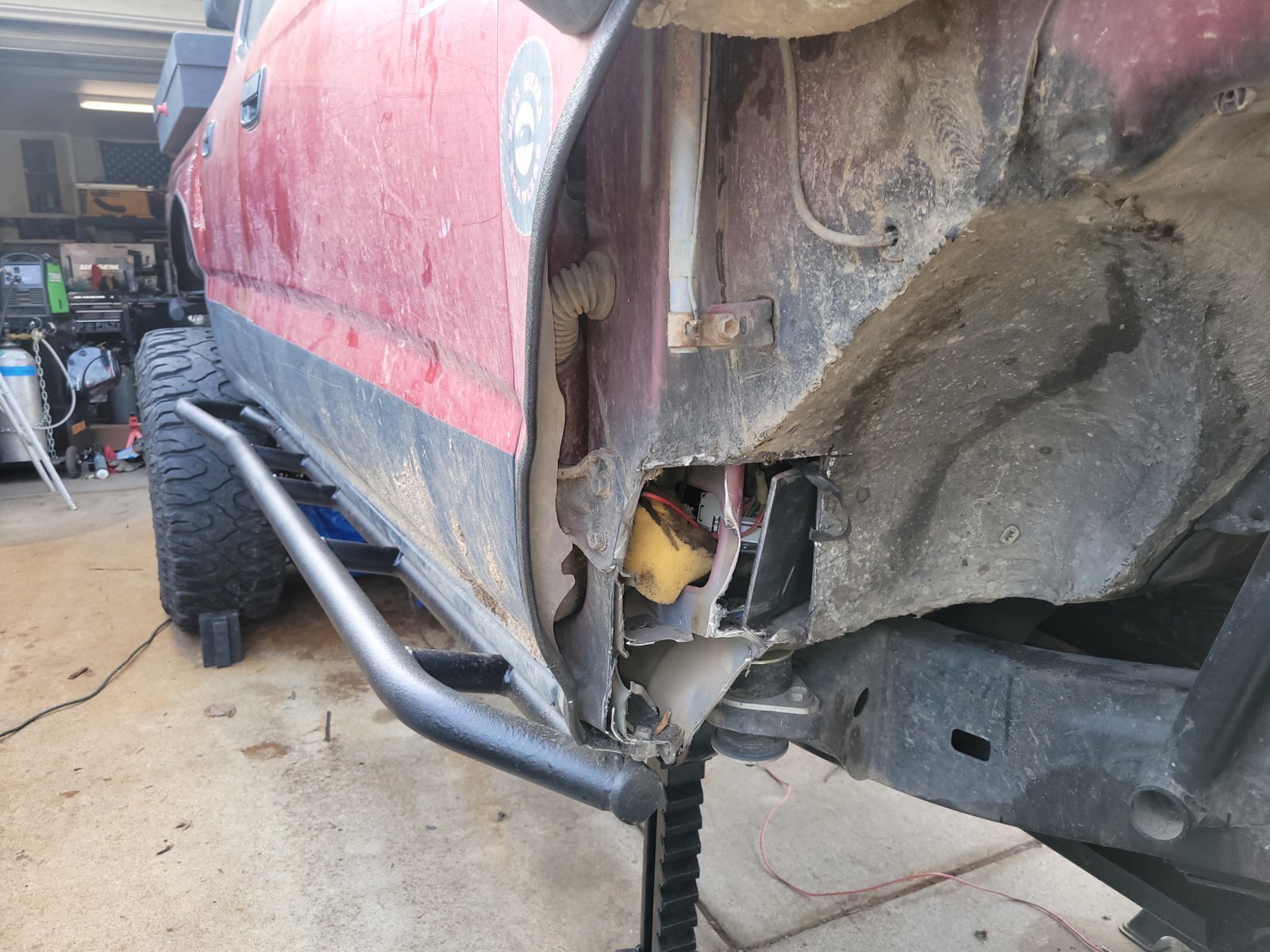

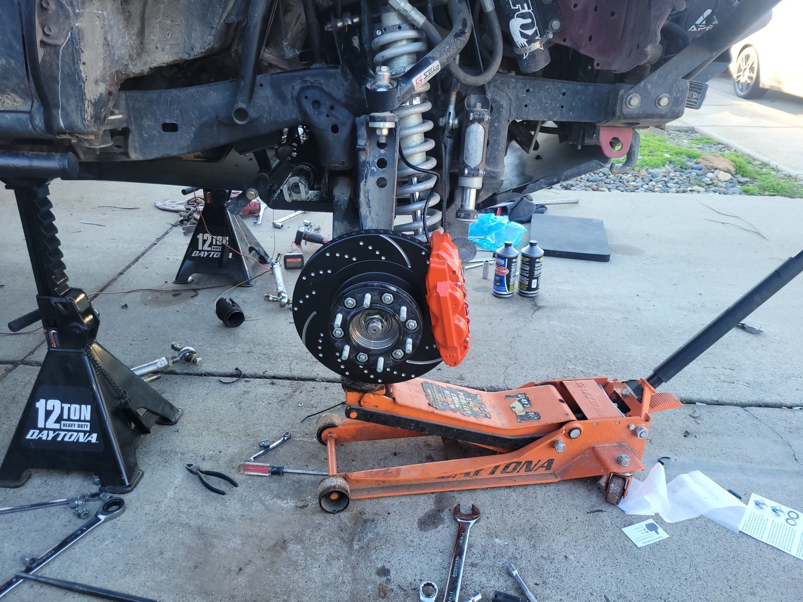

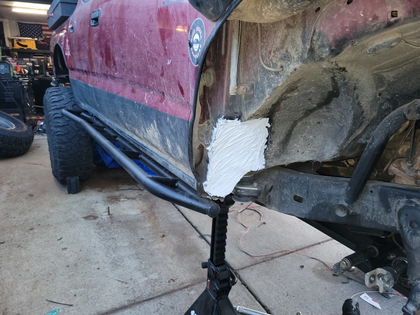

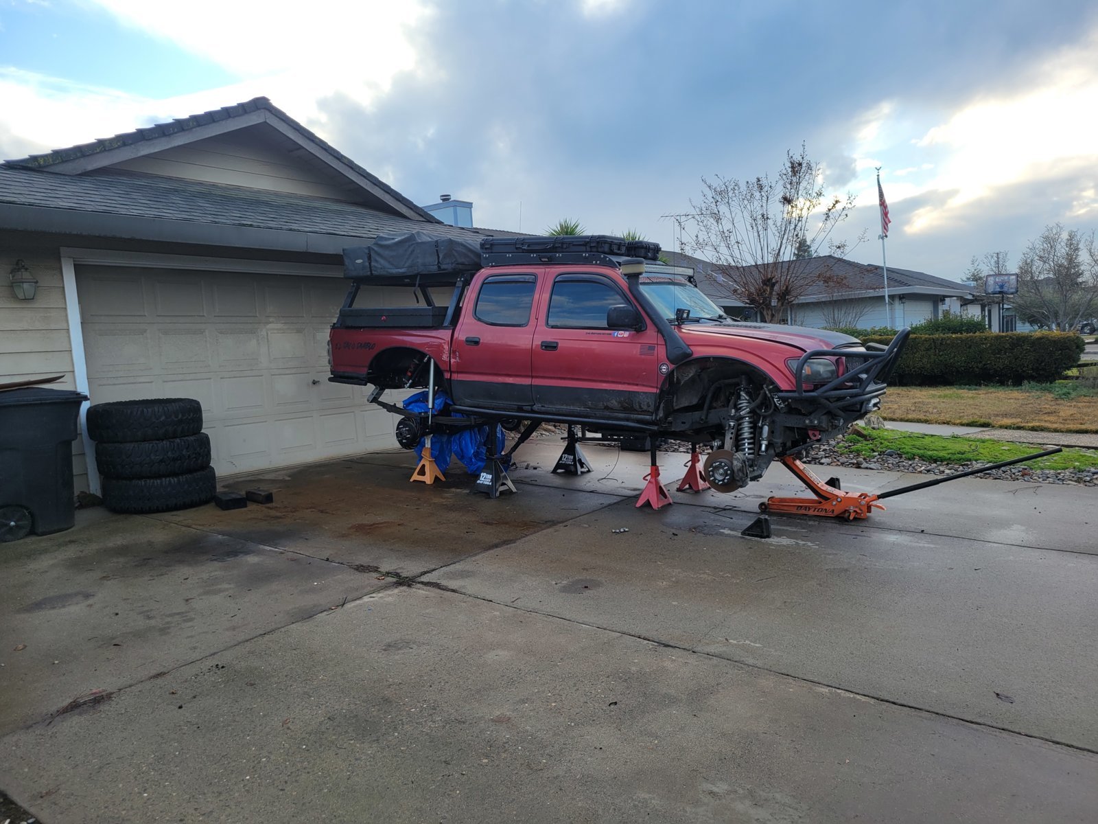

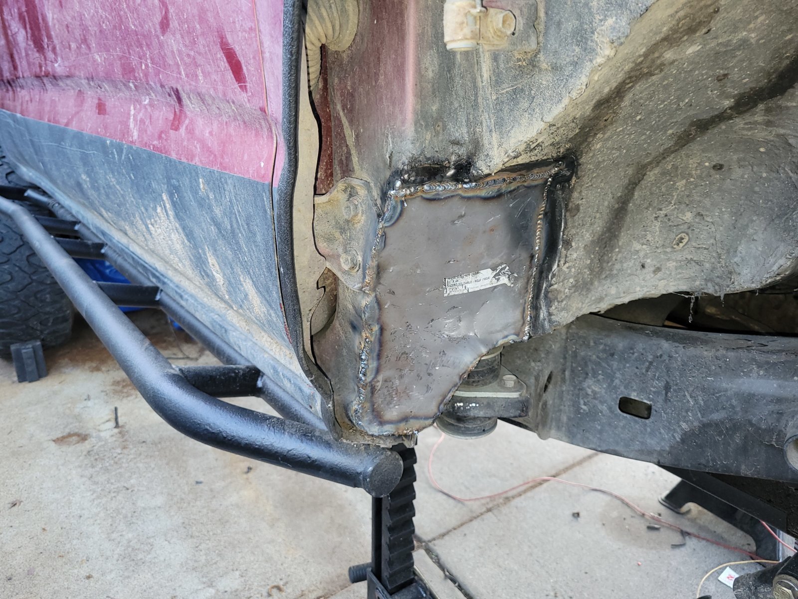

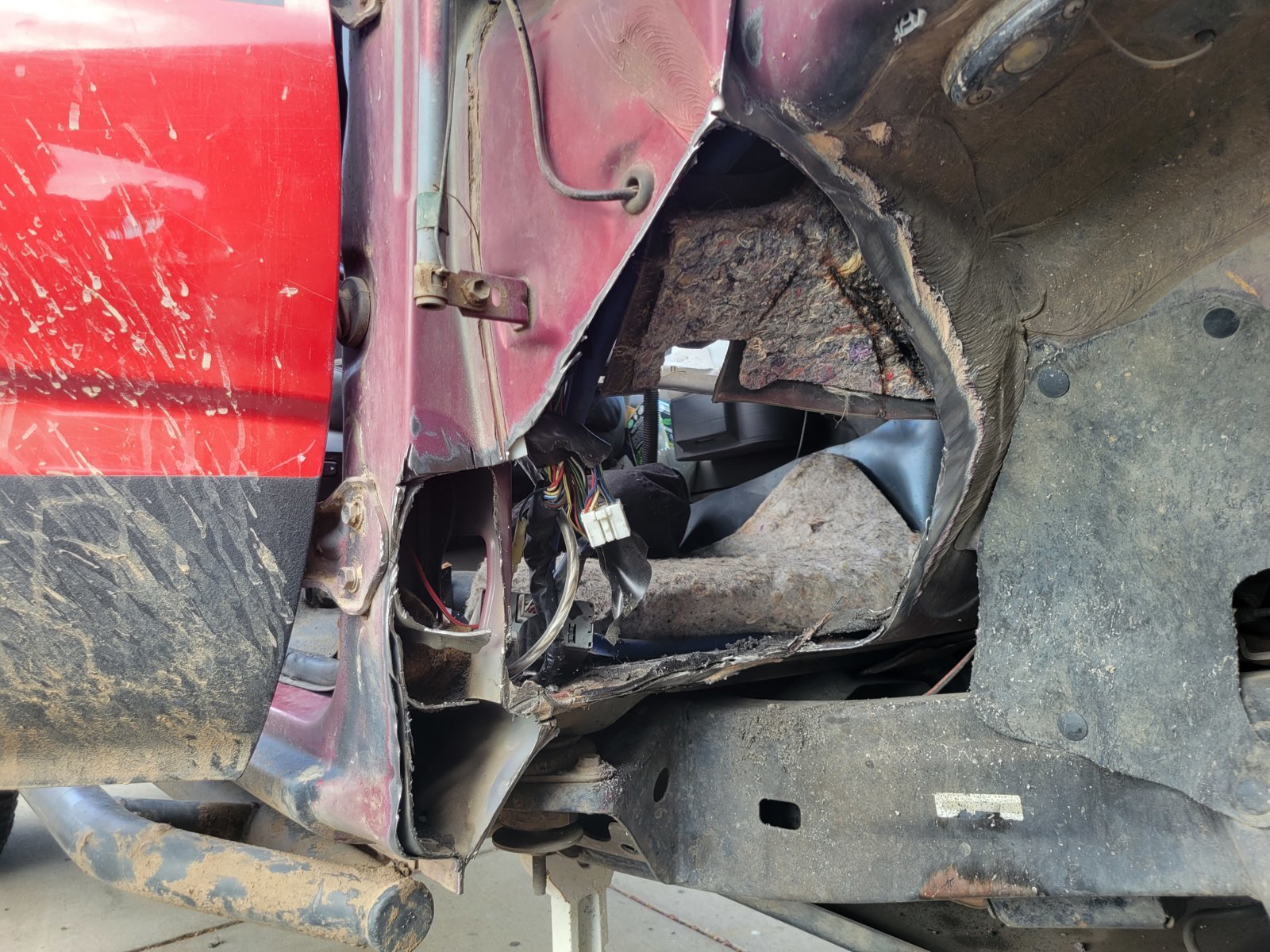

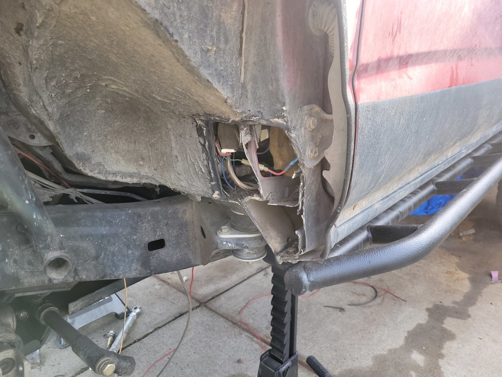

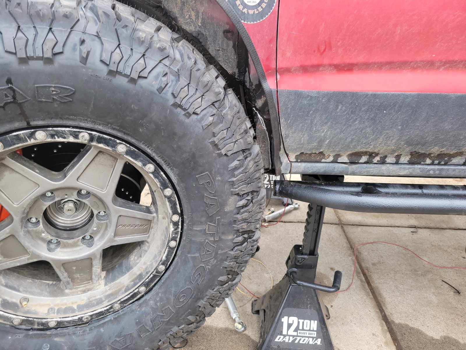

    Lexus brakes
    Clearance for the 37s
    Had to cut a little more from last time... here's last time. (For 35s)
    Still a little more to cut.
    So... I cut :sawzall:

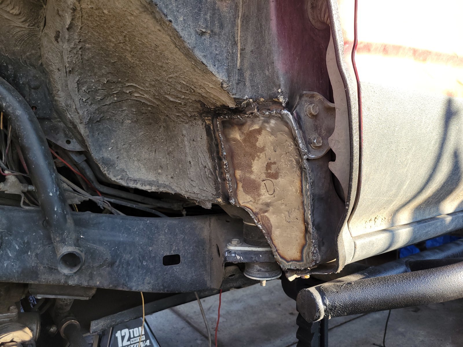

    And then I welded :welder:
    Voila!
    37s fit full stuff.
    Don't forget to decorate with frosting. Unless you like the annoying sound of rocks hitting sheet metal when you kick up gravel. :rofl:

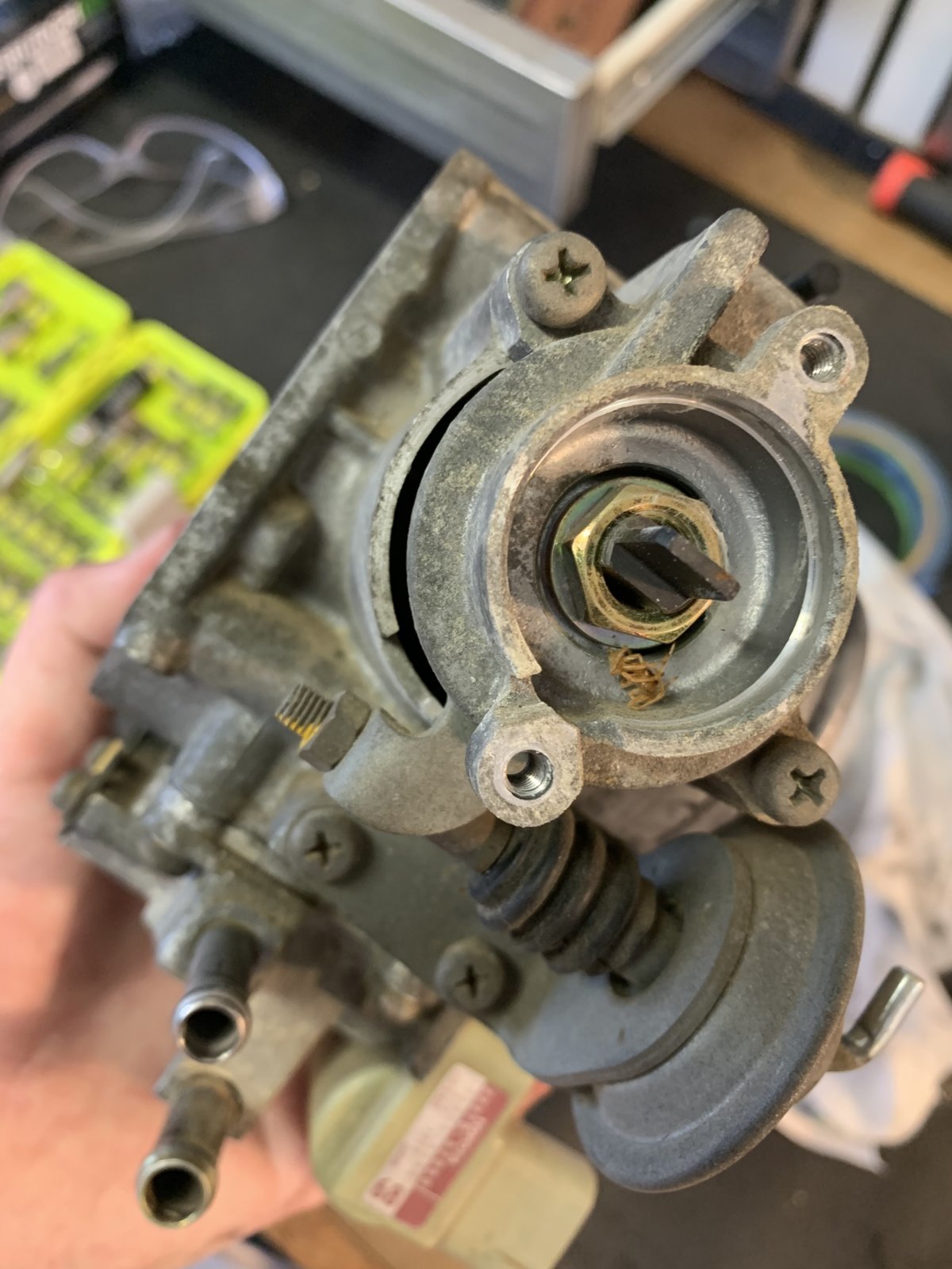

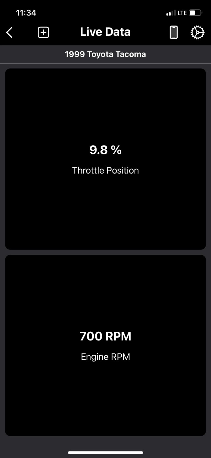

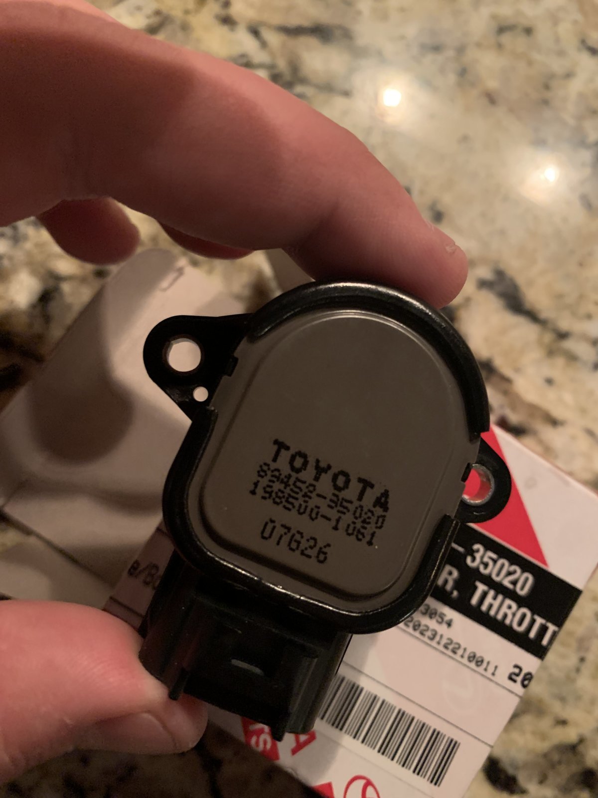

    ^^ Replaced the Throttle Position Sensor due to a P0120 code and rough idle. Idles at spec now. Dead spider was found inside the TPS housing area.

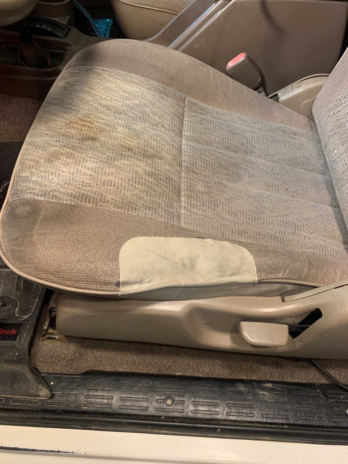

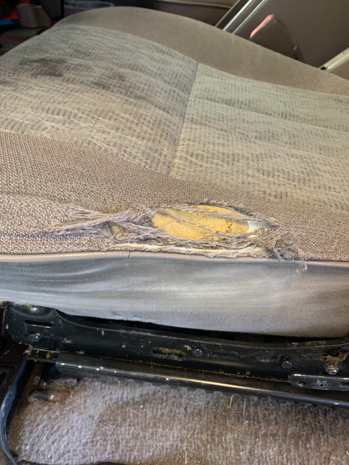

    Somebody needs to make spindles that move the wheel centerline forward an inch or two.

    Gives you more caster, but that's not what I'm talking about. Move the spindle centerline forward to clear the back of the wheel well better.

    The ball joint is pushed forward an inch therefore with the same alignment spec you get an inch of clearance on the firewall. I’m getting like 6* with solo arms and 31’s and not much lift - the tire rubs the front bumper when parking and turning radius is bigger - both from a longer wheel base.

    Is that idle in park or drive? I’ve noticed mine sits at 11% and in drive the idle is 650ish, which seems low to me but I’ve got no idea.
