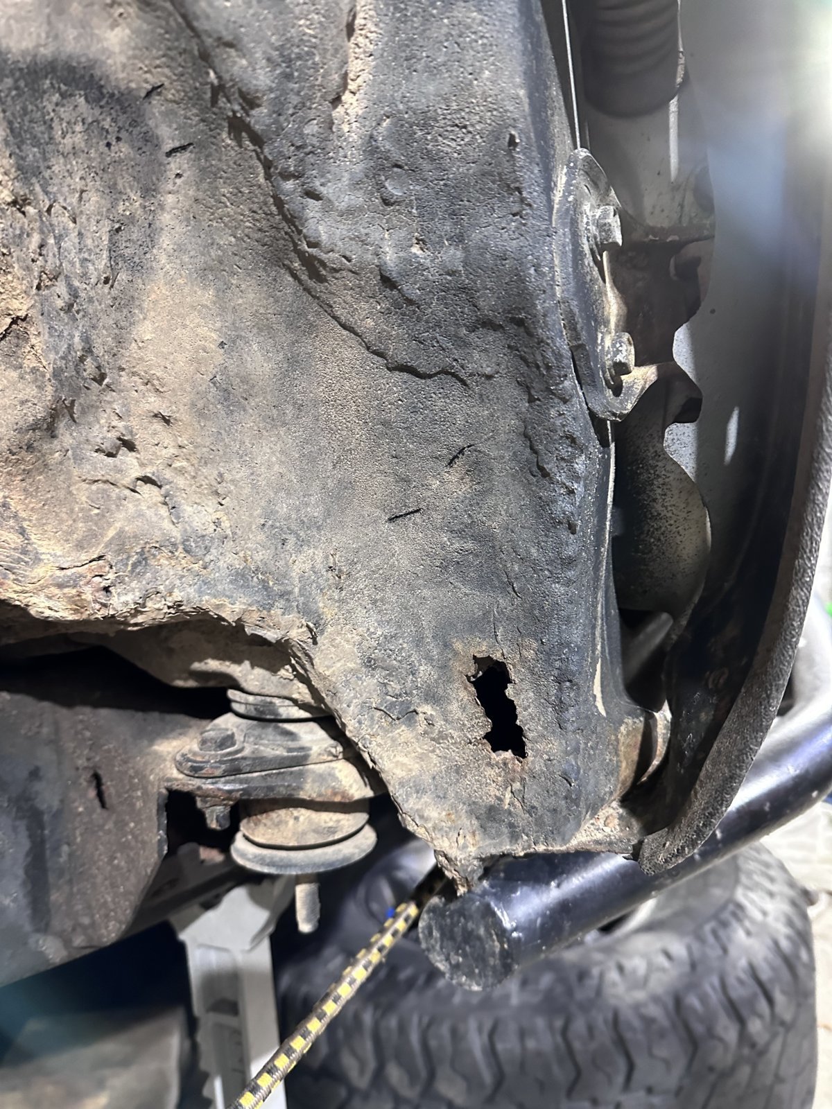

    Tell me about it. I have a theory it rusted from the inside out. That particular section is separated from the inside of the cab and more part of the rocker than anything and probably was left bare because I didn't think to paint inside that cavity post welding. That stud that usually is at the bottom of that rocker to hold the body panel on snapped off ages ago and I used a self tapper to hold that fender corner on both sides. My best guess is water got in from the bottom and then just stayed in that cavity.
    I'd blame him too but it actually rusted in a spot with no welds :p At least now I have my own welder setup and can repair it myself. Last time I did the cutting/disassembly and he did the welding.

    I couldn't get a shot from a paint can in there either, can just sorta see it through a void. So I just blasted Eastwood internal frame coating in that cavity.

    Mine doesn’t see the conditions that yours does, but your point about the water creeping in there has me concerned. I ended up welding a flanged nut there where the OG fender hardware got cut away and it’s entirely possible that it has allowed some water ingress as well.
    Might have to steal Zane’s idea and spray some Eastwood stuff in that weird little leftover pocket through the hole in the nut.

    Yeah I think that will be my plan after the repair. Will also weld a stud to the bottom of the truck like how it came originally to seal the bottom too.

    It's def worth checking in on. Curious what gauge everyone used for their tubs too? This was 20 and maybe it was too thin.
    Looking back at photos and it wasn't in great shape to start with...
    I treated the stuff inside the cab post welding but not that cavity.
