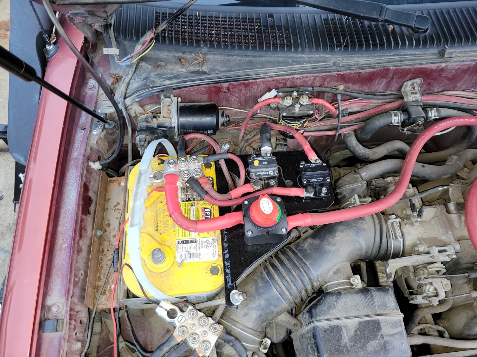

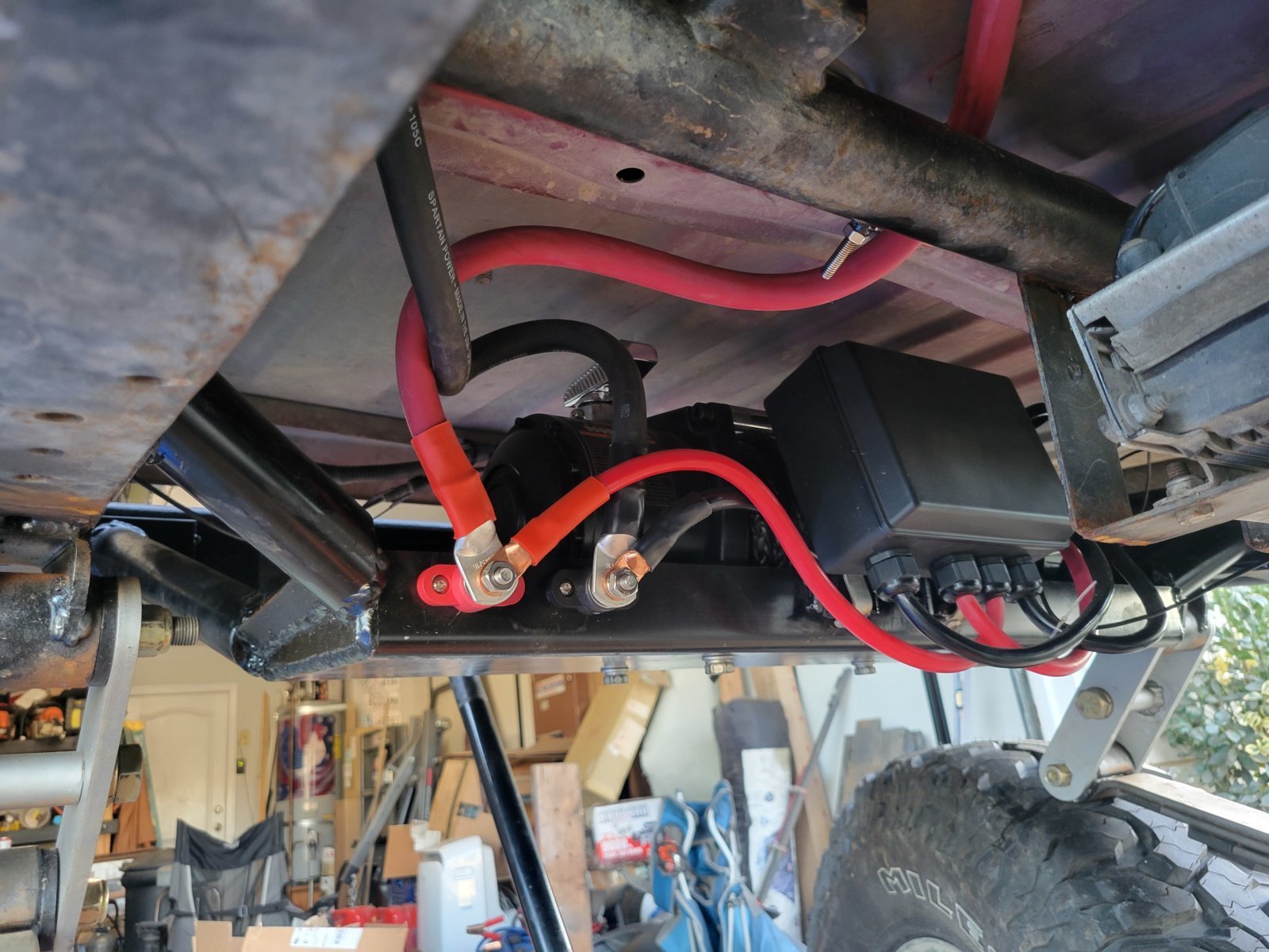

    There are aircraft jumper plugs that could be employed for this purpose. Not cheap but would be very functional.
    Jumper Cables:
    https://www.ebay.com/itm/186193093323
    Receptacle Plug:
    https://www.ebay.com/itm/325764889798
    https://www.ebay.com/itm/134811114285
    Just an idea....................

    Drop bracket lift and booger welds
    With those cables do you not need extra sheathing for wear resistance?

    I'd strongly recommend wrapping all those cables on the rear with some Techflex nylon sheathing to be safe. Not hard to do and well worth the extra peace of mind.

    They still need to be zip tied into place. But they aren't going to move. I may wrap them with something. But they are tucked WAY up out of the way. And the sheathing on them is actually really thick. (like almost 1/8 inch thick).

    Yeah I was thinking tech flex or spit loom.
    Yeah I wasn't worried about stuff on the trails, just vibration against the metal parts its zip tied to. I looked up the brand and it looks like high quality sheathing but I think I would be paranoid with that much voltage regardless.
    I just saw this which obviously could have been fixed with better wire routing but it could have def been a burned down truck.
    https://www.bronco6g.com/forum/threads/smoke-and-new-sound-coming-from-engine.86458/#post-2121547
    Looks like cheap cable sheathing though too.

    The one thing I've got going here is that wire isn't going to always be hot. It will only have current if I turn the disconnect on.

    This is an awesome precaution IMHO! :thumbsup:

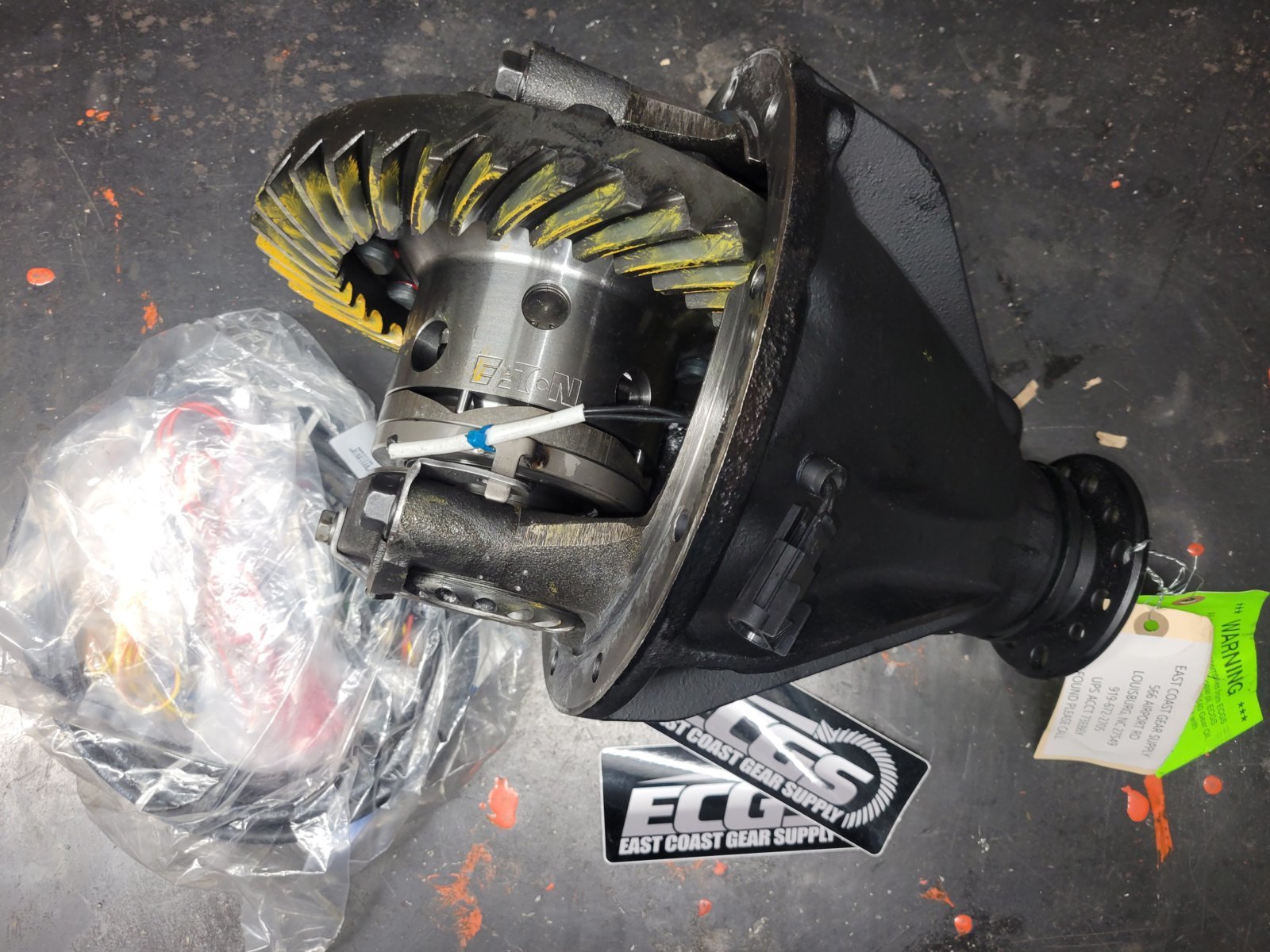

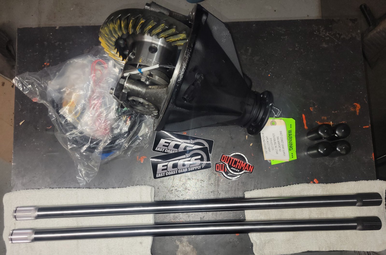

    Good stuff arrived today...

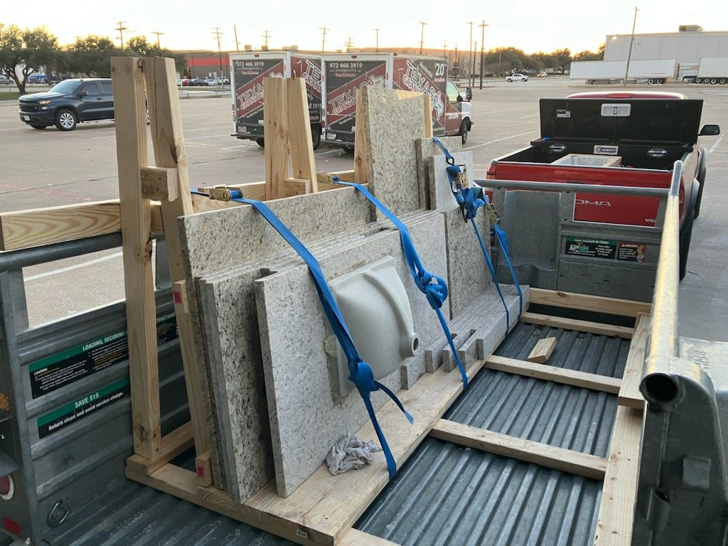

    Loaded about 2,200# of granite onto a 1,200# 5x9 U-Haul ramp trailer for hauling 1,IMG_1703.HEIC.jpg IMG_1704.HEIC.jpg 200 miles north. I'll check back in on how the Taco pulls it.

    Very nice!
    I put a TruTrac Posi in my 5-lug 1994 pickup and it really gave me a fighting chance in the snow. Giving some thought to someday putting one in the Taco and 3rd Gen 4Runner.
