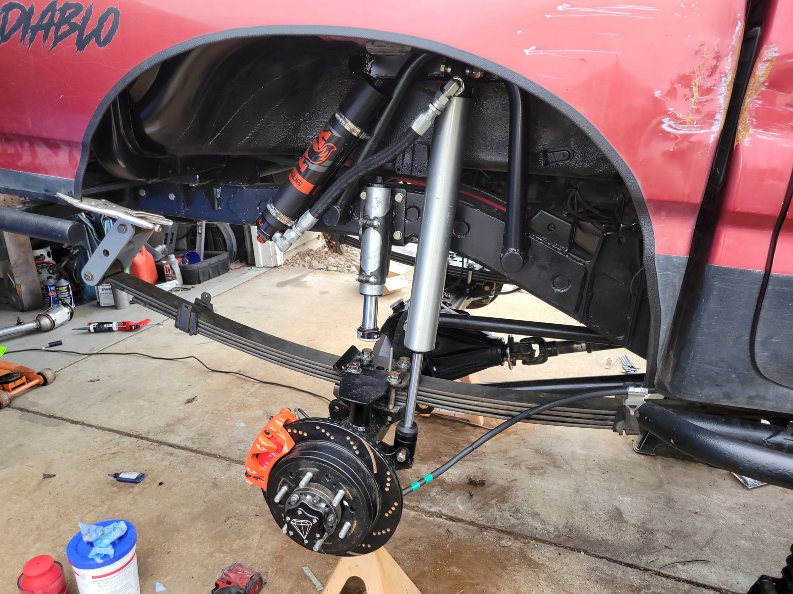

  16. Jan 12, 2024 at 5:41 PM
    El Taco Diablo
    El Taco Diablo Professional Pinstriper
    Nov 6, 2017
    #235223
    13,981
    Matt - KN6DZP
    Hughson, CA
    Impulse Red DC, 5vz-fe, 4wd swap, LT, dual case, F/R locked
    Just 3 tons of fun!!!
    Made some more steps in the right direction today.
    Been a minute since she's not been on any jack stands.
    And a sigh of relief... the axle shafts are exactly the right fit. Never measured custom axles before. Dutchman axles really took the time to go over everything, to make sure they were right. CAN NOT recommend them enough.
