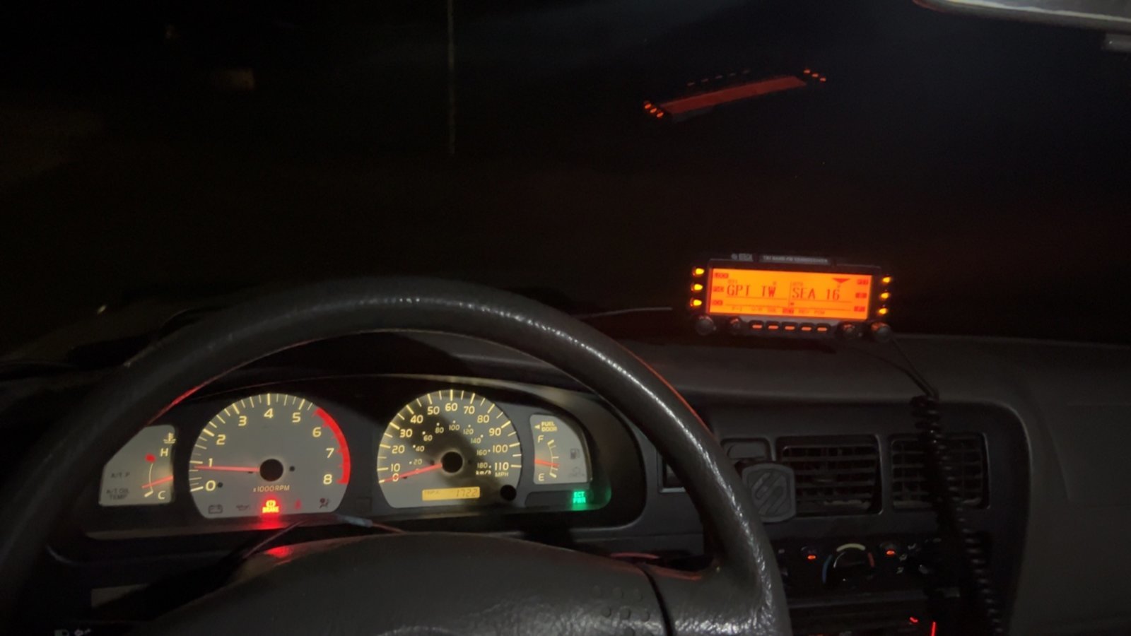

    Did a rough install on my Btech HAM radio tonight so I can listen in to the local HAM’s and air traffic control. Mounted the main unit behind the back seats and put the head almost dead center of the dash and I think it turned out pretty good, not a huge fan of the RJ45 cable running across the dash but it works for now and maybe a few days in the sun will loosen it up so it lays down well.

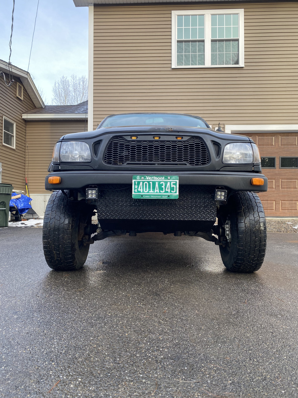

    Replaced upper ball joints on both sides yesterday, then today built a little skid plate to cover the radiator and replace the chicken wire i'd been running there for about a year. Also got a reman driver's side caliper since the one I rebuilt a year ago decided to seize up again and was pissing me off. Next up, gotta fix a gaping hole in my driver's side floorboard );IMG_5564 2.HEIC.jpg

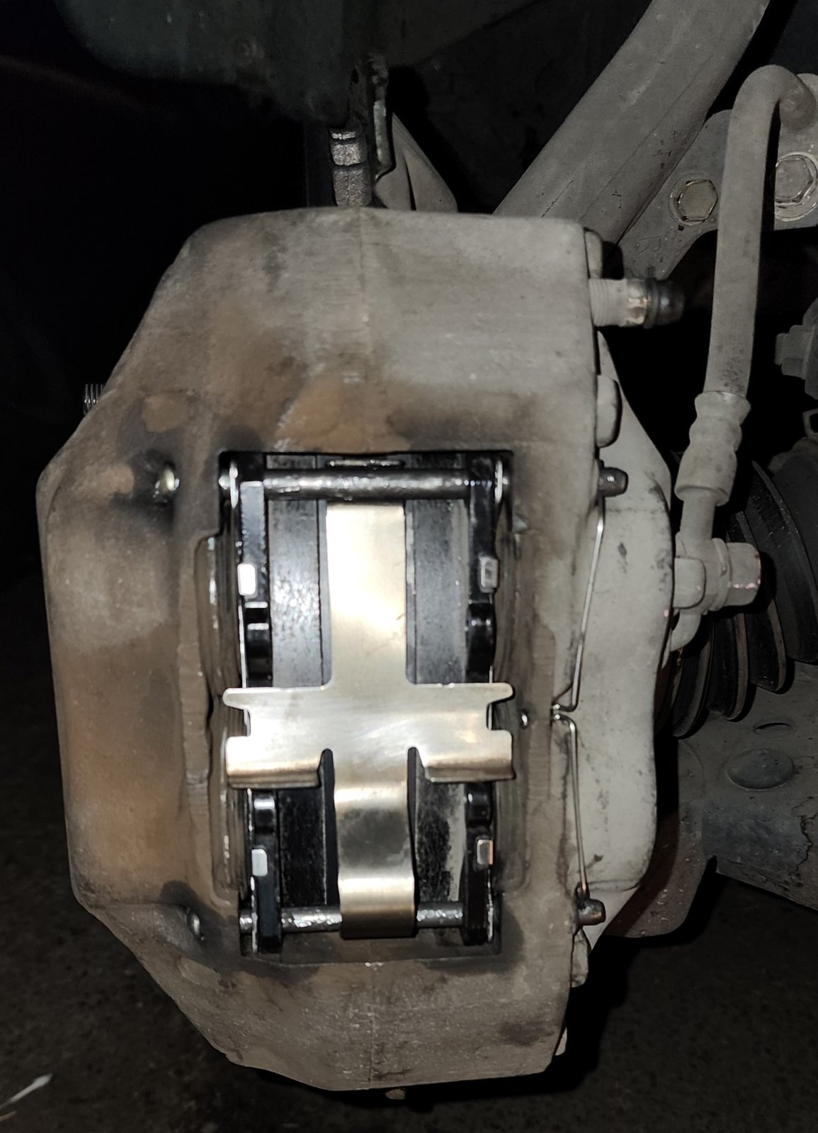

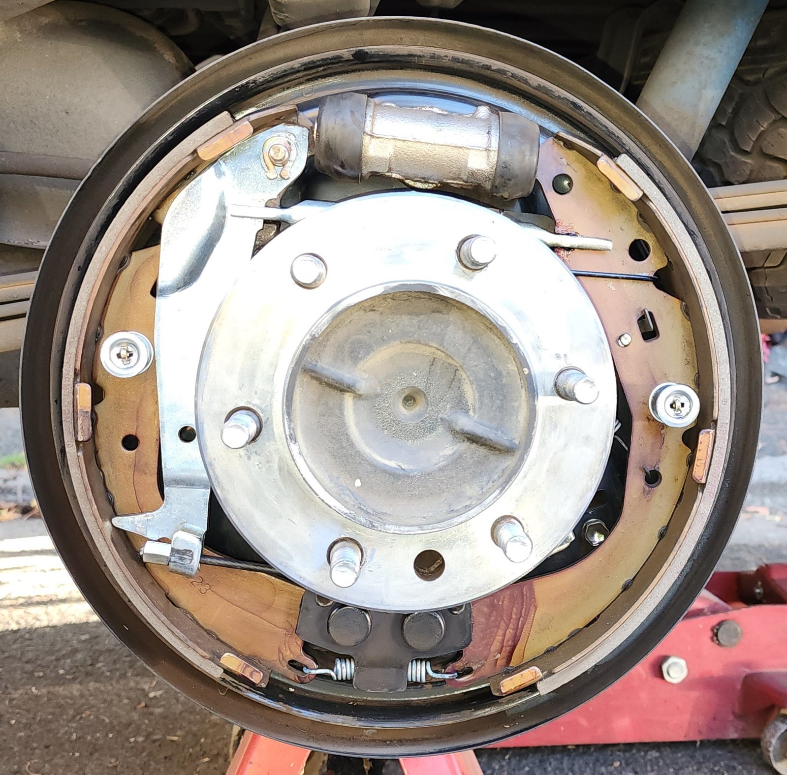

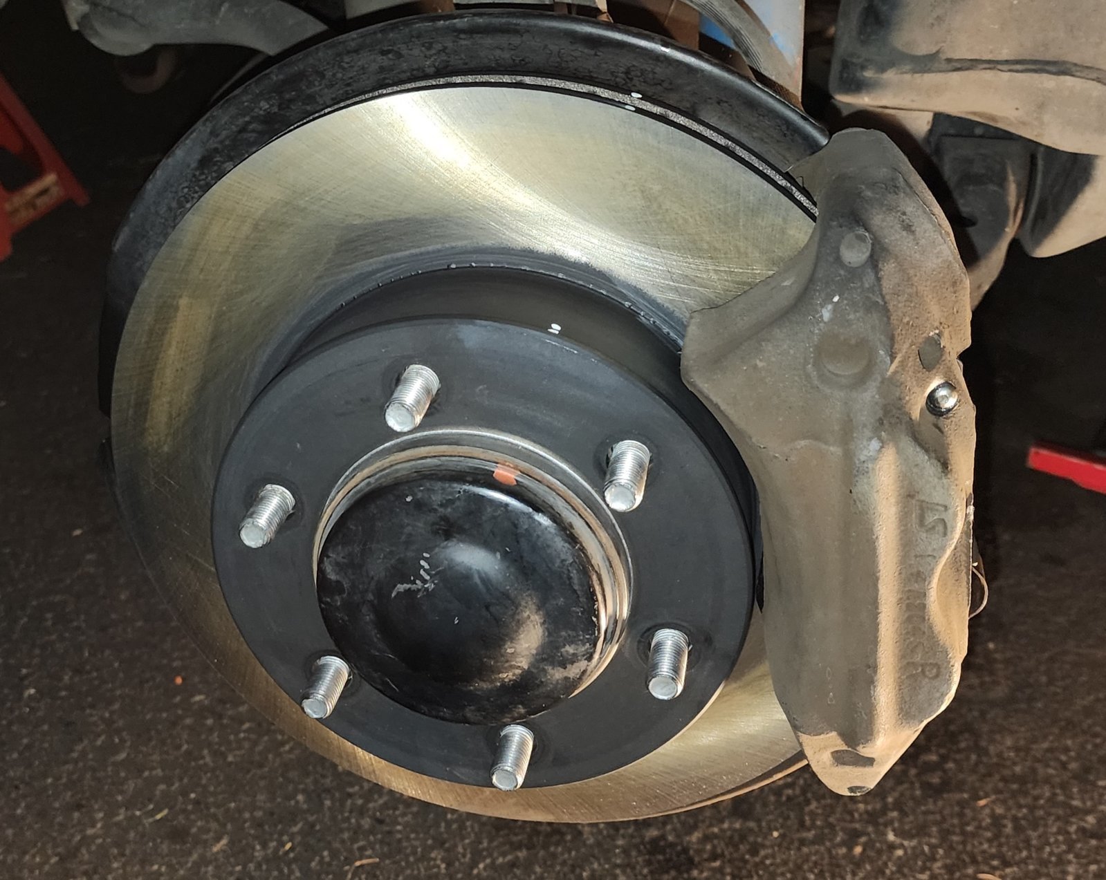

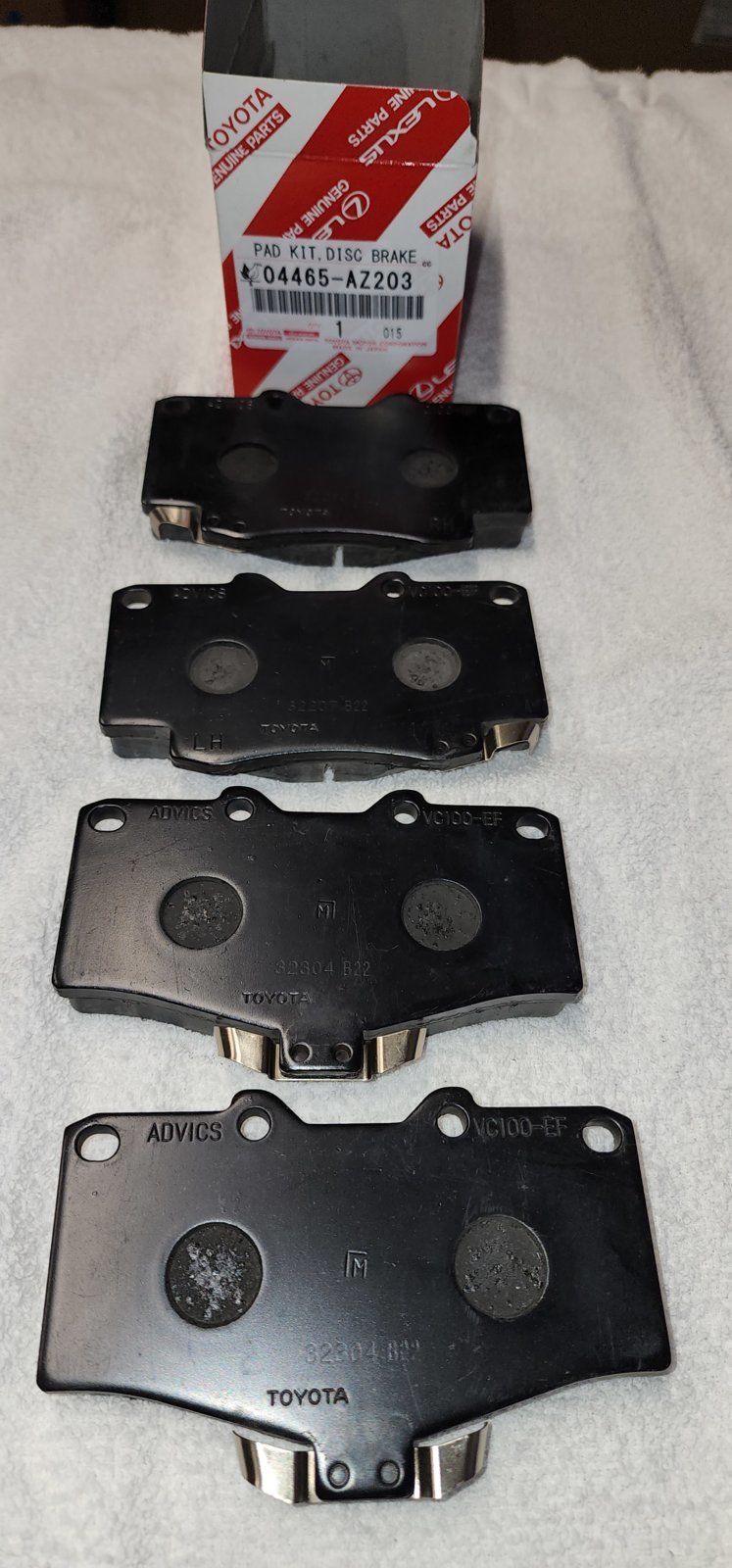

    Wondering what the advice is, when it's time to replace the rear brake shoes, between just putting on new shoes and hardware kit, turning the drums, or replacing drums with shoes. And if OEM is best here to work well with fronts (that tend to get too hot if rears don't work well and are adjusted).
    If there's a thread on this happy to read it if you point me in that direction.
    @ 169,033 miles: Replaced the front brakes (Toyota discs and pads - Advics actually - and pins).
    Rears are original: disassembled and serviced them and reassembled then adjusted the rears to spec, but didn't replace.
    Shoes have about 4mm left at lowest edges.
    LH shoes thickness:
    Top front: 6mm
    Top rear 5.2 mm
    Bottom front 3.9 mm
    Bottom rear 6 mm
    RH shoes thickness:
    Top front: 5.5 mm
    Top rear 5.4 mm
    Bottom front 3.9 mm
    Bottom rear 6 mm

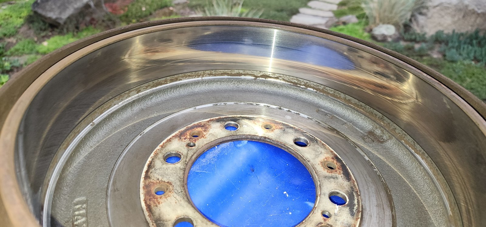

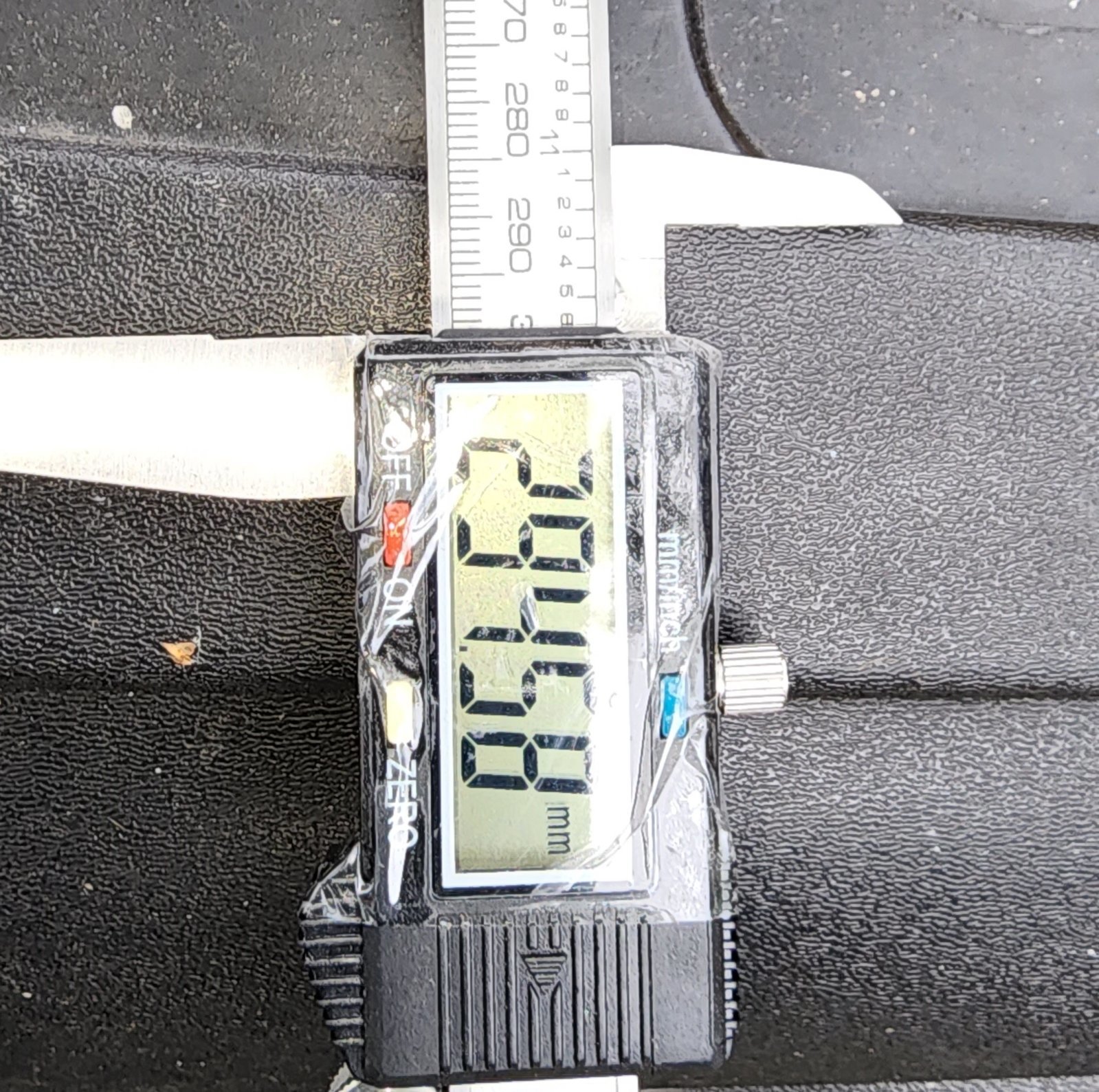

    Drums measure 294.48 mm, well within spec (<297 mm) with a slight groove
    Can't find a sticky or thread on rear shoes recommendations after digging about 7 pages into the search on 1st gen forum.
    I've swapped OEM pads up front a couple times without turning before with success.
    TIA.

    Did you fab the grille? Looks good.

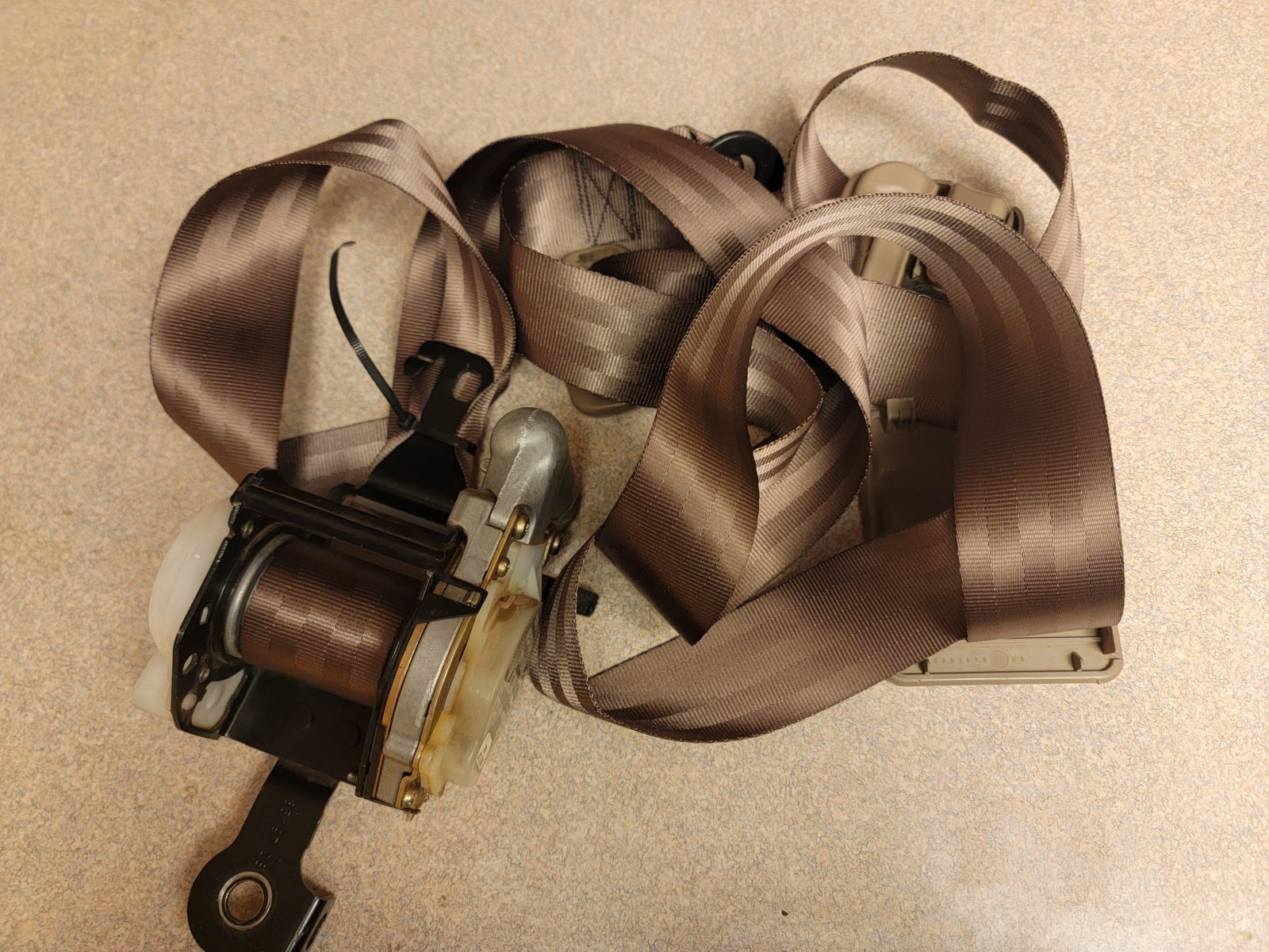

    Sweet! I just spoke with them last week and will probably soon be sending in the 2 of mine that were completely out of stock everywhere. It's hard to tell from the photo on my phone. Is that tan or gray? How good was the color matching?
  11. Jan 26, 2024 at 10:36 AM
    Squeaky Penguin
    Squeaky Penguin Nothing Ventured, Nothing Gained
    Apr 5, 2012
    #76340
    10,074
    Brett
    Steamboat Springs, Colorado
    '01 4WD, SR5, TRD & '13 TRDOR AC
    Lots of dust and custom dents, Check Build
    It's tan.
    My truck is buried in snow and I haven't checked how close the color match is. I also don't have the original carpet or seats, so not much fabric to compare it to. :rofl:
    Looks pretty close from what I recall. :notsure:

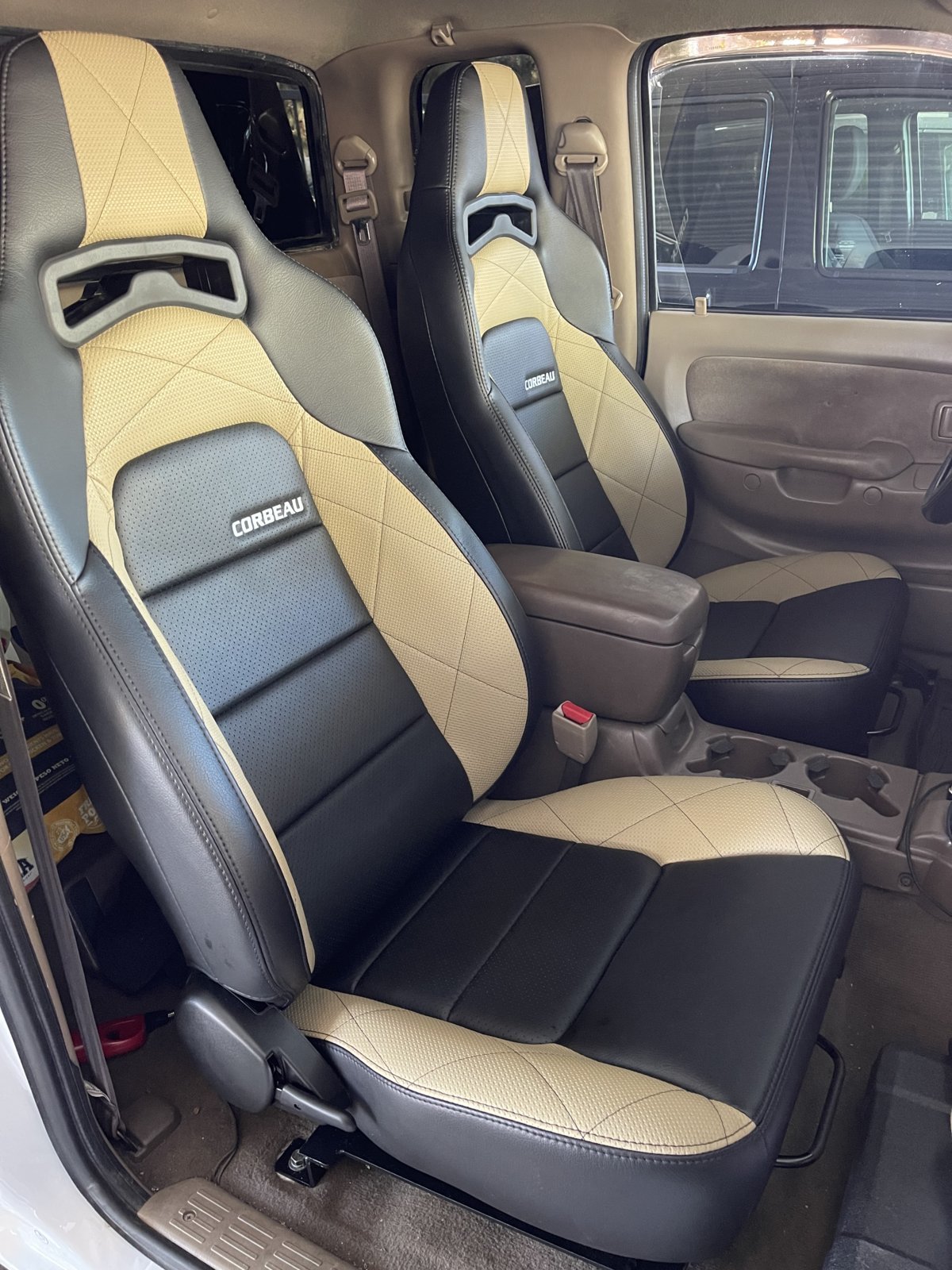

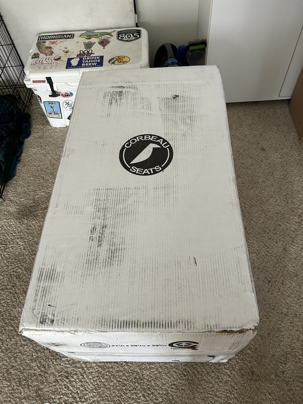

    Aaaand they’re in. My old seats will be in the BST soon.
  13. Jan 26, 2024 at 6:16 PM
    El Taco Diablo
    El Taco Diablo Professional Pinstriper
    Nov 6, 2017
    #235223
    13,979
    Matt - KN6DZP
    Hughson, CA
    Impulse Red DC, 5vz-fe, 4wd swap, LT, dual case, F/R locked
    Just 3 tons of fun!!!
    Niiiiiiice!

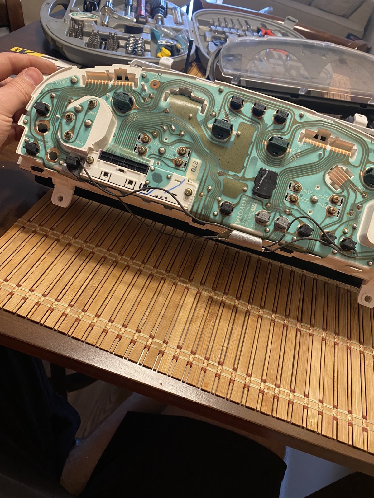

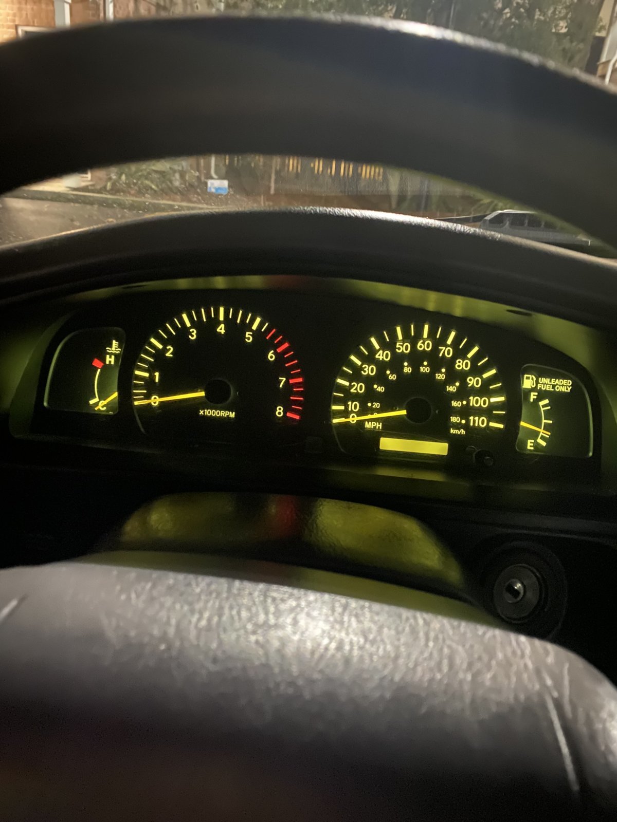

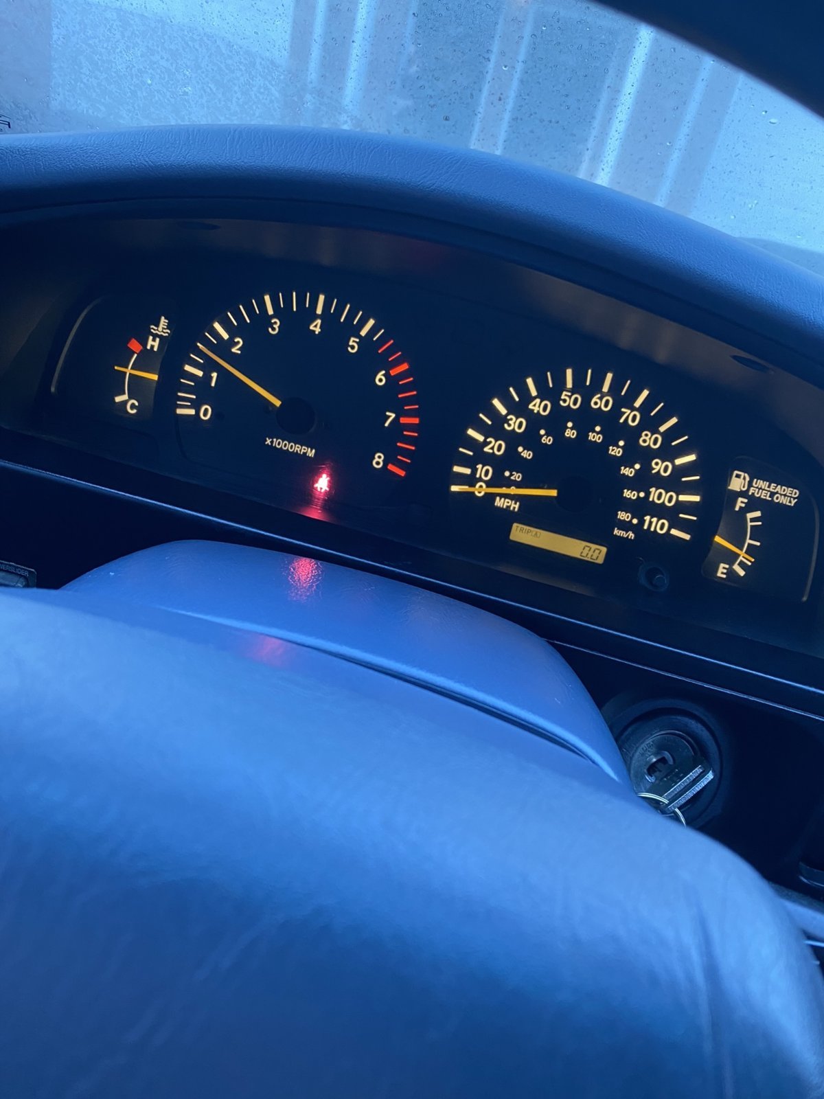

    Pulled the cluster yesterday to swap all the lights to LED. Straightforward process took a couple hours start to finish going slow. Was also hoping to figure out why my heat gauge always goes right to the middle, no luck so will try to search for a new/old one to swap in.
    Also found out why the check engine light never worked... ha

    The after photos look great. What part numbers did you use for the swap? Expect they work on all 1st gens, so a 2004 DC? TIA.

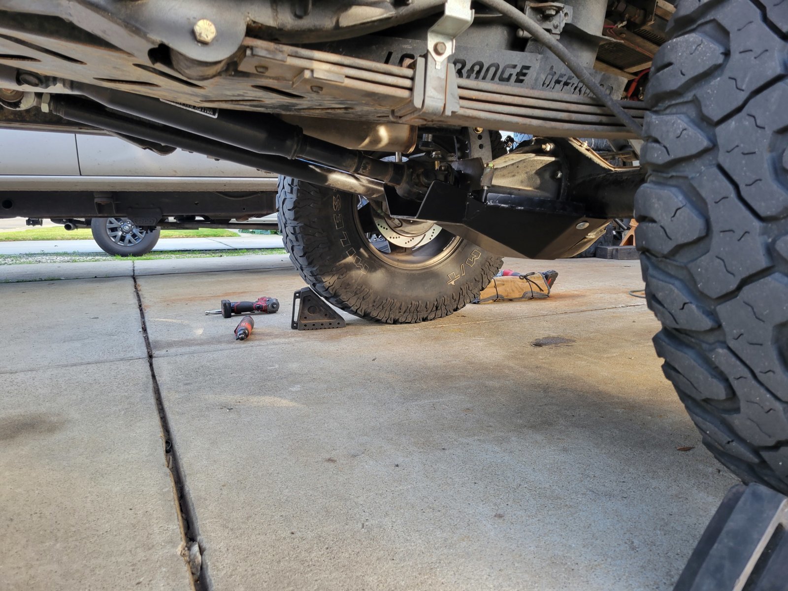

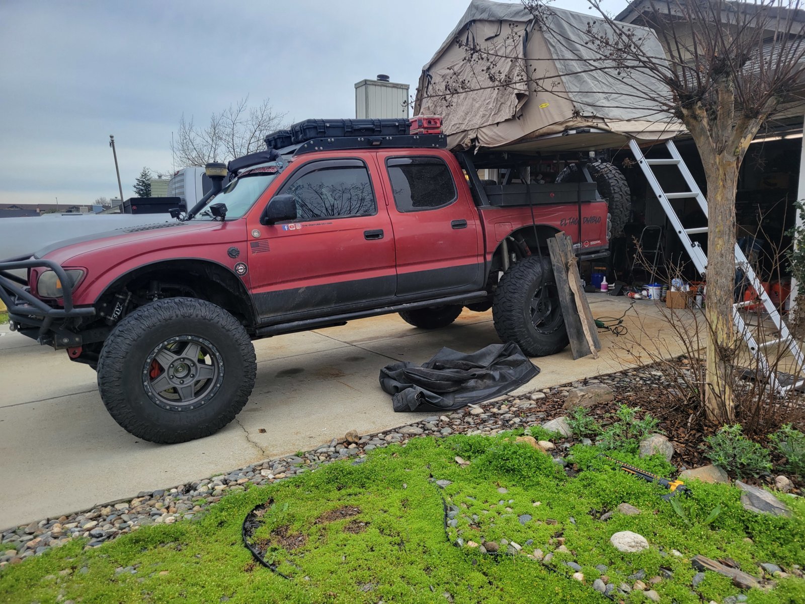

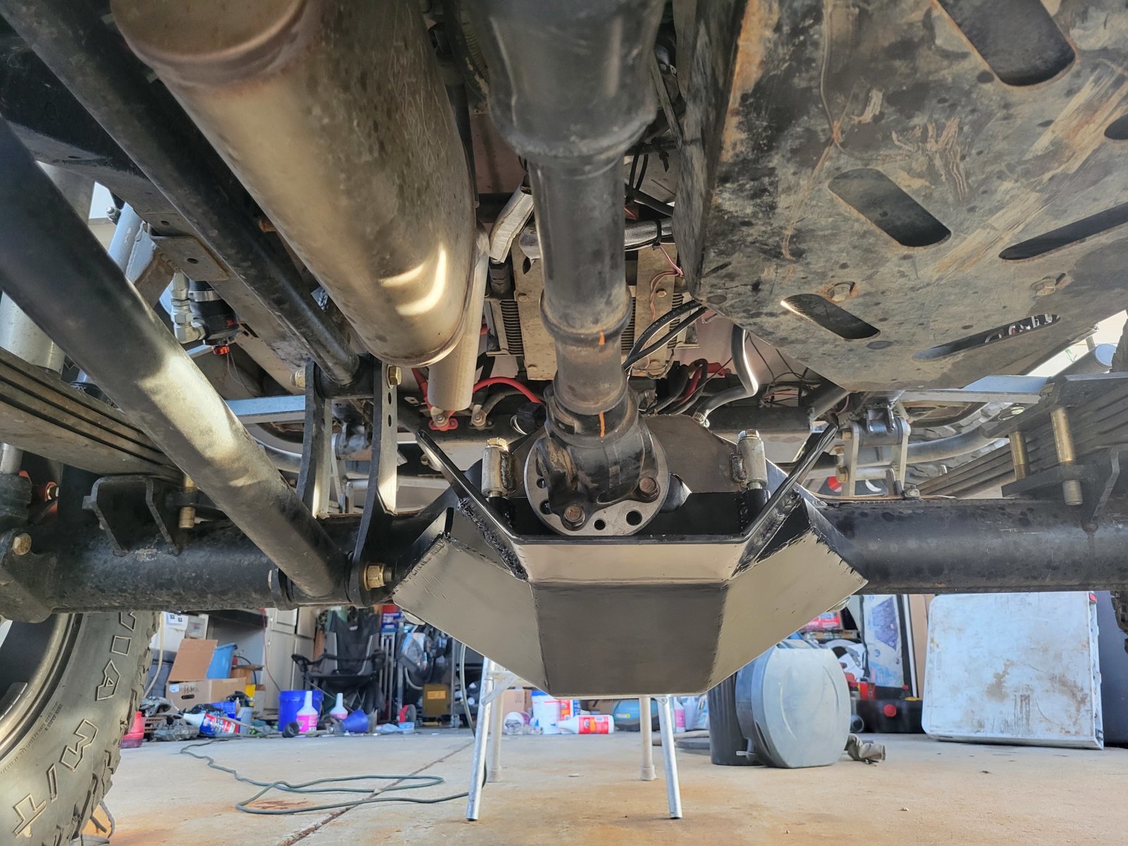

    Making the mad thrash to get ready to leave for Hammers on Tuesday.
    Airing out the tent and washing the bedding
    Fixed the steering rack :thumbsup:
    Also figured out a sort of fix for the rack bellows with the steering links.
    Hung the diff skid
    Finished up some wiring odds and ends, cleaned up the interior a bit. Adjusted the DSCs on the shocks. I had forgotten to do that when I installed the rears.

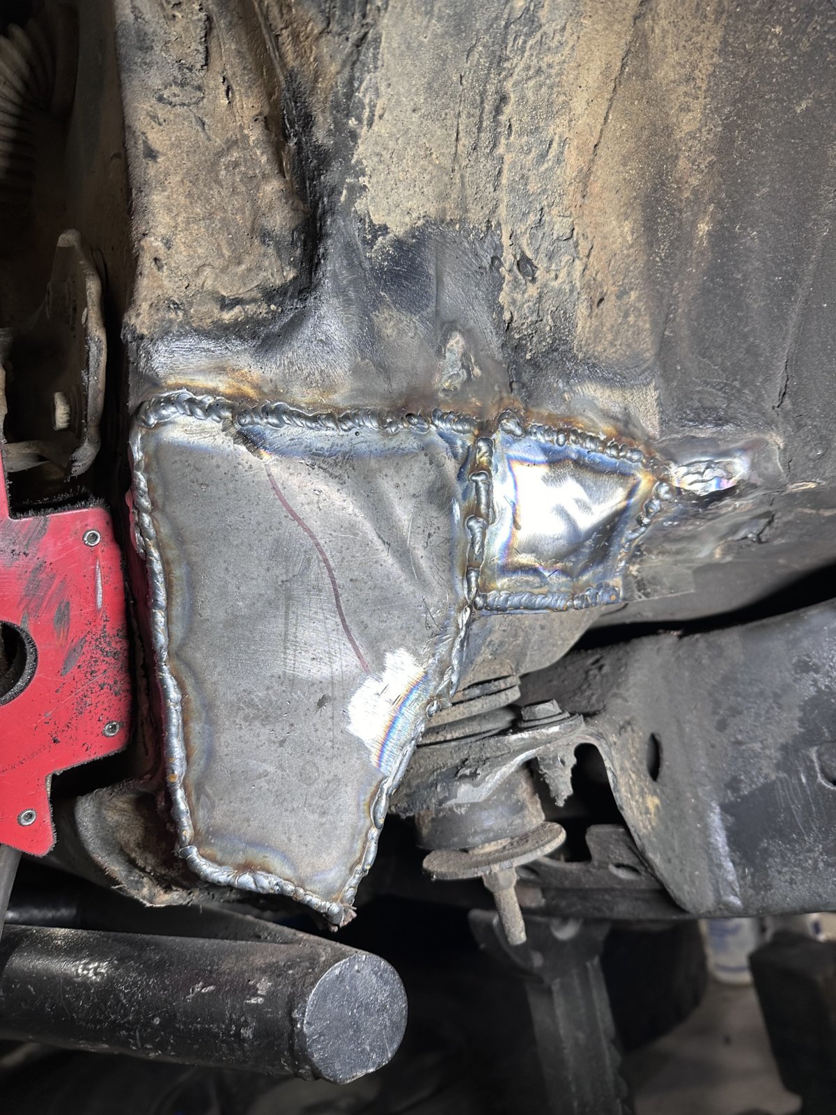

    Drop bracket lift and booger welds
    The next time I do this will def be with 16ga and 18ga vs the 20. So much easier to weld.

    Where did you get those seats from?

    For the cluster? Its something like 5 194 bulbs and a pile of 74 bulbs.
