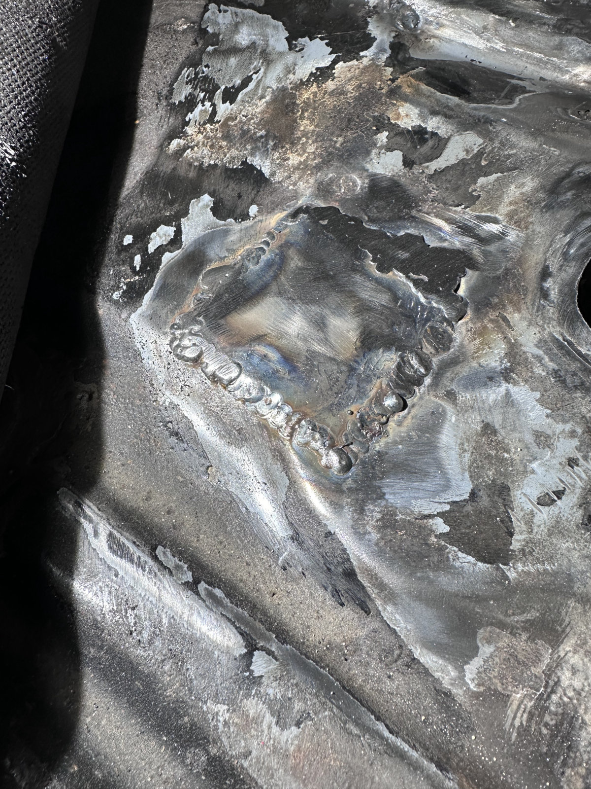

    Drop bracket lift and booger welds
    These dang rust free socal trucks just makes me so sad to look at my rust bucket. Speaking of, patched another rust hole this morning. Think I'm finally ready to prep for paint and seam sealing.
    Also learned today that the cavity the body mount is in is sealed from the cab with a plug but is open to the elements on the bottom of the truck via a tiny 1/2" hole. So a great spot for water and salt to gather and stay in to rust.

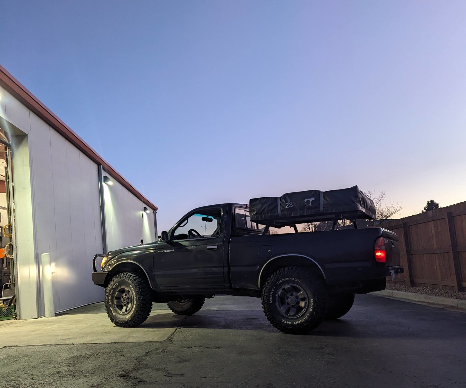

    Since putting the bed rack and tent on the rear end has been a bit saggy, I pulled my OME leaf packs out and put in a middle leaf I pulled out originally to make the ride softer.

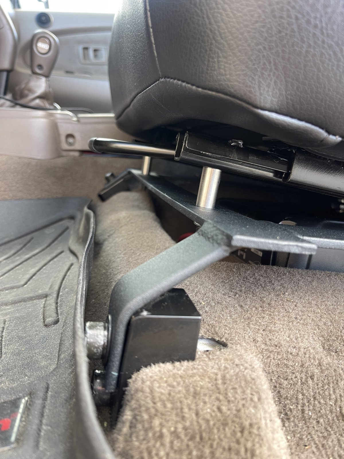

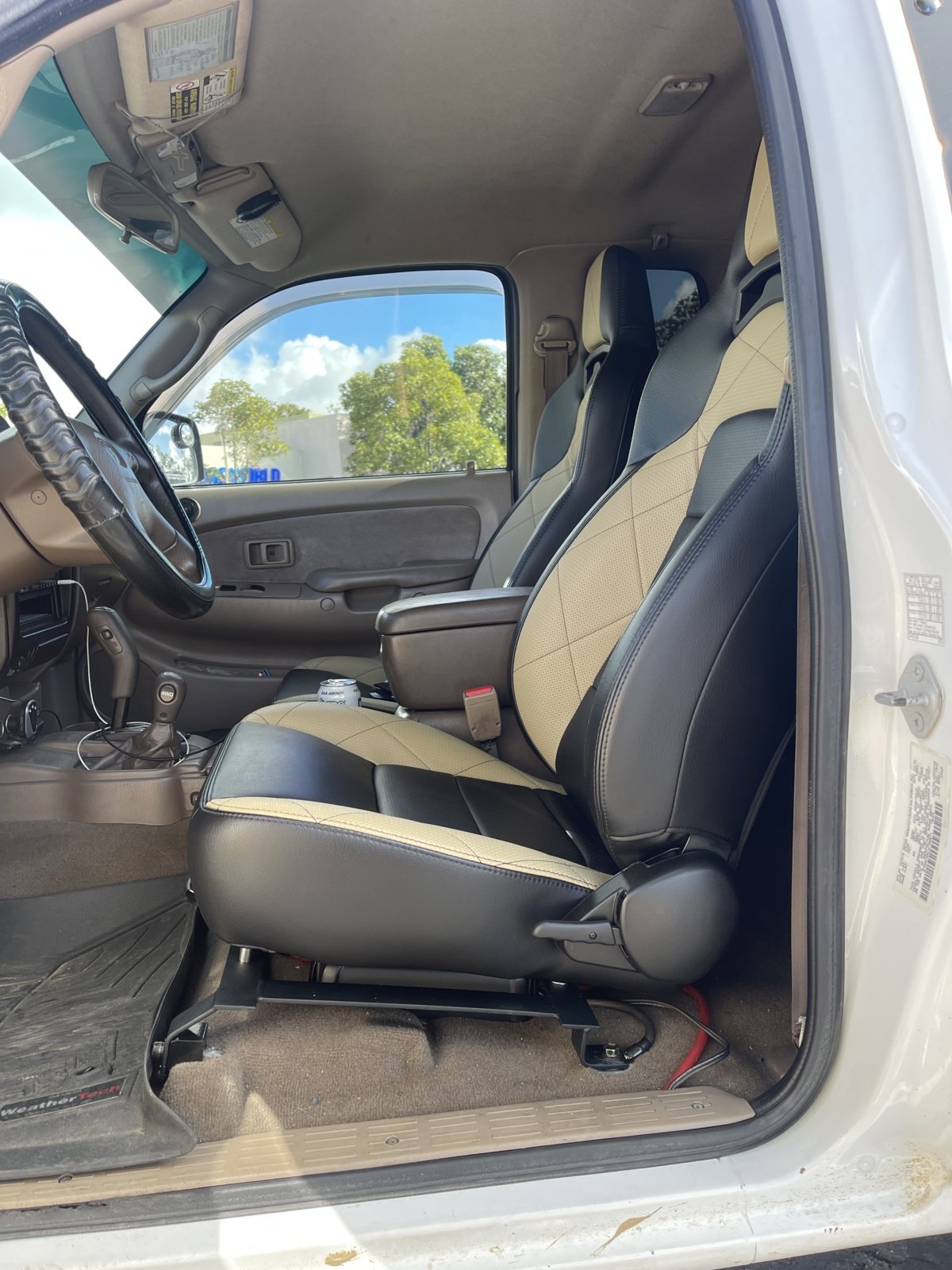

    Installed some spacers to lift the front of these trailcats. The Corbeau brackets sit a bit lower than the oem ones do which I don’t like even with the desert does it seat jackers as you can see. They feel MUCH better now.
    Hardware I got:
    M8-1.00 nylon lock nut
    3/8x1/2x1 stainless steel spacer
    M8x1.00x50 socket head cap screw
    (Ignore my amp wires that I’m too lazy to hide better)

    Are the seats really worth the price?

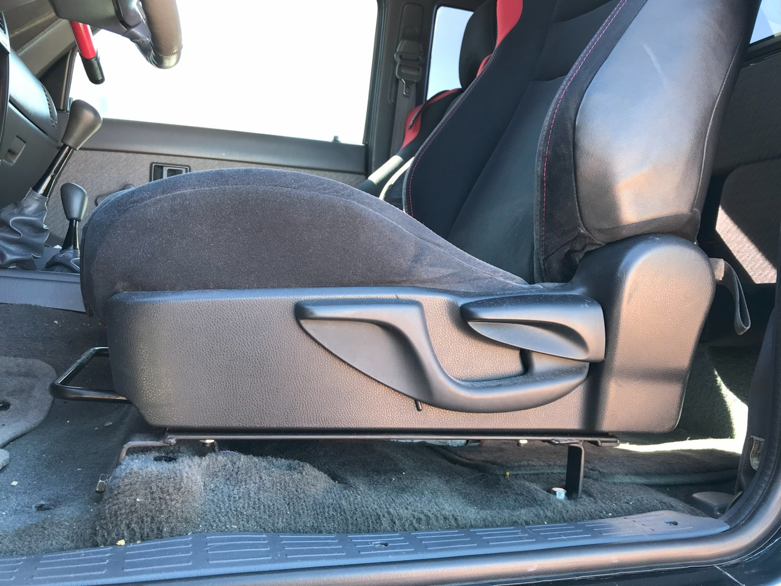

    I made my Scion seat brackets a little to high. I am afraid that if I lower the rear that I will feel like I am sitting in a hole and end up with too much pressure on the front of my legs. The front cannot go any lower. I also added one inch of high quality foam and heating elements to the seats, so that makes it even worse.

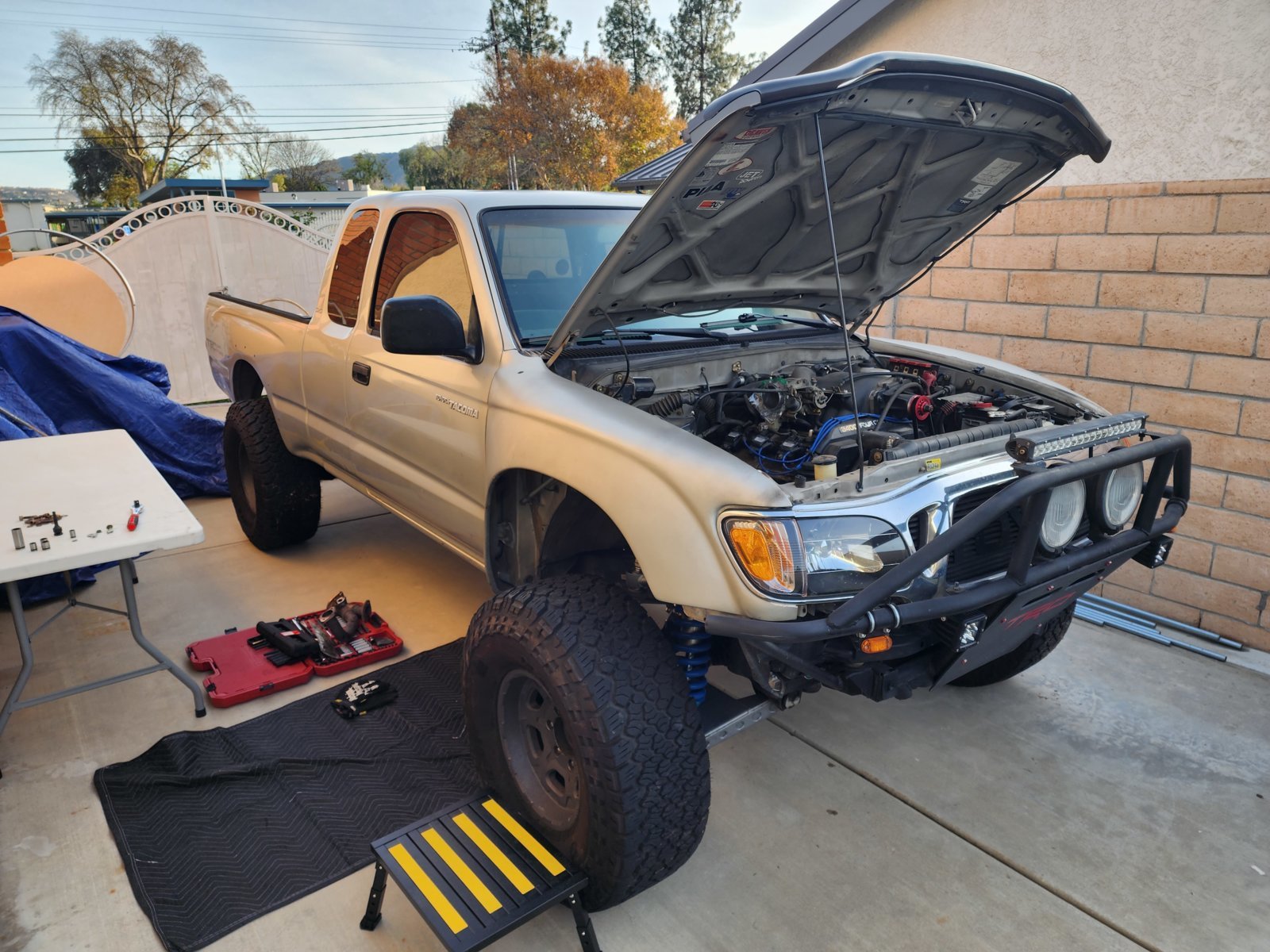

    Over the past couple weekends got the front diff installed, rebooted a torn CV Axle boot, swapped out the PreRunner spindles and hubs with manual locking hubs and the Tundra brake upgrade.
