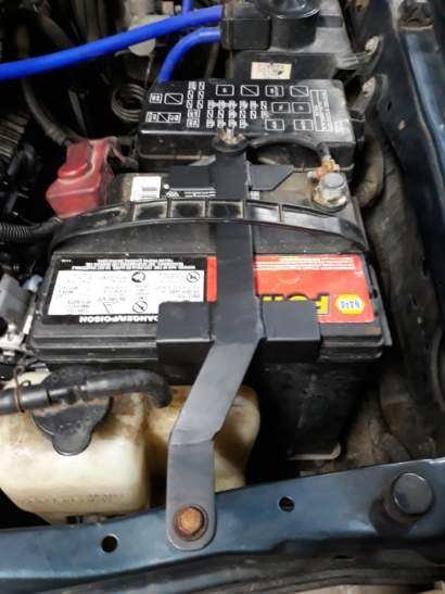

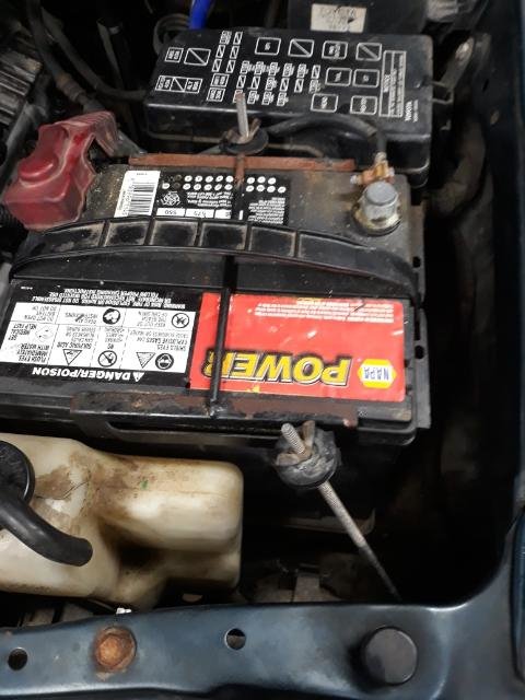

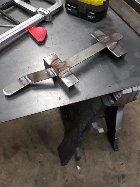

    My factory battery hold-down bracket rusted away some years ago. The aftermarket one (first pic) was better than nothing, but not by much. Finally made one from some flat stock that should last the life of the truck.

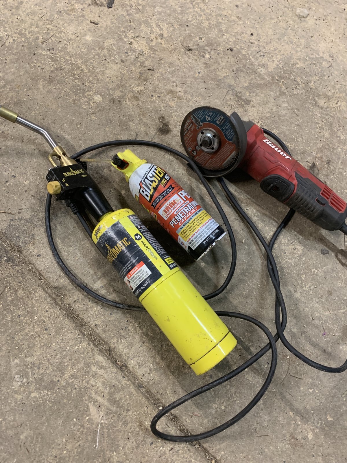

    Using the angle grinder to cut the torche tank while spraying pb blaster to help the cutting blade?

    Precisely :annoyed:

    Very nice, I need to make one for my rig.

    I cut and rewelded my oem one to make it a bit bigger for my battery.

    I have one of the aluminum ones, and it struggles to keep my battery in place. I need something that will secure it better.
  11. Feb 15, 2024 at 7:47 AM
    Speedytech7
    Feb 20, 2014
    #123587
    58,541
    FCQM+VG Cheney, Washington
    It's less Tacoma and more mod
    What kind of battery are you using there. Mine had a little trouble too and a stuck a 1/4" piece of wood under the batter to space it up. A lot of the AGM batteries are a little short

    An AGM, never thought about raising it.

    Most sit a touch short, I have spaced them up as well as put 1/4" stall mat under the tiedown to it compresses and grips on batteries that don't fit quite right.

    That's why the Odessy batteries had the adapter plates, they go on the bottom to lift it up higher.

    I might need to make another one or at lease hack this one up. The DieHard is getting a tad long in the tooth and the only replacement I can find with the same exterior dimensions is the Odyssey version at around $300-$350.
    If I do it will have an "adjustable size" feature (hint).

    Deka Intimidator in the appropriate size may be similar specs to the Diehard.
