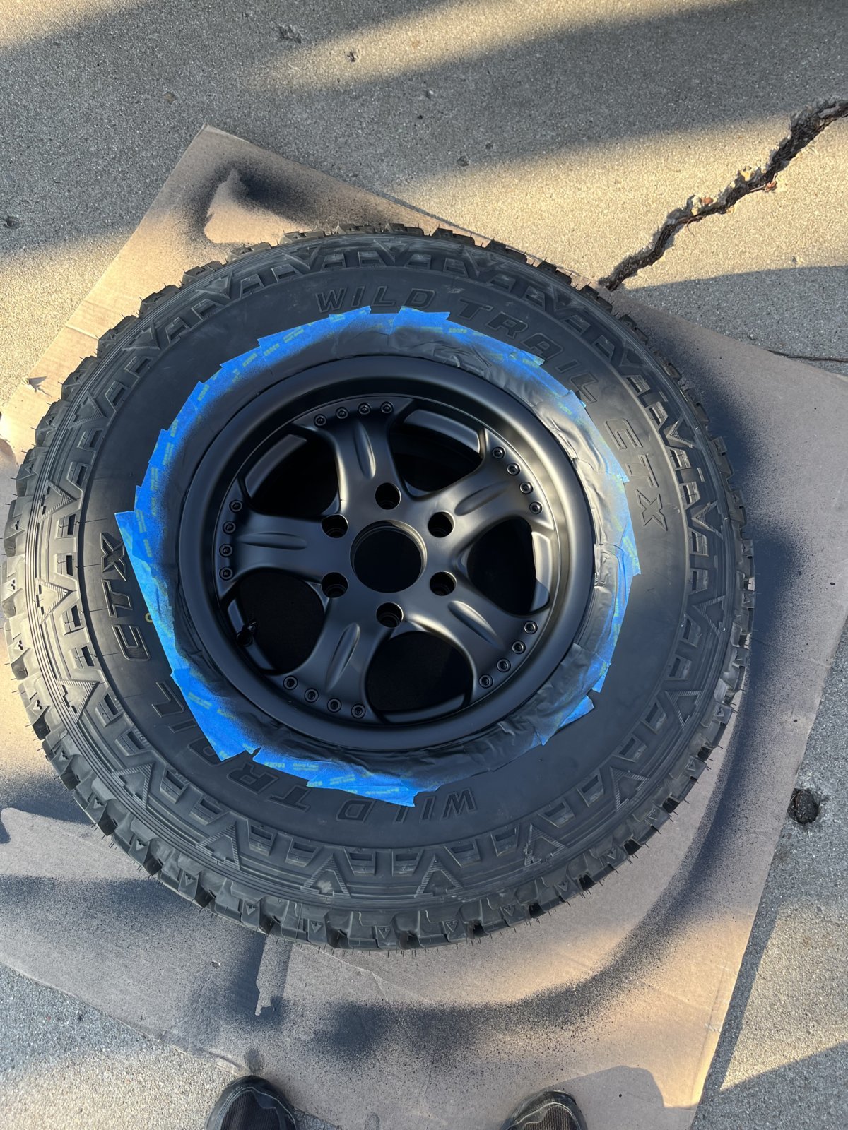

    Finally got it mounted and color matched to the truck

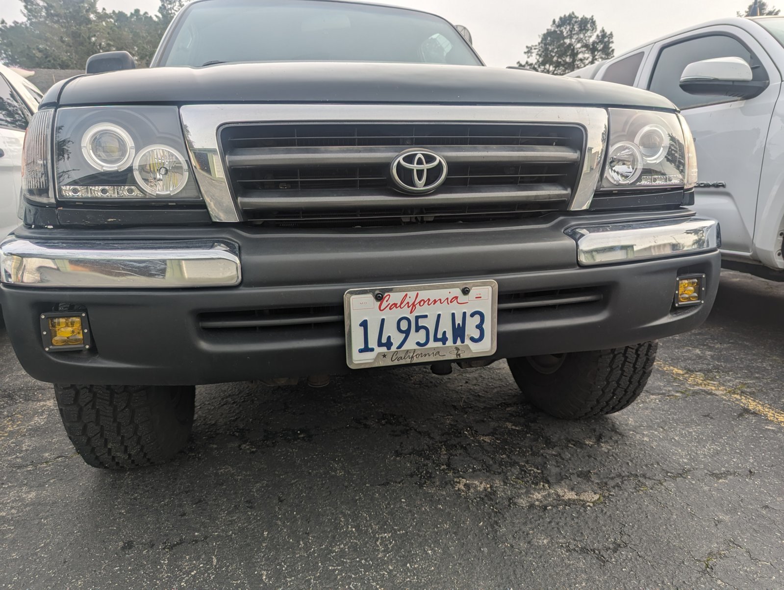

    I'm definitely interested in more pics of how you mounted the fogs. I want to do something like this soon.

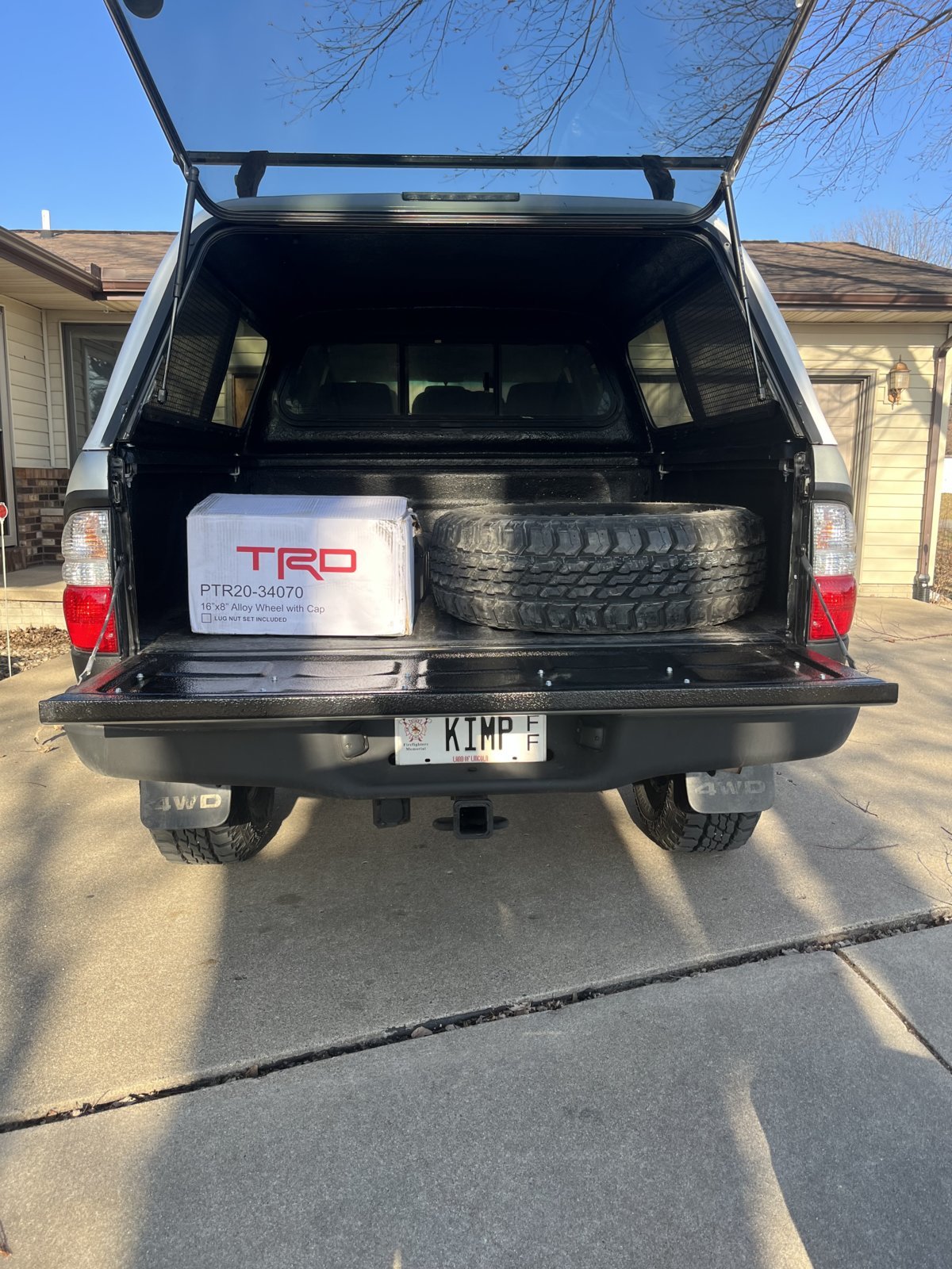

    If @Parkvisitor ends up passing on this offer, I call dibs!

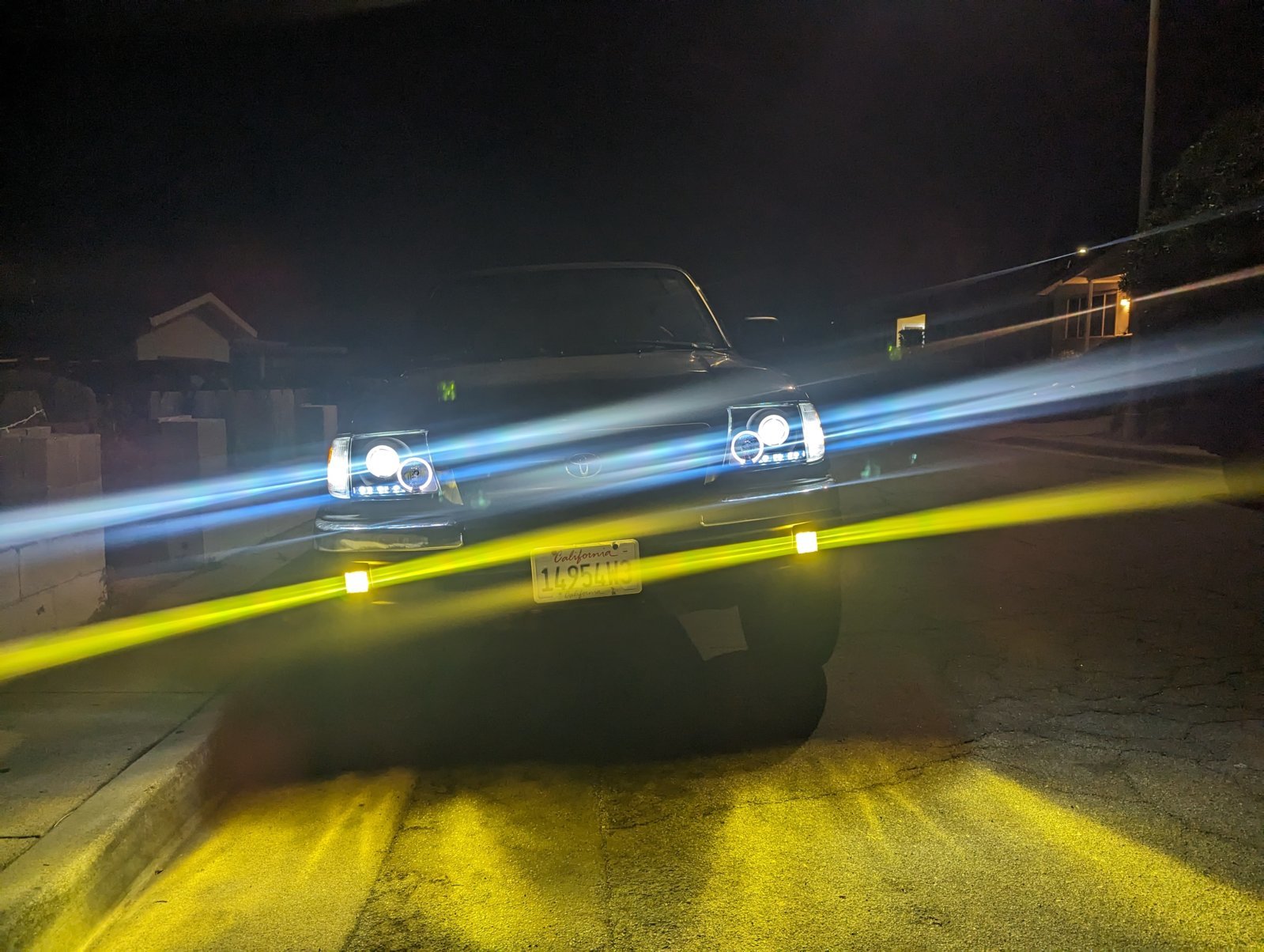

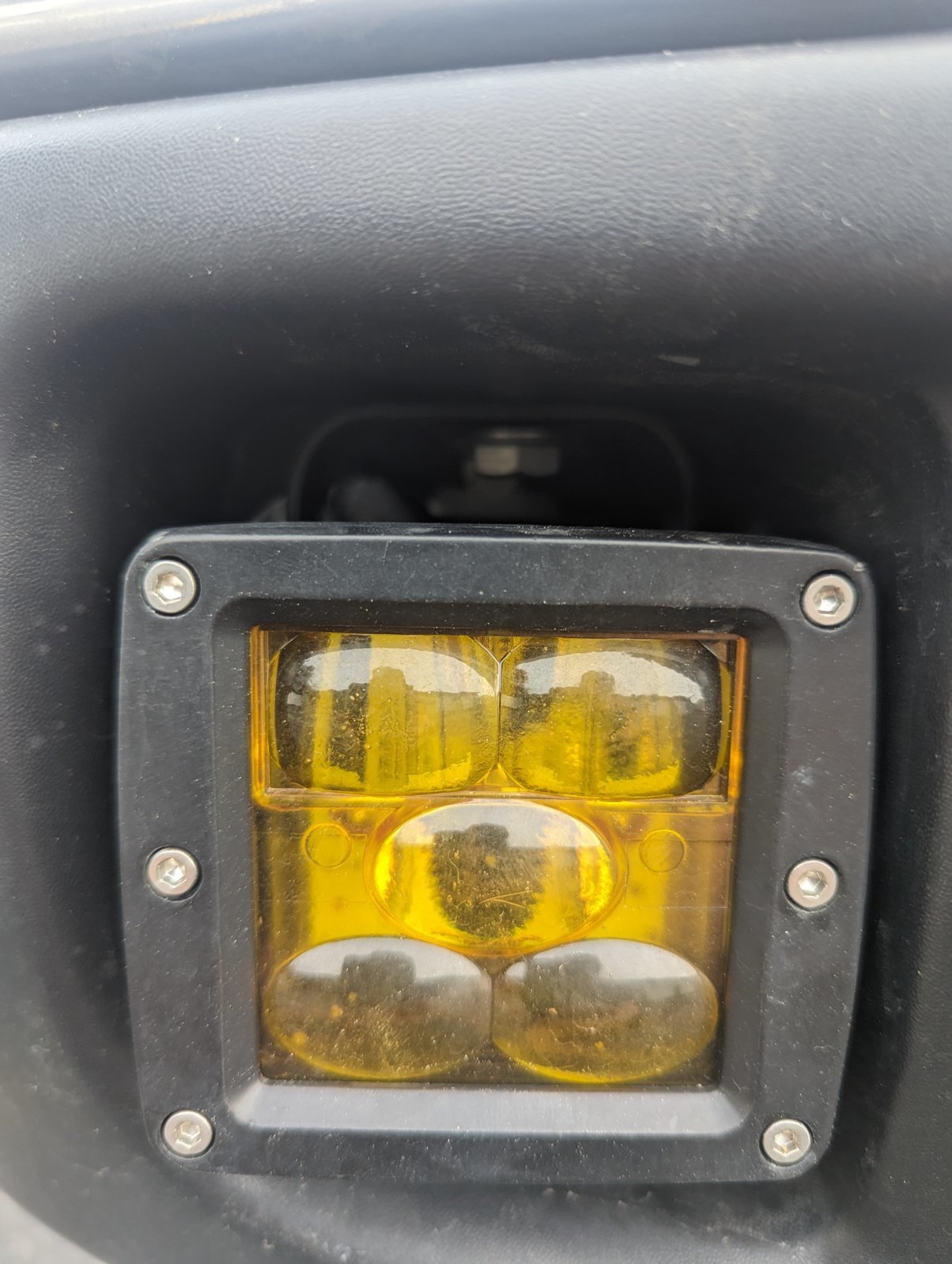

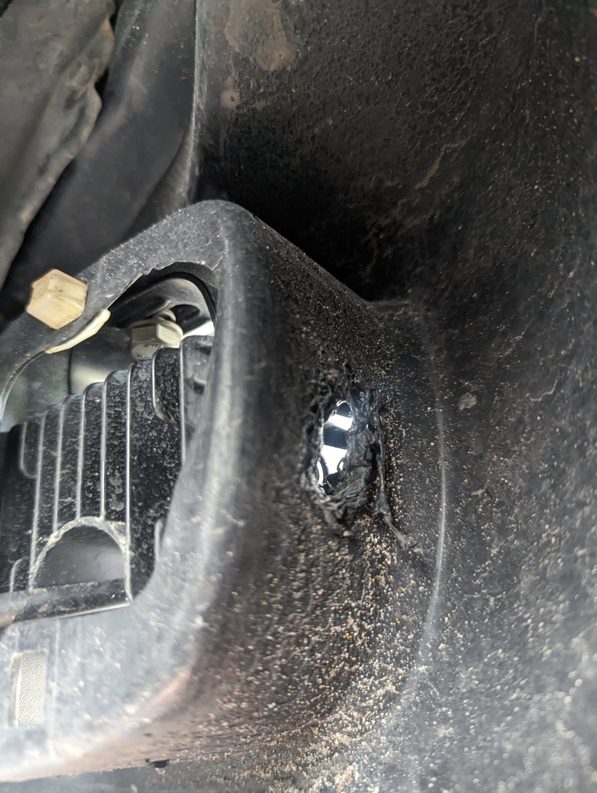

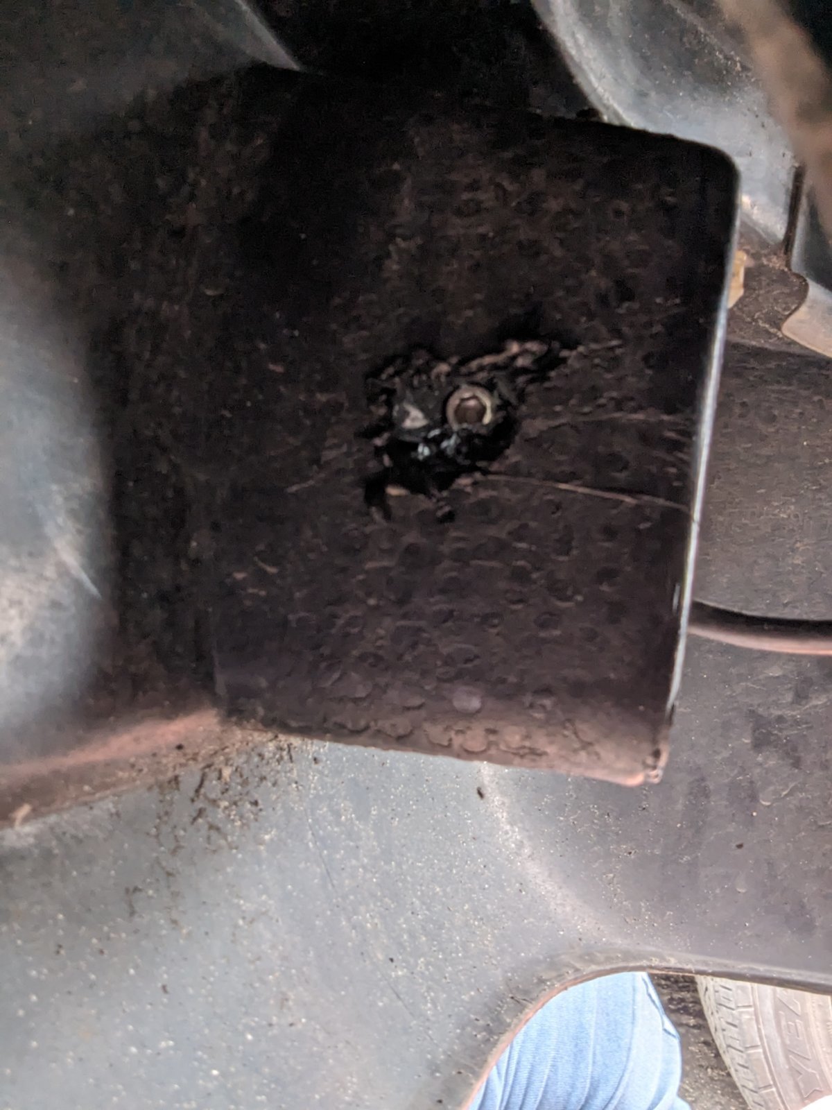

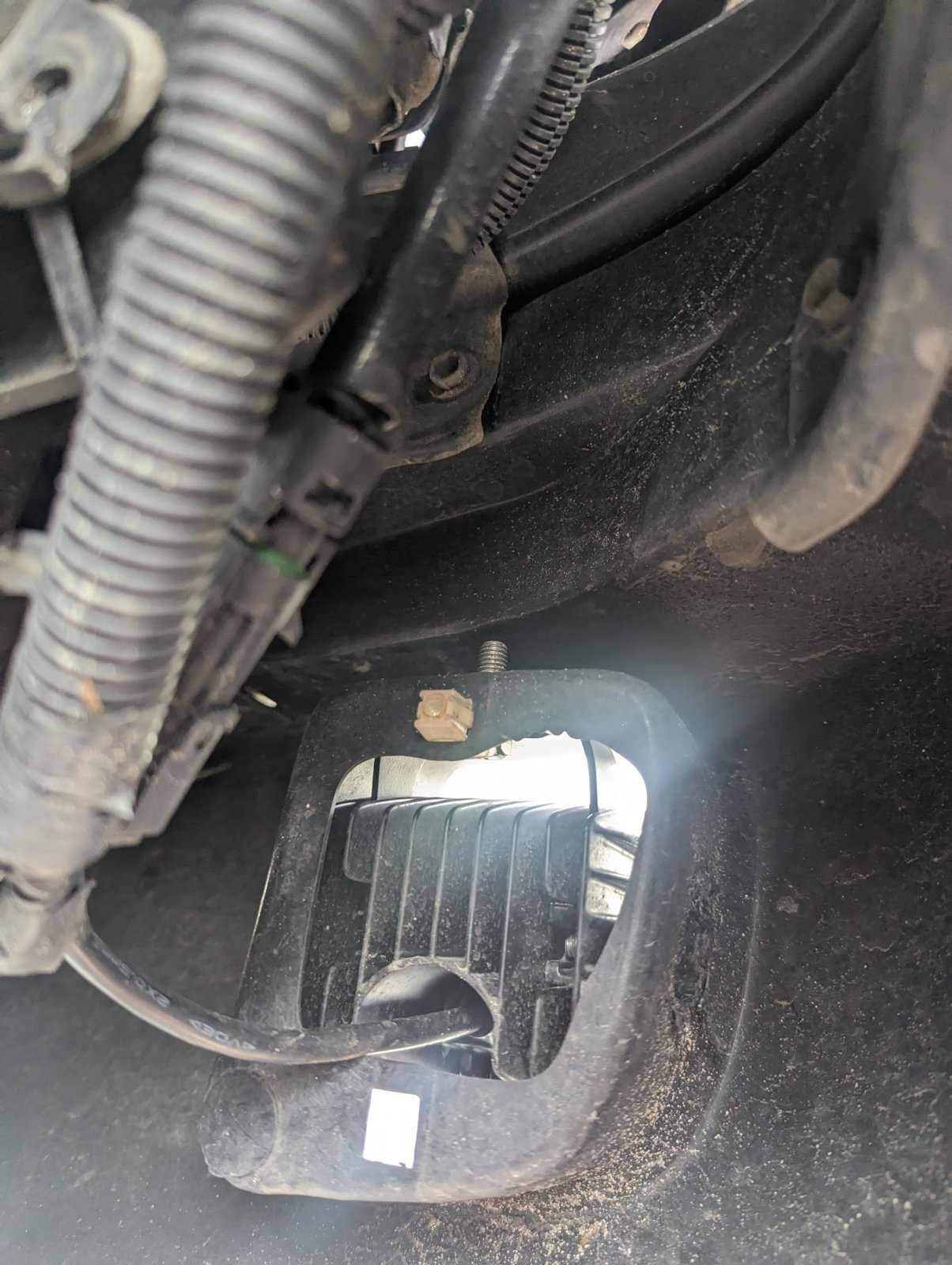

    It's been raining a lot here since I posted, so I forgot to follow up on this, so thanks for the reminder.
    It was pretty easy, actually, you don't even need to remove the bumper (although that would make it 10x easier). I did admittedly a pretty half-assed job at the install, and I'm still very happy with the results. I used these fogs:
    https://www.superbrightleds.com/led-fog-light-3-square-13w-1-700-lumens
    And hit the lenses with a few layers of this:
    https://www.amazon.com/dp/B005Y38S3E
    (4 inside, 2 outside), but really, any 3" pods should fit. Removing the turn signal housing is easy, it's just 2 screws on the back and then they slide right out. After, I drilled a hole in the middle of the top of the cubby, and just mounted the pods with the bracket like you would normally anywhere else. I recommend hitting the mounting bolt with some thread locker blue though, just for extra vibration protection. After, I realized I forgot to drill holes to access the retention screws for adjustment, so melted some holes in the plastic with a soldering iron. I recommend drilling holes on the sides of the cubby before you install them instead though, it's just cleaner that way. Here's some pics so you can see what I'm talking about. I'm thinking of posting a write up when I have time to take better pictures and (poorly) draw some diagrams.
    Something I thought about after was that it might be more secure if you take a Dremel to cut out slits for the arms of the bracket to slide through, and then mount the bracket on the top with the arms hanging into the cubby.

    Would it be possible to recess them more? You’d obviously need a way to mount them if it was too far in, I’m just wondering if they would be too large and start hitting the sides of the cubby space.

    There was plenty of clearance on the sides, the issue was the back. You could probably trim out the back some if you want them recessed more.

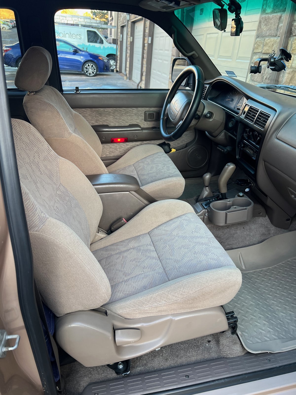

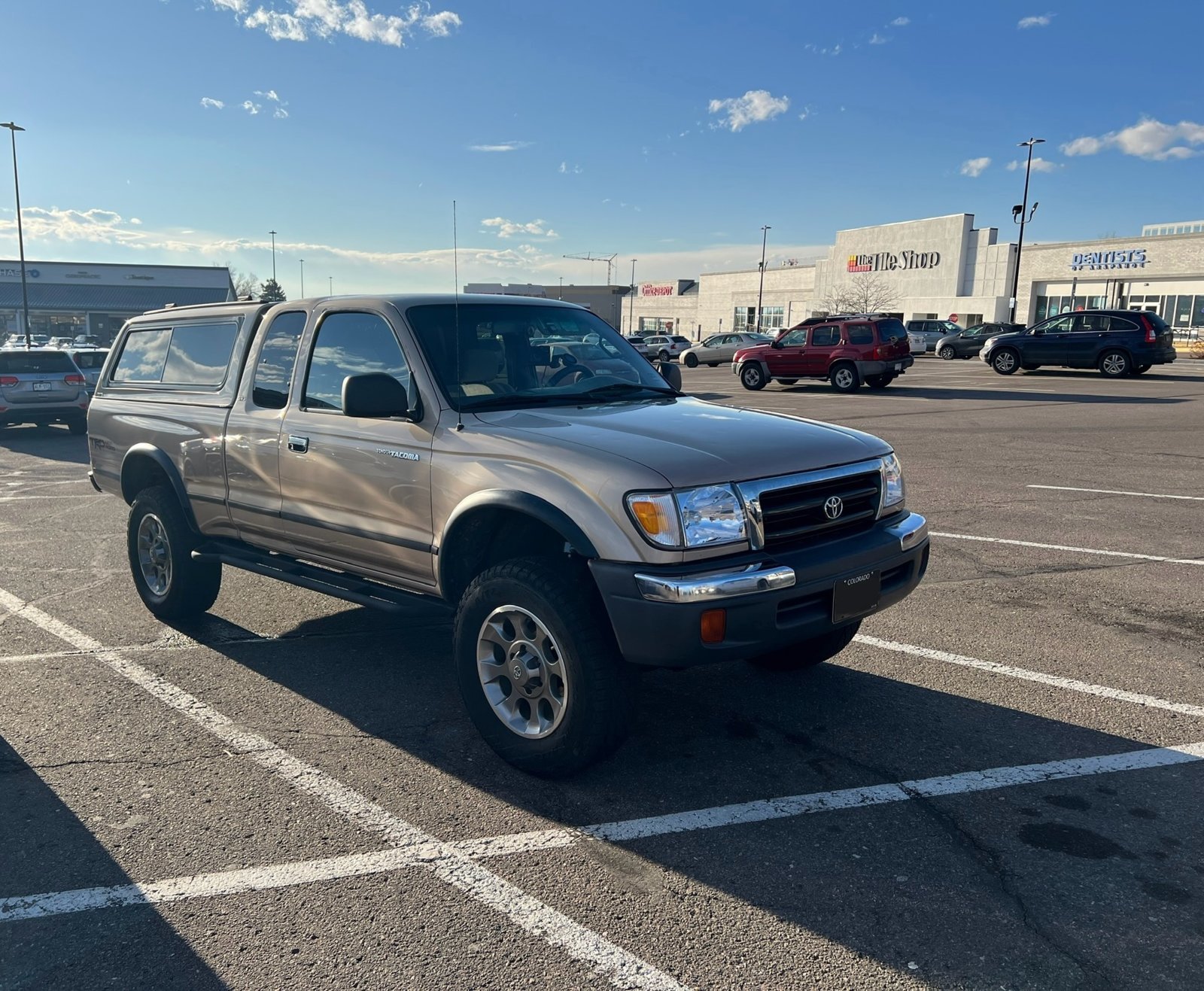

    Haven't posted in a bit! Finally got my camper shell sealed on tight. She's truckin along nicely. Working 60 hour weeks and gymming 5 days a week I just don't have time for much, but she's always eager and ready to go when I fire her up. Still so happy with how clean she is at this age, not bad for 25.
