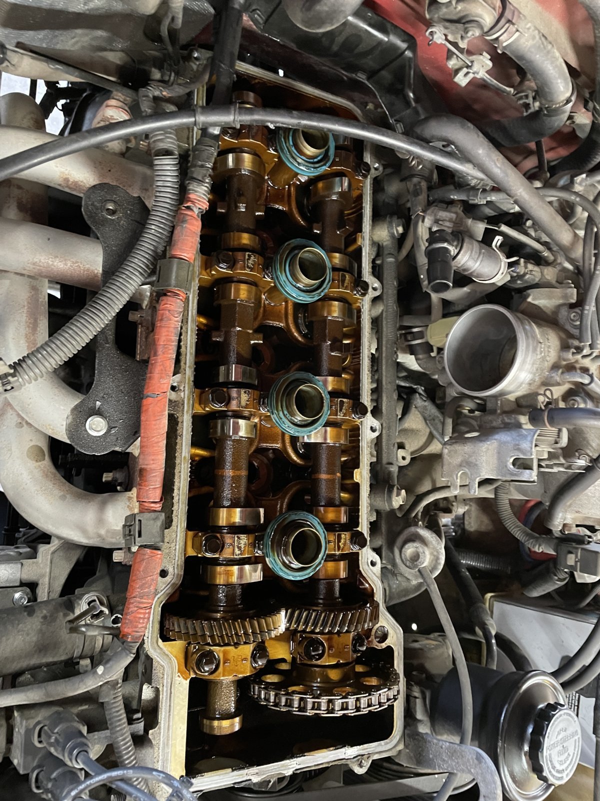

    Pulled the valve cover today to fix an oil leak. The spark plug seals stayed on the tubes…. The tubes were completely full of oil… those seals were installed by a Toyota dealer in 2017, they’re obviously not OEM.
    3RZ was running strong anyway!
    I got it all fixed up with new seals and new plugs.
