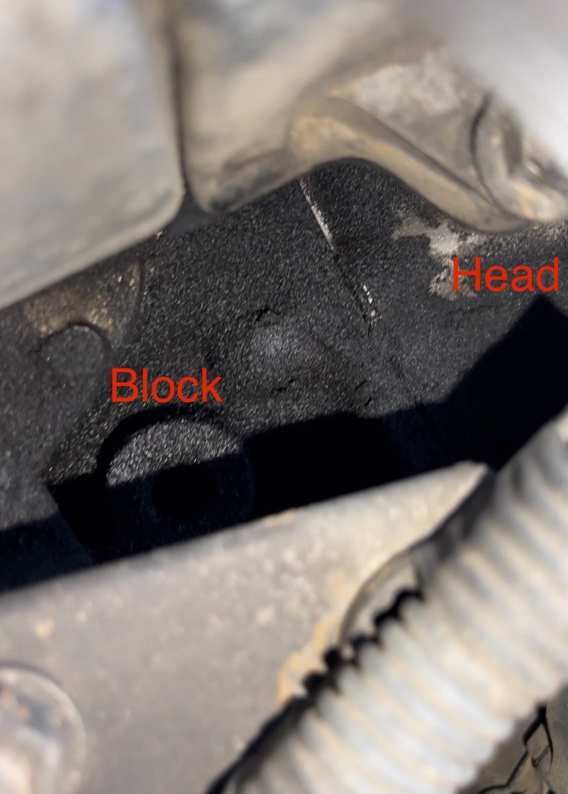

    What are the odds of oil leaking out between the head and the block? I did a full head gasket job and heads replacement a year ago so I’m praying that it’s just leaking from a half moon/cam shaft seal/or valve cover gasket. Oil and coolant levels seemed good at the time of this picture but it was still hot. Rechecking later when I get off work. 5vz

    Really unlikely

    probably valve covers. Notorious for leaking.

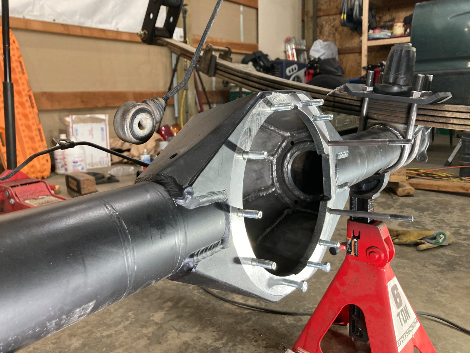

    After having this thing sit around for a few years, it's finally in. Probably not really needed, since the axle housing patch was still performing beautifully, but was in the area anyway and had someone who knew what they were doing there to help, so why not? Thanks Zane! @Speedytech7

    Nice! About time you got it under the truck.

    It makes for excellent eye candy... and an involved art project :p
