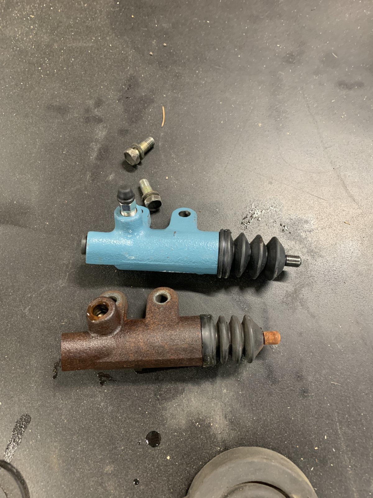

    New clutch slave cylinder. Didn’t fix the clutch return issue. :anonymous:

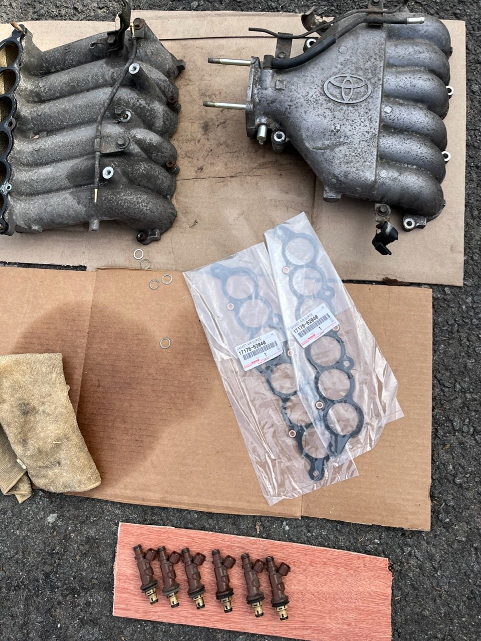

    Are injectors worth doing if you aren't having any significant issues with them?
    Only thing that may be improved that I know of with my truck is a quicker hot start, truck cranks a few extra times when hot and I've heard that may be the injectors. Not that big of a deal to me though..
    I'm putting new heads on so the intake manifold is off and they are just sitting there, so now would be the time to do it, but at $300 I don't want to just throw money at them for no reason? 290k and original as far as I know..

    A lot of guys start having issues with them when their trucks get up in that mileage range. If it were me and I was that far in I'd do them as preventative maintenance and know you're good for another 290k.
    Once they start to get clogged or otherwise act up, it seems many people waste a lot of time and money chasing easier other possible causes (MAF, plugs, coils, plug wires, TPS, IAC, O2 sensors, etc). $300 (actually only $150 I believe) now will prevent that whole headache. I think Motorwest will refurbish all 6 for $25 a piece (so $150 total).

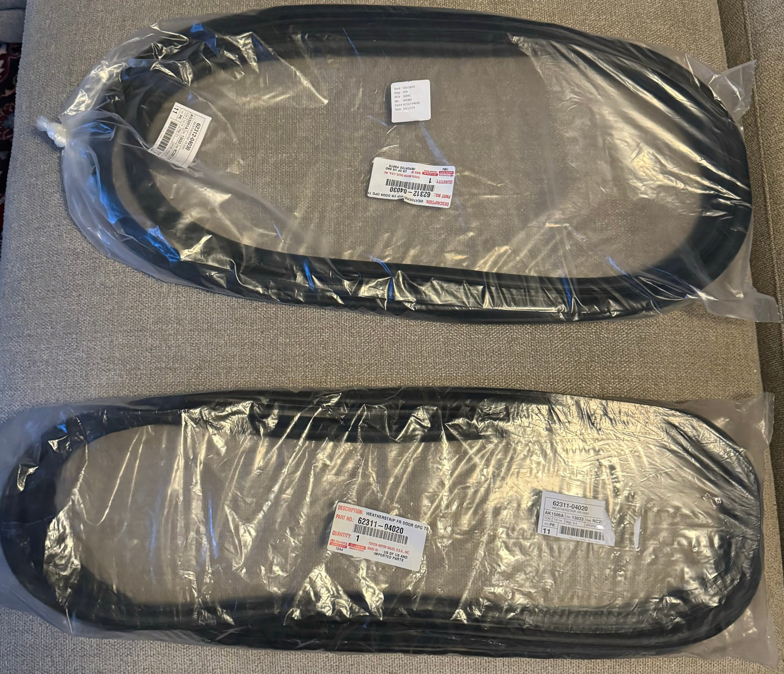

    I desperately need to do my door gaskets. All 4 of mine have tears/holes in them :bananadead:

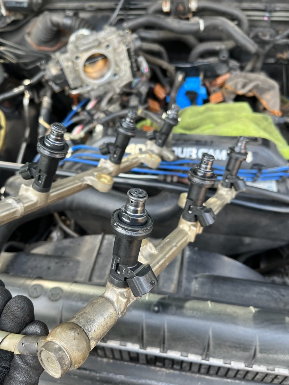

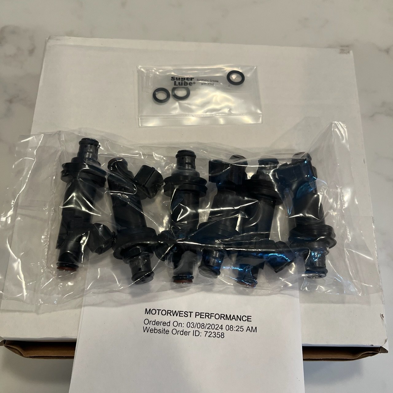

    100% worth it, feel like a new engine after. Granted, I knew I had one injector starting to fail - it would drip a tiny amount of fuel so restarting the engine after an hour or so would take a lot of extra cranking due to the cylinder flooded with fuel. Once it started throwing a random misfire CEL I knew it was time to replace all six since they are all original approaching 190K miles. Motorwest’s black injectors also solves the internal solenoid issue with the original factory ones so that was also a reason I paid more for these.
    Any rough hesitation at idle is completely gone. Truck cranks perfectly now on a warm restart. Throttle and power delivery is much smoother, especially climbing inclines at highway speeds.
    This was honestly the single most noticeable maintenance improvement I’ve made to the engine. The injectors live up to the hype I’ve read in the reviews.

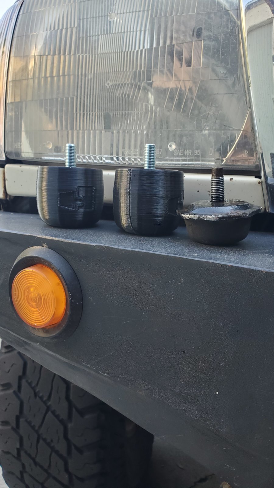

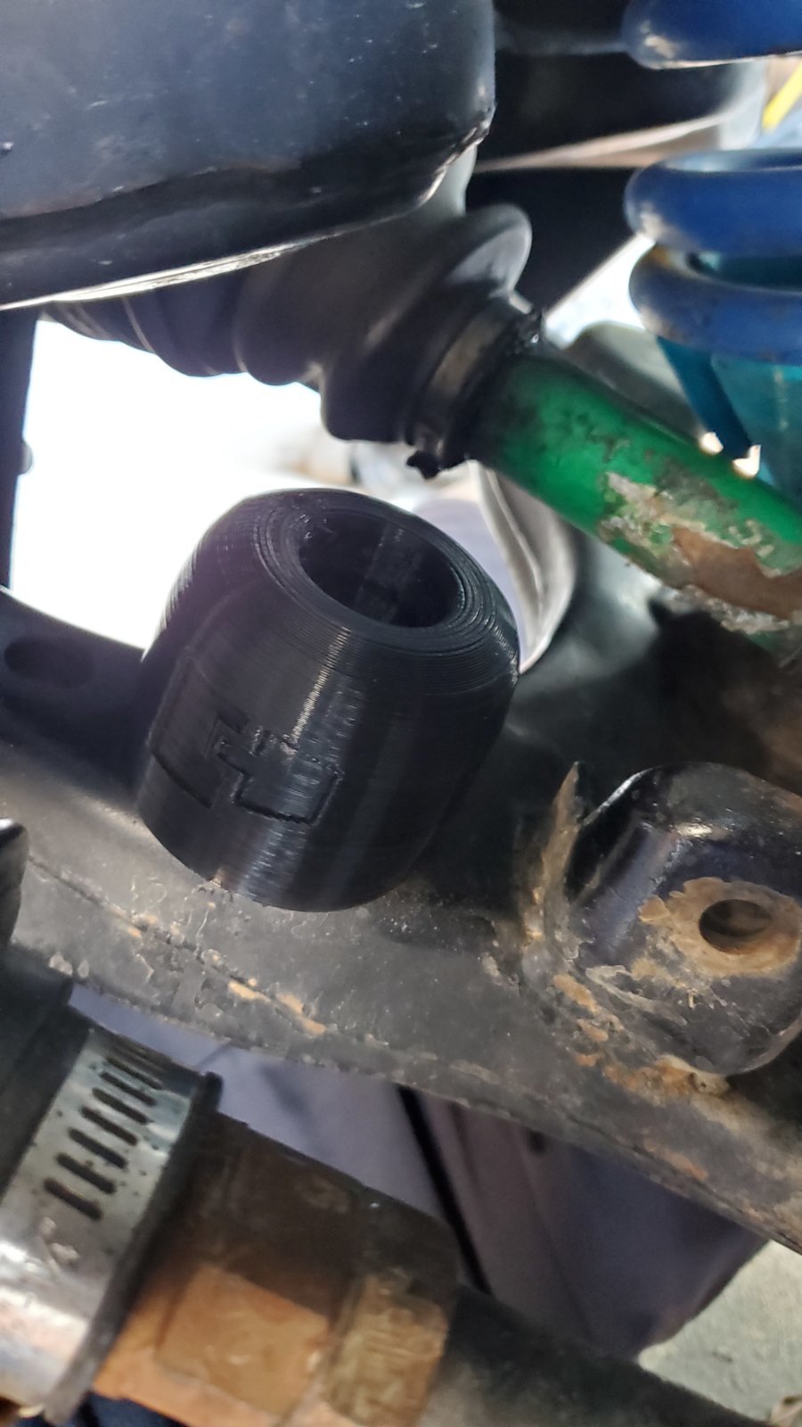

    Perry parts front bumpstops got installed. Should have the chance to test these out soon in the desert on some high speed stuff. Hopefully they don't make the ride so nice I start breaking other stuff...

    Those don't look like they will last long to abuse to me. Looks like they will split apart after some light abuse along the 3rd printing lines.
    I'd look at Durobumps once those die.

    The guy that makes them says they should last longer than duros and has a replacement guarantee

    They have a 2 year warranty, so we'll see how they do

    interesting. They don't look like they will last long given all the places it has to come apart.
    granted I don't think really any rubber bump is meant to last long in this world haha
