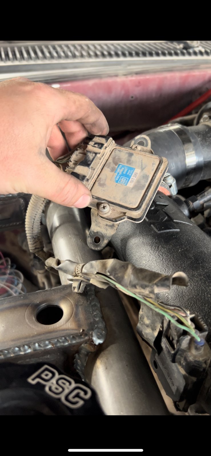

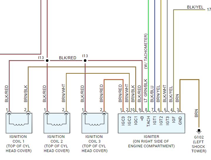

    Any ideas why this piece near the maf sensor needs grounded for the truck to start? I have two grounds from the block to the frame. The original one from the fuse block to a ground junction to the frame. And the battery is grounded to the frame as it got moved to the bed. The minute this thing comes off the frame the truck dies and won’t restart unless I put it on the frame again.
    also I removed the mechanical fan. The pulley has the 4 bolts through it but do I need to put anything on the end where the fan slipped on? It feels tight but running it looks like it has slop.

    It's less Tacoma and more mod
    Well that piece is the igniter. You kind of need that for your ignition coils to do anything at all... It must ground through the bracket I don't have the wiring diagram in front of me right now but when I relocated mine I made sure it was grounded

    Thanks I’ll ground it then. My personal truck it isn’t grounded and it runs fine and never had an issue so was stumped. I have to recheck the ground from the battery to the frame but I’ve been chasing my tail on why it won’t start without this grounded.

    @malburg114 It says it does have a ground wire in the harness so you may want to make sure that wire isnt broken if this unit fails to work when not fastened to metal

    Perfect. Thank you for this. I’ll trace all the wires now that I know what to look for
