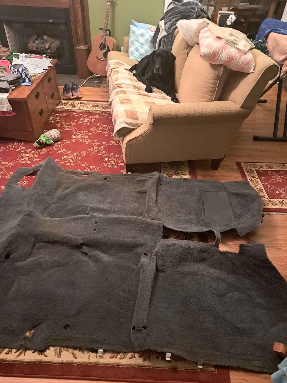

    Cleaned my carpet on 97.. sprayed it with blue coral an pressure washed with hot water.. still wet, so i folded it 3 times rolled it up an stuck it in the washer with some dep degreaser cuz think i had a leaky bottle of 2 stroke or chainsaw oil one living in tha backseat while back.. frontloader worked out nice and came out surprisingly dry lol... ive been trying to fit a pair of late 90s sr5 4runner seats but im tryna figure out the mounting.. went cut and weld but i have other taco seats to steal mounts from i wasnt happy to see they likely wudnt fit cuz the metal frame is wider an rails are riveted.. so weld it is i guess watever..gotta set of 02 taco buckets but they need a recover.. cant stand 60/40 on long rides anymore.. better done without carpet lol.

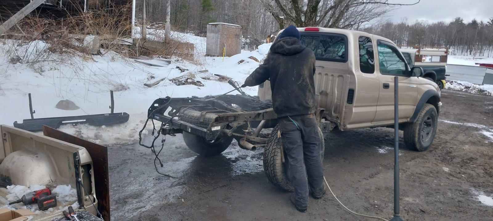

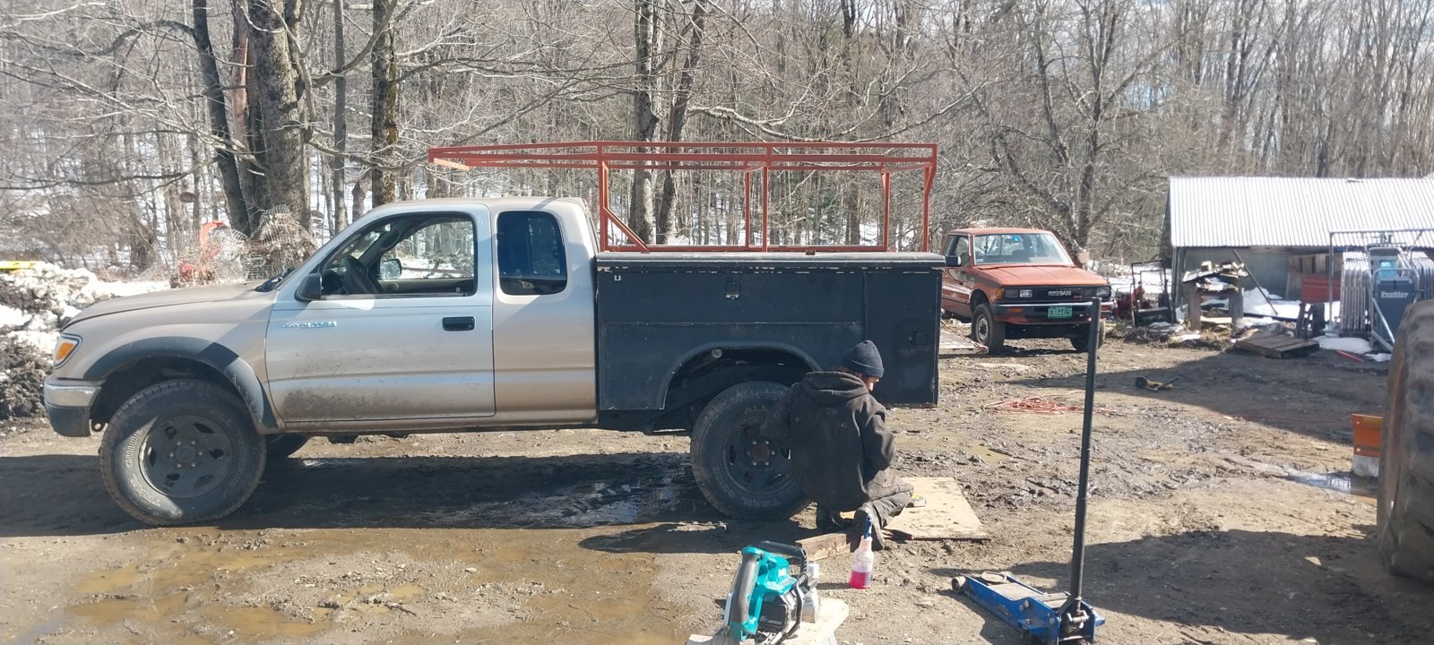

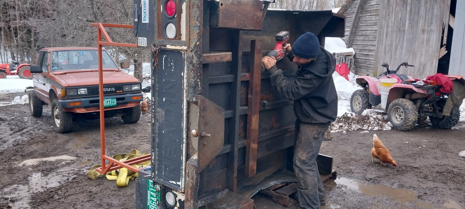

    Helped my buddy swap the service body of a 720 onto his (my old) first gen. Is it now the only taco w a service body? We were wondering what the bed was originally for. Maybe a short bed full size? Its about 66" wide, so fits great on the taco. Had to make some new crossmembers for it, but turned out great!
    The 720 will get a flatbed and replace their atv on the farm. Cheaper and cooler than a side by side! The thing runs great and was a PNW truck until recently so its got good bones.
    Ill be getting the gold box from that truck for mine. Previous owner slopped on a rubberized bedliner when bed floor rot started, and it got so much worse. I tried stripping some of it and found fist sized holes at every joint in the bed floor. Been running w a drop in liner, stoked to get a decent bed.20240406_105511.jpg 20240406_115933.jpg 20240406_141707.jpg 20240407_150743.jpg 20240407_160212.jpg

    I want one of those beds!

    That bed is def for a medium sized pickup. I put an old one on a fullsize chevrolet for the pool company back in the day and it was way wider than the cab...

    Right! Hes so stoked!

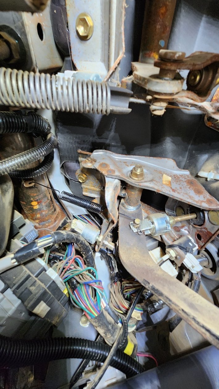

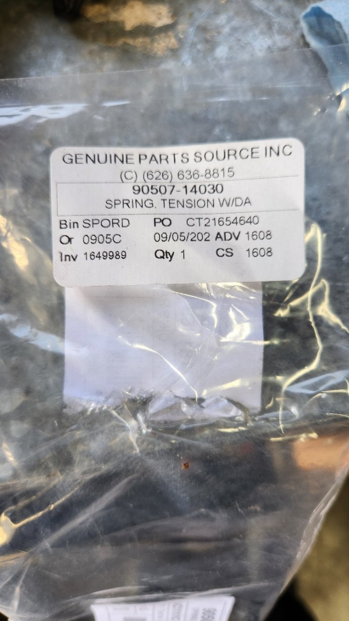

    Finally got around to installing the linear clutch return spring. I guess it was due after a bit over 400K miles.
    Here's the spring I used:

    Could you share a picture of it installed? I just destroyed my new bushing during reinstall yesterday and had to improvise a new "bushing". Probably on borrowed time with this new set up.

    As I learned on TW, the dash connection is already there. The clutch pedal side connects to the groove on the pin on the pedal arm. I was able to pop the torsion spring out without removing anything.

    That's pretty slick and way easier. Can you notice any difference in feel?
