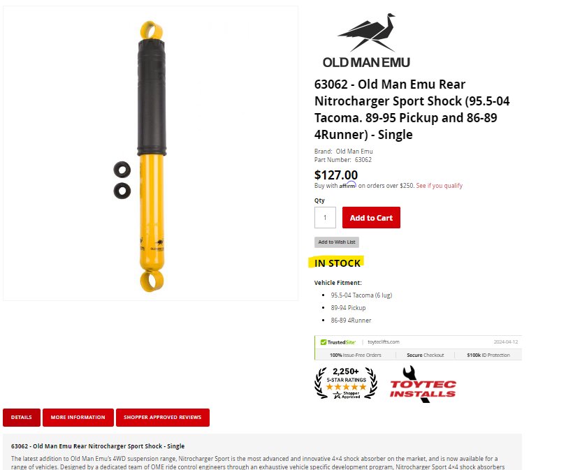

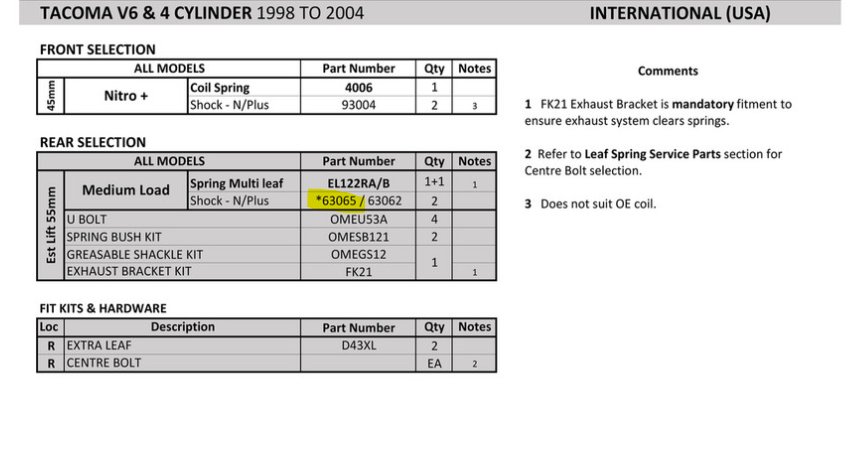

    OME/ARB's current spec sheet shows another part number for 1st gen in addition to the original 63062. The additional part# is 63065. When I look up 63065 I see it as for the Landcruiser 60 series. https://**********/products/63065 The dimensions listed are the same as the 63062 shock. 63065 is slightly heavier than 63062. What this all means :notsure:, for you to decide lol.

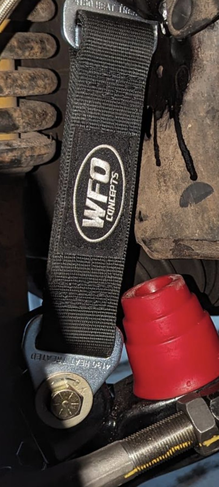

    installed limit straps and energy bumps. letting my tie rod ends limit down travel wasn't quite working:laughing:

    How do those bumps interact with the frame and full compression? They look like it would be a glancing type contact, not direct.

    the pic is pretty deceptive at full droop, I'll have to try and take a compressed pic, the majority of it ends up under the bump pad and gets compressed. it's not 100pct contact and I may cut the top ring portion off so it gets flatter engagement but for $30/pair it will hold me over til I find the durobump I misplaced when I tore everything apart :homer:

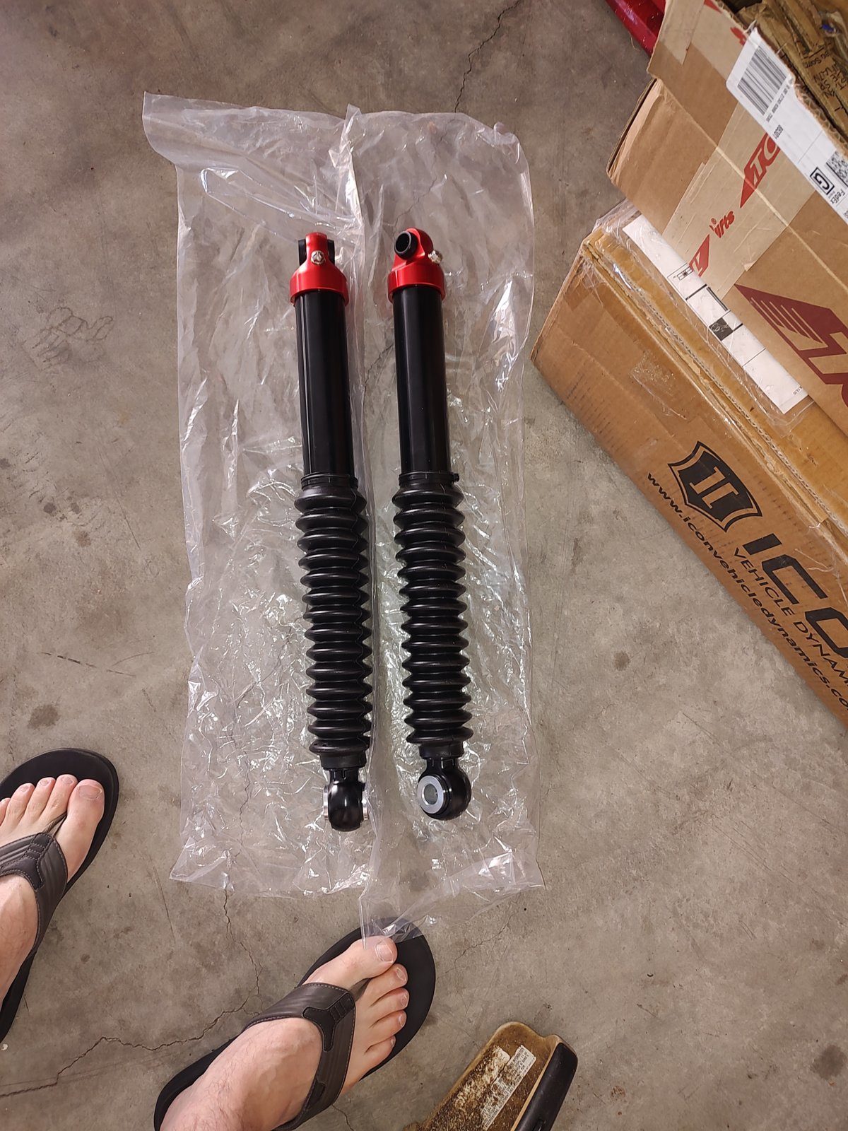

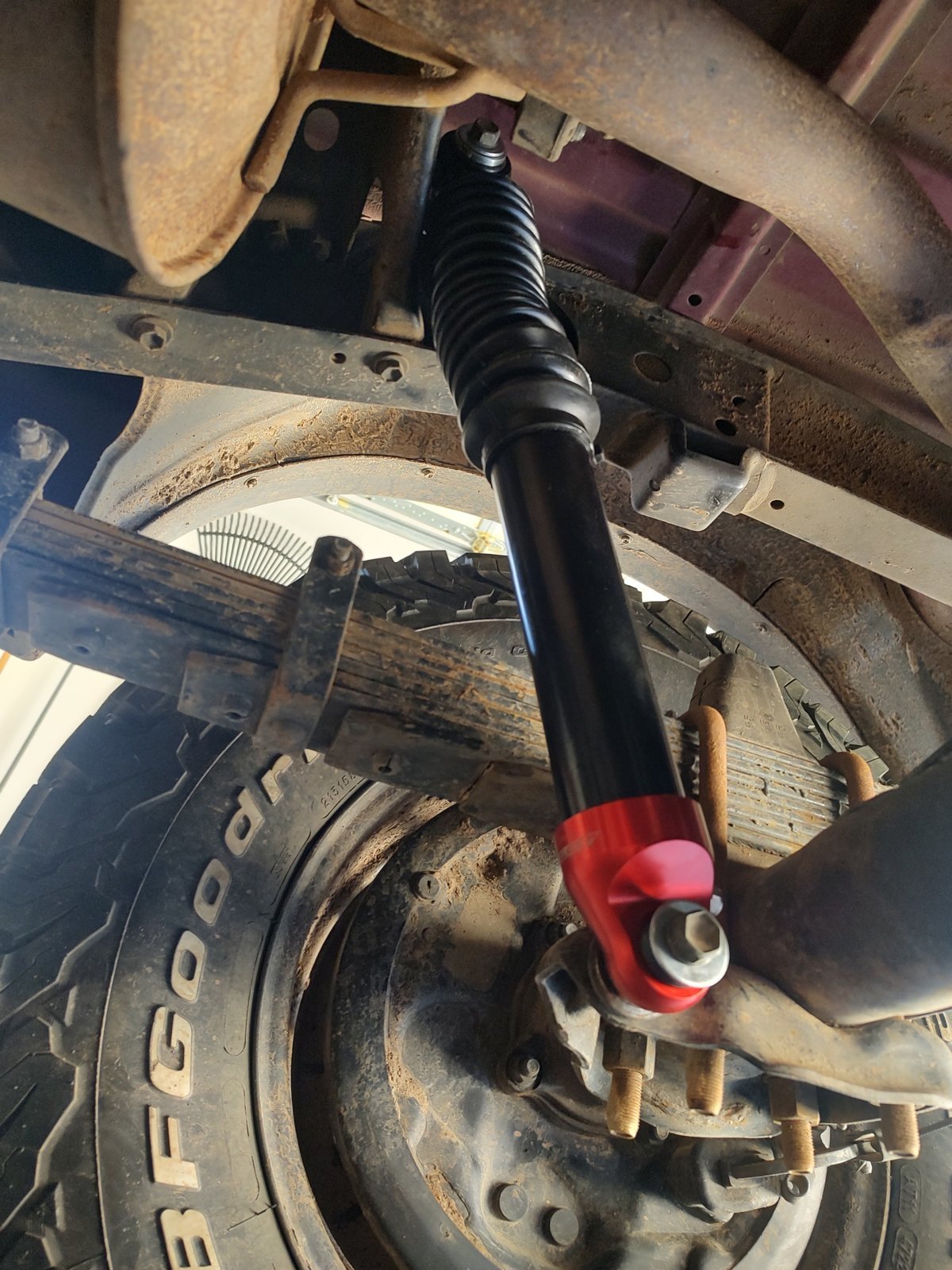

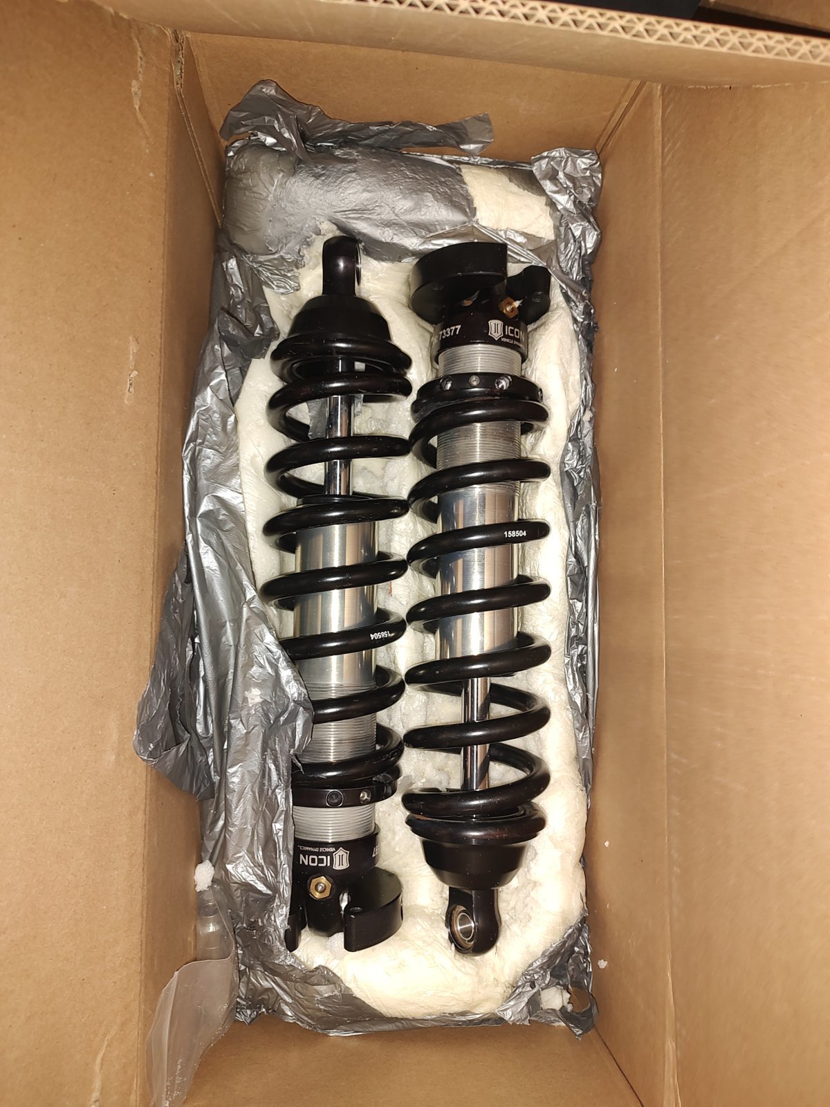

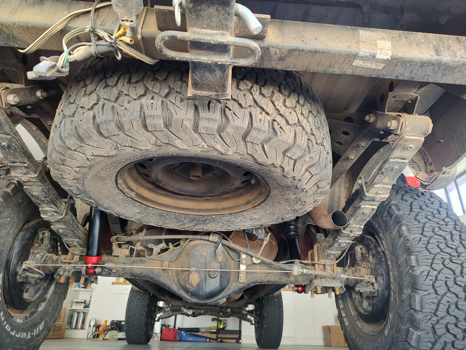

    Off with the 5100s and on with the Toytec Aluma 2.0s on the rear.
    Got Icon 2.5s waiting to go on the front, once my Icon Delta Joint UCAs arrive.
    *Edit: just realized the shocks are on upside down... Whoops

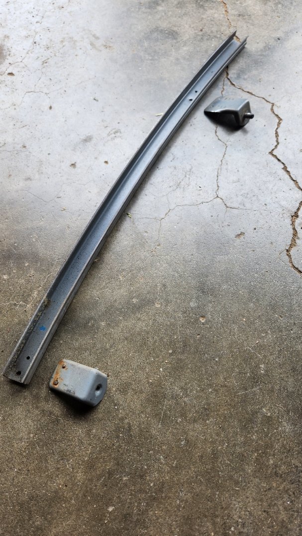

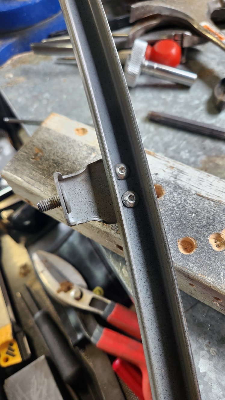

    Well, that explains why the window had a mind of its own.
    Being a little cheap and impatient, I fixed it up with some M5 screws and nuts.
    Happy the window does what I want it to do now.

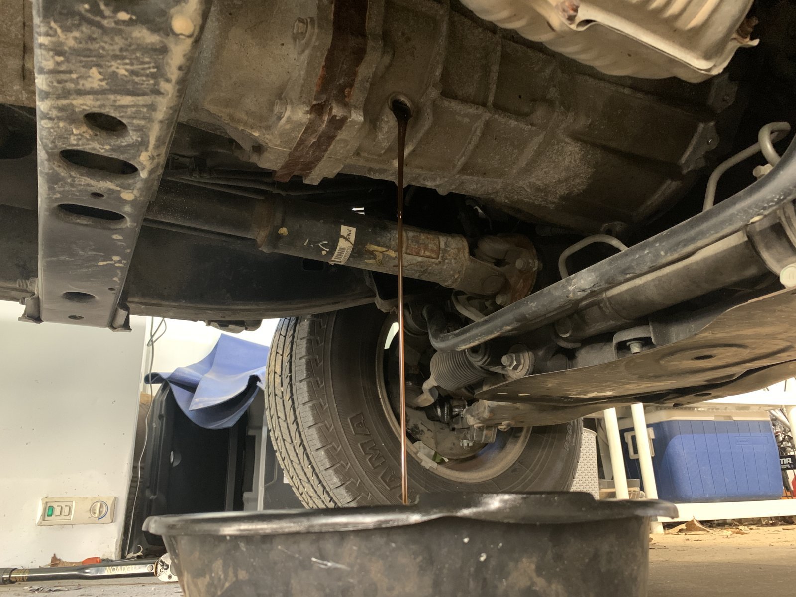

    Manual trans fluid drain and fill on the new truck. Old fluid looked really clean and there was hardly anything on the drain plug.

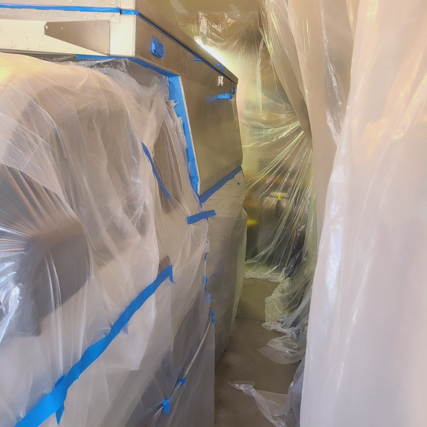

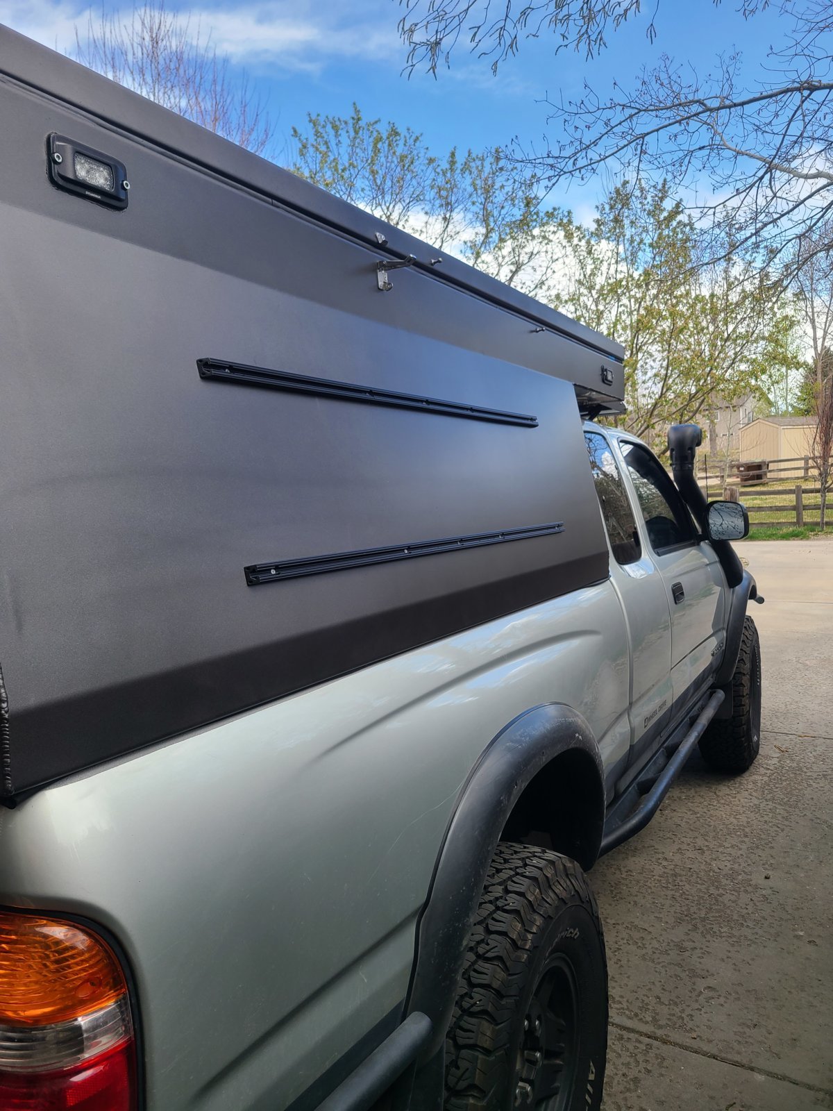

    Camper changed colors this weekend

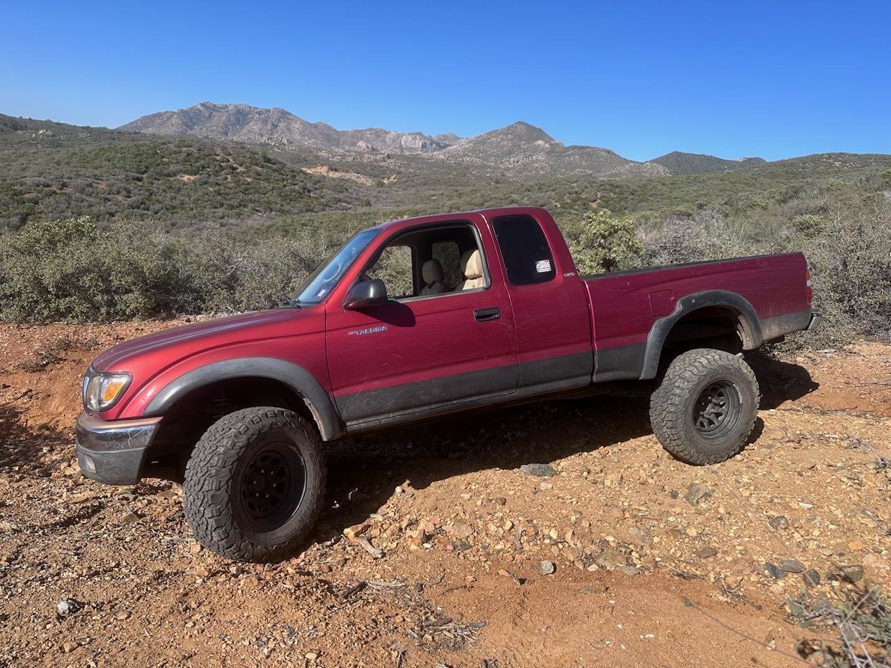

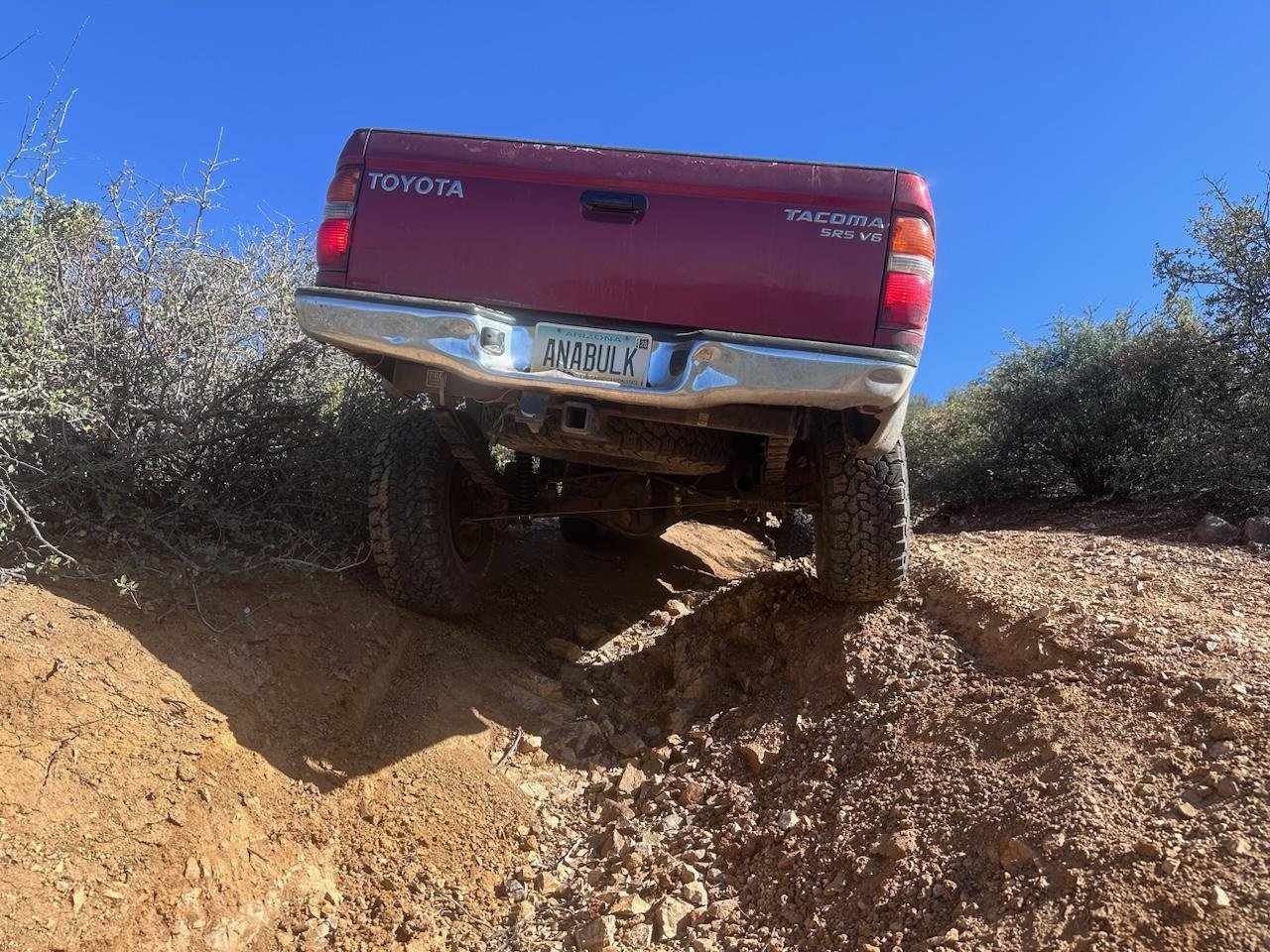

    Finally got time to take the truck out and test out the Eaton locker. Also fitted some Toytec Aluma Series 2.0s, and they seemed to let the rear end flex a bit more than the old 5100s.
