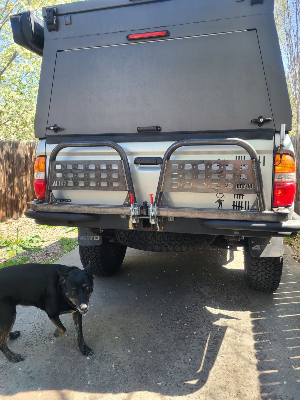

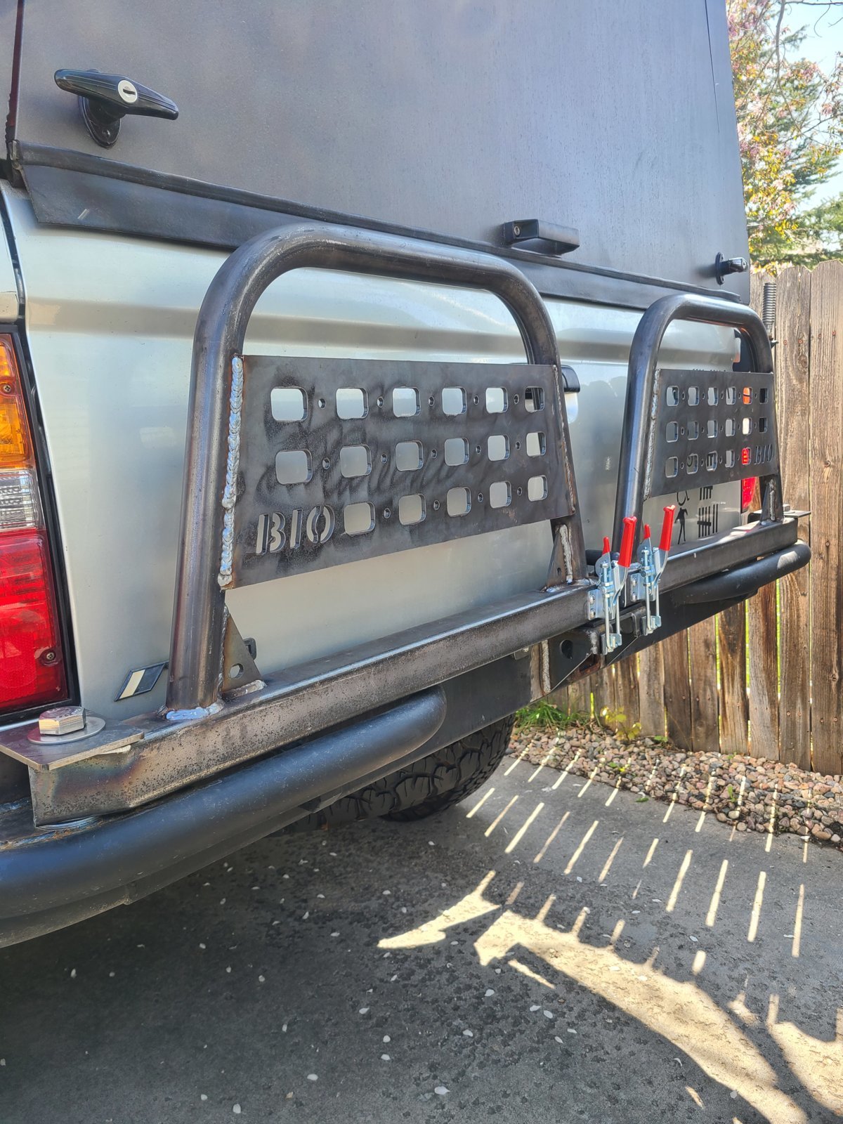

    Got the swingout arms welded up.

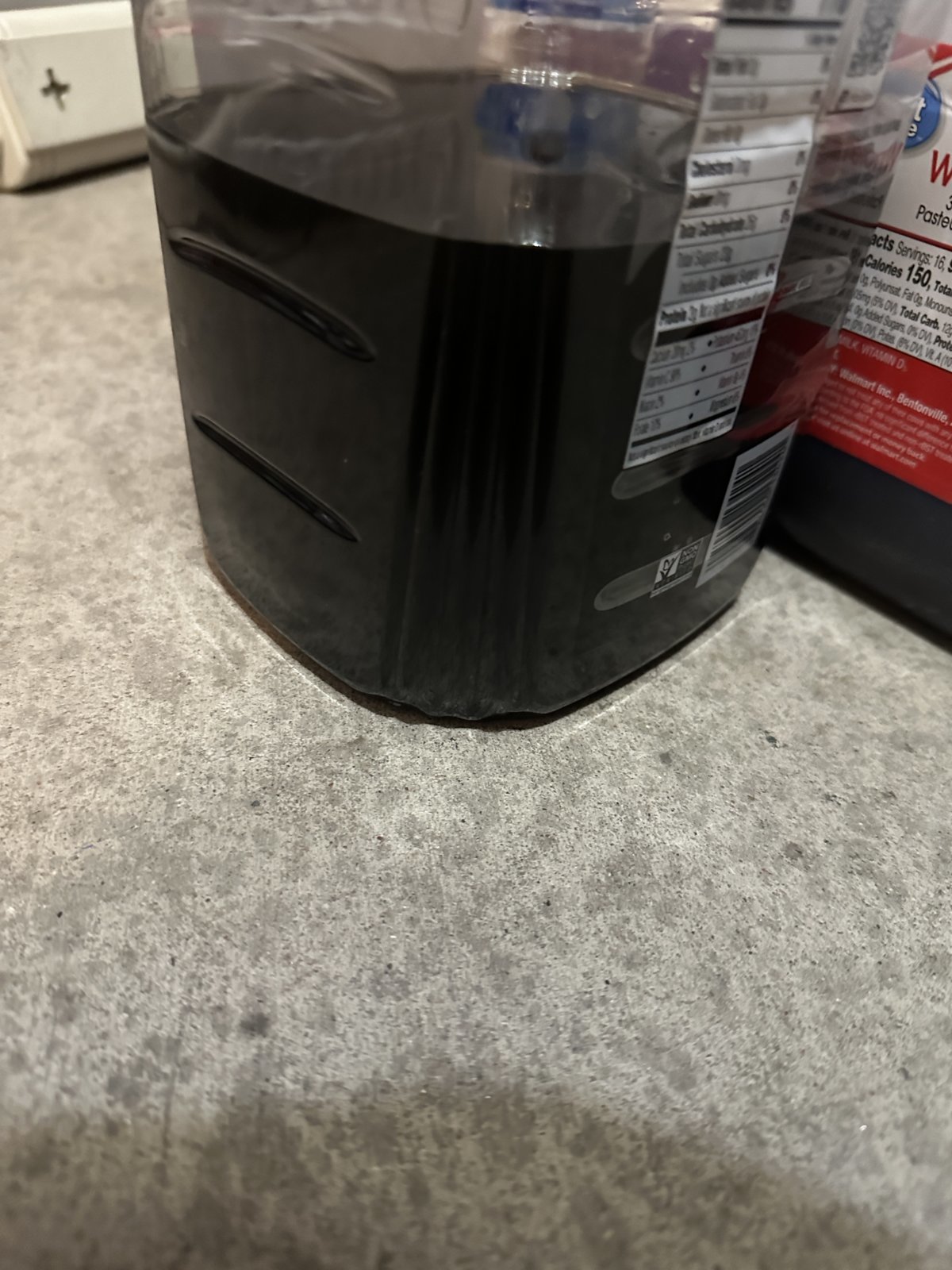

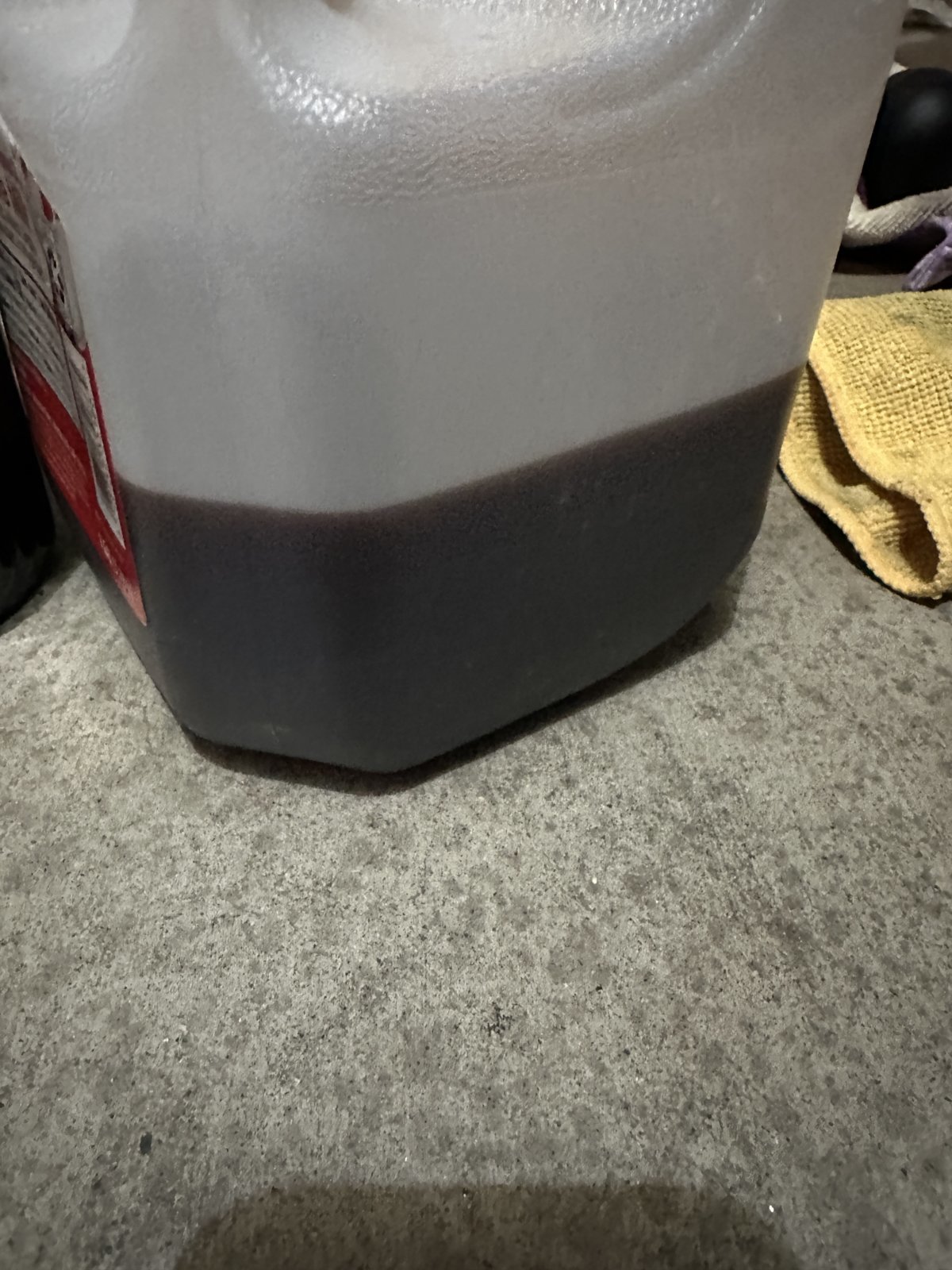

    Flushed my brake fluid
    and power steering fluid
    Both feel the exact same, but at least they’ve got fresh fluid. Wayyy past overdue on both.
    Should be light gold and red not black and black :anonymous:

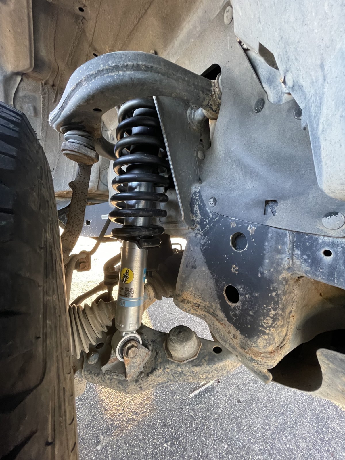

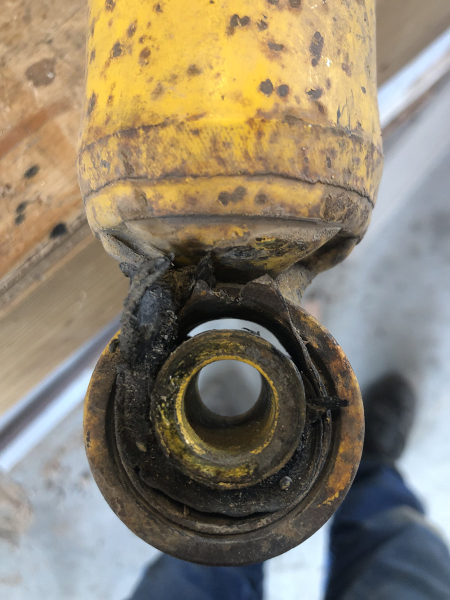

    New shocks. The bushings on the front ones were in pretty rough shape.

    If that is OME they will send you fresh bushings.

    Thank you, that's good to know. Yes, they are OME. I replaced them with identical OME shocks, so, I will keep that in mind for the future.

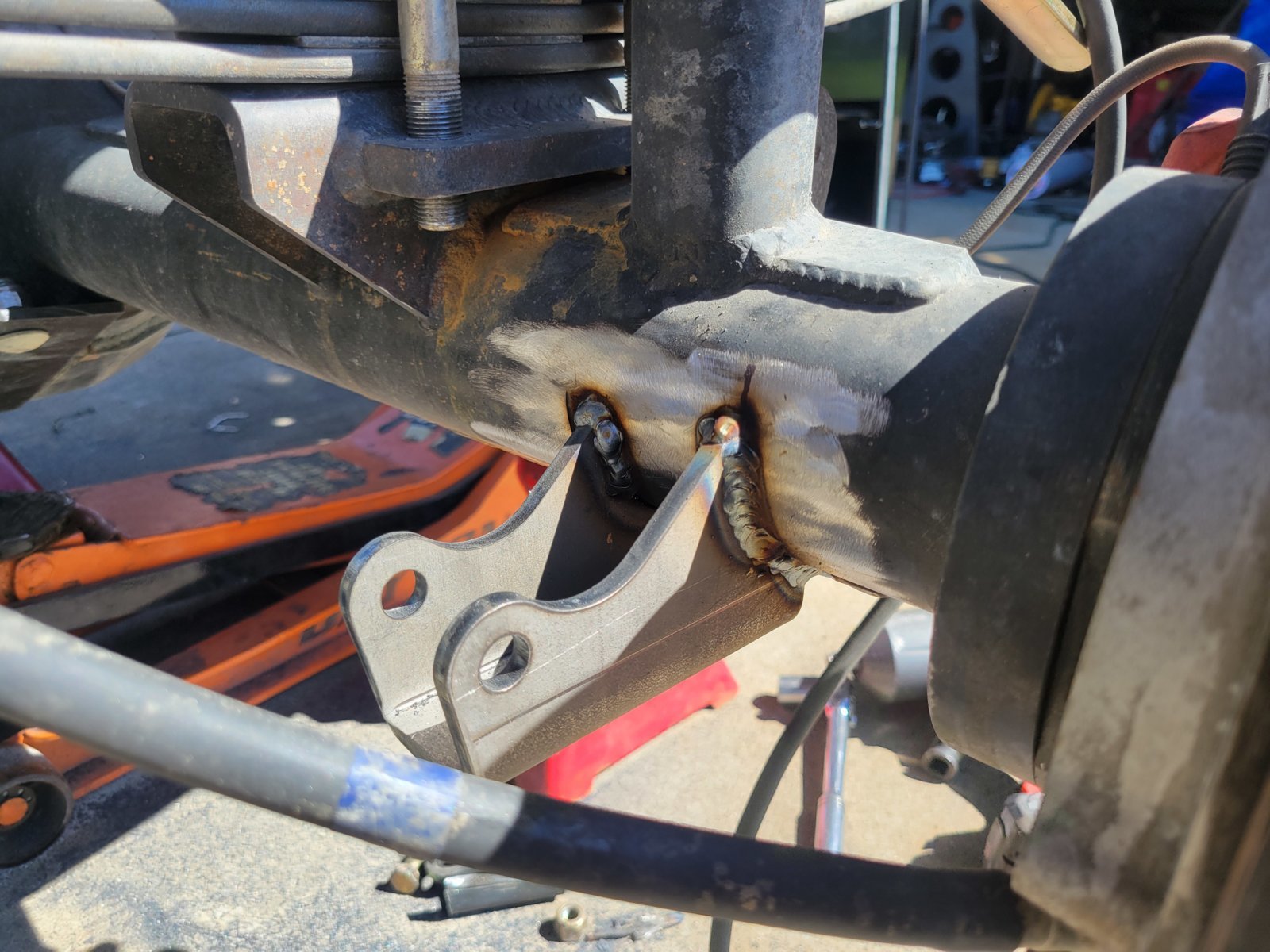

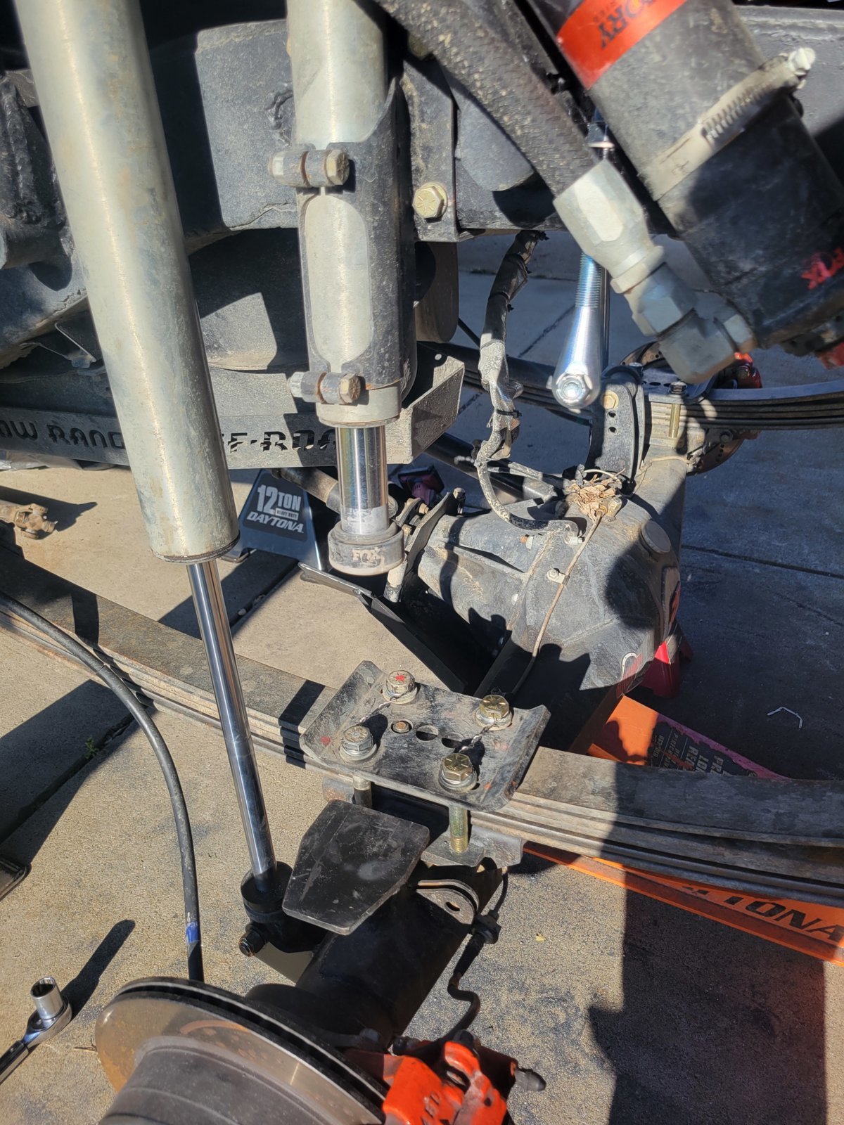

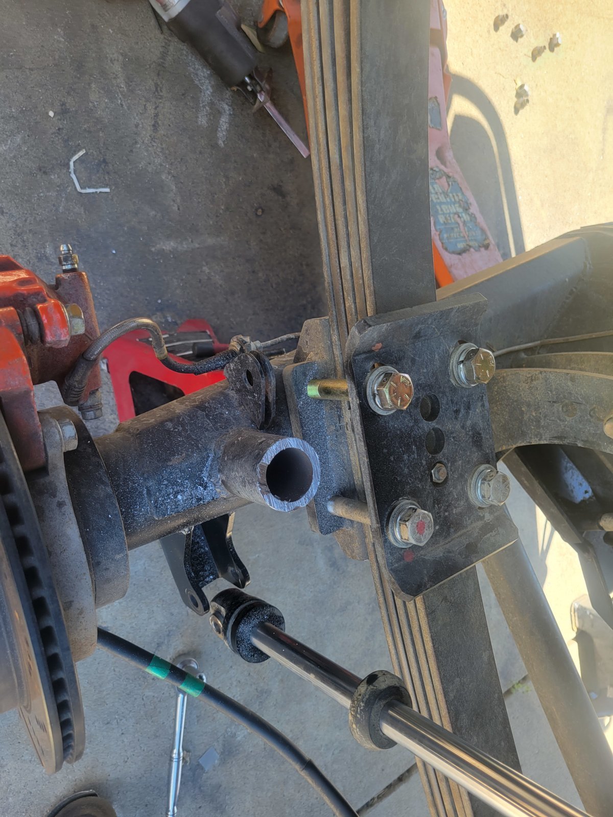

    Just 3 tons of fun!!!

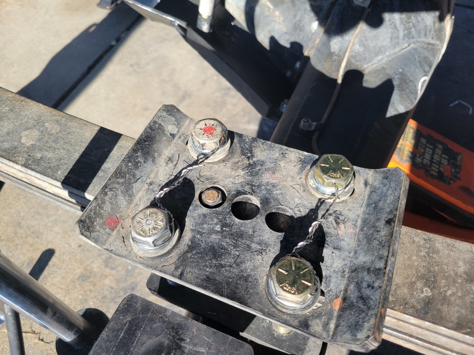

    5th leaf re-installed.
    Lower shock mounts relocated.
    Bump stop pads lowered.
    Limit straps mounts finished.
    Straps measured and ordered.
    Hydrobump pressure adjusted.
    That's pretty much the list of things I identified, on the test runs, that needed adjustment.
    I thought I may need to shorten the shackles when I added the leaf back in (because I though the leaf may lift me too much). But I'm only at a 2.5 inch rake, unloaded, and without it setting and settling. The 7 inch shackles give me the perfect amount of droop. The leafs droop out at almost the exact same point the shocks droop out. The limit straps will still be there for an "oh shit moment" though.
    The up travel goes to full bump .5 inch before the shock bottoms out.
    Giving me 5.5 up travel and 8 down travel.
