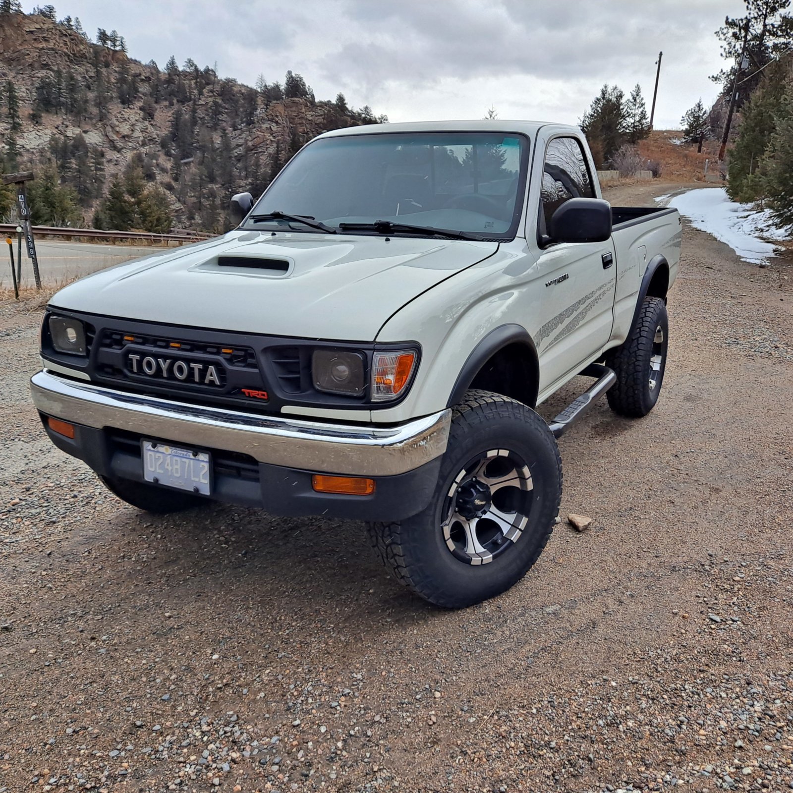

    New shoes on ol' girl

    Love the color

    Thanks, it's OD green rhino liner

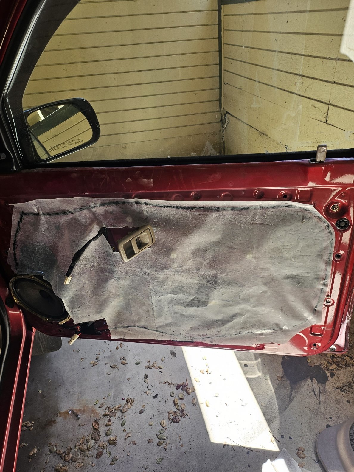

    old shower curtain re purposed.. had to adjust my lock actuator, was opening but not locking completely.

    That is smart. Tho I’ve always wondered how important those really are. Is it like a dust shield or something?

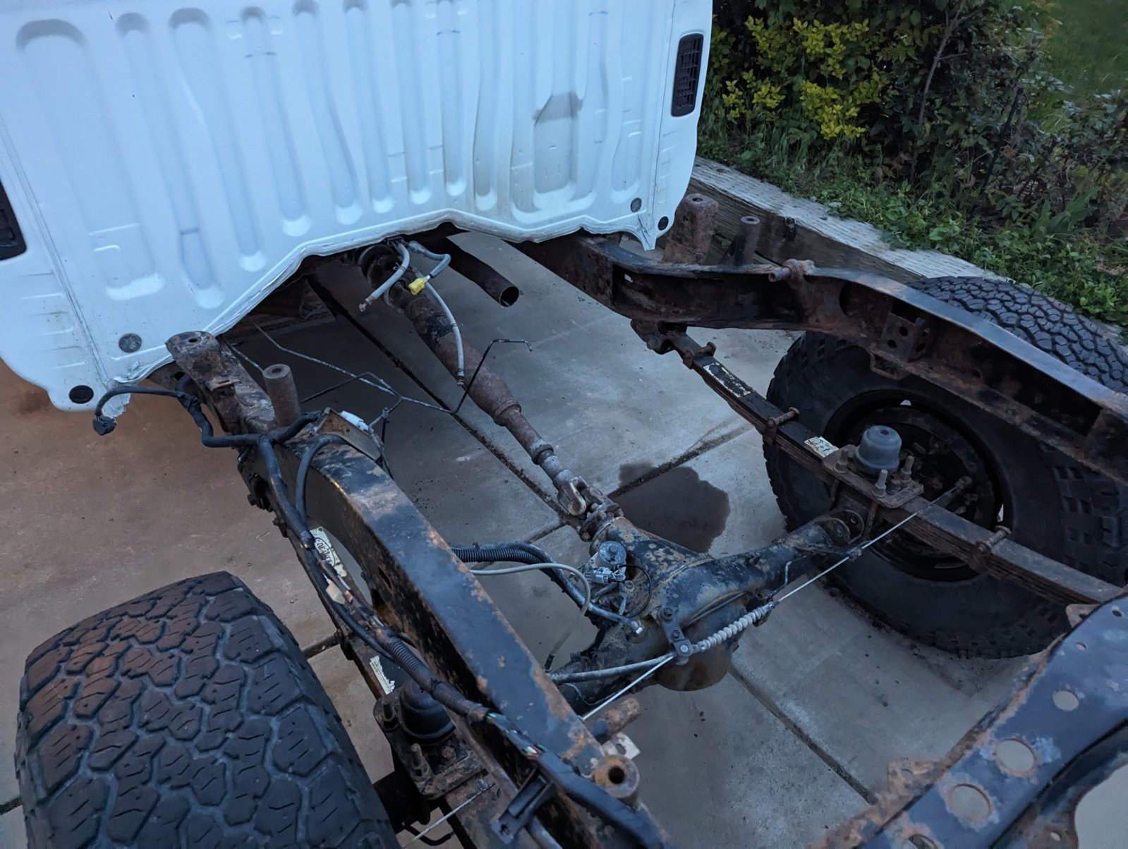

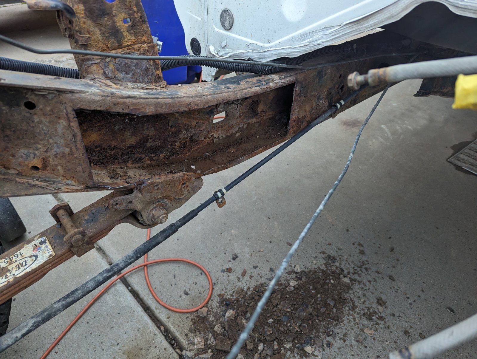

    P.Blackley
    P.Blackley Well-Known Member
    Jul 30, 2014
    #135093
    224
    Patrick
    Layton, UT
    99 Tacoma 4WD SR5
    Fox extended coilovers, LR UCA's, Deaver J59's W/ 12" Fox triple bypass shocks

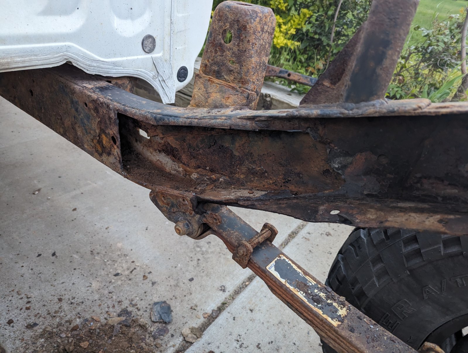

    Got the front cross member removed and the cancer rust cut out this evening. Next step is cleaning out the inside of the frame and removing all the loose surface rust. Then a coat of rust conversion.PXL_20240509_024316746.jpg PXL_20240509_020317076.jpg PXL_20240509_020311828.jpg

    How do you adjust the actuator?

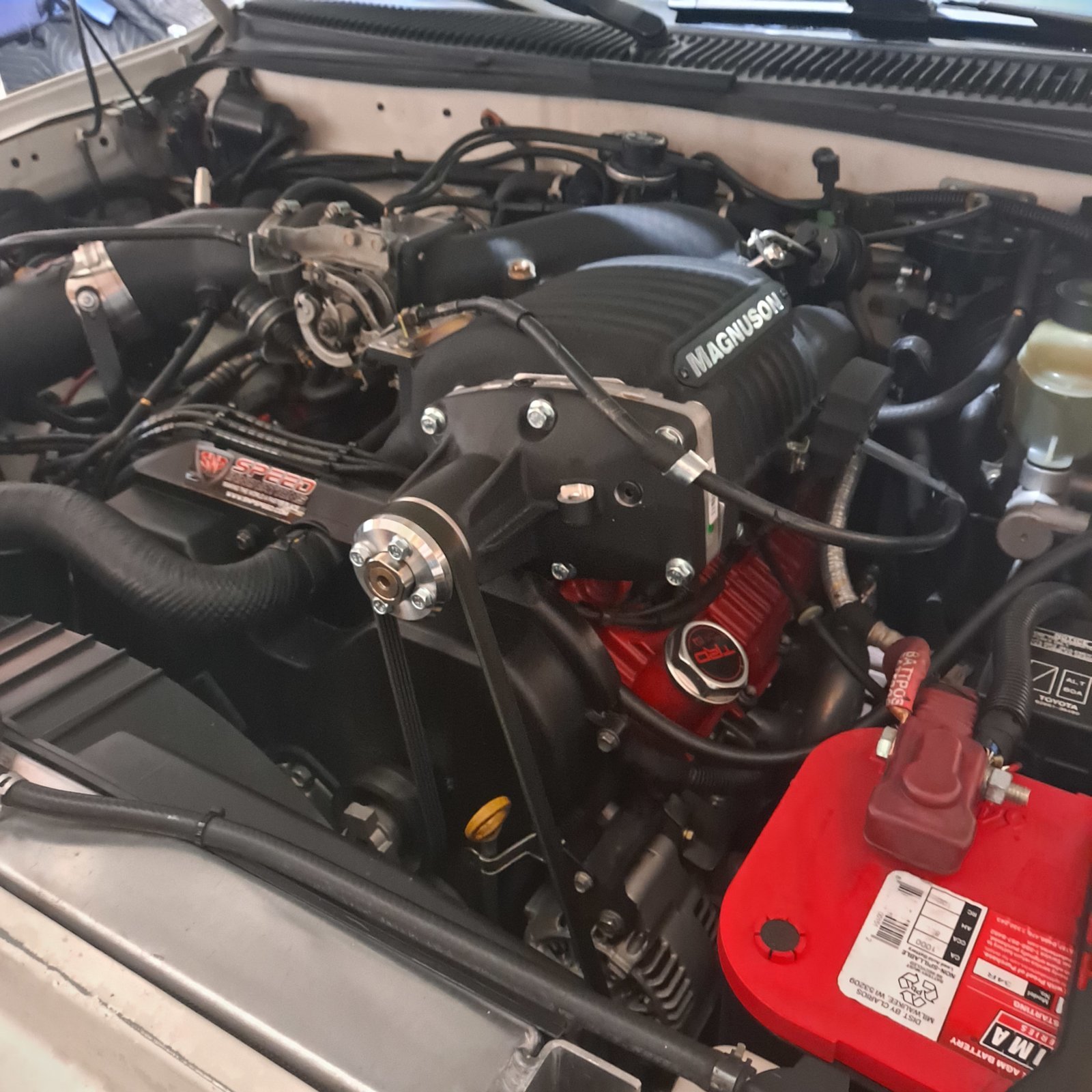

  16. May 10, 2024 at 7:18 AM
    1997tacomav6
    1997tacomav6 V6 5sp,RegCab,TVS1320 Supercharger,Haltech, 800k
    Oct 5, 2013
    #113940
    10,419
    John
    Denver
    97 reg cab, v6 5sp 300hp supercharged, Methonal Injection, 800,001 plus miles, Original Owner
    V6 5sp,RegCab,TVS1320 Supercharger, 56mm pulley, methanol injected Haltech ECU, AC Tvs1320 supercharger,(MUST DO) every 125,000- 150,000 needs rebuild Projector headlights HID 5 speed manual Amsoil for all drive train Smaller 56mm custom pulley, (MUST DO) 2004 DESNO fuel injectors, zero ping ping, 2004 side door mirrors Dick Cepek Rims, Michelin tires LTX, ATM Pathfinders Dynopro ATM ( that last 100,000 miles) Now running Dynopro ATM mud and snow tires KN cold air intake Cat back dual exhaust with ss exhaust tip, Raised exhaust tail pipe to 2" below body line Optima*dry cell battery,red top Alpine sirius radio, 200 watt amp, focal is165 split door pod speakers Focal door speakers Subwoffer behind seat Viper alarm, Electric Locks Dark tinted windows, bucket seats corbeau lg1 Tacoma Rubber floor mats TRD fender extenders, Bilstien shocks, King shocks JBA UCA trailer iv hitch, electric brake control, Drilled slotted brakes, High carbon steel (MUST DO) EBS green stuff 7000 series pads(MUST DO) TRD engine oil cap TRD stick shift, Marlin crawl shift kit. Rear sliding window 2002 4Runner functional hood scoop cut into Tacoma hood, 4Runner dual overhead map light Gentex Auto dim + Compass + Temp, garage,rearview mirror Snow Methonal kit stage 2 Custom 3 core aluminum radiator Linex bed liner Haltech stand alone ECU, Intake supercharger gauge. Stainless steel brake lines, Custom leather wrapped steering wheel, Haltech stand-alone ECU,

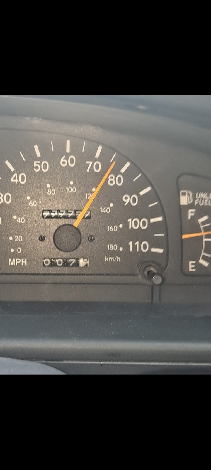

    777,777 at 77mph with the new Tvs1320 supercharger and haltech ecu going strong:)

    that should be put into a museum eventually :hattip:
