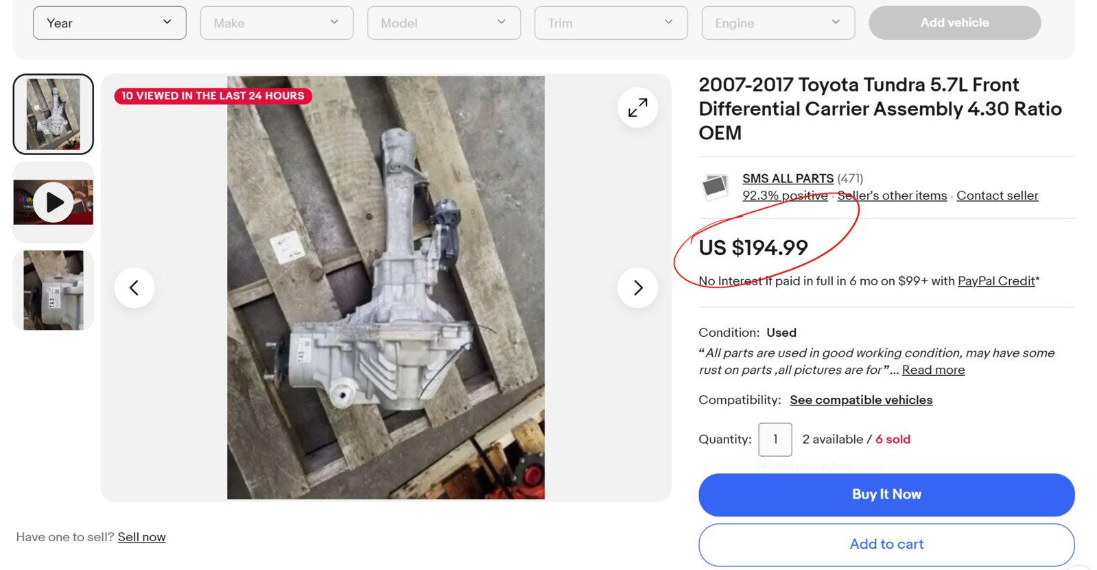

  4. May 21, 2024 at 9:59 AM
    El Taco Diablo
    El Taco Diablo Professional Pinstriper
    Nov 6, 2017
    #235223
    13,981
    Matt - KN6DZP
    Hughson, CA
    Impulse Red DC, 5vz-fe, 4wd swap, LT, dual case, F/R locked
    Just 3 tons of fun!!!
    Hell, these things are cheaper than I thought now. (+99 shipping on this one)
    I'll have to call ToyAuto Mart here local and see if they have one / how much.
    Nothing like buying a $300 core just so you can ship it to ECGS and pay $2500 for locker and re-gear :rofl:
    But, at that kind of price it could be worth grabbing one to see if it can be made to fit.
