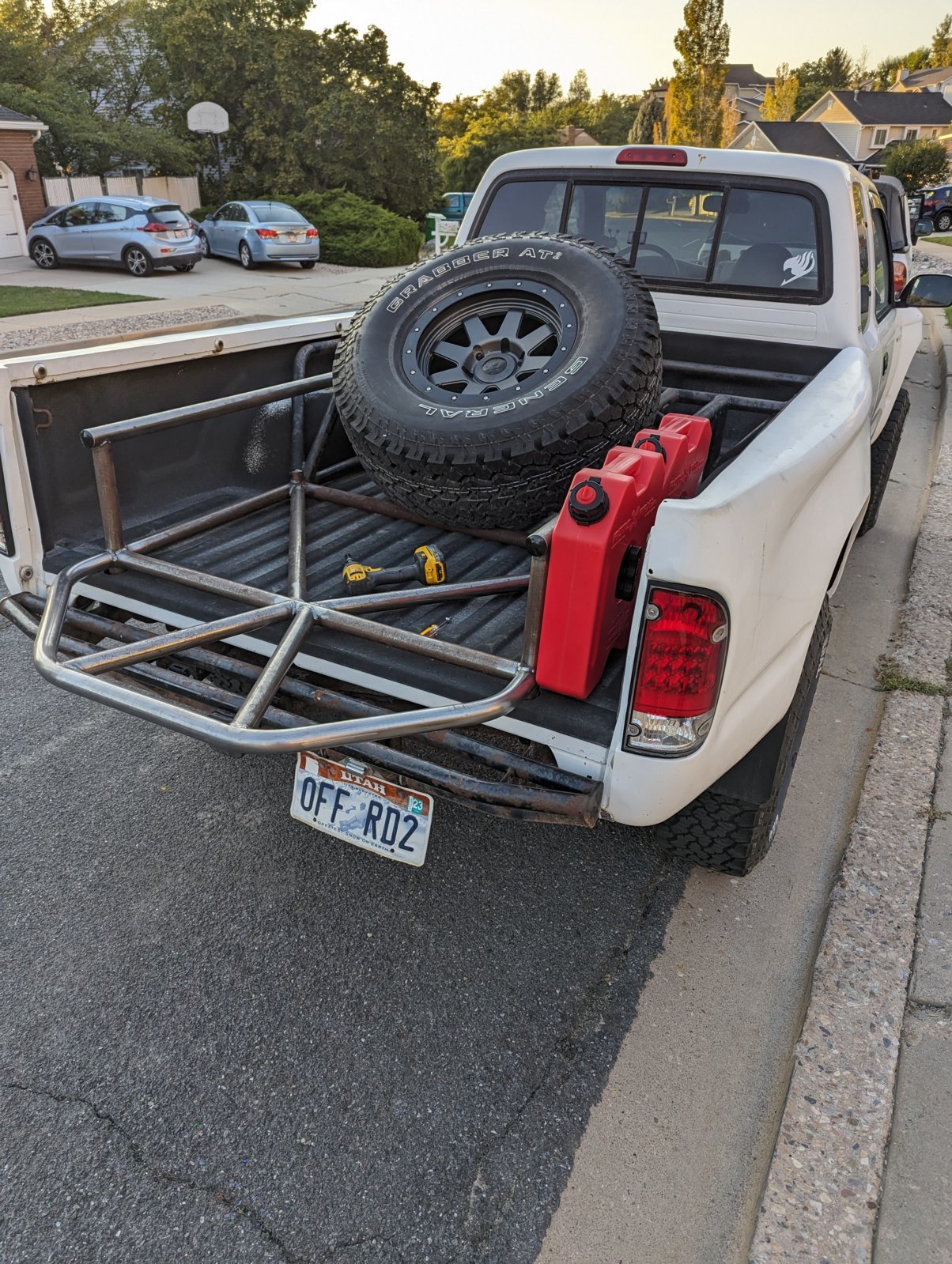

    Got the bed mounts cut off and the passenger shock mount cut off this evening, day by day its starting to look more like a race truck. Putting UCA's and LCA's and some fox 2.5s on my father's second gen this weekend, then I should be able to push the clean up and I can start patching up the holes left over from the rust.

    Those are some beefy leaf springs and a modified frame, what happened to the truck before?

    Sadly rust in frame around the front spring mounts. The truck has a bed cage for bypass shocks so I've decided to remove the bed to save the weight. I'm boxing in the rear part of the frame, replacing the cross members with some 2" round tube and moving the gas tank up behind the rear axle to move that weight to the center of the truck and being further back.

    Heres a photo of the bed cage in it's current state.

    The springs are Deaver J59. They have a lot of individual leafs but they're actually a performance-oriented spring designed to be flexy, not meant for heavy loads.

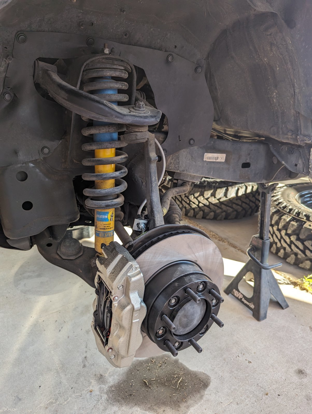

    Tundra brake upgrade done. The old brakes were....done. Maybe a sixteenth left of pad. These brakes always were terrible anyway, here's hoping for better.PXL_20240525_203131067.jpg
    I'm really tired after being outside in Tucson from 9 to 3, so I'll bleed them tomorrow.
    Also, the passenger OEM hard line on the frame rounded off, even with a flare wrench. Took that little short hard line out and put it in a vise, clamped
    on the flare nut with vice grips and popped that sucker loose. Other than that, the whole thing went pretty well.

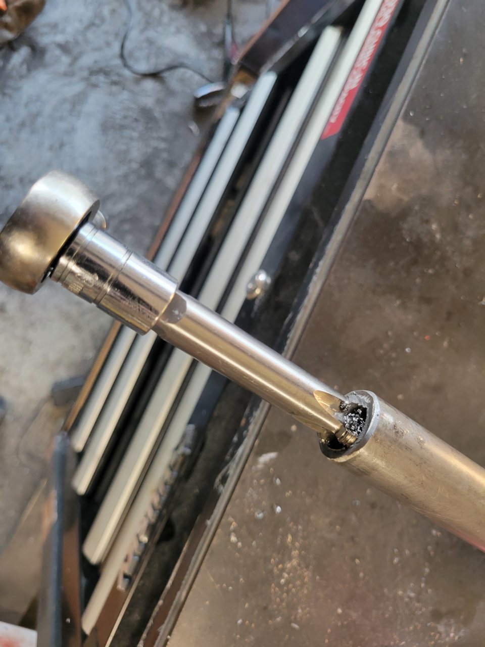

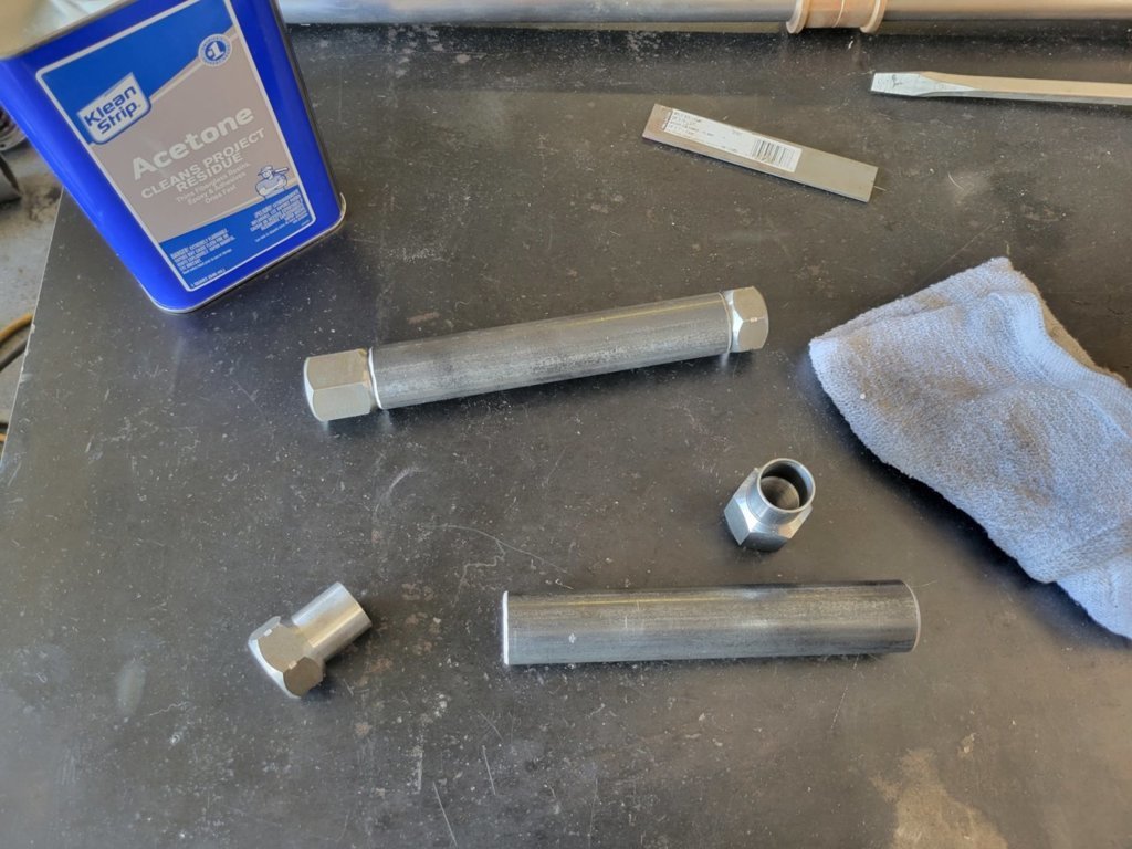

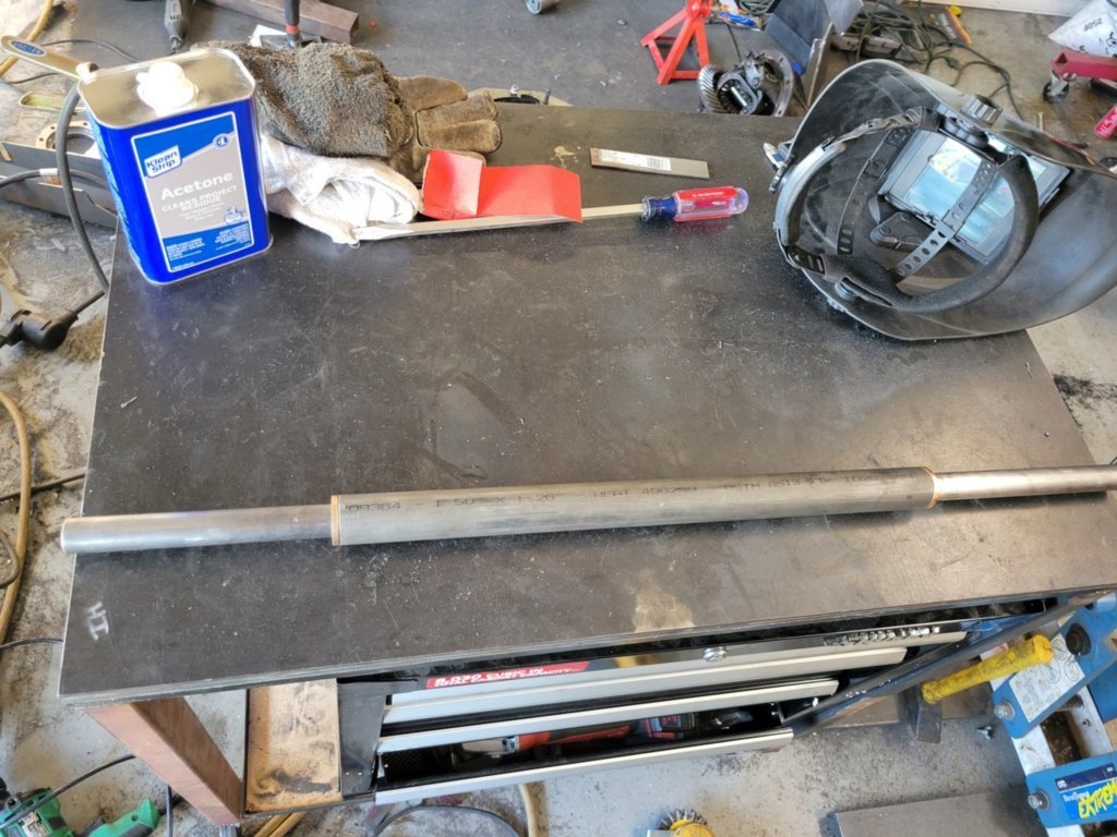

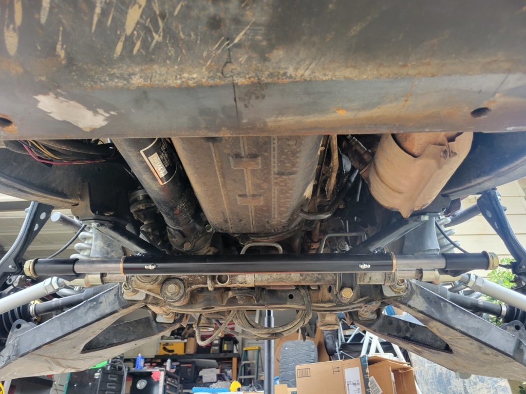

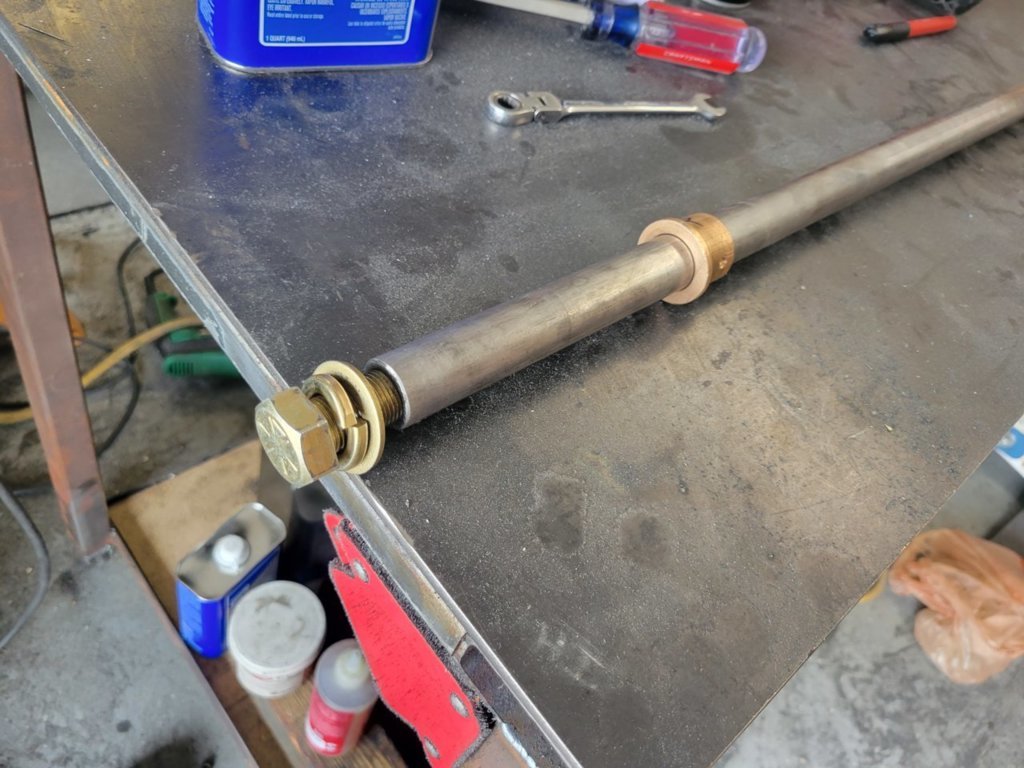

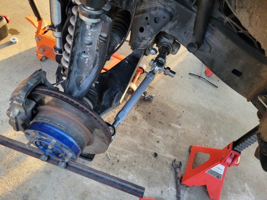

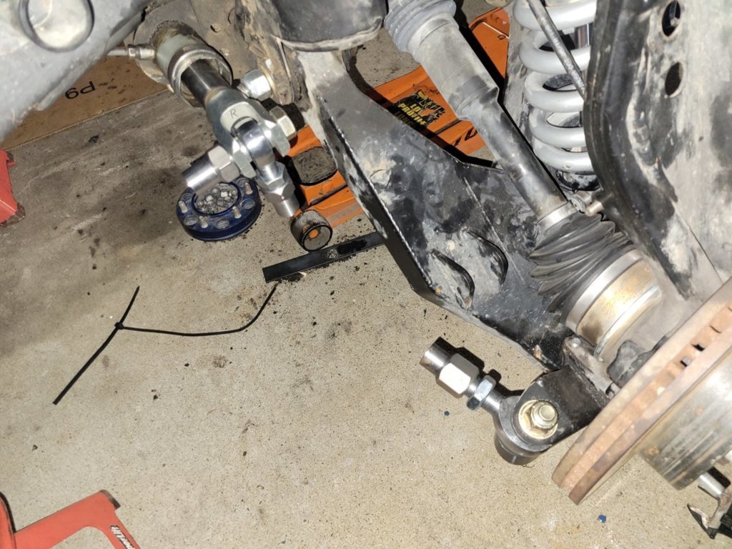

    I made my own with Trail Gear clevis for the inner.
    20230514_212827.jpg 20230522_205014.jpg 20230522_190713.jpg 20230526_180627.jpg 20230526_193624.jpg
    Then I added a rack slider.
    20230526_191004.jpg 20230526_191007.jpg 20230527_123237.jpg 20230527_193145.jpg 20230528_154632.jpg 20230528_154440.jpg 20230528_162210.jpg 20230528_162244.jpg

    Great job! I think I will copy your inner tie rod conversion. Did you lose the ability to use the boot?
    The rack slider is impressive too! Does the steering feel different?
  17. May 26, 2024 at 12:24 PM
    El Taco Diablo
    El Taco Diablo Professional Pinstriper
    Nov 6, 2017
    #235223
    13,979
    Matt - KN6DZP
    Hughson, CA
    Impulse Red DC, 5vz-fe, 4wd swap, LT, dual case, F/R locked
    Just 3 tons of fun!!!
    I ended up being able to cut the boot shorter and clamping it to the clevis.
    Steering is fine.

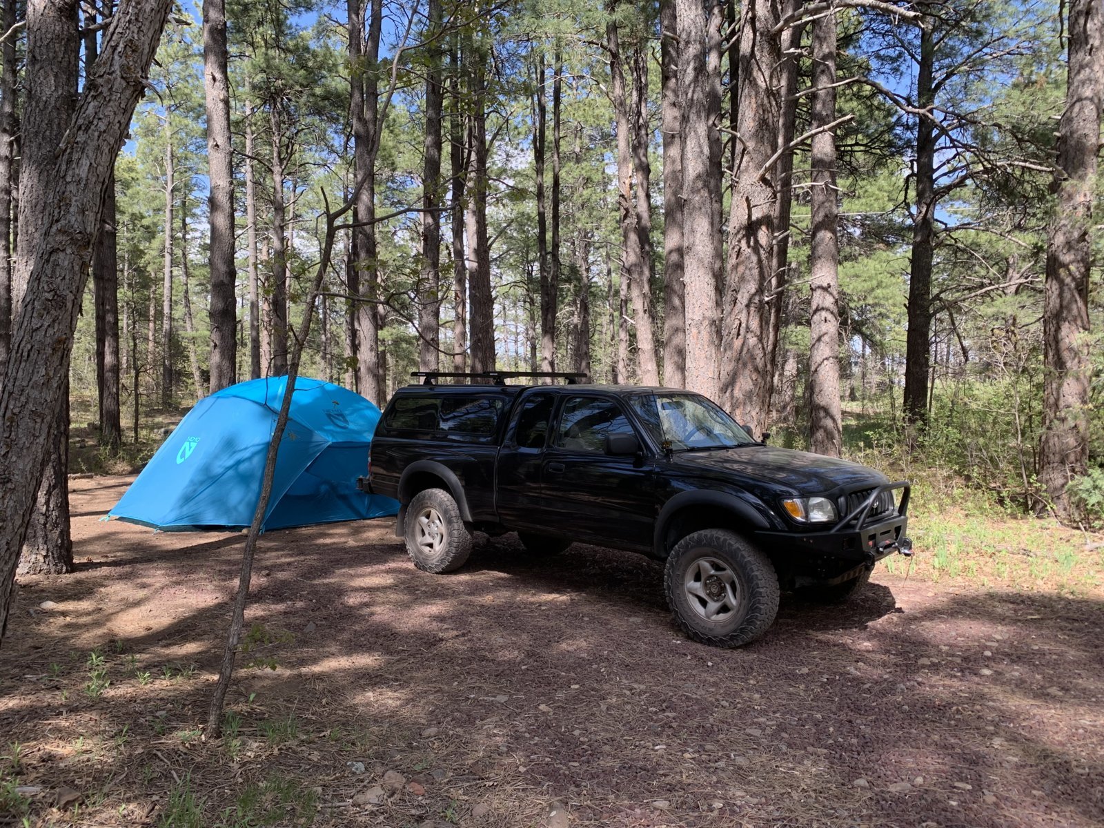

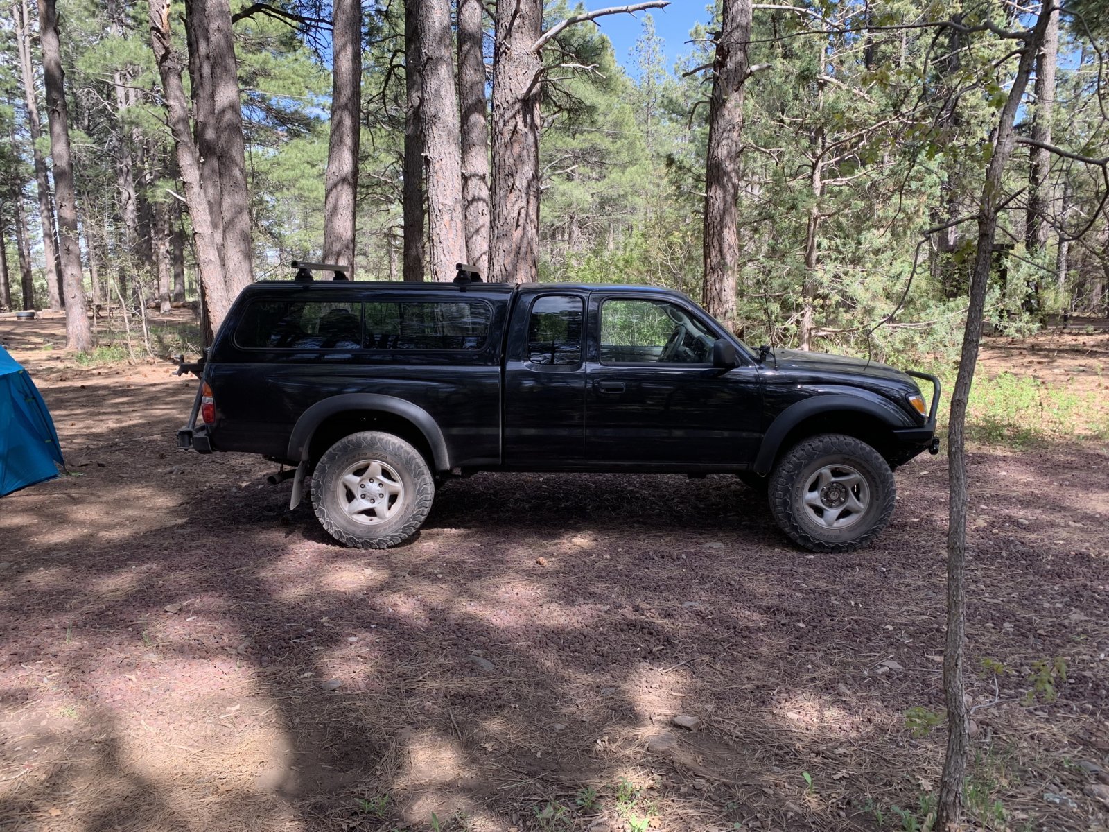

    Hit the 200K mile club on the trip up to Mormon Lake this weekend.

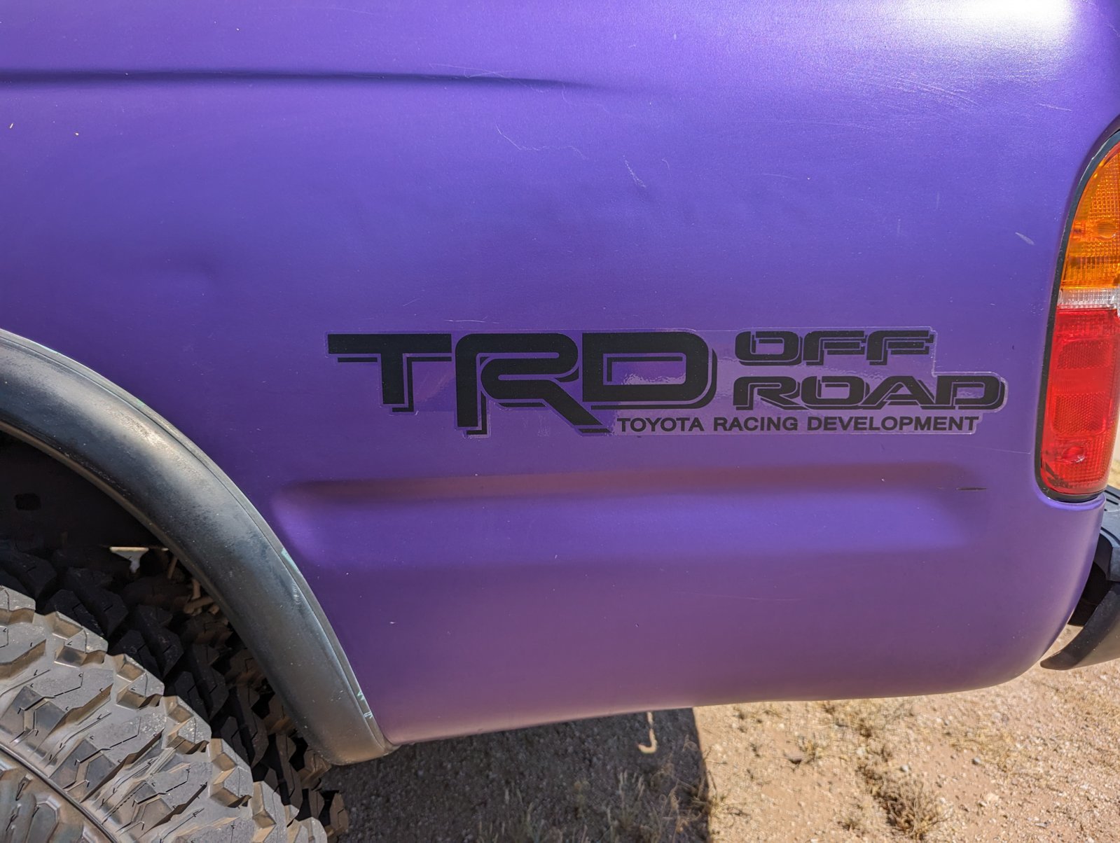

    So first impressions after doing the Tundra brake upgrade, and admittedly the poor previous brake pads/rotors..... one of the better things I've done to this truck. It will literally lock up all four wheels now, really nice pedal feel. I deleted the load sensing valve a long time ago and I don't have a proportioning valve, and it stops very quickly with total control. PXL_20240527_220056289.MP.jpg
    I also replaced the windshield washer squirters that were clogged up, and put the TRD stickers back on. There are no other emblems on this truck...just not a fan of them.

    The TRD stickers are a little low in the besdide, but yes, the Tundra brakes are a top 3 mod for me.
