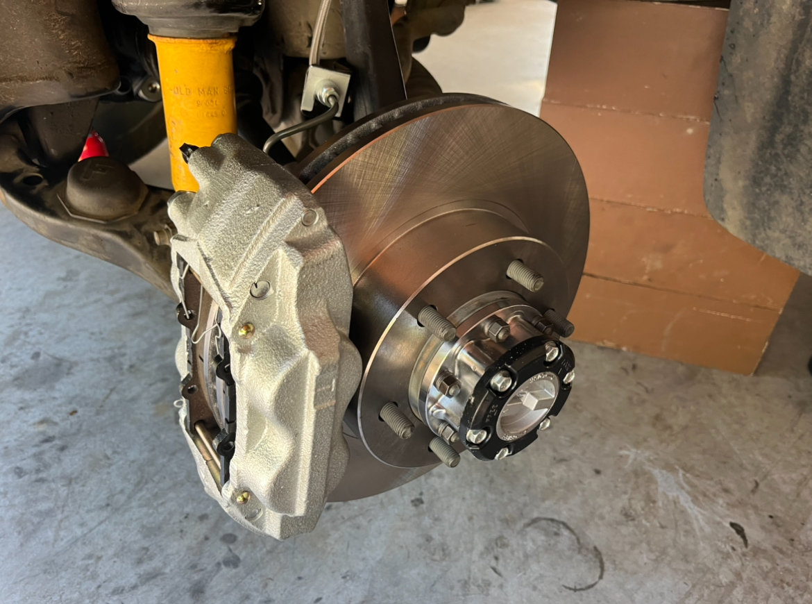

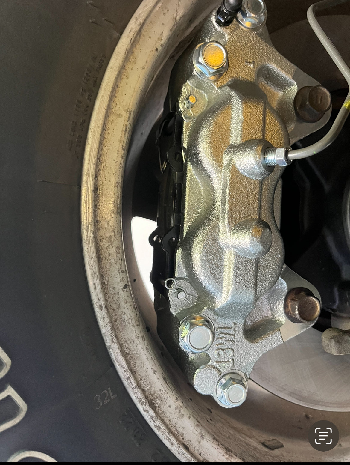

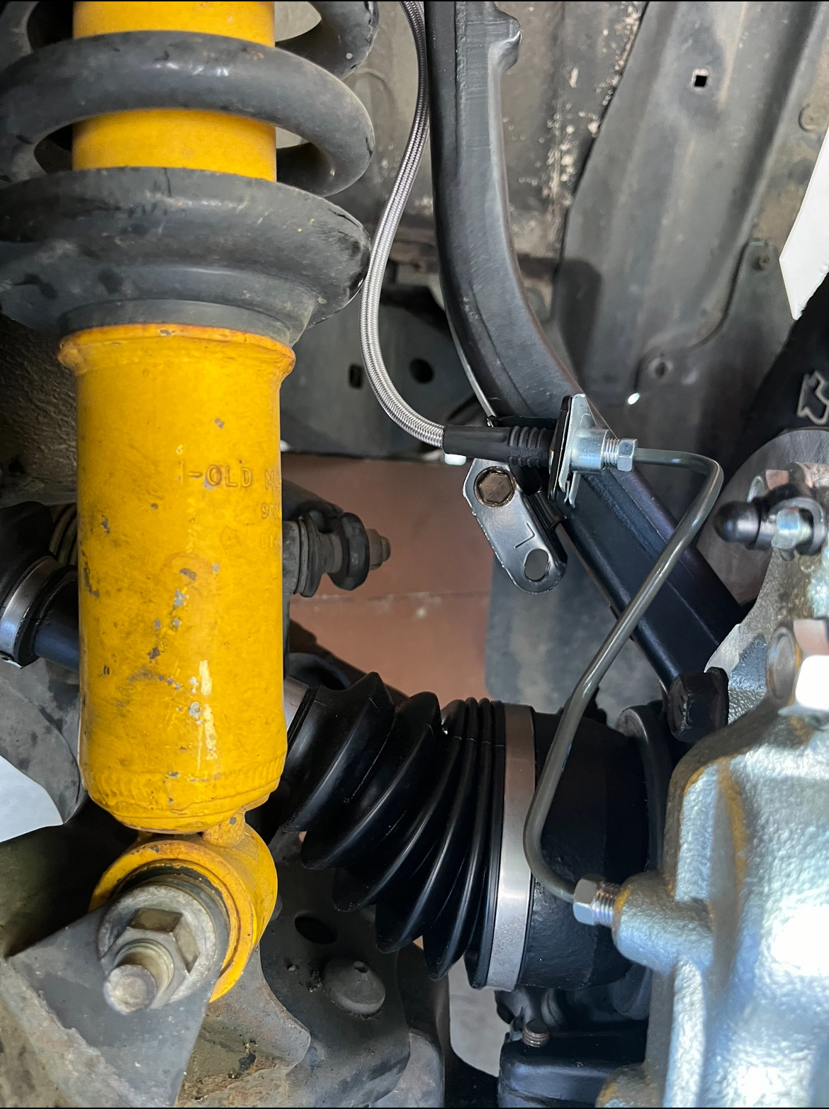

    Finally got the manual hub conversion done, and swapped on the Tundra brakes at the same time.
    Will have to go back in later for the upper (Icon) and lower (stock w bracing) control arms and king shocks, still waiting on a couple bits
    but two less things in the to do pile:bananadance:

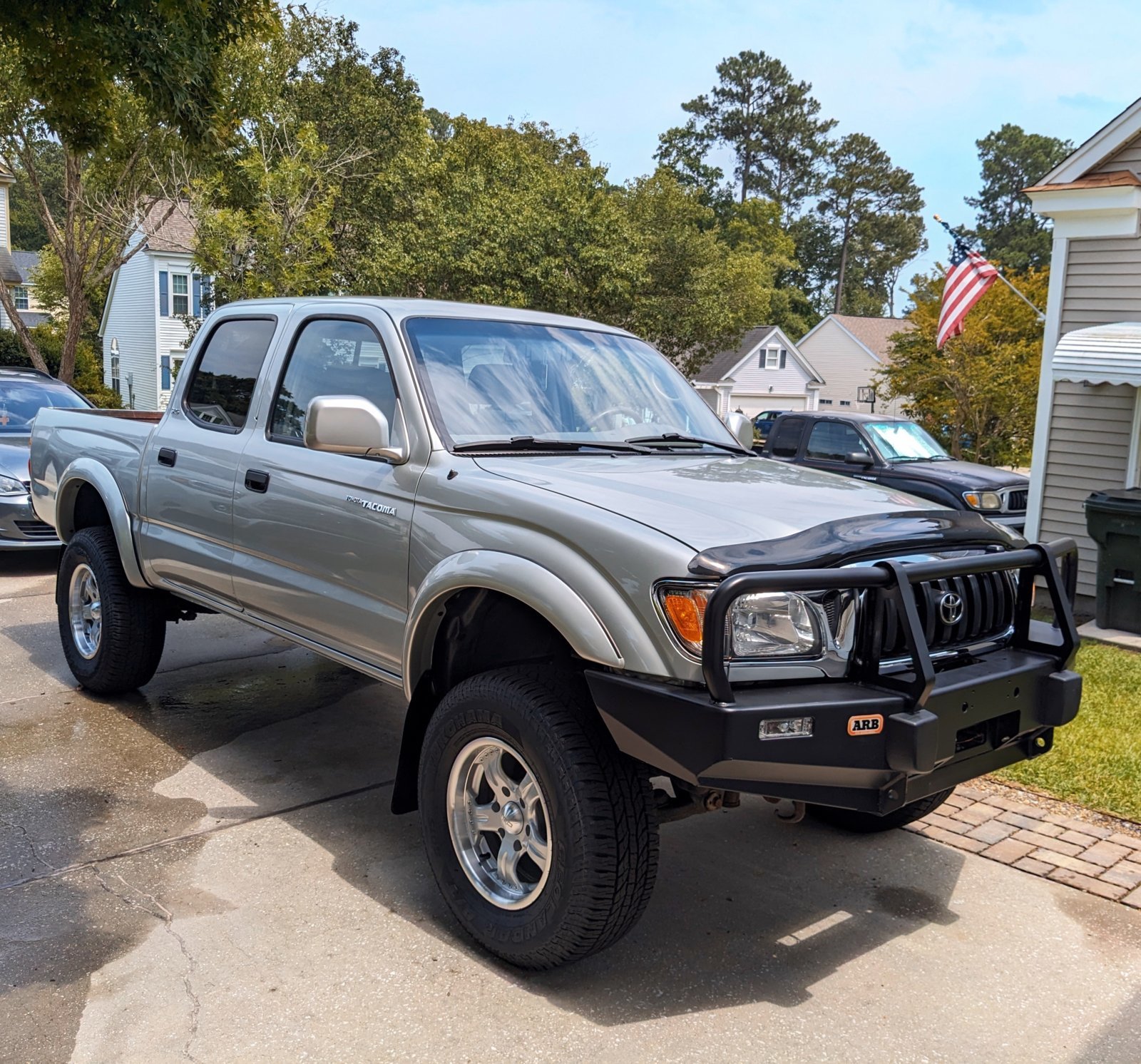

    Not done in a day, but over the course of 2 months:
    • Full body repainted
    • Color matched fender flares with new weatherstrips,
    • 4Runner mirror swap, painted + heated mirrors wired up with a Muth H-Mod and 1st gen Rav4 defrost button (they need t3 neo wedge LED bulbs if anyone does this later on - stock incandescents are too dim)
    • New chrome emblems,
    • New TRD 16" Ivan Stewart wheels + tires
    • Hella fog lights installed with the Camry fog light switch
    • XM antenna run outside to the bumper
    • 2nd gen 4Runner door actuated map light (which caused me to short out my body ECU and blow up a resistor :) )
    • Seat jackers so my spine is no longer being shattered.
    • Metal door handles
    • Fuel sending unit, pump, filter, soft hoses, overfill valve, tank gaskets, painted tank skid plate - dreading the day 20 years from now when I have to pull the tank back down :(
    • Locking glove box latch from 4Runner
    • Swapped ARB turn signals for ones from a VW Golf Mk 2 with running lights
    • New headlights and side markers
    • New third brake light + gasket, license plate light housings, tail light housings (not pictured)
    • Antenna painted (missing from picture as it was drying)

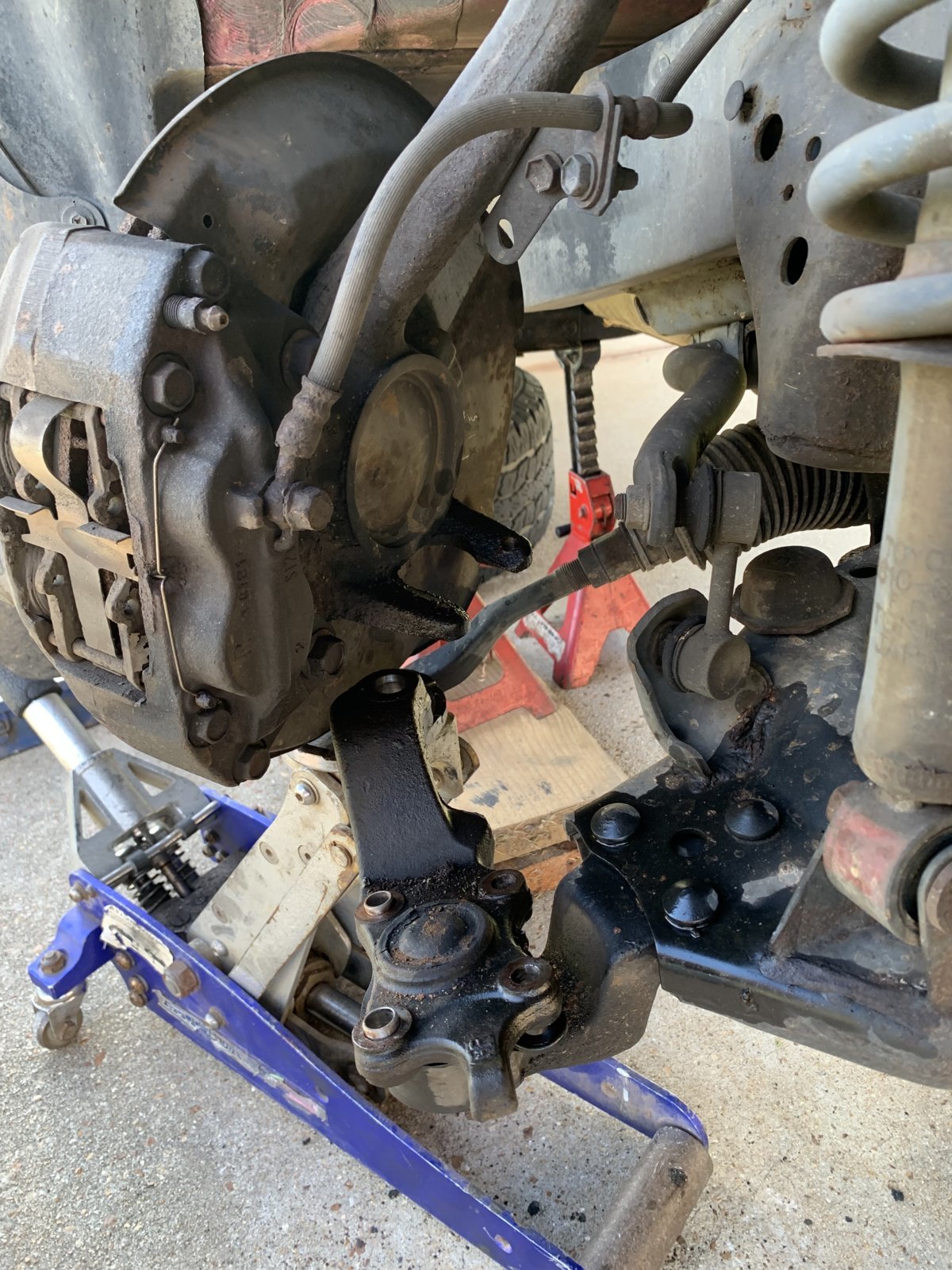

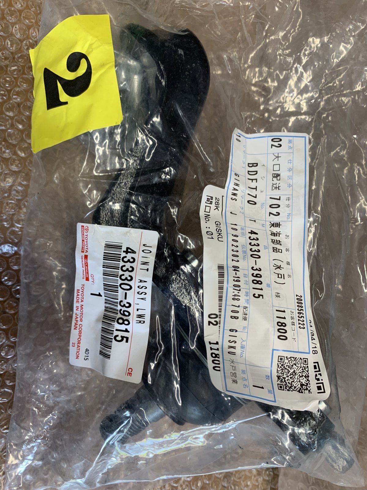

    A21044B5-0656-43BD-B51A-D2EBFC249AAC.jpg LBJ’s for the first time since I bought the truck. No idea when they had ever been replaced and I’m taking a big trip this coming weekend and didn’t want to end up with a cambered wheel on the side of the road. Kinda cool so see the OE parts in the package with the Japanese script.D03AD6EA-1AE3-4349-B73F-2EAEFCAA75DD.jpg

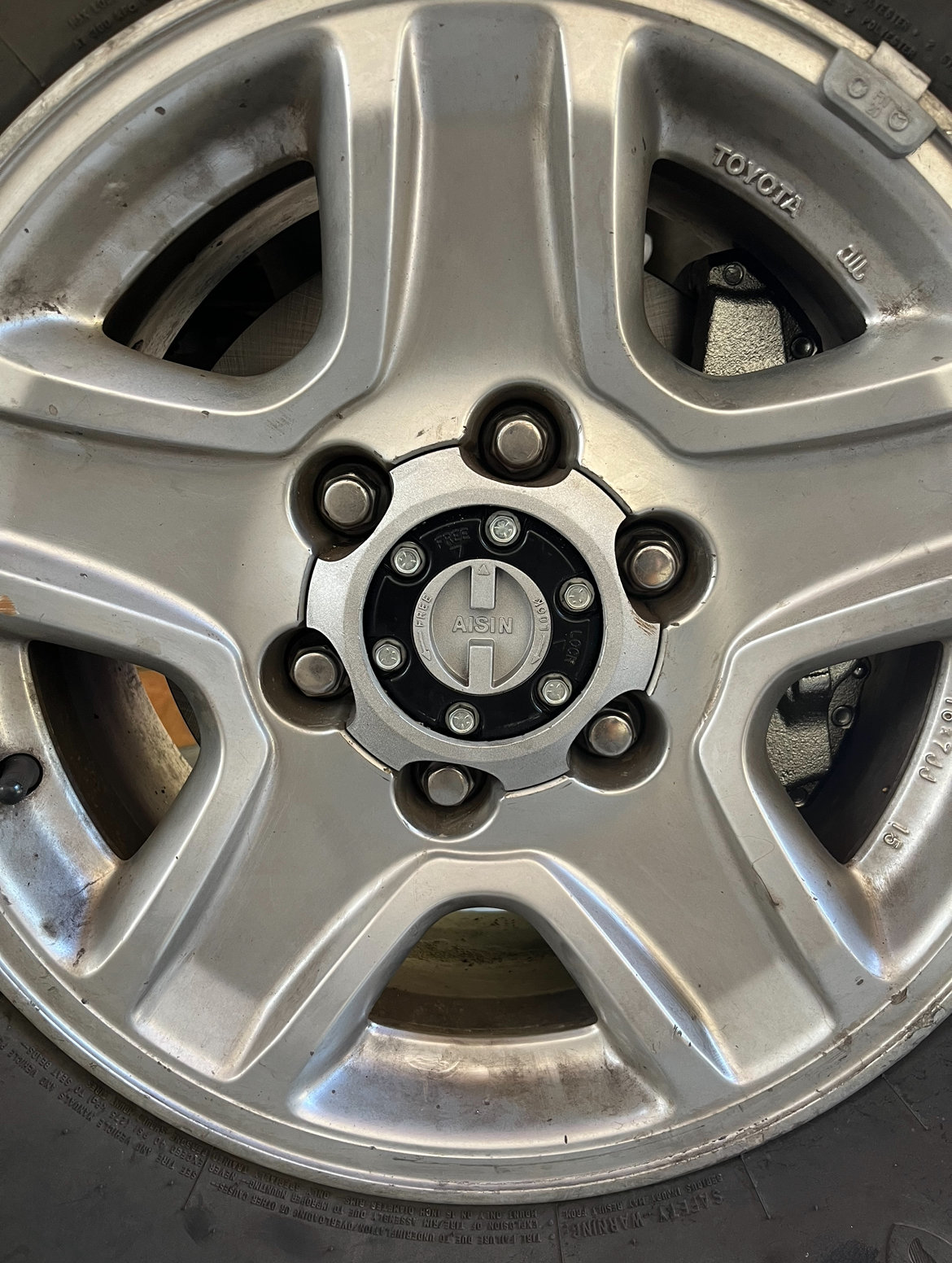

    Oi! Are those the 4-runner 16x 7 wheels you have the tundra brakes and manual hubs on?

    Yes sir! Fit like a glove, including the center cap once you remove the center:amen:

    That looks plenty clean enough, but for any perfectionists in the crowd, the locking-hub center caps from Tacoma wheels fit right into those 4Runner wheels. You might still be able to source some new ones from Toyota.

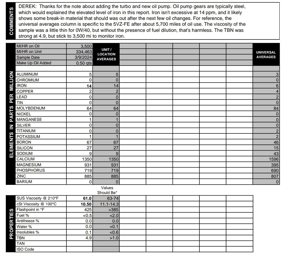

    I'll throw my Blackstone report in for some comparison.
    I'm about 1,700 miles away from the next sample

    It was easier to compare before it went to a second page haha

    Strikingly similar though (at least to me, the untrained eye). Interesting to see how the evaluations were different.

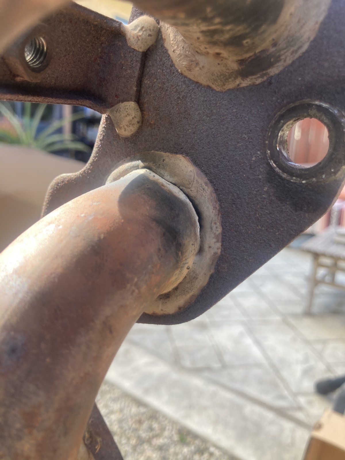

    Finally found the fucking reason for a P0420 code

    What’s the value of the manual locking hubs? Are you able to use the push button 4WD with them?
  18. May 29, 2024 at 9:20 PM
    m3bassman
    m3bassman Well-Known Member
    Jan 16, 2011
    #49376
    17,138
    Green truck
    Yes and no. If the hubs are locked it'll go into 4x4. If the hubs aren't locked you only get 2wd, but you can do 2wd lo at least.

    Also on a manual hub truck, with the hubs unlocked (as they should be pretty much all summer during normal on-road driving), the CV axles aren't spinning.
    On an ADD truck the CVs spin anytime the wheels spin period. So in theory you should significantly extend CV boot life with manual hubs
