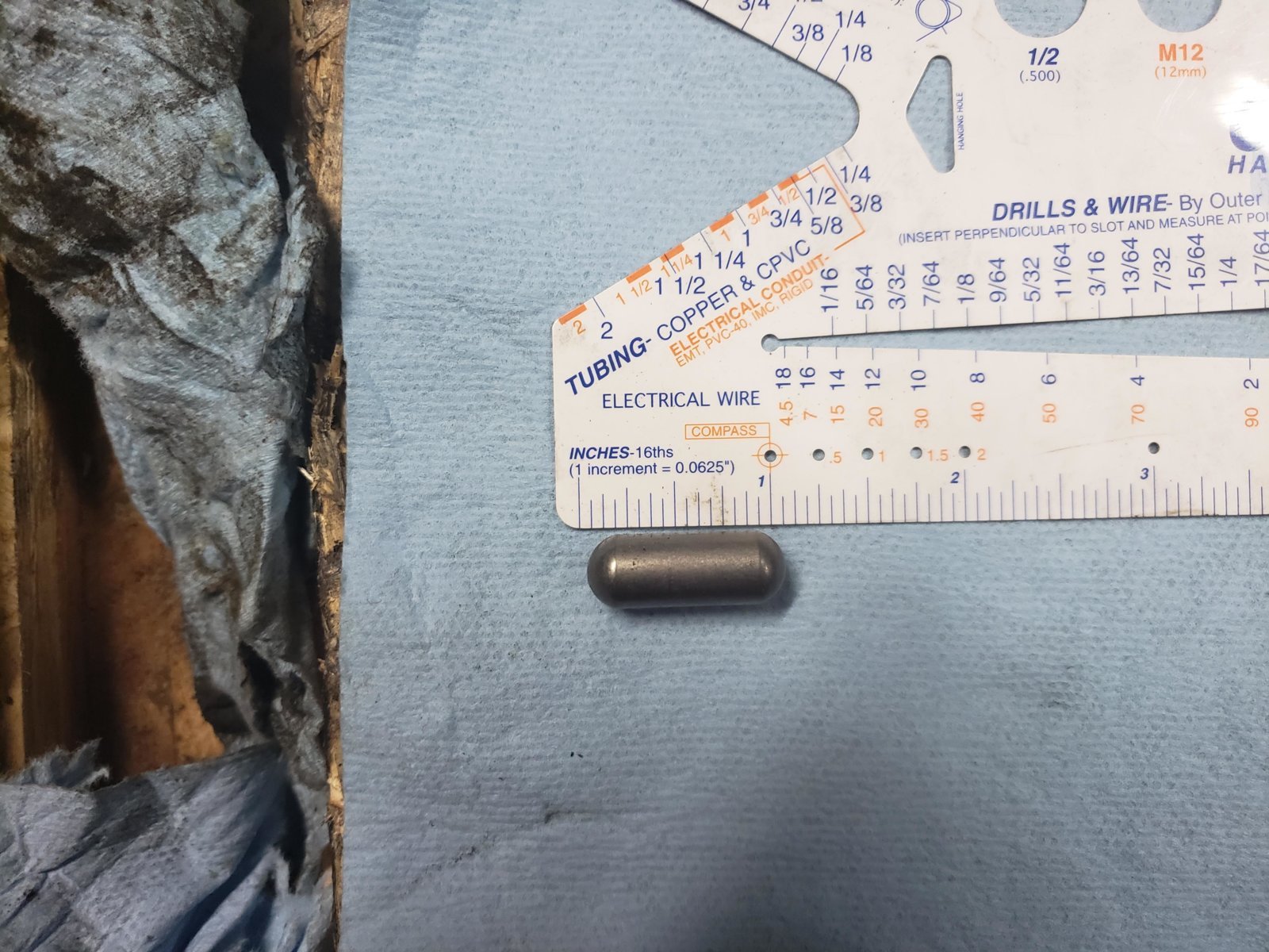

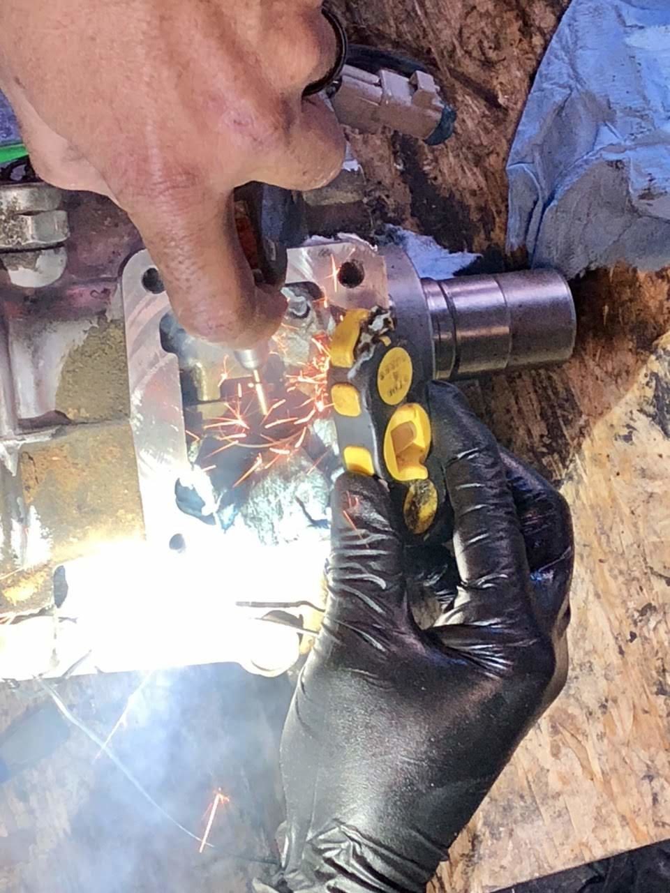

    Or there's more to it than just dropping the case. You have to open the case and take the giant "pill" out. (Detent).
    Then you get to take a cutting wheel to the shifter rail.
    Fun times :thumbsup:
    But, it's really not that hard. And totally worth it in my opinion.
