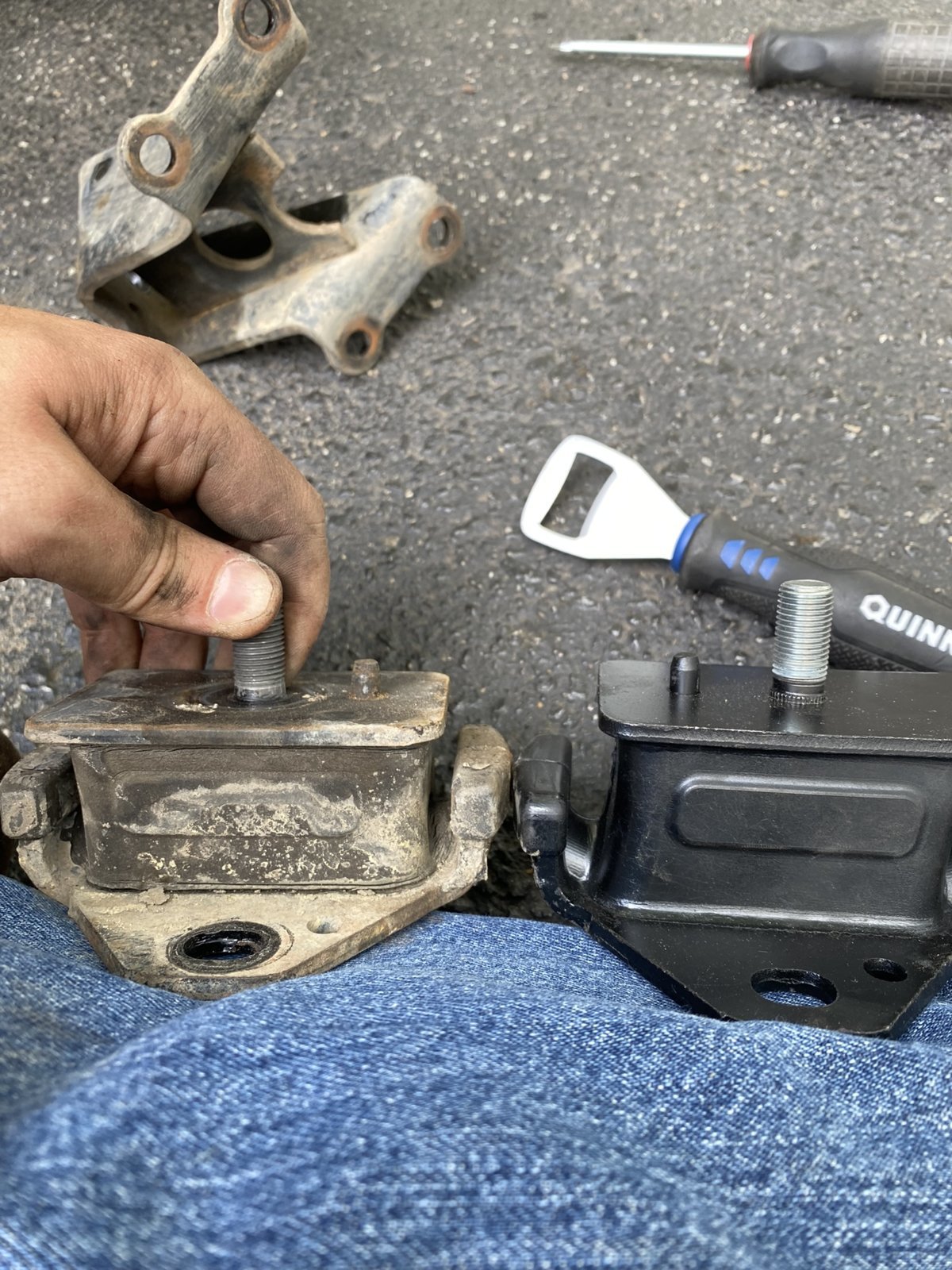

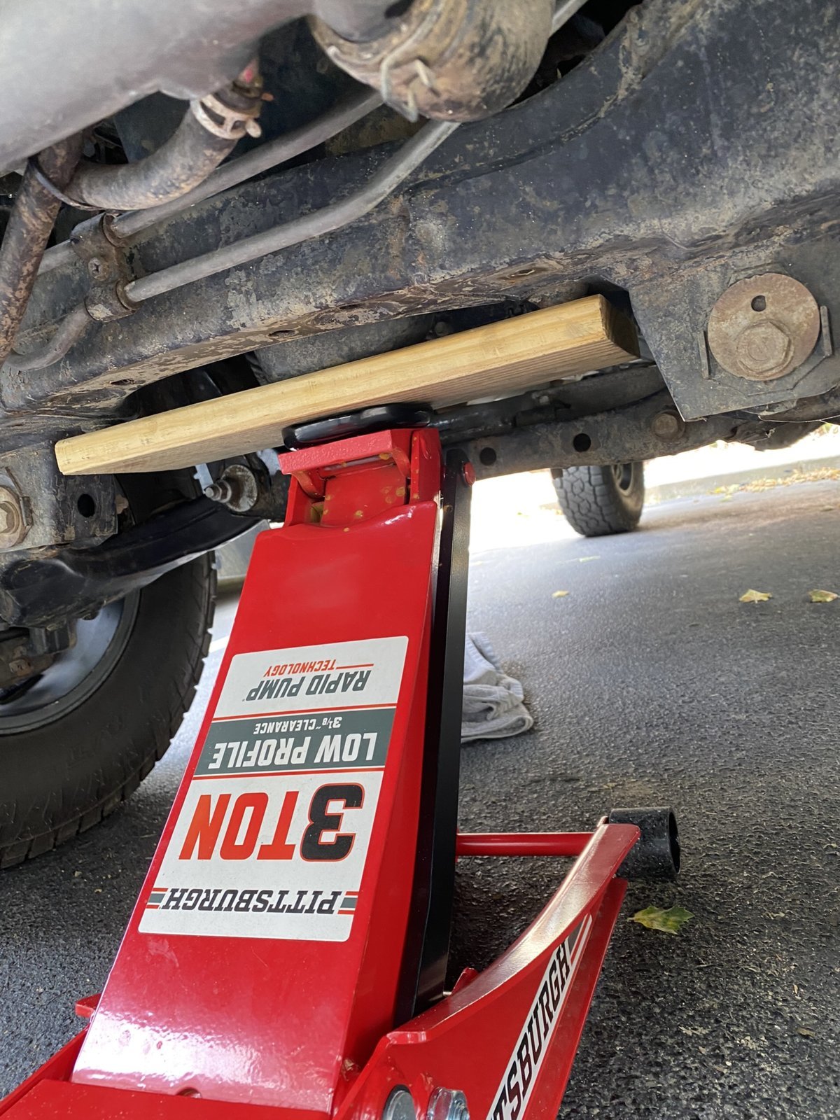

    25 year old rubber, finally got the motor mounts replaced. Did the transmission mount a while back. Made a noticeable difference but I think the engine actually moves more when you shift gears now, though its smooth and no more "clunk" when it happens or off the line from a stop.
    Jacked up on the oil pan, no issues. Found it far easier to just take the mount off from the block bracket. It raised my engine probably an entire inch if not more after replacing.

    I am guessing that Quinn tool came in handy for most of the job.
    noodles93[QUOTED] likes this.

    My most used tool in the box

    What's that Quinn tool for?

    Gotcha :cheers:
    I was racking my mind to figure what use that could possibly have during a motor mount job lol. How could I have overlooked something so essential?

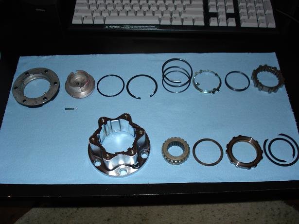

    There is no needle bearing inside the manual hub.
    This is the exploded hub
    The "cog" next to the hub body and/or the one in the upper right is what I think you are referring to, that blew up when you sheared a CV.

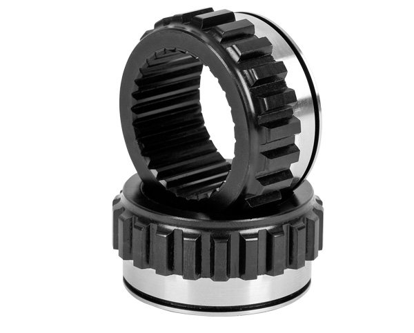

    The part next to the hub looks similar to this one.
    These are LongField Chromoly (solid axle truck, still not sure they make these for Tacoma, just an example of the inner hub gear). The machined surface just passes through a bronze sleeve in the hub body it's self. That bronze sleeve has dimples to retain grease. The machined surface turning inside that bronze sleeve is the only "bearing" you have, inside the hub body, when freewheeling.
    The groove at the bottom of the machined surface on the above "cog" (for lack of a better word). is retained by the C clamp shown below.
