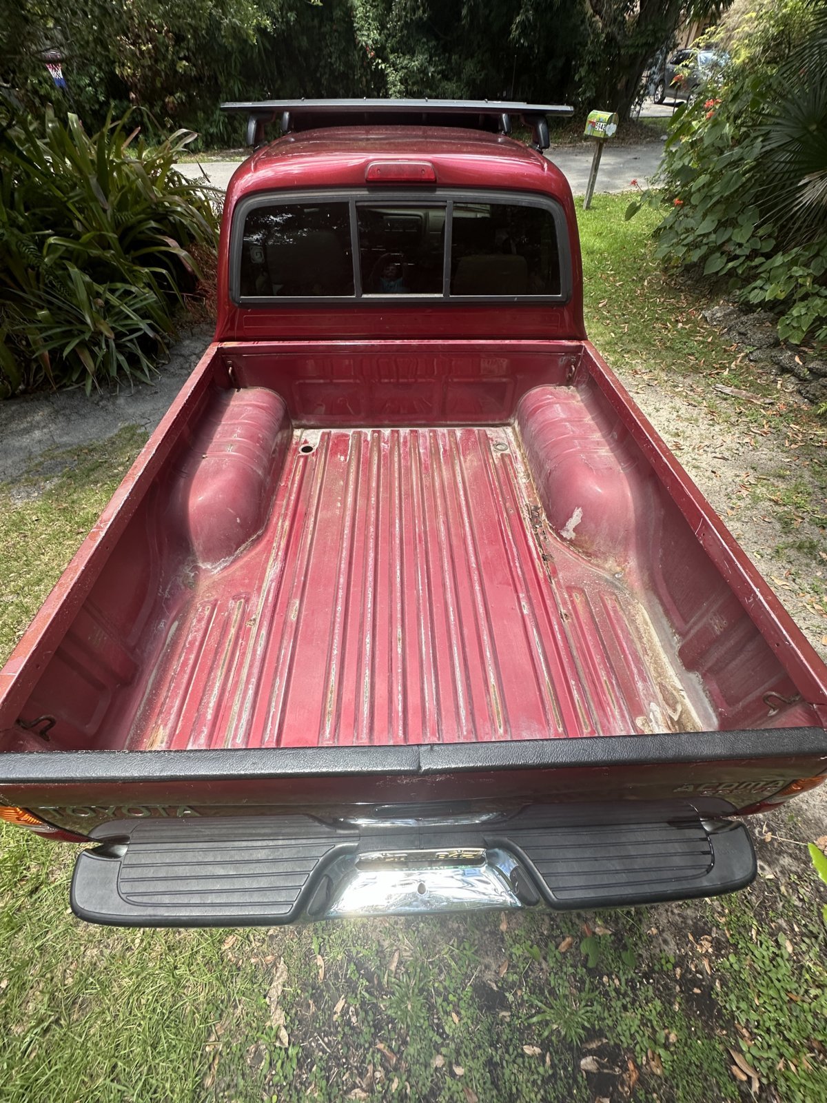

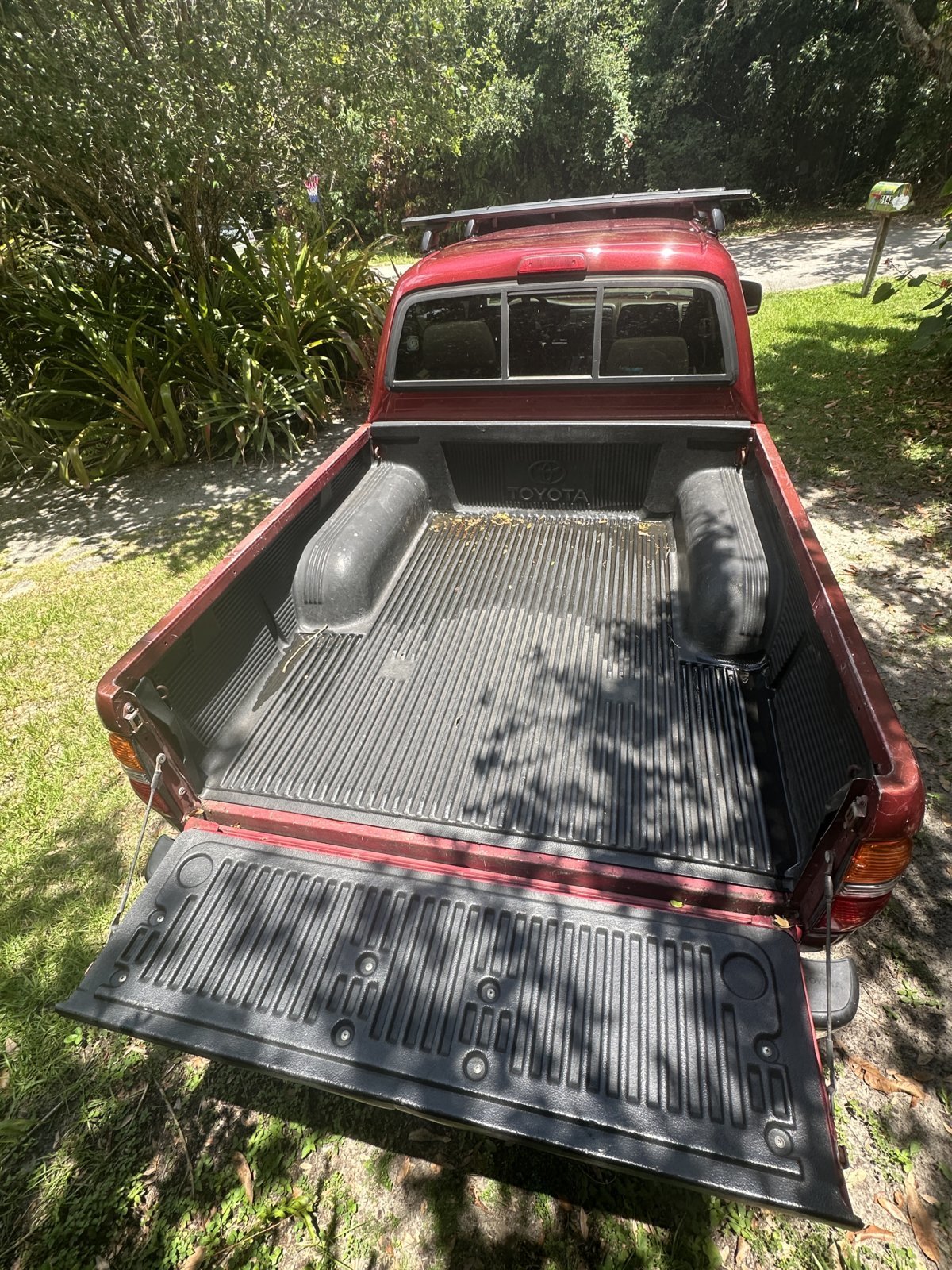

    Doing bedliner or going to leave it?

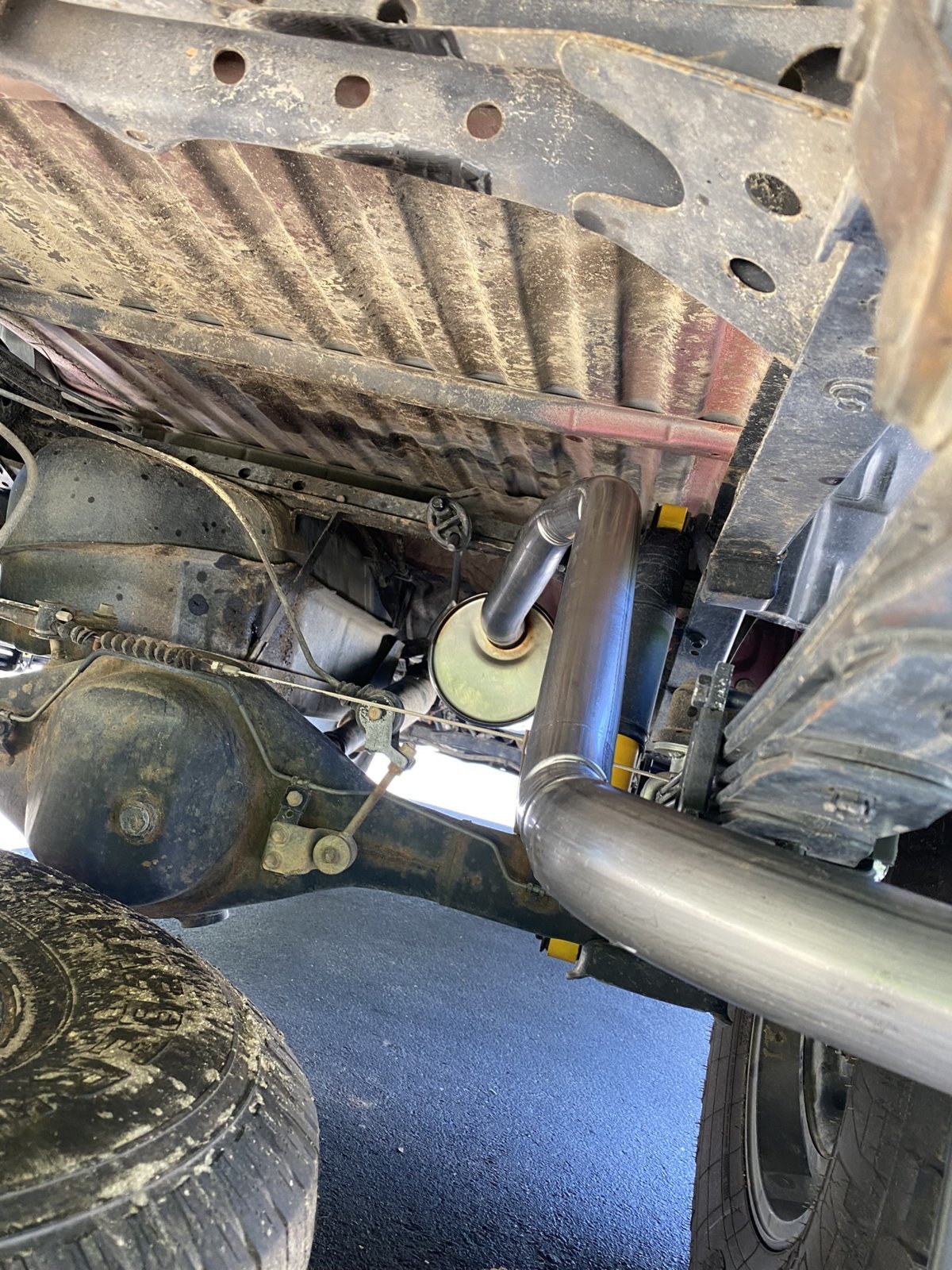

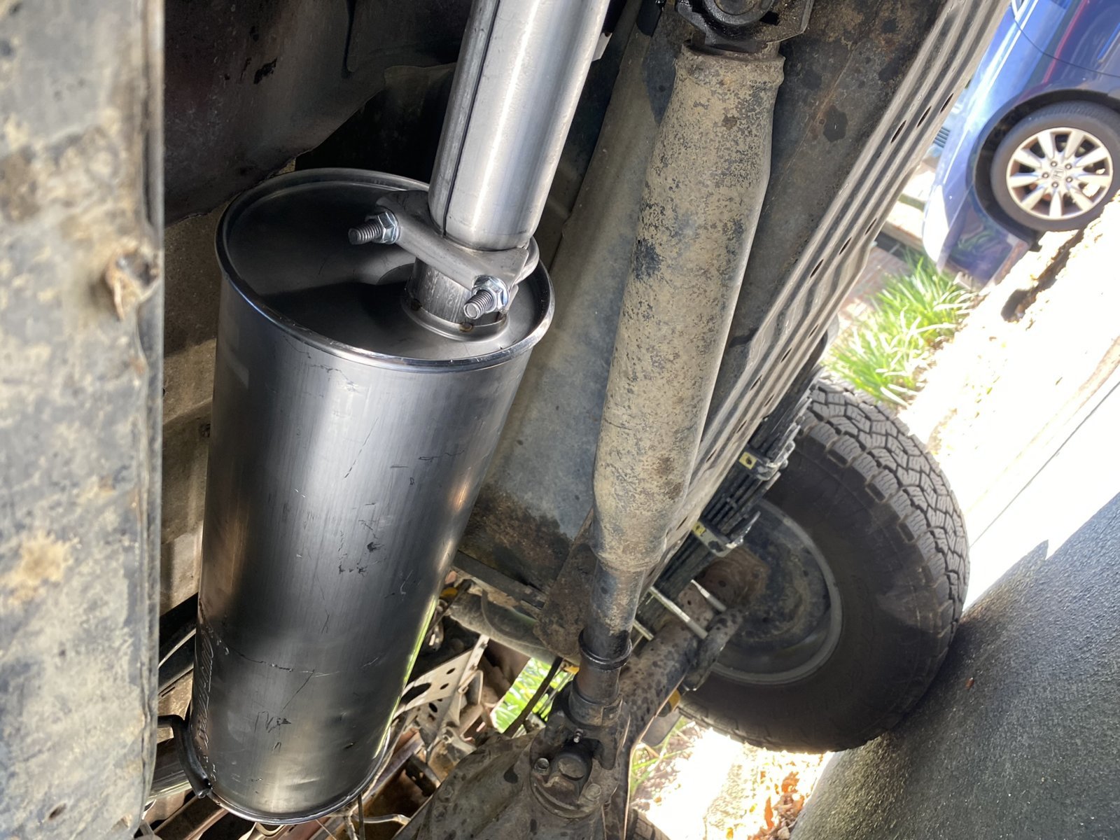

    Replaced my exhaust. Old one had tons of pieces of my old cat in the muffler I couldn't shake out. Have a pretty rough exhaust leak at the join/clamp though. Makes it run really loud, going to try a different type of clamp tomorrow.

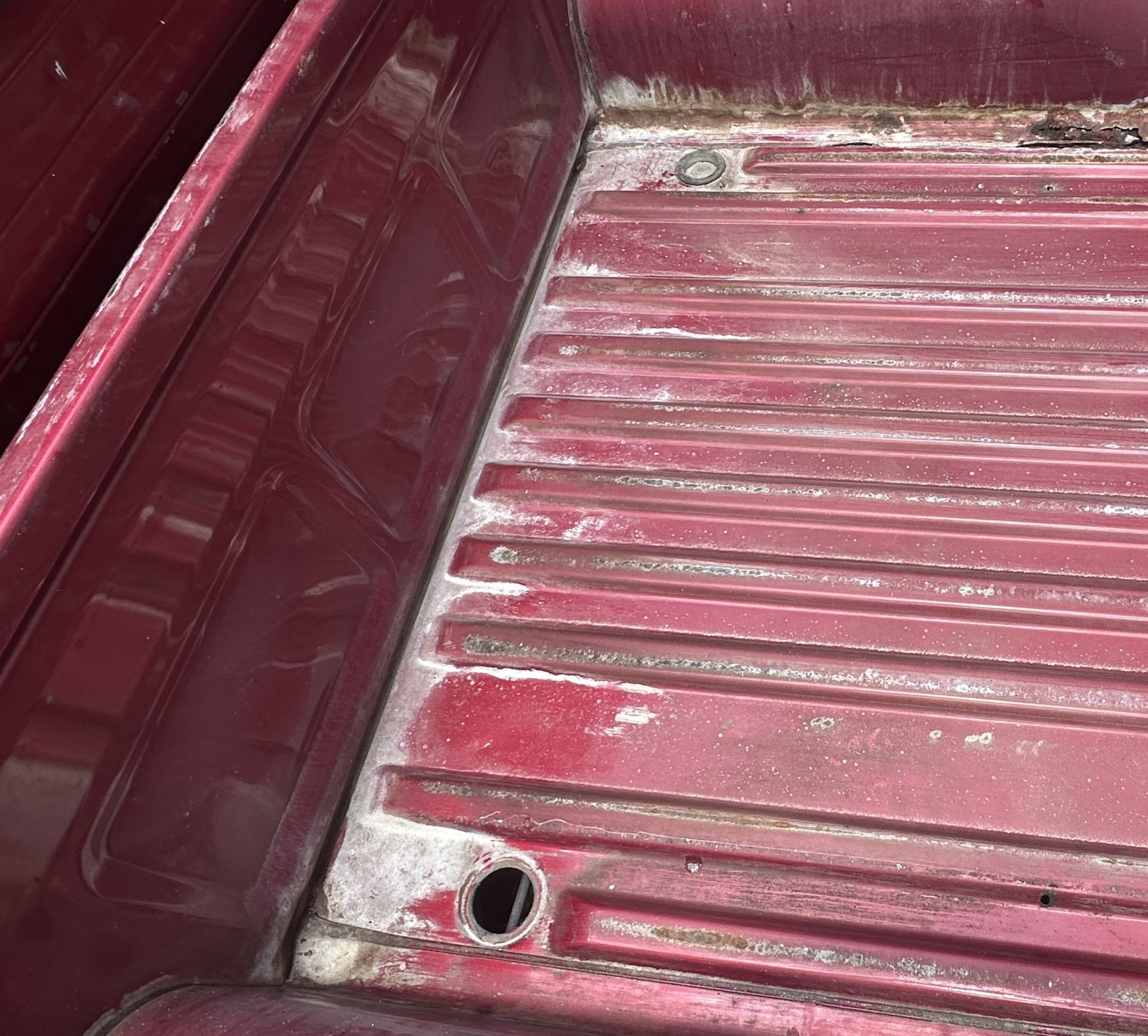

    Gonna do bedliner, but have to deal with all that rust first.

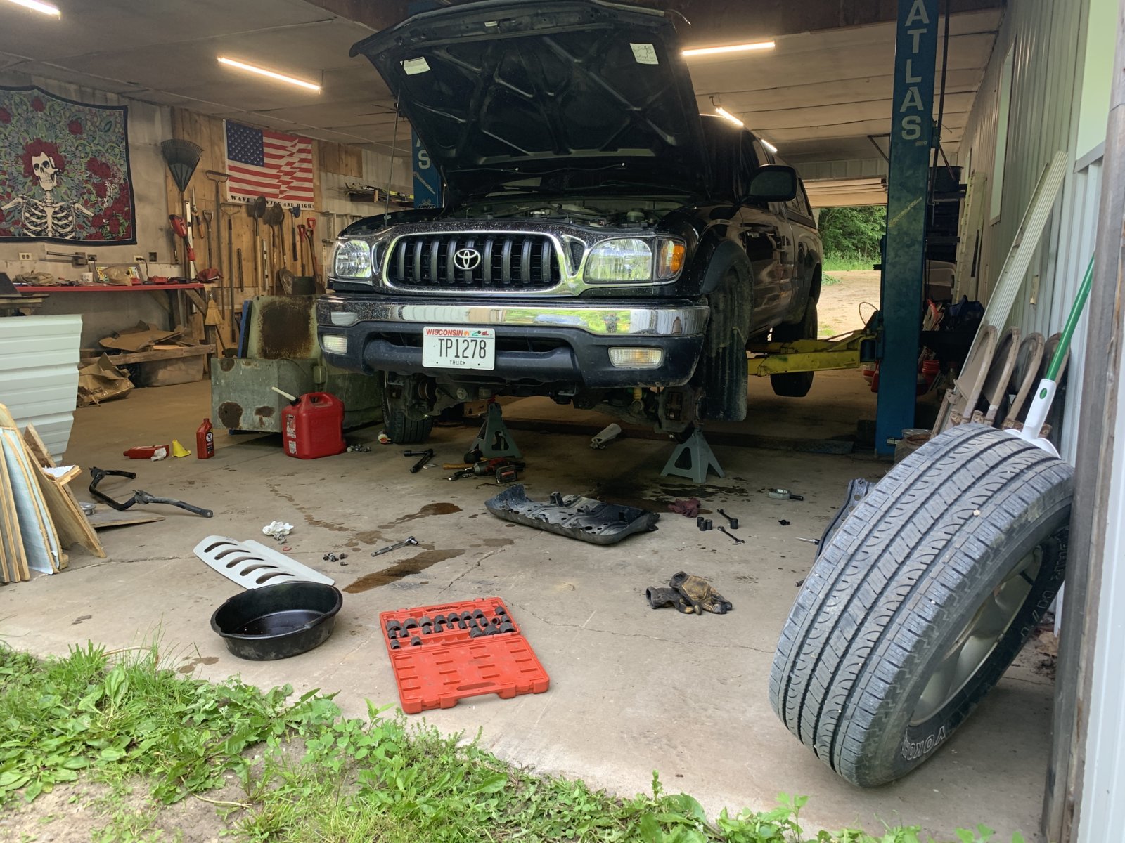

    Changed driveline fluids and removed pinstriping

    I would recommend getting that joint welded. I've never had good luck with exhaust clamps anywhere in my exhaust system

    +1
    Have the same exhaust, same clamp, it always leaks and rattles there
    Feel like I tighten that joint monthly

    Yup I was going to try one other band clamp then take the welder to it. Won't be pretty but it'll work.

    Awesome, haven't seen that before, thanks for the tip! There's one spot I'll need to cut and patch up with a new piece of metal, but for the other surface rust this looks like the ticket.

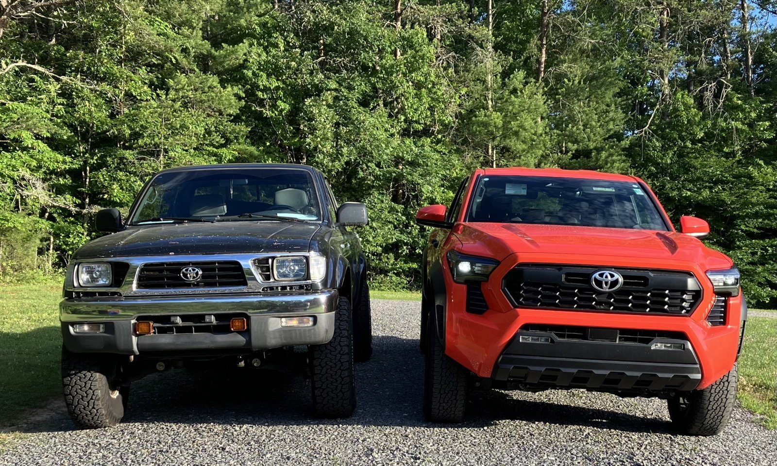

    Compared new school vs. old school.
