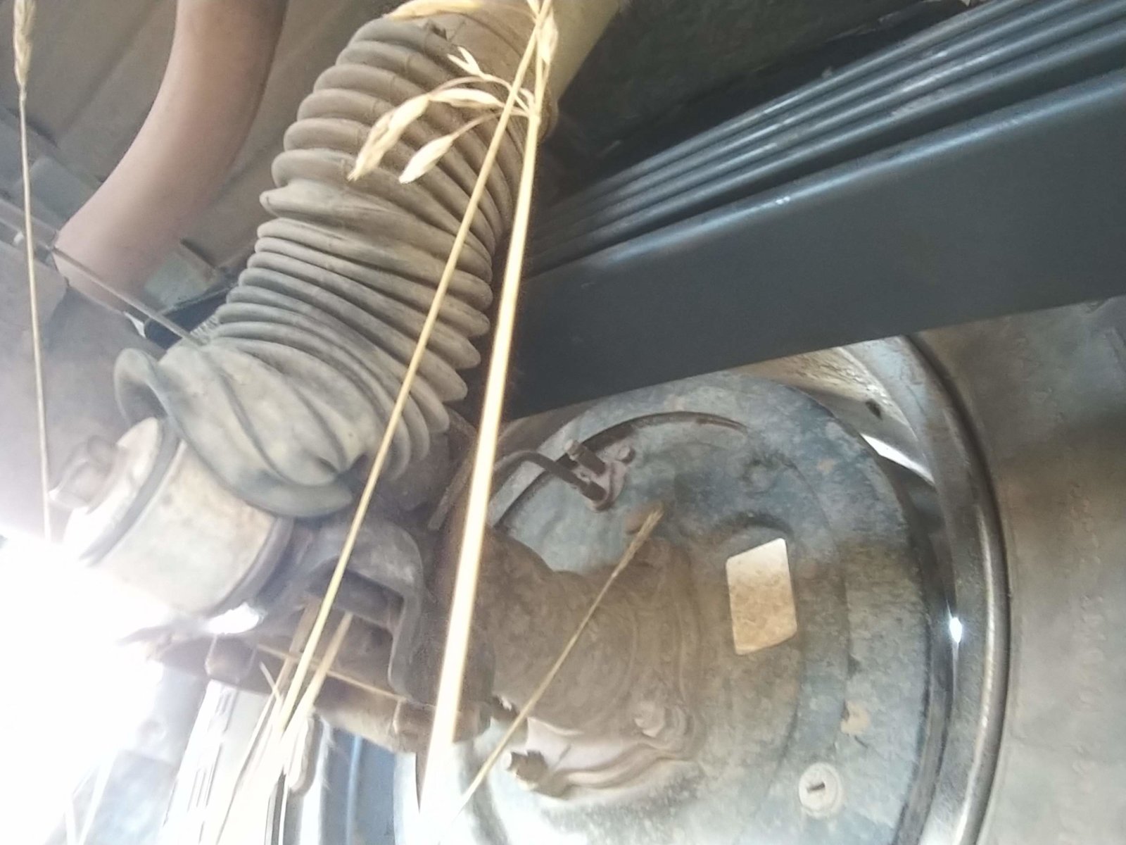

    I ran a CS019 pack with 2 leafs removed for a long time when I had 31s on and didn't need much lift. I pulled a middle leaf (The 3rd one IIRC) and the lowest Overload leaf. Worked perfectly. I recently reinstalled the 3rd Leaf due to adding weight to the back. Still without that Overload to drop 3/4 of lift of the pack.
    The center pin does get long as you remove leafs and you will either have to cut it or drill out the bumpstop to fit it.
    I have an Old Photo of it at full compression but you can see its missing the lowest overload and the 3rd leaf.
    I ran it like this for 4 years and 25K miles without issue.

    Thanks for the info and photos! are you certain that photo had both leaves removed though? im Pretty sure the cs019r leaf pack has 6 leafs. 3regular and 3 overlaod leafs. Im counting 5 leafs in the flexing pick so one leaf is definitely removed! Thanks

    My bad I just realized I am on a CS016R Pack being a 98 with the longer leafs.
    The results will apply on those packs though. You can remove leafs. ARB tells you not to likely to just make sure the Load carrying ability isn't reduced.
    Mine is a 5 Leaf pack with 2 Overloads. 1 still being removed. But on yours I would pull an overload if you want to just reduce height. Or if you want a slightly smoother ride will the 2nd Regular leaf. So that you retain the leaf holders.

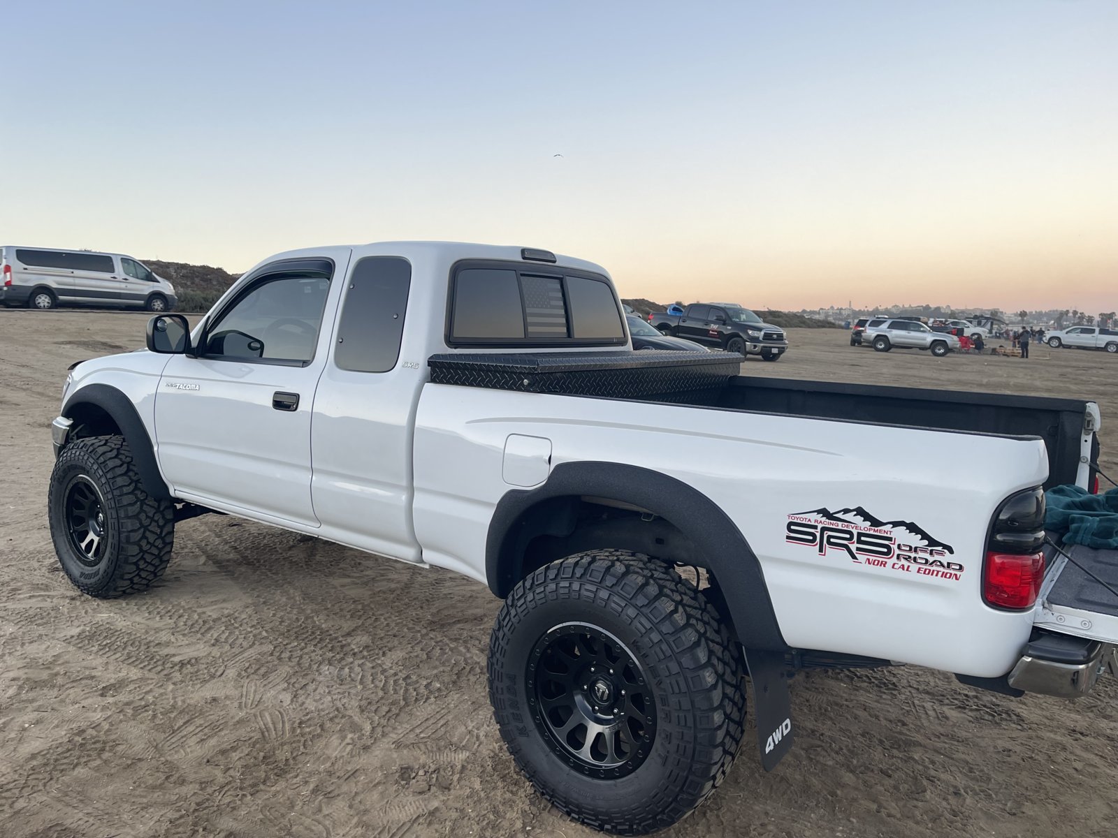

    I think that if I had a white or black truck, I'd keep the wheels the nice army green of the primer. Now for tires. I think I'll go with Kenda Klevers this time.

    stuff
    What size tires are they? Looks good!!

    Those are 285/70/17
