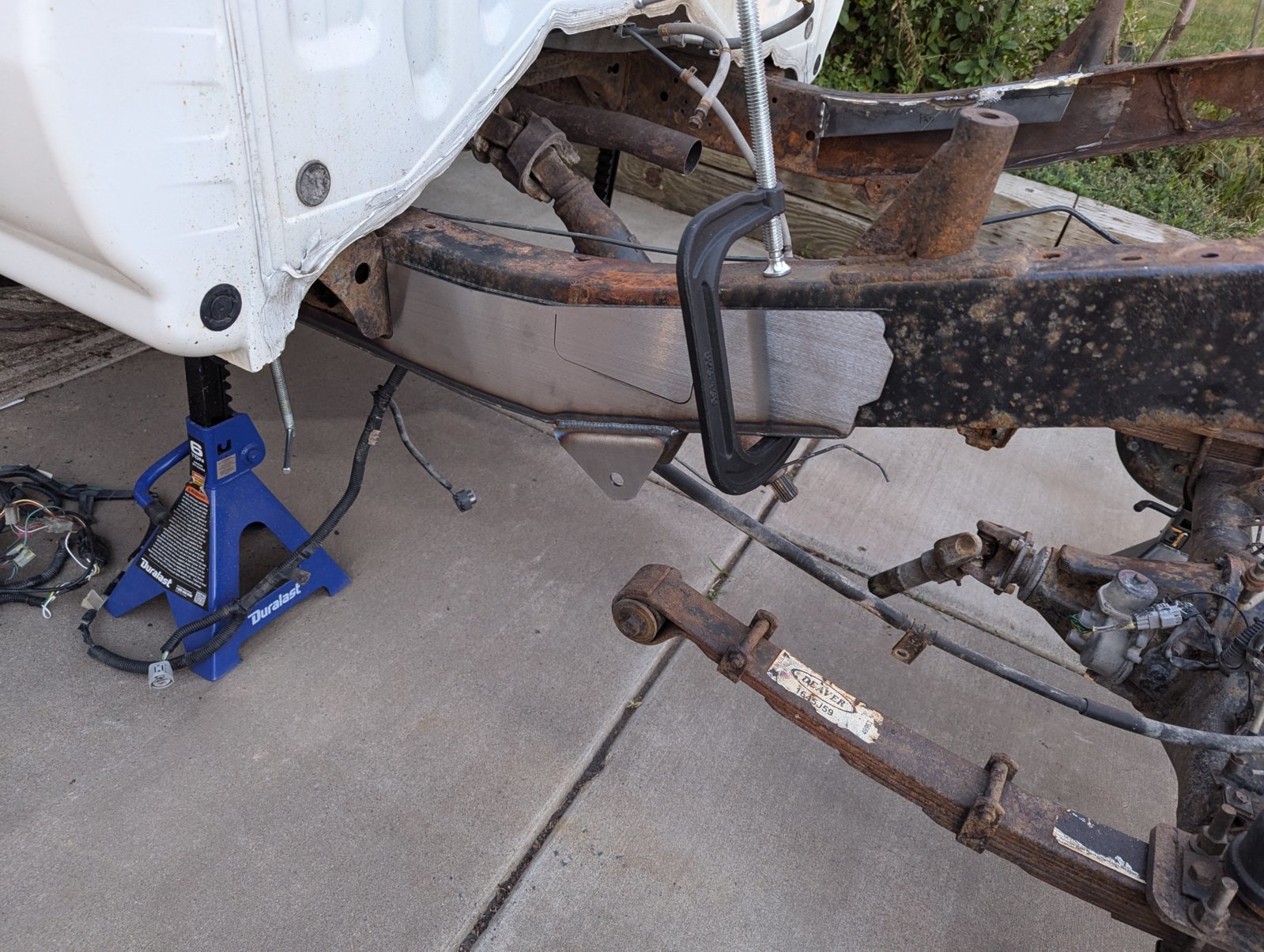

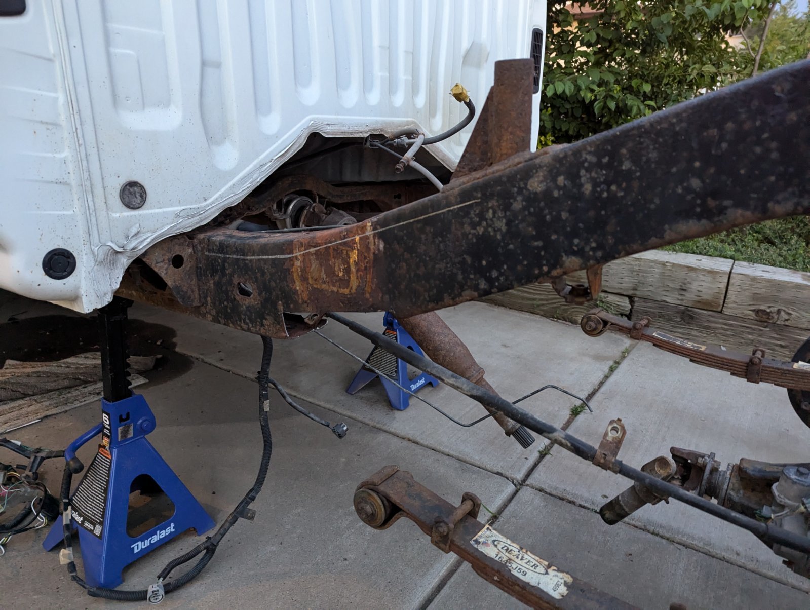

    Started removing spring hangers and testing fitting the replacement caps.

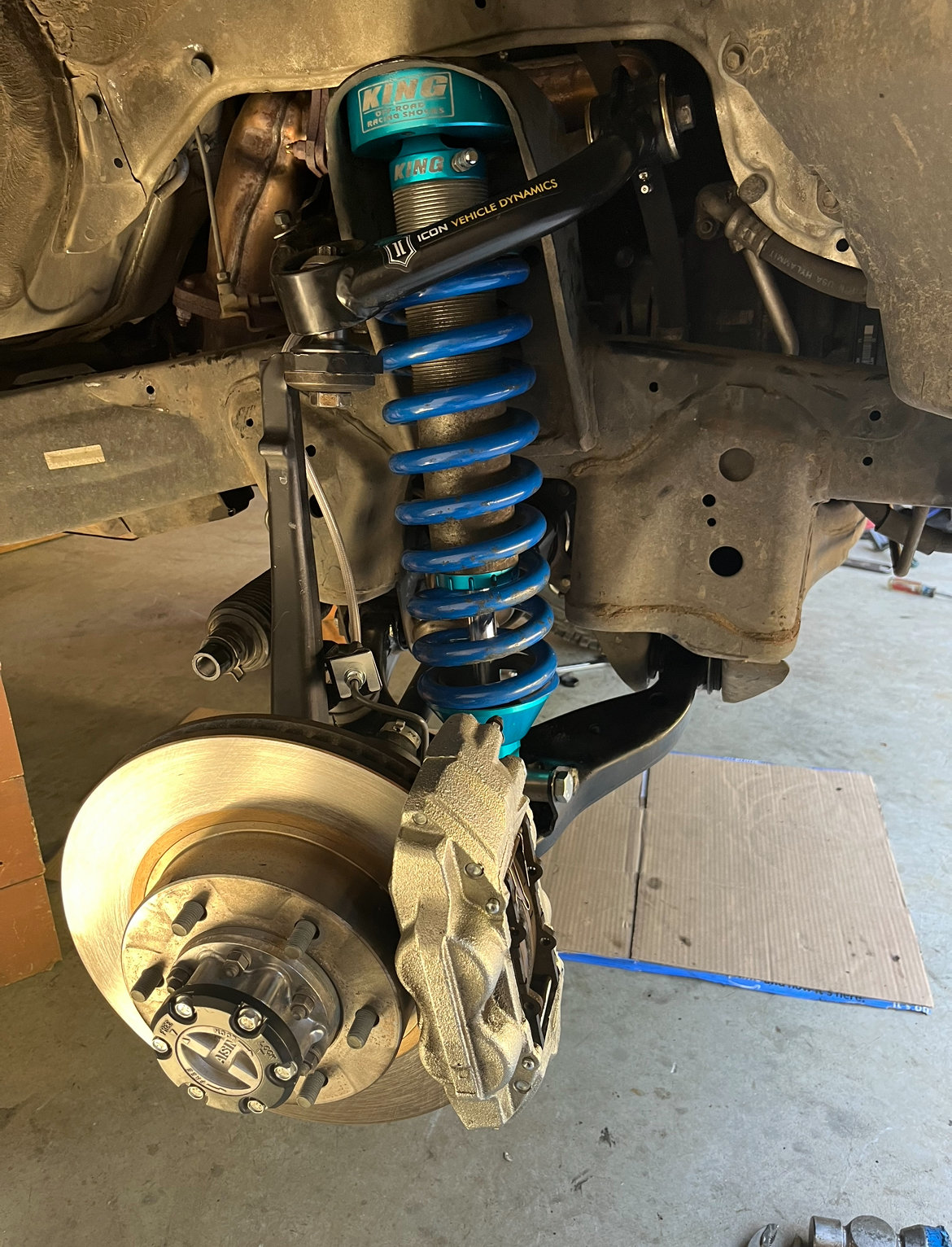

    Installed Icon UCAs, Stock LCAs with Eimkieth reinforcements, King shocks, inner and outer tie rods, lower ball joints, and new steering rack bushings, then took it Les Shwab and had it aligned

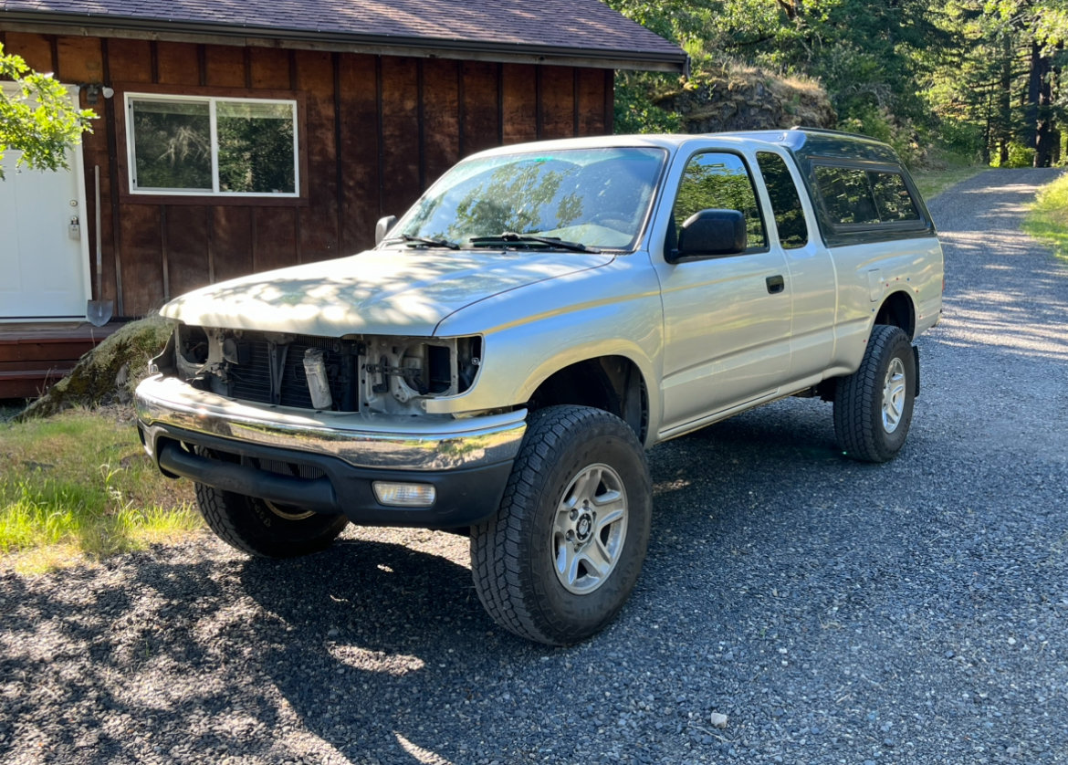

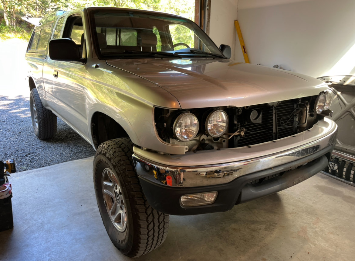

    After that I gave Gertie a nose job, headlights are in progress..
    Silvers are close enough to pass until paint time, need to get those rear fender grommets pulled. On an unrelated note I'll be listing a complete 01 front end in first gen parts if anyone is interested :D

    You backdating your Taco? That's gonna look great.
    Also, how is the new ride quality?

    It's a 4runner front endnhe put on, same gen though

    The ride is much improved!
    I want to give all the credit to the kings but honestly so many things got refreshed it's hard to say.
    But the used King shocks, with 600# springs are a night and day difference compared to what I pulled, which was new OME struts with 500# springs
    much less chatter over bumps:)
    I swapped them out in anticipation of adding a winch, and because I got a great deal on them:D

    I'm guessing he's referencing the dual rounds
    you are of course spot on for the body work

    You making a grille for the dual pars or a was that a temp thing?
